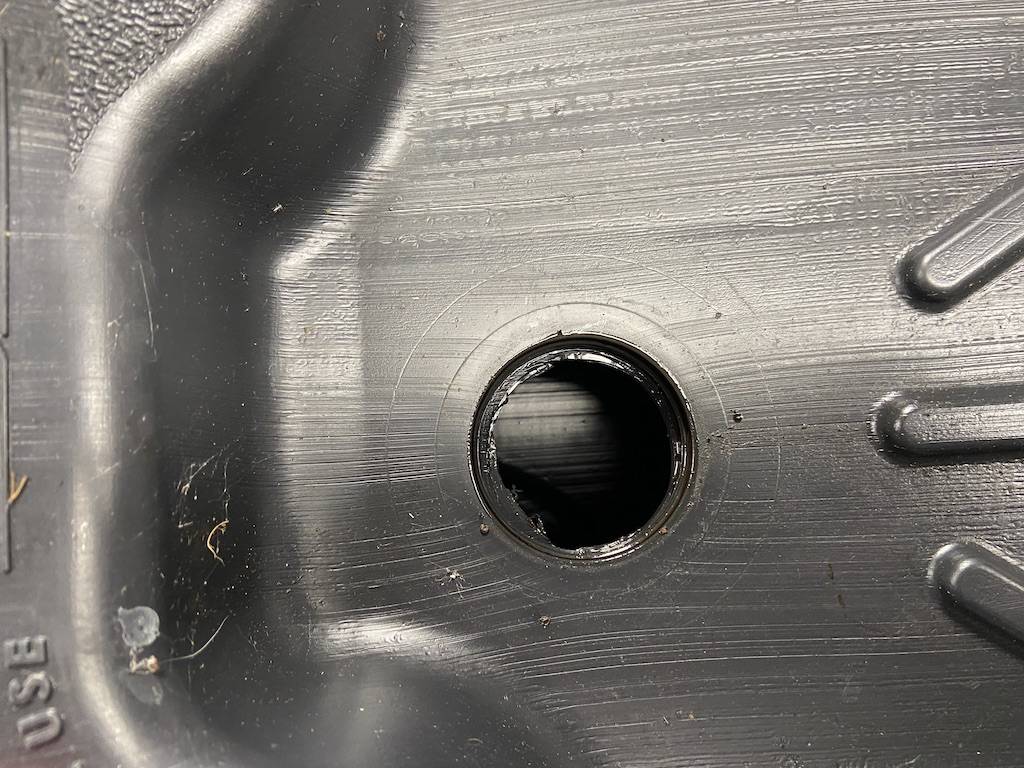

2 things
The hole where the oil goes into the pan, should be opened up to accommodate the funnel, it has a trap.
Then cut the funnel tube off so the funnel will sit solidly on the raised ridge of the drain pan, & not wiggle around.
I can measure the down spout & post if you like?

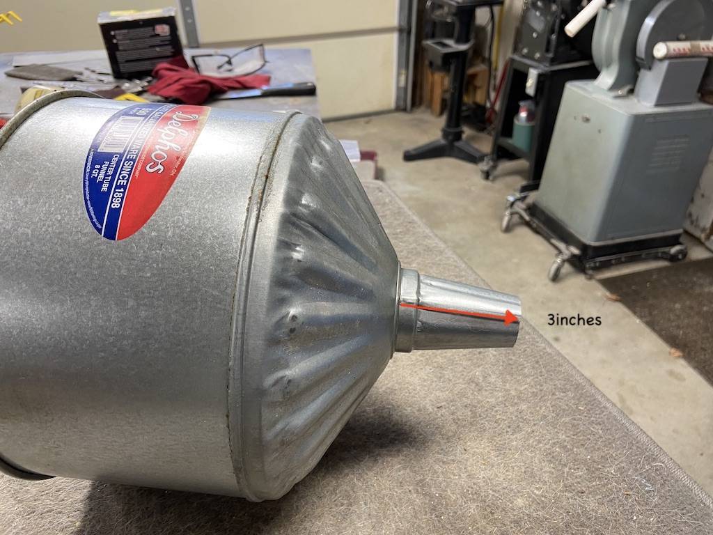

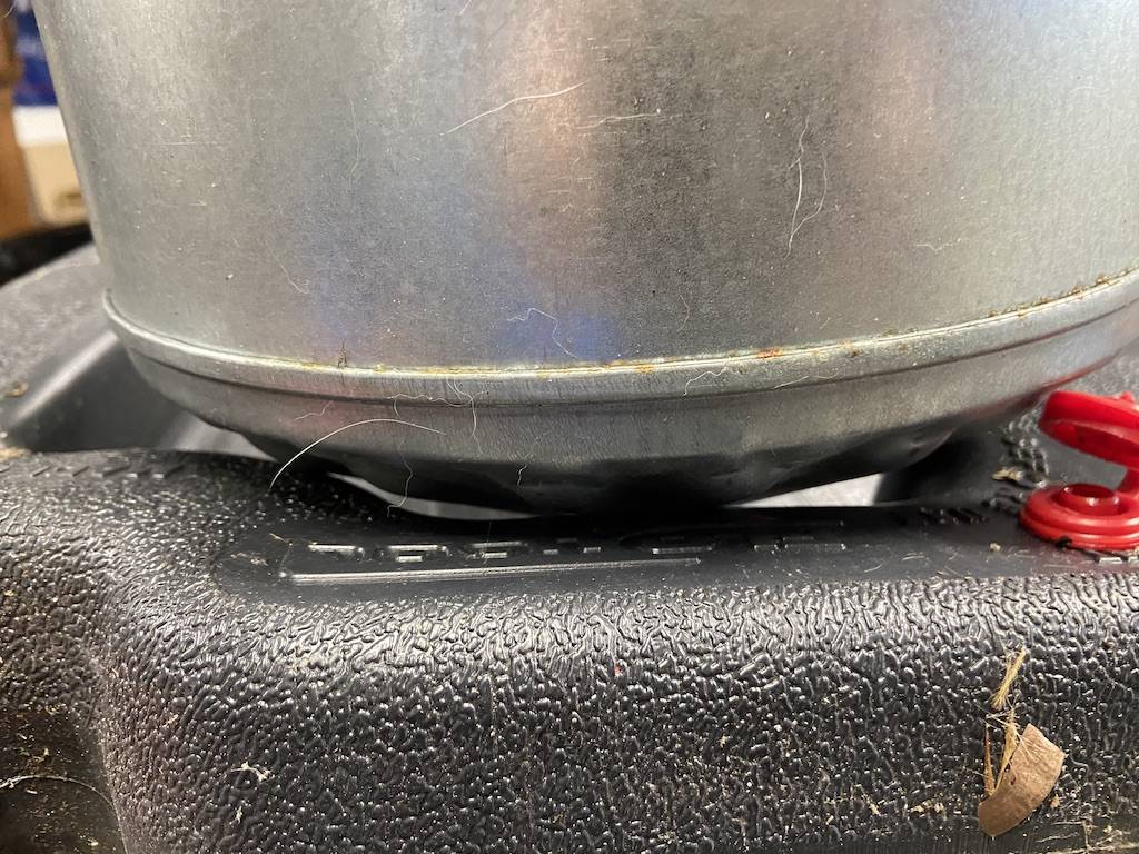

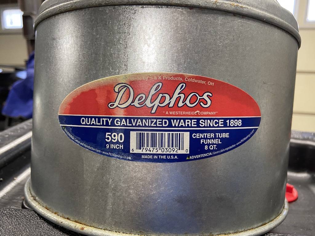

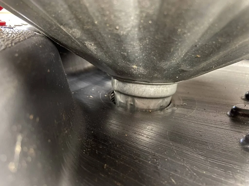

Pictures, worth a thousand words :-)
the threads for the plug are still there, so it still seals.
3 inches
Very sturdy, the oil goes right into the drain pan, never accumulates in the funnel.

MANY thanks, amigo! Easy peazy. :-) But I got a chuckle when I went to funnel link because it was for TWELVE of them but I FIRST looked at the PRICE! $122! <laughing> And then I saw the link at the top for just one. $23, a bit more reasonable. <grin>

The drain pan (from Wally World via Kamazonski..whodda thought, right?) FINALLY showed up, Greg and I've been waiting to cut the funnel until I first do the pan cutout.
But for reference purposes, (measure twice..) can you tell me how much of the spout is remaining after the cut? (or how much you cut off?)
I'm trying to visualize a view from inside the pan and I'm seeing maybe an inch of funnel?
TIA, Greg.
Rapid Red
Nov 4, 2019
5,049
4,096
Woodstock GA
Greg
TIA, Greg.
This help?
