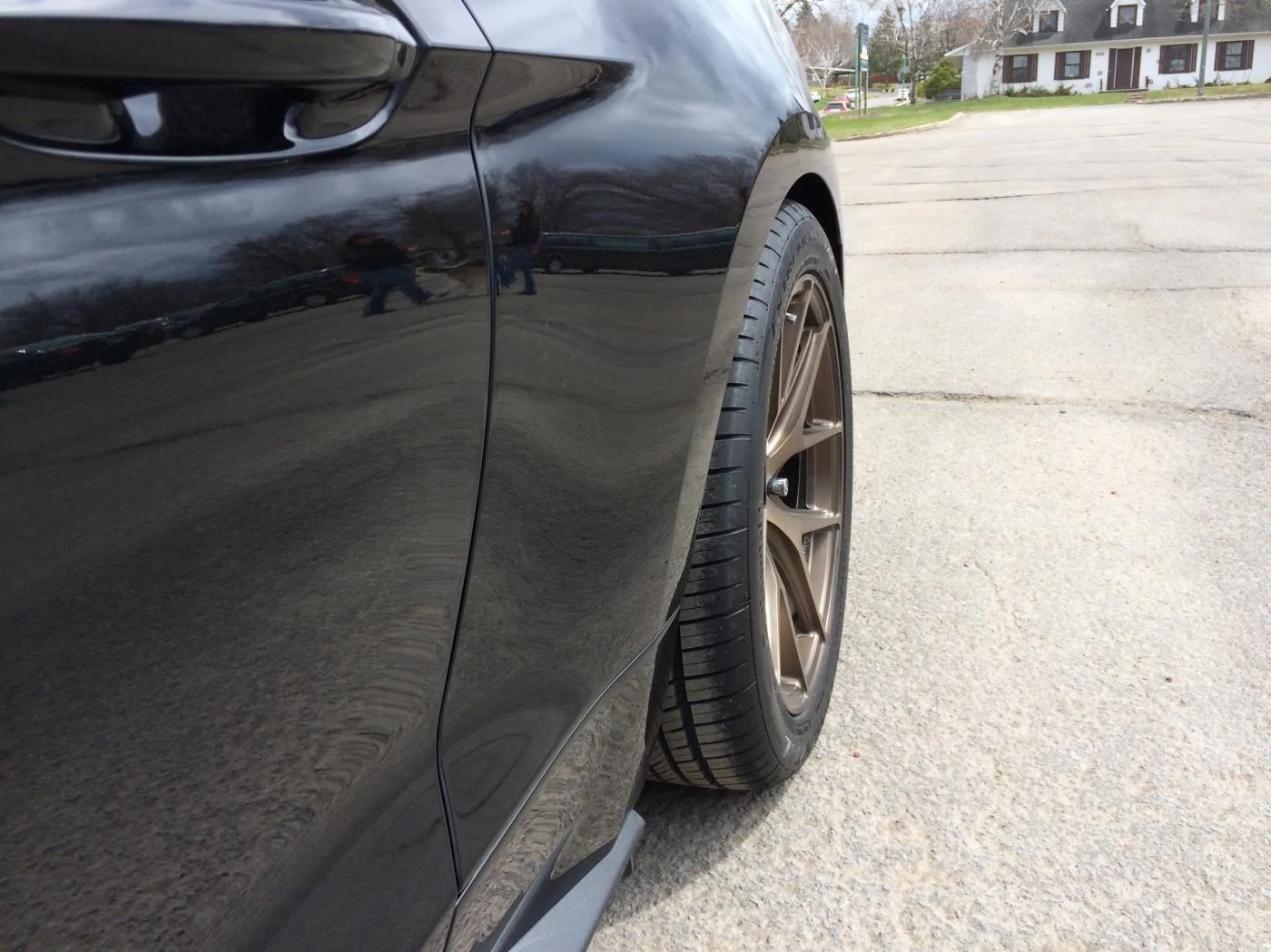

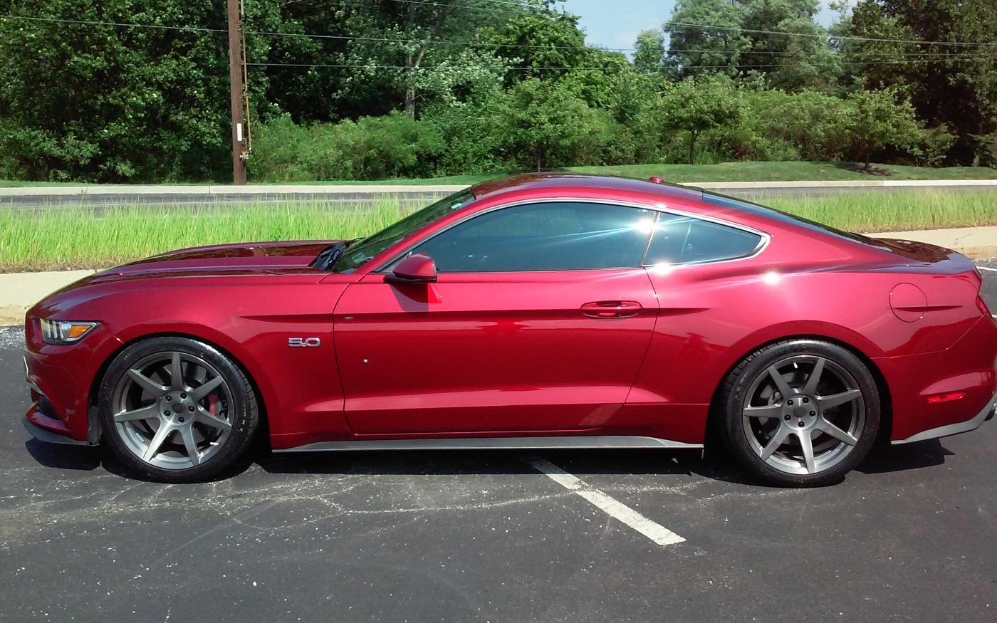

Im running square 275/35R19 with the rears on the factory 9.5" wheels. Its pretty close to perfect, not stretched at all. Just a little shorter than the factory rears, but about the same as the factory fronts.

sooo want the downforces they have on lmr. 20x8.5 square, problem is there a 27mm offset, dont know if that will be a problem running 275/35 tires i went on the calcualtor thing says it will be out further then 25mm thats a good inch cause of the offset.... guess ill have to research more

thanks yeah that looks bad ass .. my only concern with a 275/35 on a 9.5 was i dont want any stretch, i had 275/40/20 on my challenger on a 10 inch rim and it stretched a weeee bit ... think im going to go the 275/35 route im on cjpp springs more of a drop in the front then rear..
275 doesnt stretch on the 10" all depends on the tire you use.
I think you mean when the top of the tire cups and curves.

yeah the cup and curve thing i wasnt fond of.. i ran toyo proxes t1,s.. i was wrong it was a 10.5 rear

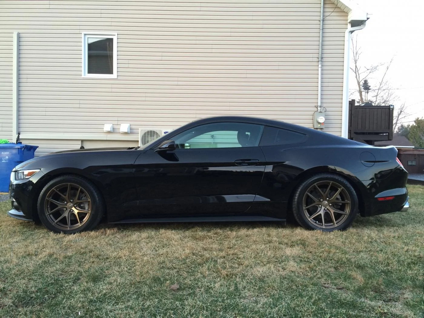

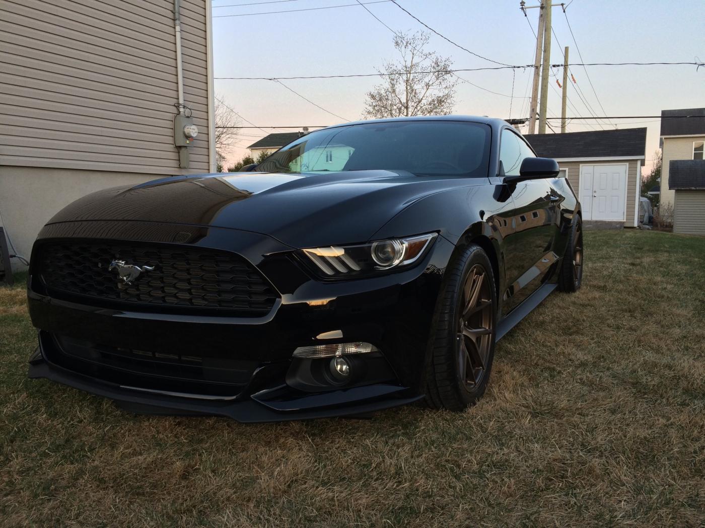

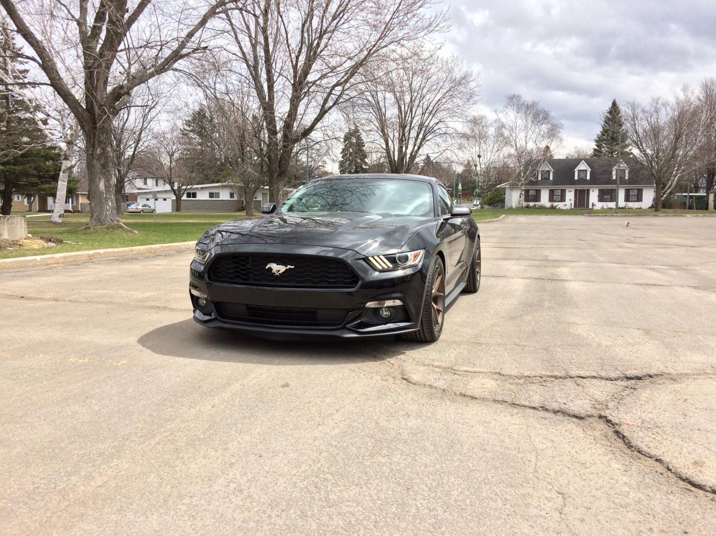

That looks really great. I'm a bit suprised l not seeing more black 6GM's running this wheel color on the forum.
Thanks man. Yeah, silver is classic, black on black is a bit to much for me, bronze is different and looks really nice to me

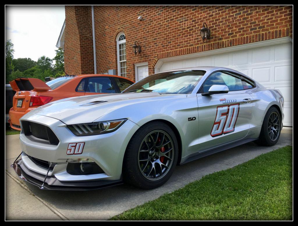

Consider Apex 18" EC7 if track only. They clear and are light and strong with a very long track history durability wise.
You will se alot of 18" used at track days as the tires are $100 cheaper and it is very difficult to get a 19" tire wheel to weigh as little as an 18" tire wheel: assuming youc are about unsprung mass.
Also 19" 6G wheels are available to run square.

What he said^^
I run 18" Apex wheels for the track.
