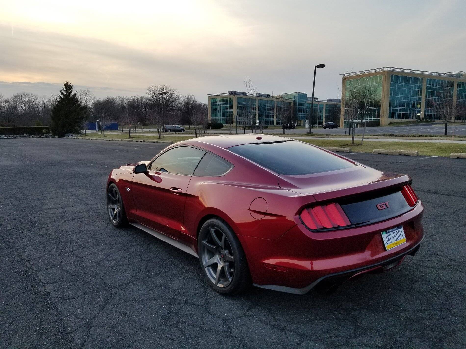

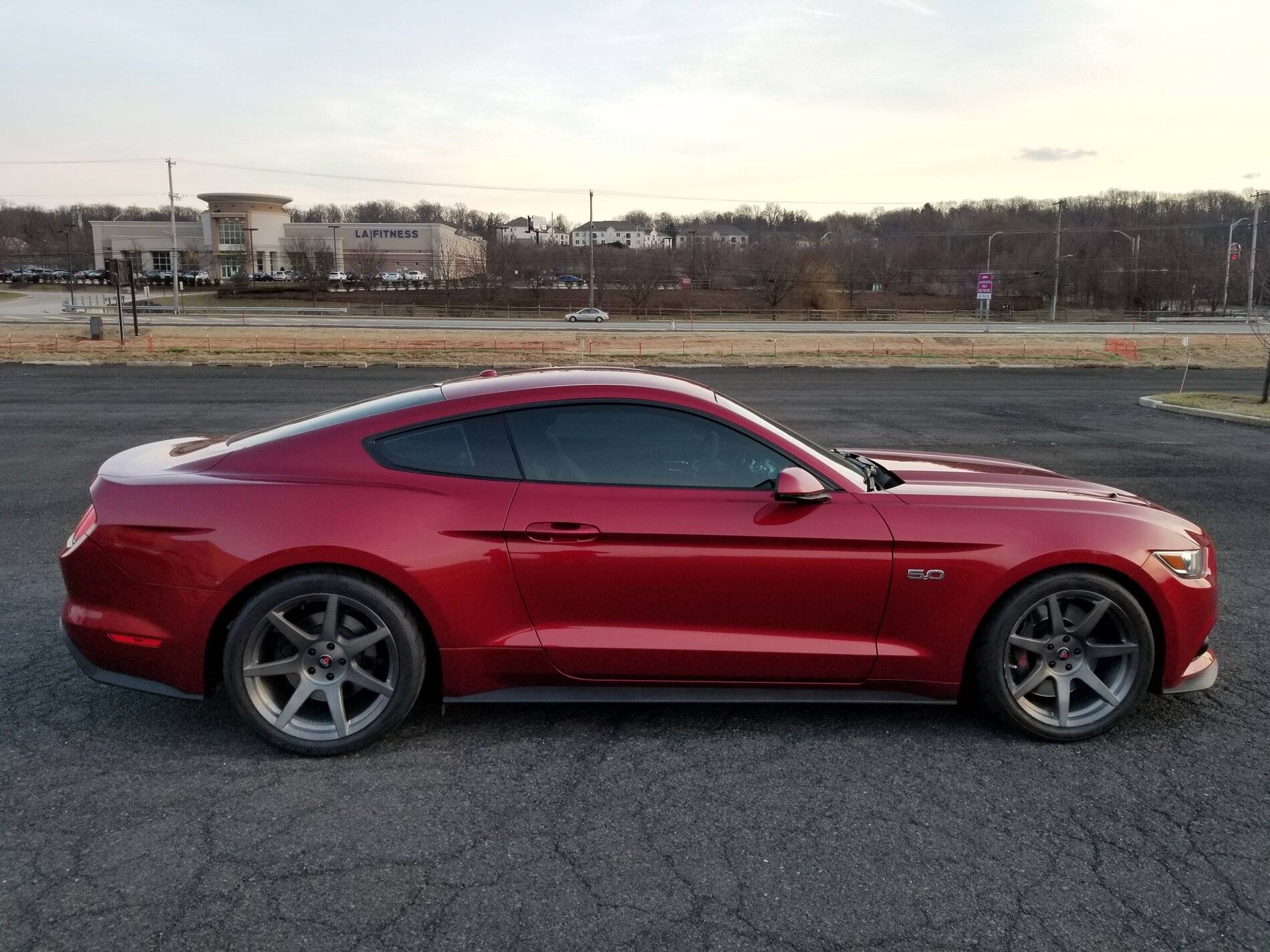

jabrax
Oct 22, 2015
85
790
146
Montgomery County PA
Jeff
2015 ruby red PP GT
subbed. looking to get a square set of wheels to replace my stock PP1 wheels. would love to see more deep concave square setups but it doesnt seem like there are that many out there.
Here is what the 6gr 10 squared looks like mentioned by Nightmare
