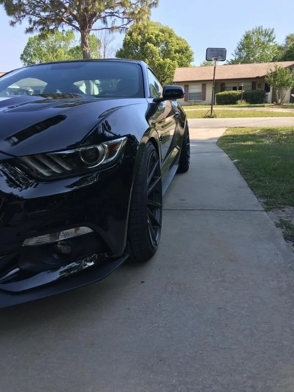

Check out my post on page two, number 25. Mine are 285s but other than that same specs, wouldn't notice much of a difference between 285 and 275.

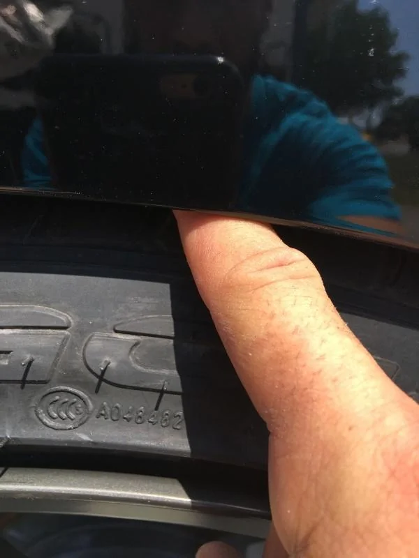

285/35 bubbles over a little on a 9.5 typically so 275/35 should be about square it depends on the tires though some run wider than others.
