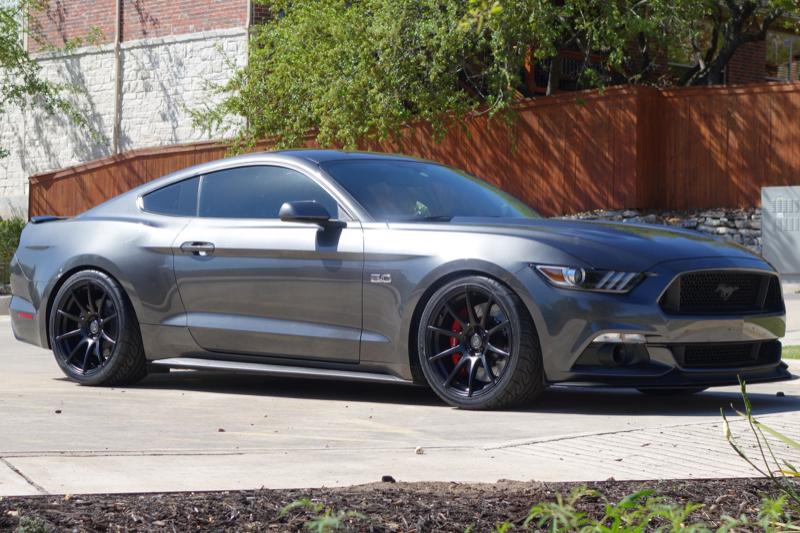

Forgestar CF10's 19x11 with 305/30's.
No issues at all, works great. Street handling is great, with a little tram lining, hope to do a track day soon to see how they do when pushed to the limit.
^^this is the winner, but without offsets, it's a moot point.
(and yes, I know this is the car Cortex set up with some specially goodies)
