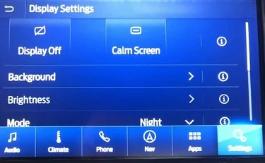

...Out of curiosity, what's the deal with that 'cyanlabs' mentioned so much? What's the catch with that site? And do they have now the same exact 3.4 version (forgot the numbers), or is it still an older version? Hope I don't have to use it.
Cyanlabs method is like jailbreaking method for iPhones. Their downloader allows the install /update of Sync and Nav versions bypassing Ford's checking methods. You still downloading official Ford downloads from Ford servers. All is done from one place. This is how Sync3 v3.0 owners can install newer versions like v3.4. Because of their outdated APIM, Ford doesn't allow this. Check out the Cyanlabs community forum
If I can ever download it, where do you access it? Thx.....Where is that setting? Thx....Are they 4 on 3.3 or 3.4? And once more, how do you access them? Thx.
These are found in the display settings

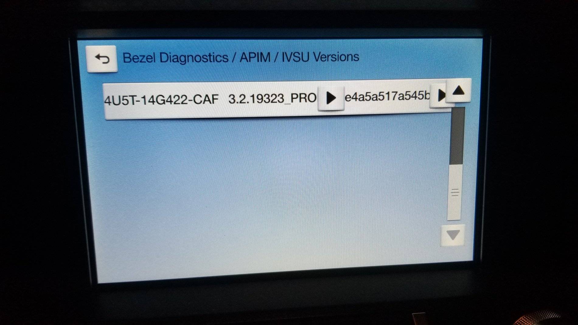

I found them on my pc so here they are.

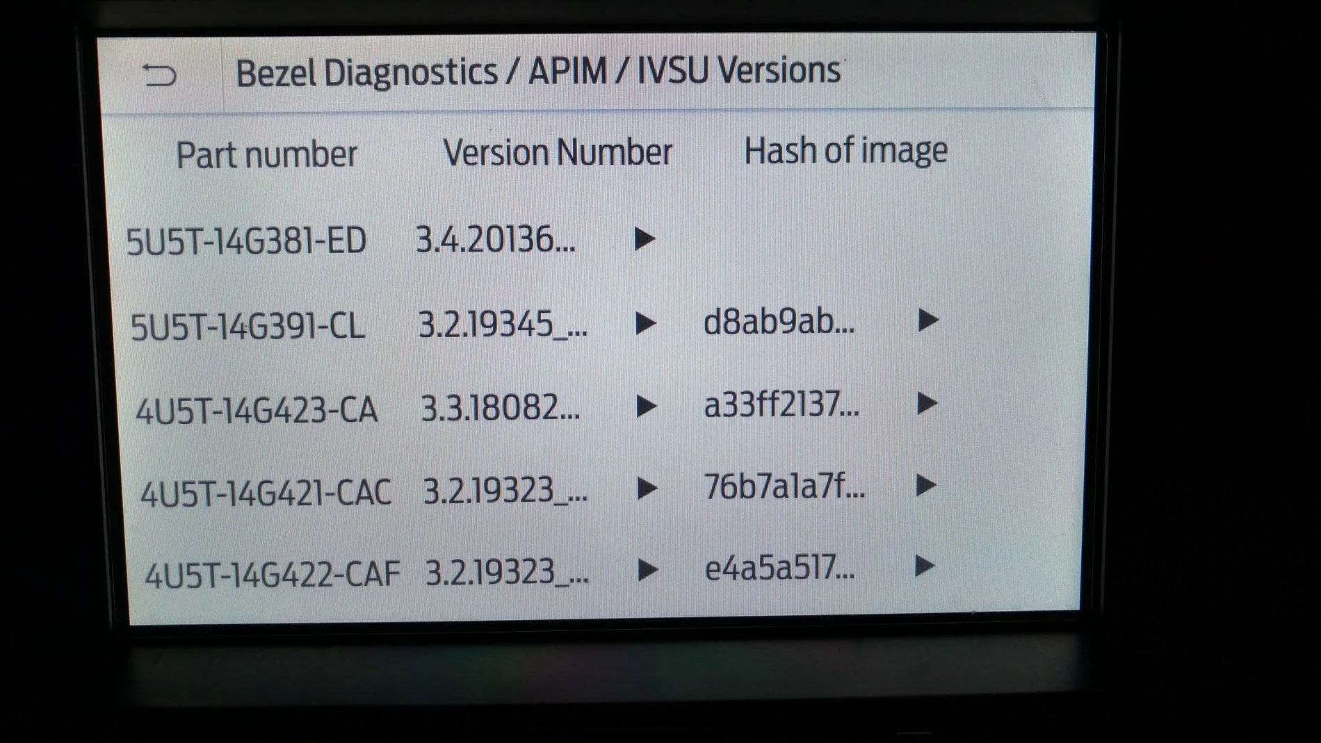

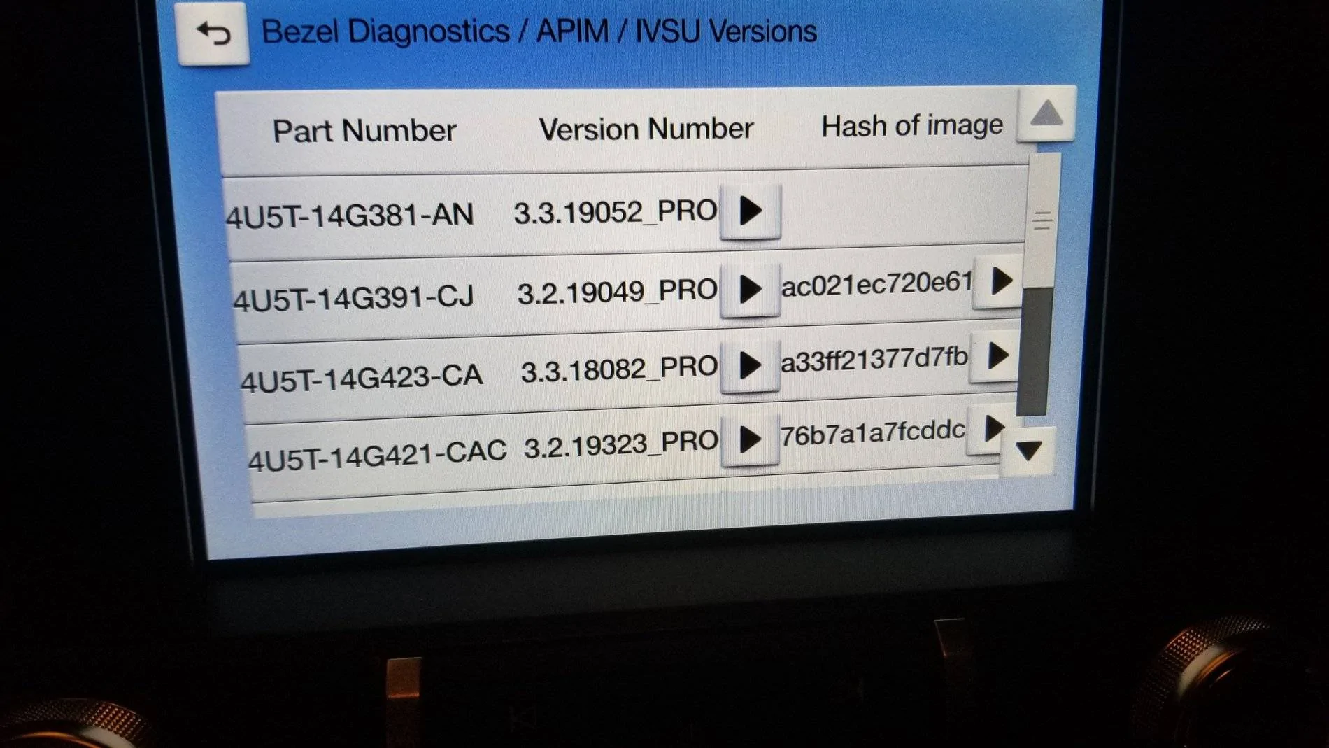

How do you get to this display? I guess this is the APIM diagnostics. I need to check if my NAV 119 installed correctly.
How do you do a "master reset" on Sync?
thanks,
Press n Hold FF and the CD Eject buttons -> Touch "End Speaker Test" -> APIM diagnostic - > IVSU Versions
thanks,
there are 2 methods
https://www.mustang6g.com/forums/threads/how-to-enter-into-“bezel-diagnostics”-mode.119109/
1) like el-guapin said..
2) if you dont have a CD player (like i do) then its "seek up" on the steering wheel and "tune up" button on the FCIM (front control interface module). its the phsyical button on the center console to go to next station, not the digital button.
Thank you! I don't have the CD player on my 19GT 400A so I'll use Wade's advice for that.

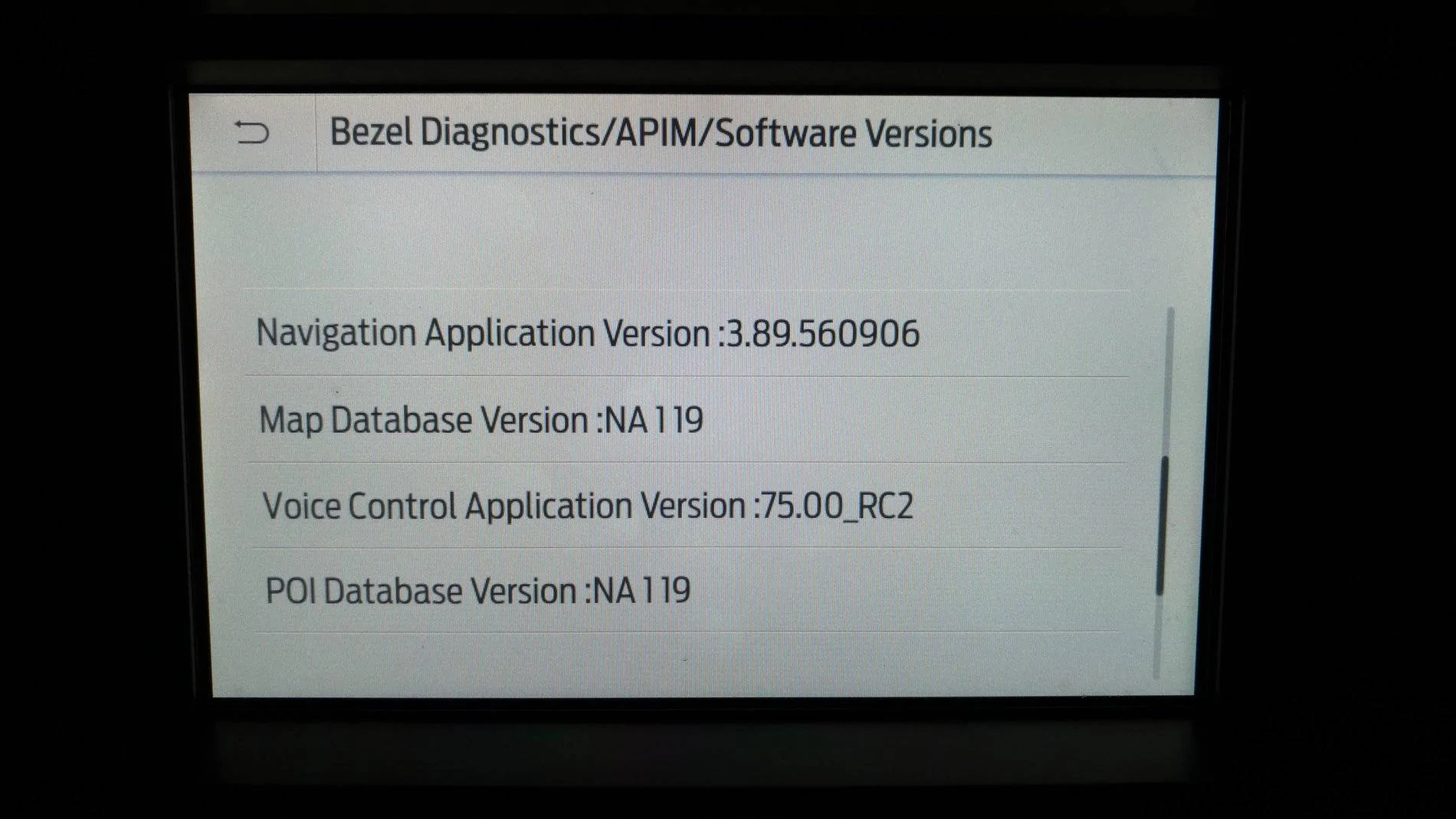

Even though my Nav maps continue to update in 35 minutes (tried twice) it displays Complete and here's what's been loaded. Guess I'm ok.

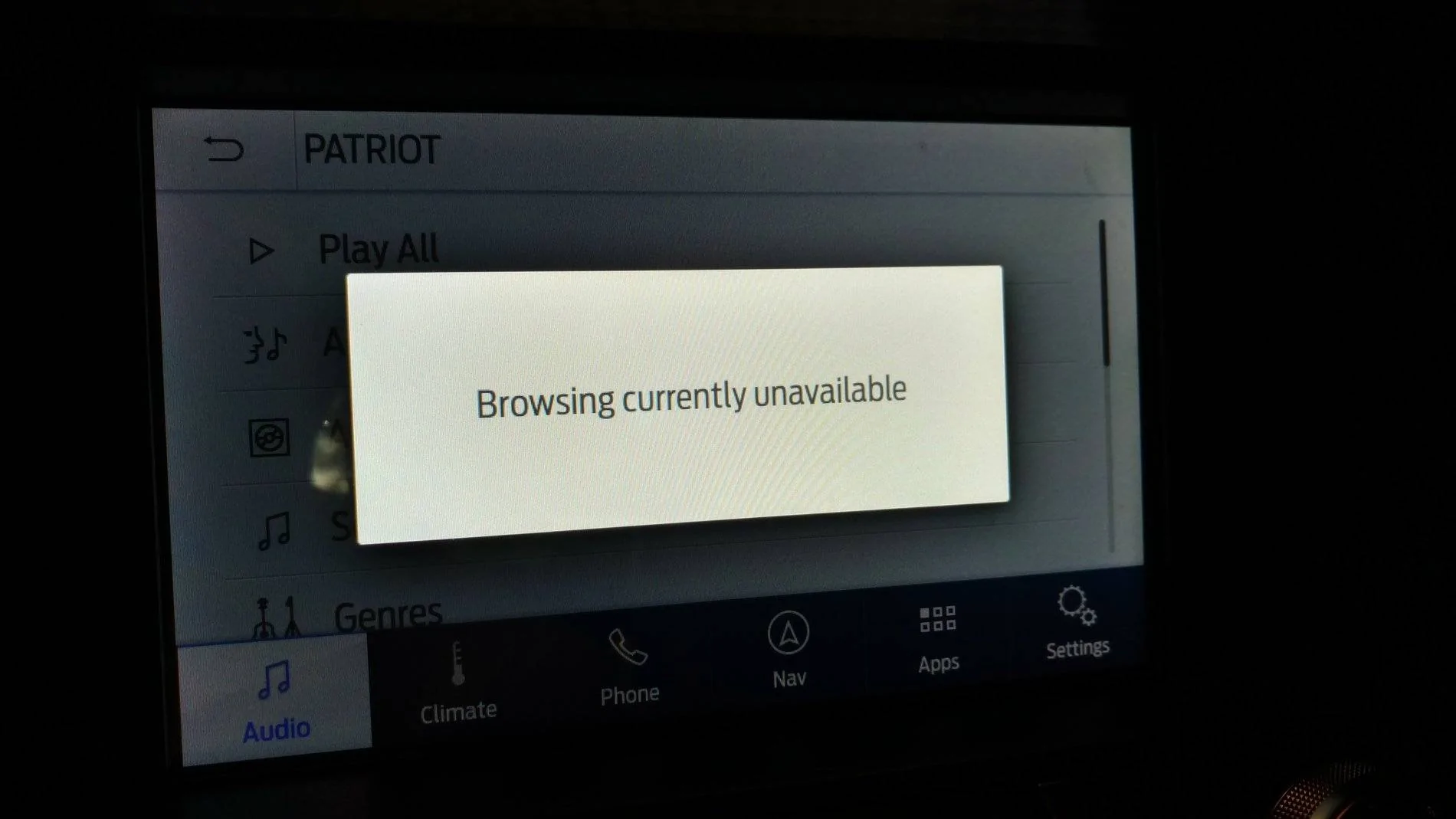

As someone else has mentioned, I'm now not able (with Sync 3.4) to Browse my USB stick with all my tunes, even when sitting still or when using the voice commands.
UPDATE: System Reset solved this problem.
Yep, looks fine. That's a pretty blistering install time for the map.
As someone else has mentioned, I'm now not able (with Sync 3.4) to Browse my USB stick with all my tunes, even when sitting still or when using the voice commands.[/ATTACH]
Yep, either a master reset (to re-index) or a forced re-index through media player settings seems to be clearing this up for everyone.
