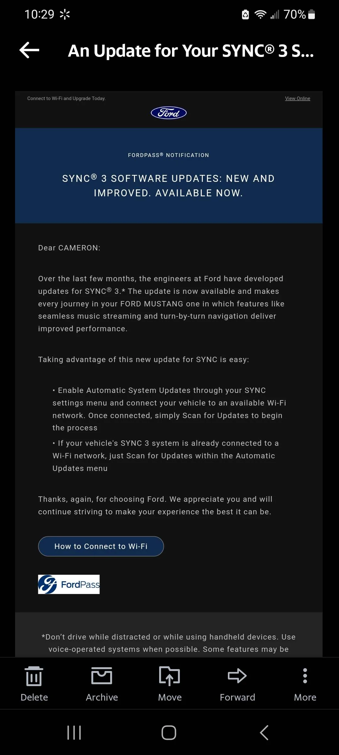

Got this email today. Anyone recently update their Mustang? Is it a legit improvement? I don't want Ford gathering more info from me than necessary.
Yes, I did it. As Sync3 is discontinued there are no longer any major improvements. It’s basically a behind the scenes update. No reason not to do it. The latest build # is 22200. You can check in General, About Sync to see what your current build is. And no, they are not gathering any additional information on you.
I just got this today and I’m on 22200. As usual the update site is working so I’ll keep trying to see if maybe Ford released 22251.
