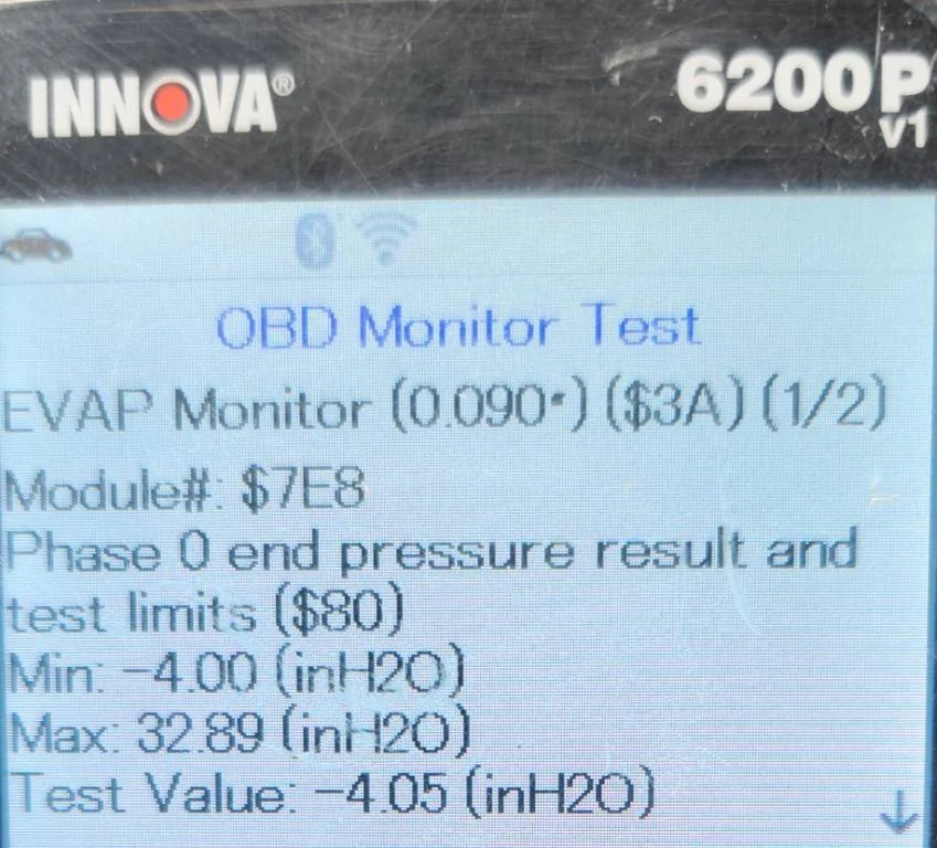

After a bit of hibernating over the Wisconsin winter, I ventured back out to the workshop to see if P1450 Unable to bleed up fuel tank vacuum has somehow sorted itself out when given time to think about its actions. No joy with that. I have already replaced the vapor canister purge valve / solenoid with both a new aftermarket one and a new OEM one, but no change. I smoke tested the lines and spotted no leaks. I lubricated the fuel filler flap with WD40. And due to the amount of raw gas that was dumped into the emissions systems when using 87 octane on an E85 tune, I have now also replaced the entire vapor canister assembly with the Standard Motor Products CP3633. But after driving it for a few weeks, it still registers a new pending 1450 and retains the permanent 1450 codes.
I'm going to re-do the smoke test and also look hard for lines that may be kinked but not leaking. The only remaining item in this whole EVAP system that may relate to P1450 is the fuel tank pressure sensor and the OEM shop manual I have says the rear subframe has to be dropped to access the sensor, and that's if you can even find a sensor to replace it with because apparently neither Ford nor the aftermarket makes this sensor. So some junkyard diving may be needed. I read somewhere else that it may be possible to replace at least the sensor part and re-use the existing tubes by loosening the gas tank straps to have it down a hair to you can fit your hands above the differential. We'll see.
At least I have the new clutch to go on the AC compressor. The squeaky/grinding noise goes away when I turn on the AC so hopefully I can get away without replacing a whole bunch of AC stuff too. I got a killer deal on a brand new water pump, thermostat and all related hoses so I am going to replace this stuff when I am doing the AC compressor clutch install.
At least the above is plan A.
I do see some evidence of the problem when I run the OBD tests on my scanner. It does show a low reading on one of two. Now to try to decipher exactly what this data is telling me.

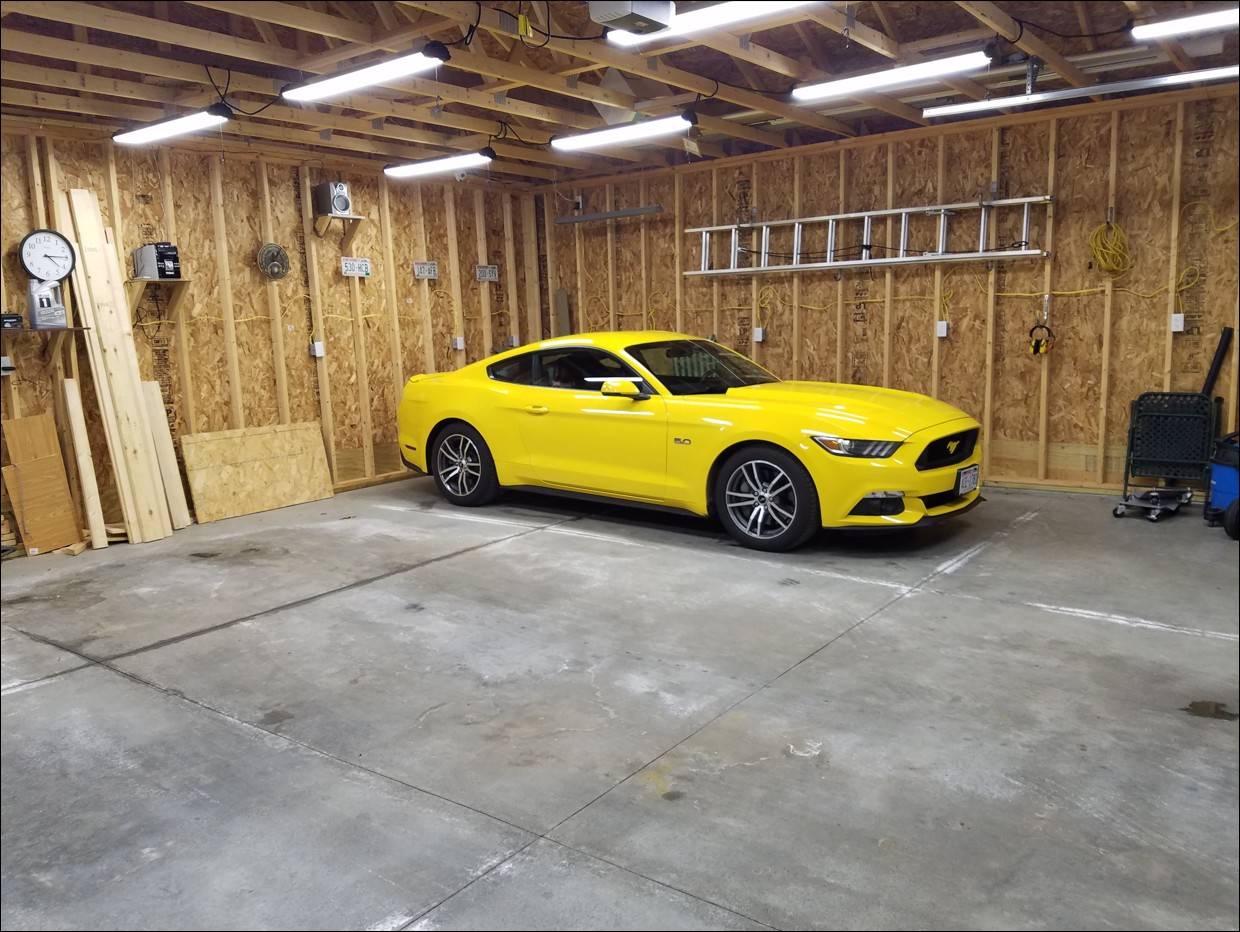

I only wish my yellow 2016 GT (named Crisis) was still here instead of the red 2016 GT Oliver. Yellow ones are hard to find, at least that aren't $5K more than a red or black one.

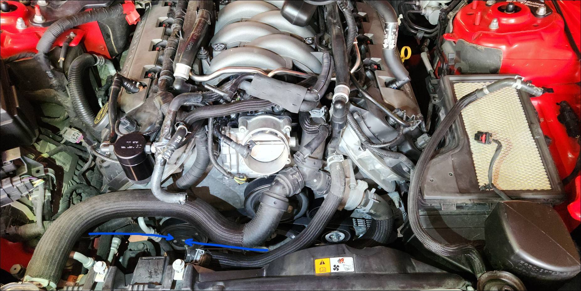

I figured today was as good a day as any to start the replacement of the AC compressor clutch, water pump, hoses, thermostat, etc. I got off to a decent start, getting the coolant drained without making a mess. Then came removing the stuff in the way to remove the AC compressor clutch and water pump. @#$@#, a very brittle plastic clip on one of the hoses connected to the air inlet tube snapped and those little bundles of joy are a peach to find to replace. This time it's the end circled in red. I suppose after nearly 10 years in a harsh environment like an engine compartment, a certain amount of material fatigue is to be expected. But they still suck trying to find/replace.
I got the rest of that stuff out of the way, time to remove the AC compressor pulley. No sweat, time to dig out my handy-dandy clutch holding tool I have on-hand. Oh, crap. Since I've mainly used it for snowmobile and dune buggy work, I didn't notice how much larger the dowel pins are on it. Hmmm, do I wreck it for use on sleds/buggies by grinding down the pins to fit the Mustang's AC clutch compressor pin size or get one fit for purpose? I decided on the latter, and try to find the hose clips at the same time.
Looks like that's all for today. On to watching the MotoGP race and then the Masters. I got the F1 race watched before I went out to the shop. I won't spoil the results.

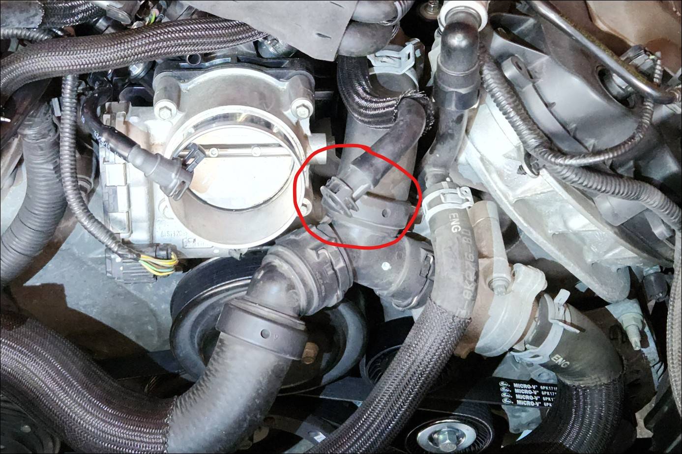

All of these radiator hoses are being removed before I proceed with the compressor clutch work any further and replaced with new ones afterward.

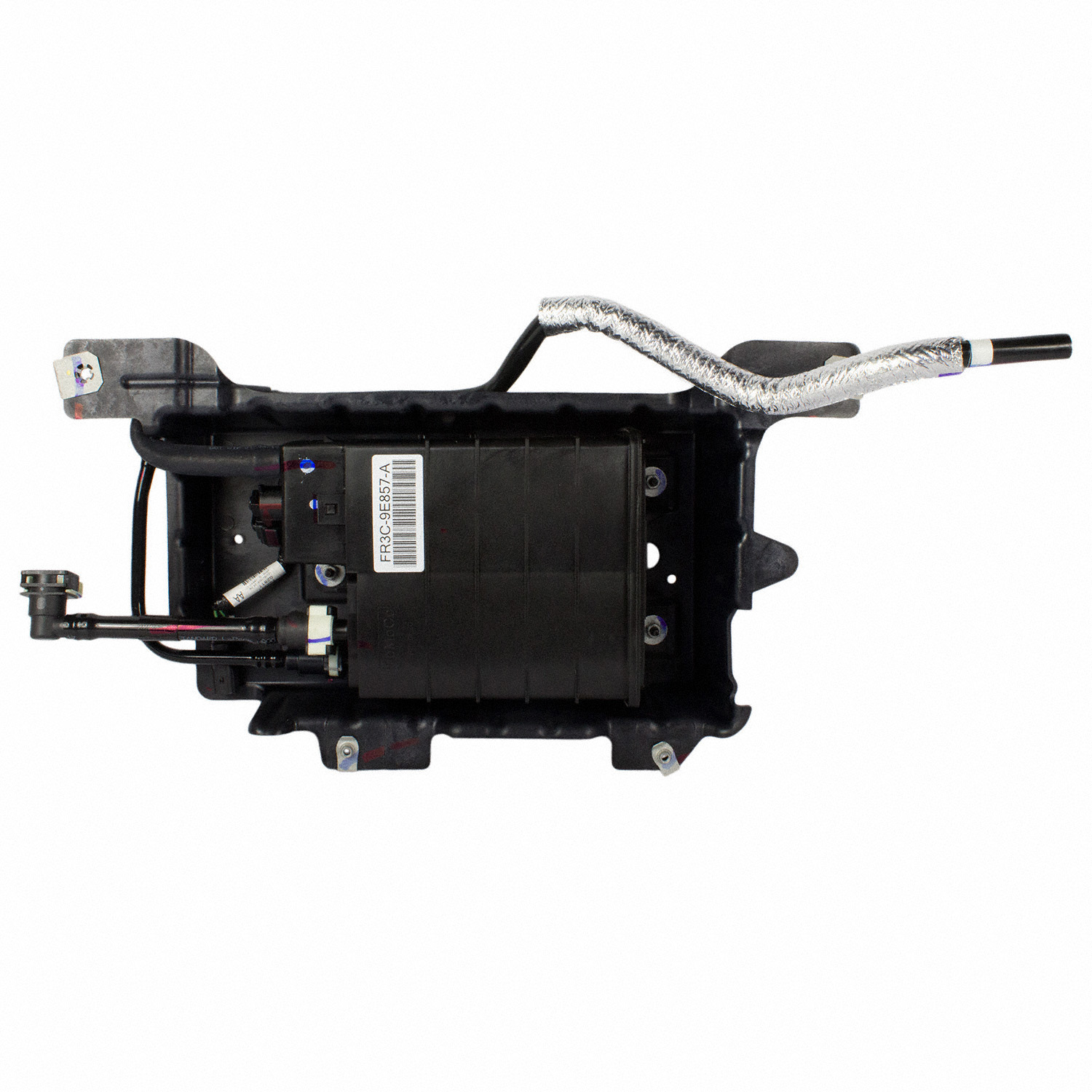

@LevittownFordParts
He needs the EVAP fuel pressure switch. This tells the computer how much pressure is in the fuel tank. I looked it up for mine a couple years ago and it is part of the EVAP lines next to the fuel tank. I tried and cannot find the part number any longer.
The part is very similar to the linked part in an above post.
LevittownFordParts
Jun 27, 2014
2,494
1,355
Worldwide
Benny & Mitch
S550's!
@LevittownFordParts
Thanks,
This appears to be part of the vapor canister https://parts.levittownfordparts.com/oem-parts/ford-vapor-canister-fr3z9d653j
In this image you can barely see the electrical connector
https://www.ecat.dealerconnection.com/images/upload/jpg/PRTIMG/CX25/CX2525-RIT.jpg
- Benny
