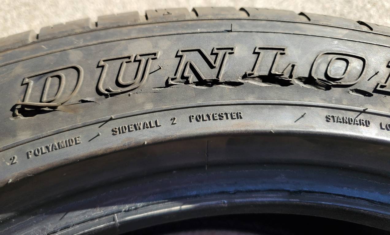

I was able to replace the mismatched tires that came on this car when I bought it. It had very worn out Federal Super Steel 595, 255/45/ZR18s on the rear and "new" 235/50/18 Dunlop Conquest Sport A/S tires on the front. I replaced them with 235/50/R18 Continental ExtremeContact DWS 06 Plus tires and also installed new TPMS sensors at the same time. I had the previous version of this Continental tire on my other 2016 GT and liked them.
Now like everything else on this car, that can't be all there is to it. I left the two worn out tires at the tire installer for recycling but took the two Dunlop tires that now have about 2K miles on them with me in hopes of selling them and recouping a bit of money. Sounded like a good plan to me. So at lunchtime yesterday I went out to the garage to get some good pictures of the two tires, measure the tread depth etc (11/32) so I could post them on FB Marketplace. That's when I noticed something funky on what would have been the inside facing part of the tire. There are a bunch of gouges that in a few spots go nearly all the way through the sidewall! There is no damage to the wheel or any scuffs on the sidewall, just these gouges. I've never had this car drive up any kind of ramp etc. I don't know if damage like this can happen when a tire is being removed from a wheel. Or maybe it happened when the car was being loaded on or unloaded from the small car carrier that was used to deliver the car to me. Otherwise, no clue. It did hold air pressure. I certainly can't sell this one. I just feel fortunate it's no longer in use. At least I still have one left I can try to sell.
