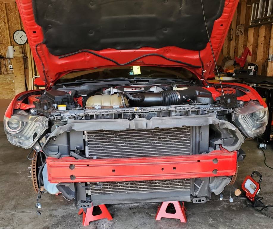

Well, this sucks. The aftermarket wheel well liner doesn't fit worth a darn. I'm not sure even a lengthy session with a heat gun would get this thing into the proper shape. At least the other pieces fit fine.
I've never tried Rock Auto's return policy but I have bought a whole bunch of stuff there over the years. Hopefully we'll get this sorted out. I knew I should have just ponied up for the OEM version from the dealership.

As for the headlight assemblies and even the fog lights (if needed), don’t source them new from Ford Dealers - you’re going to lay at least $800-$1k for a new headlight assembly from Ford….
Source out factory headlight, foglight and tail assemblies on this forum classifieds or even eBay. You can gets front headlight assemblies for like $150-$300 each depending on year, condition, and who’s selling them. Tails you can usually find for $200-$300 a pair, again depending on year, condition and who’s selling.
As for the fender liners - this applies across all years of Mustangs; usually the aftermarket repops don’t fit because they cannot replicate the liner to exact specs as the Ford contracted part…. The original parts are usually protected by. patents, copyrights and other laws that the aftermarket cannot replicate to a ā€œTā€ā€¦. So the aftermarket cuts corners or does very minimal design element changes to stay out of court….
Again you can source original Ford parts used from a variety of sources again such as here from folks parting cars or converting S550’s into race cars and don’t need those parts, eBay, and also check out LKQ which is a large parts source for used, take off and overstock of original equipment vehicle parts. You can also reach out to The Parts Farm who also has a large selection of used Mustang parts. I’d you’re looking for new, LMR has an excellent selection of new Ford parts too.
If you insist on genuine brand new Ford parts, hit up @LevittownFordParts on here who is great with helping the community here.

The genuine Ford fender liner I ordered over the weekend from a local Ford dealership arrived there this morning and I picked it up at lunchtime. I was planning on installing it after work today but it's in the 90s and humid so maybe not.
I long ago stopped trying to save a few bucks by buying lower quality tools because it always ended up costing me more in long run when the cheaper tool would break or not work properly and I'd end up getting the better quality one after that. Now I just skip the first step.
I need to remember this for replacement parts too... sometimes OEM is the right way to go.
I've been keeping an eye on ebay for headlights and guys are still asking $350 per light despite them having 2 or 3 broken mounting tabs. Thankfully the taillights are good and the fights and turn signals are aftermarket but I think they are working fine. Famous final words for $100 Alex.
At this point, I really do see the light at the end of the tunnel for making this car right, and this time it's not a freight train or a bullet train! ;)

I decided to just ignore the heat for a bit and install the Ford wheel well liner. It went is as easy as you please. No fuss at all.
I now have the front end put back together with everything replaced that needed to be replaced. Except the headlights. Until I come up with a permanent solution, I am at least going to polish the lenses on the ones I have so they don't look so awful.
I do believe it's time to put down the tools and just drive again for awhile!

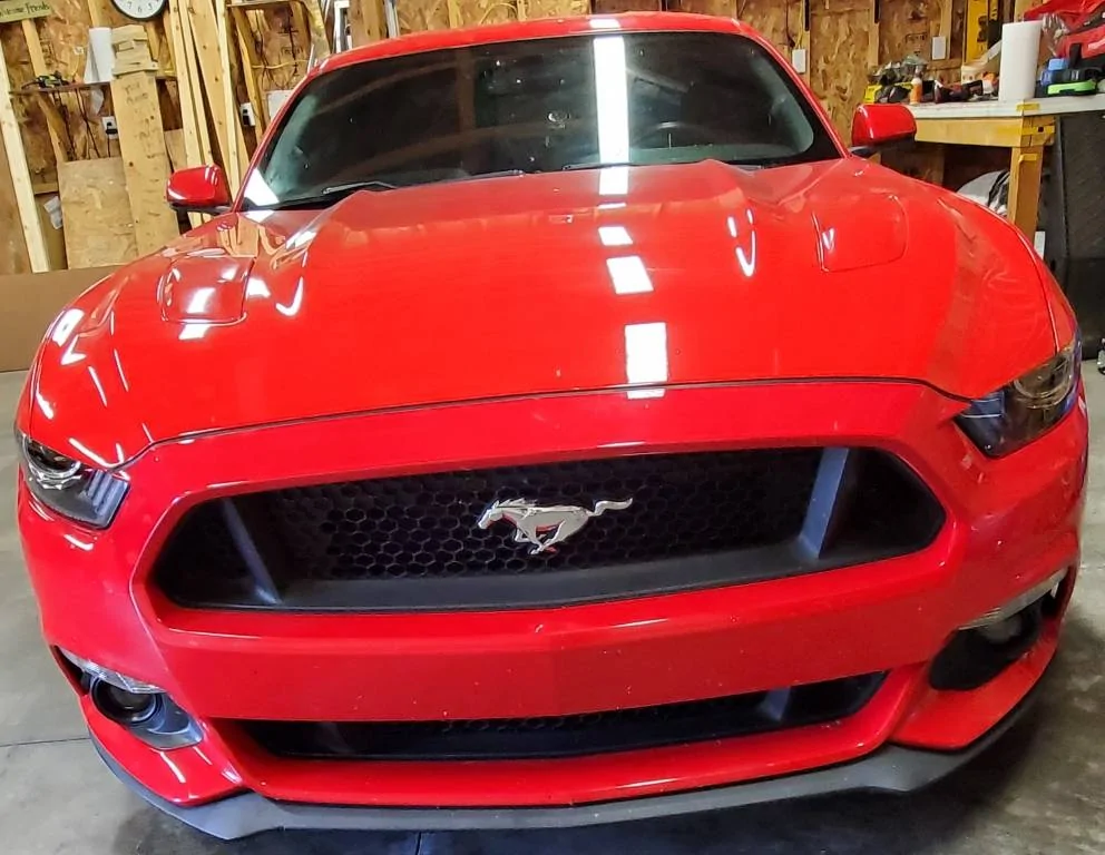

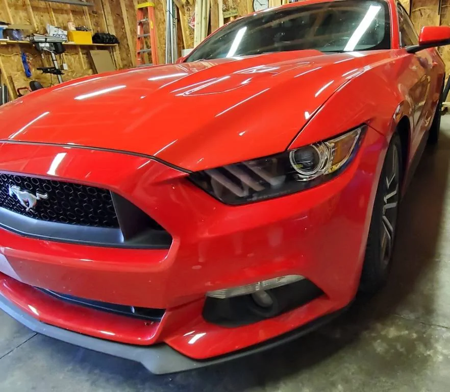

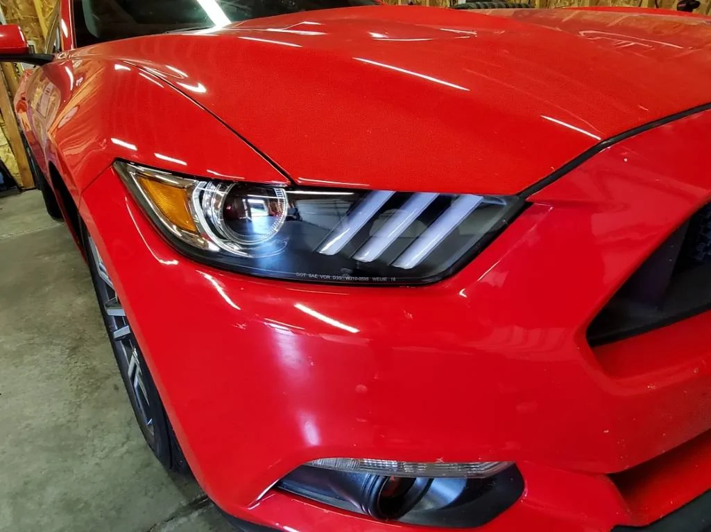

Last week I ended up rolling the dice on a new set of inexpensive eBay headlight assemblies to replace the trashed headlight assemblies that were on the car when I received it. They arrived this morning and looked okay to me so I decided to install them. I'm sure they're not as superb a quality as the $1000 per side OEM ones but I can live with that.

While these eBay headlight assemblies look good, they do a sub-par job actually generating a decent light pattern with brand new Philips D3S 4300K bulbs. The passenger side light pattern has a bright vertical stripe about 1/4 the way across the pattern and both the driver and passenger sides have a dull, washed out beam that does a poor job lighting the road.
I may have to revert to OEM ones, if I can find a decently priced passenger side one. I don't feel comfortable using these eBay specials at night out where I live in the boonies.
