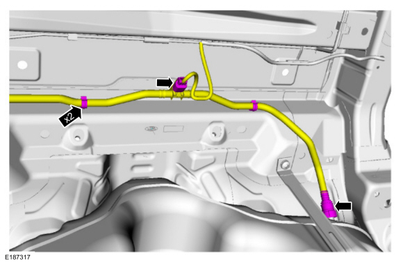

Thanks,
This appears to be part of the vapor canister https://parts.levittownfordparts.com/oem-parts/ford-vapor-canister-fr3z9d653j
In this image you can barely see the electrical connector
https://www.ecat.dealerconnection.com/images/upload/jpg/PRTIMG/CX25/CX2525-RIT.jpg
- Benny
I did recently replace the entire EVAP canister assembly with this one, that includes the vapor canister vent valve. I think it took a few hard knocks when I first got this Mustang and did not know it had an E85 tune on it. I put regular fuel in it, and it coughed and spit fuel out the exhaust and did not run for several months. That can't have done the evap system any good at all.
I think the part you are pointing to is this vapor canister vent valve, not the fuel tank pressure sensor. Bu I could be 100 percent wrong! My understanding is that the fuel tank pressure sensor is a separate sensor, is part of the fuel vapor tube assembly and is mounted above and ahead of the differential. But that may be old/incorrect information I have encountered in other places. That'd be great if it really is part of the EVAP vapor canister assembly.

It looks like it is in the vapor line from the tank to the charcoal canister .
Regardless, right now all the radiator hoses, tubes, water pump, thermostat housing, belts, etc are all on the workbench waiting for me to reinstall them. I'm chasing down the right AC compressor clutch holder so I can remove the 10 mm bolt in the center of this clutch, then hopefully the pulley will come out without too much grief. Just getting those 10 year old radiator hoses removed was enough fun for this cowboy today. I'd forgotten how many French swear words I know. It really widens my ability to fully express myself when working on Oliver.
Id like to check the canister part number via your VIN. Your correct that would be a canister vent valve. The Vapor line includes a transducer which might be what were after, I need your VIN for this as there is a split in 2016
Thanks,
Benny
Benny, DM sent. Thanks!

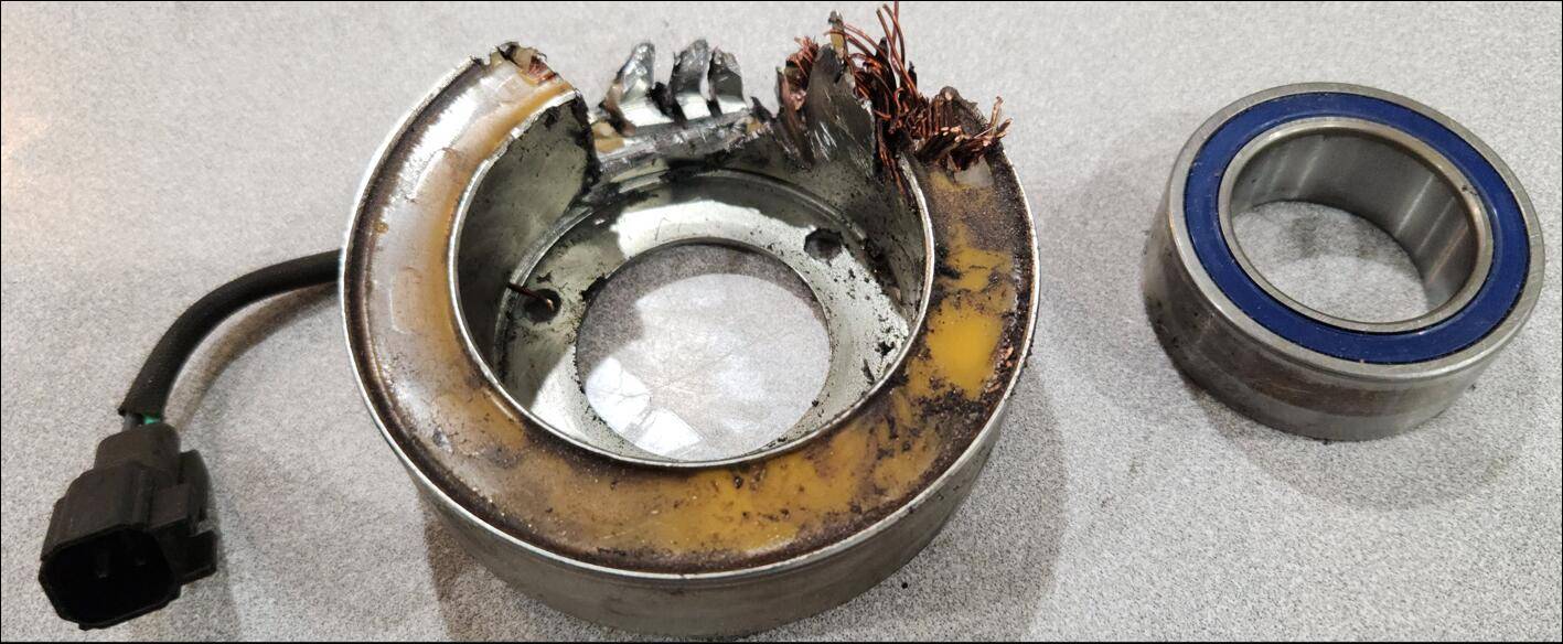

I'm off to not too bad a start at some necessary and preemptive work on the red-headed problem child.
I have the new water pump, thermostat and most new hoses reinstalled, at least the ones that are not in the way of the AC compressor work. I also decided to replace the inlet and outlet hoses on the oil cooler because they are looking a bit worse for wear. Unfortunately they won't arrive until Tuesday.
But geez, is replacing the AC compressor clutch, pulley and coil a treat. The videos and guides I watched/read about this job all mentioned that there is a snap ring that needs to be removed in order to remove the pulley. No problem, I have a very good pair of snap ring pliers. Unfortunately, I discovered they are about 3 inches too long to be used to remove the snap ring on the pulley. I'll grab a shorter pair and give it another go tomorrow. But at least when I was searching for them, I also found my misplaced Tekton 1/4" drive 20-200 inch pound torque wrench I bought a few years ago.

Some progress has been made, but of course not without Oliver kicking me in the shins and higher at every opportunity. I'm a Tubthumper through and through. You can knock me down but I guarantee I'm getting up and coming back harder.
I did get a shorter set of Irwin snap ring pliers that let me remove the O-ring. Now to remove the pulley using the puller. I have 4 sizes so I was certain one of them would fit, and I was correct. That part is good. The part that wasn't so great was that when the pulley was pulled off, the bearing that was supposed to come along with it remained firmly in place on the core. The challenge is that the bearing is now blocking the three Philips head screws that need to be removed in order to remove the coil, or whatever that almost toilet donut looking ring is called. I had used liberal amounts of various penetrants on all these parts before starting out, but stuck is stuck.
I found nothing I could use to fit in the 1/4 inch gap between the outer part of the bearing and the inner part of the stuck core. Okay, lets try a Dremel with a good metal cutting disk. No good, the stranded wire in the core tore the cutting disk to bits. Alright, let's be extra careful and use the full size Dewalt grinder with a cutoff disk. This worked much better but I could not cut through all the way to the back of the coil, at least not without having a high likelihood of making the situation a whole lot worse. I just kept grinding slots, then using vice grips to bend and break the off. Eventually I removed enough material that I was able to get to the stuck bearing. Break time. Then back at it to patiently and gently tapped the bearing on various spots front and back to break its hold, which finally did happen. Well, that was easy.
I now have the new compressor clutch kit with o-ring installed. I'll put the new compressor belt on tomorrow, as well as button up the rest of the cooling hoses. The new engine oil cooler hoses that were not supposed to arrive at my local Ford dealership until Tuesday actually arrived today. I'll pick those up tomorrow too.
And for the few clips I broke when removing various evap hoses, I was given a Dorman part number for 1/2" clips that are supposed to fit. I got four of them, hopefully they do the job.
