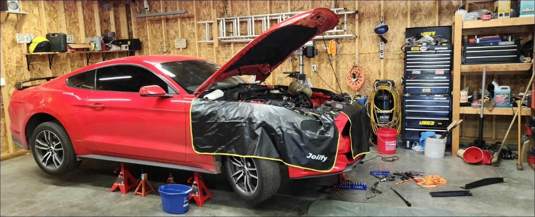

I am off until Wednesday so I figured this would be a good opportunity to tackle the AC repairs. Yesterday I had the refrigerant professionally removed so I am good to go. All the main parts had arrived by yesterday and the rest arrived today. Plus I received 8 Vevor magnetic socket trays to help me reduce the time I spent trying to find sockets. I also need something like a utensil tray for the metric and SAE wrench drawers so I can keep like-sized wrenches together.
Four 6 ton stand with four 2 ton stands and a 6 ton hydraulic jack under the rear carrier for backup. The Steeda full length ultralite chassis jacking rails are such a handy thing to have!

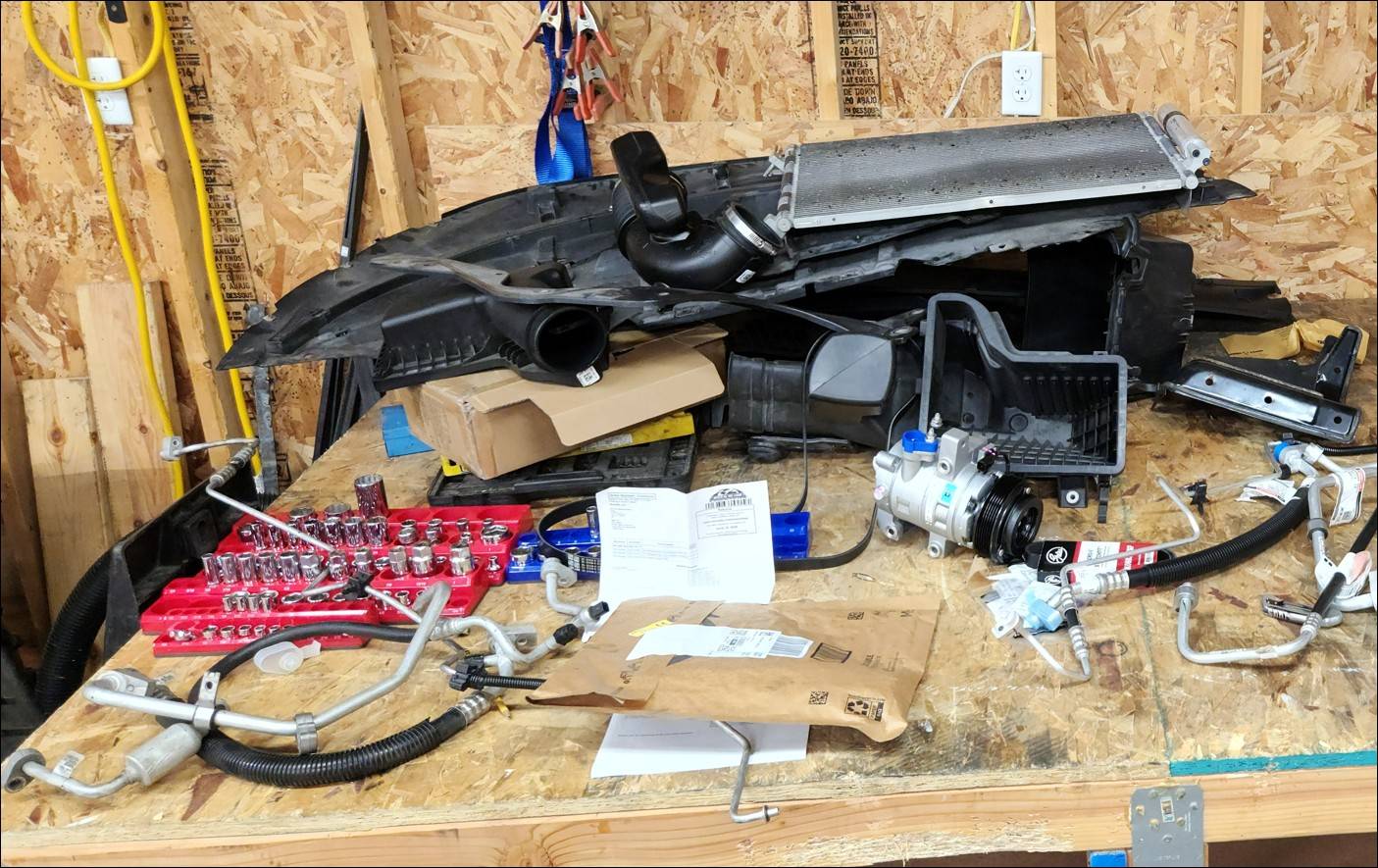

The pile of parts I have removed is growing. I am certain a pro would not have to do this, but I'm feeling my way along, along with help from Mustang6G threads and Youtube videos.

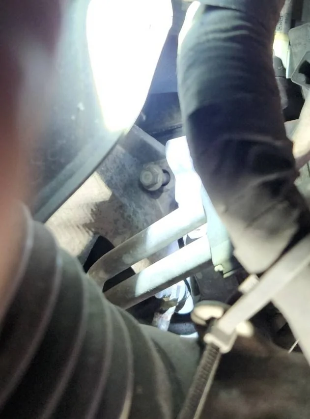

The bigger concern is a 13 mm head bolt I found on the passenger side that is backed out about an inch. I'm not sure yet what this bolt secures, but I intend on doing my best to tighten it during this project. To me, it looks like it goes into the block. I did have a brief go at tightening this bolt but I just could not get a good angle on the head and I don't want to chance stripping the head.
I have managed to remove everything except the compressor itself so far. I think the biggest PITA was the very wiggly evaporator to condenser tube. I think installing the new one is going to require all the patience I can muster.
And I know there are three long bolts holding the compressor in place but I have not yet decided my plan A for reaching them. Maybe if I remove the front passenger side tire and wheel well liner, it will give me a better angle because right now I can't even see the three bolts I have to remove. But I do know where they are, so maybe this time me fumbling around in the dark will lead to a happy outcome.

That bolt sticking out would be a motor mount bracket bolt !

I removed the front right tire and wheel lining both to a) hopefully get more angles at the various things I was trying to reach and b) retrieve the 3/8" extension that fell down the opening behind the front fender. D'oh.
I was then finally able to loosen the three bolts holding the compressor in place. One I was able to remove with the compressor still in place but the other two had to stay in the sleeves in the compressor until I could finagle it to a spot with enough room to remove the bolts. This means I have now removed all the old AC pieces (except the extractor, not touching that with a 100 foot pole!).

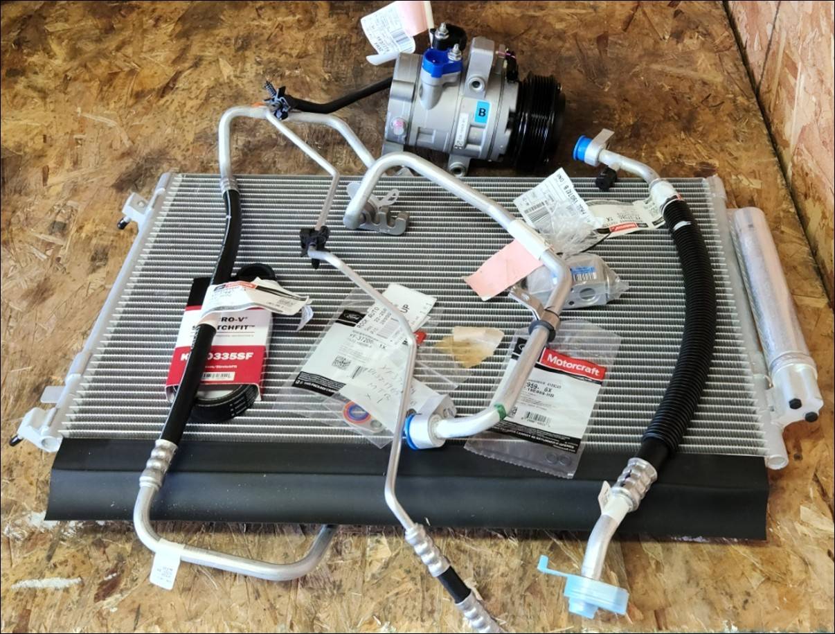

Just to end the day with the job heading towards completion, I installed the new Motorcraft condenser and drier. Next up is flushing the extractor, but not today. Geez this job is a gigantic PITA.
The good news is that once the compressor was out of the way, I was able to get a 3/8" air ratchet in where that loose motor mount bolt was hiding and tighten it up. I'll check the torque specs on it later. Makes me wonder if any of the motor mount bolts are loose on the passenger side. You'd think these bolts would have some Loctite on them from the factory, but maybe the previous owner pulled the motor for some reason.
I think I will run a few of the new hoses before I install the new compressor. It might be easier without it in the way. At least that'll be my plan A.

Oh, I just had a horrible thought that the loose motor mount bolt was not the right one, that it was actually too long, and that by me tightening it, it just went right through the wall of the block. It would certainly be on-brand for this car from "Mint" Auto Sales in Orlando, Florida.

If you don't have a few select impact swivel sockets I suggest you get some. Not the crappy chrome ones that come with tool sets from HF etc.
Pull the bolt that was sticking out and use a non black zip tie to mark the length of the bolt in question and slide it into the hole. That will confirm one way or another if you were correct. Blue loc-tite wouldn't hurt either. (I THINK...)

The Motorcraft compressor I bought came pre-charged with the correct amount of PAG. I think that since I also replaced the condenser, drier, hoses and expansion valve, I need to add several more ounces. I also saw that this can be done when the AC folks are recharging the system so I am going to leave that up to them. I am just not turning on the compressor before that. Hopefully that doesn't cause any grief, but that's where things are.
