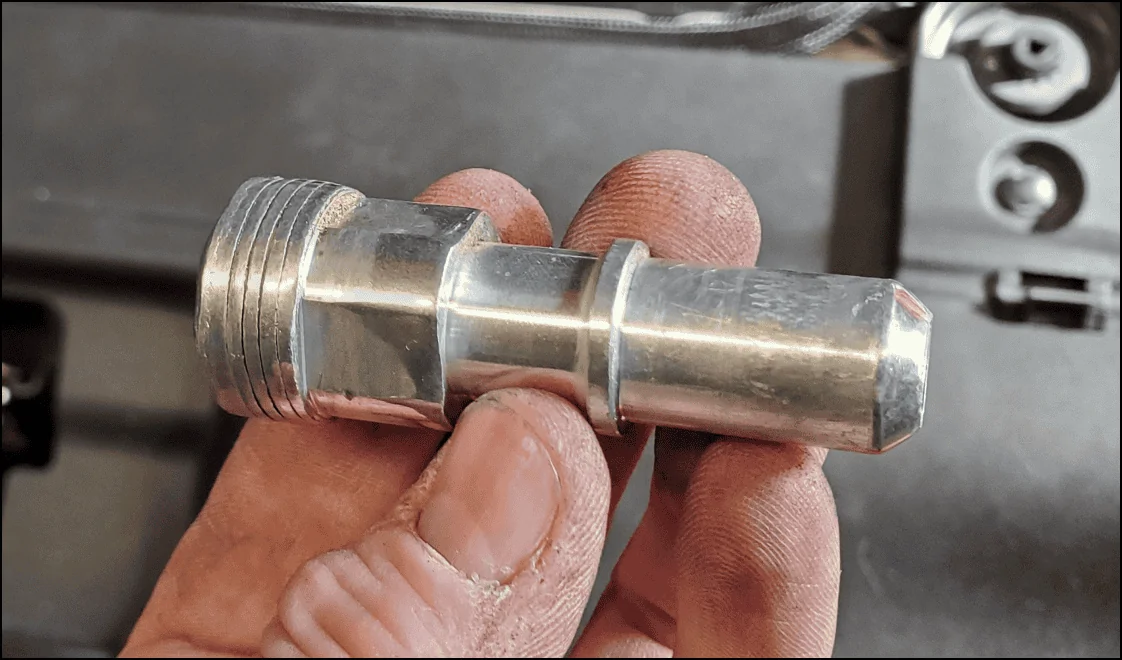

Of all the things with this car, I'd really, really love to know how the cold air nozzle (if that's what it is) ended up on top of the valves for cylinder number three. That's not exactly what one expects to see upon removing the intake manifold.

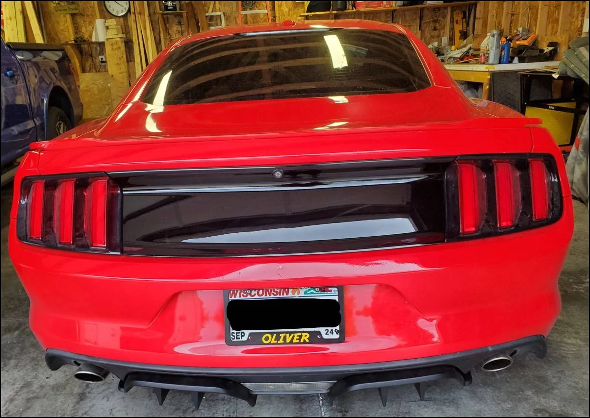

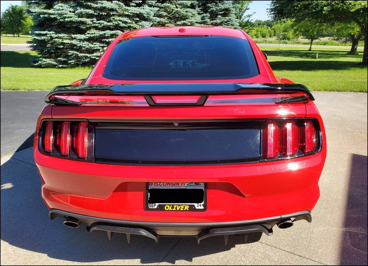

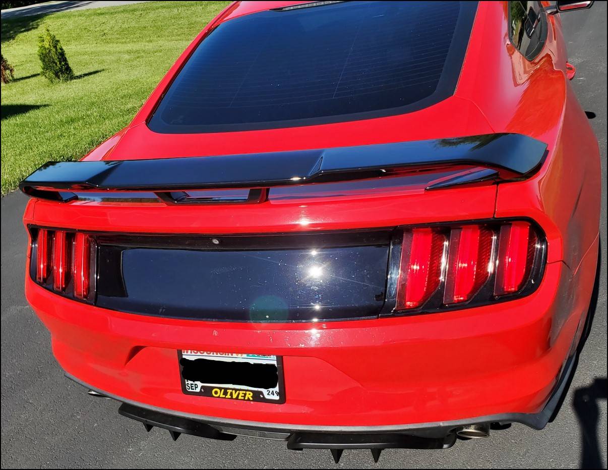

After unsuccessfully trying to locate an MMD Foose rear spoiler, I decided to pull the trigger on a performance pack style one from American Muscle.
Getting the OEM blade spoiler and related adhesive off was about as much fun as I expected, maybe a bit more. About one square inch of paint pulled up under the passenger end of the blade right where one of the threaded studs is. This area is covered by the end of the PP1 style spoiler so I just taped off the bare spot, prepped it, then sprayed it with primer and a red that's reasonably close to Race Red. Good enough, considering it's covered by the replacement spoiler.
There was still the fun of having to drill the end plate for the posts on the cover plates and drill a hole on each end large enough to fit a 10 mm socket. I did touch up the bare metal where I drilled.
Overall, the finish on the spoiler is fine with just a few minor swirls. My biggest remaining beef is with how insecurely fastened the cover plates are on the end plates. On the driver side the two tabs do not do a damn thing to hold the cover plate in place. For now I resorted to strong Velcro to hold it in place. This is only until I can find one of the several roles of good quality two-sided tape I know I have in the workshop somewhere. Or maybe in the basement. But then I was over at my daughter's place working on some things for her. And just how long has it really been since I've seen these rolls of tape? The years and projects tend to blend together.
Overall, for now, I'm just giving this mod a 6 out of 10. Visually it's a meh and quality wise it's just adequate.
Maybe I'll try prepping and spraying the blade spoiler I took off gloss black and see how I like that look. Or not, time to just drive it again for awhile.

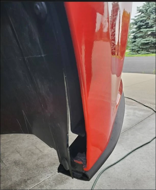

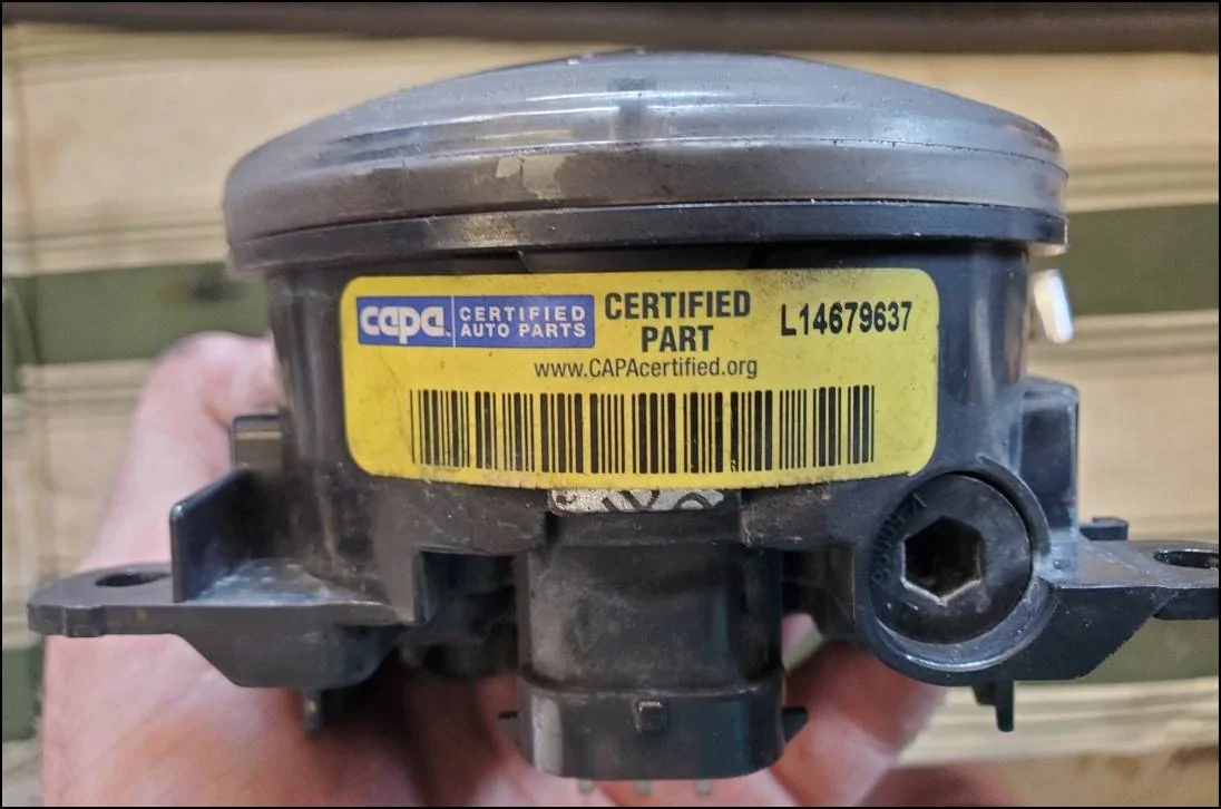

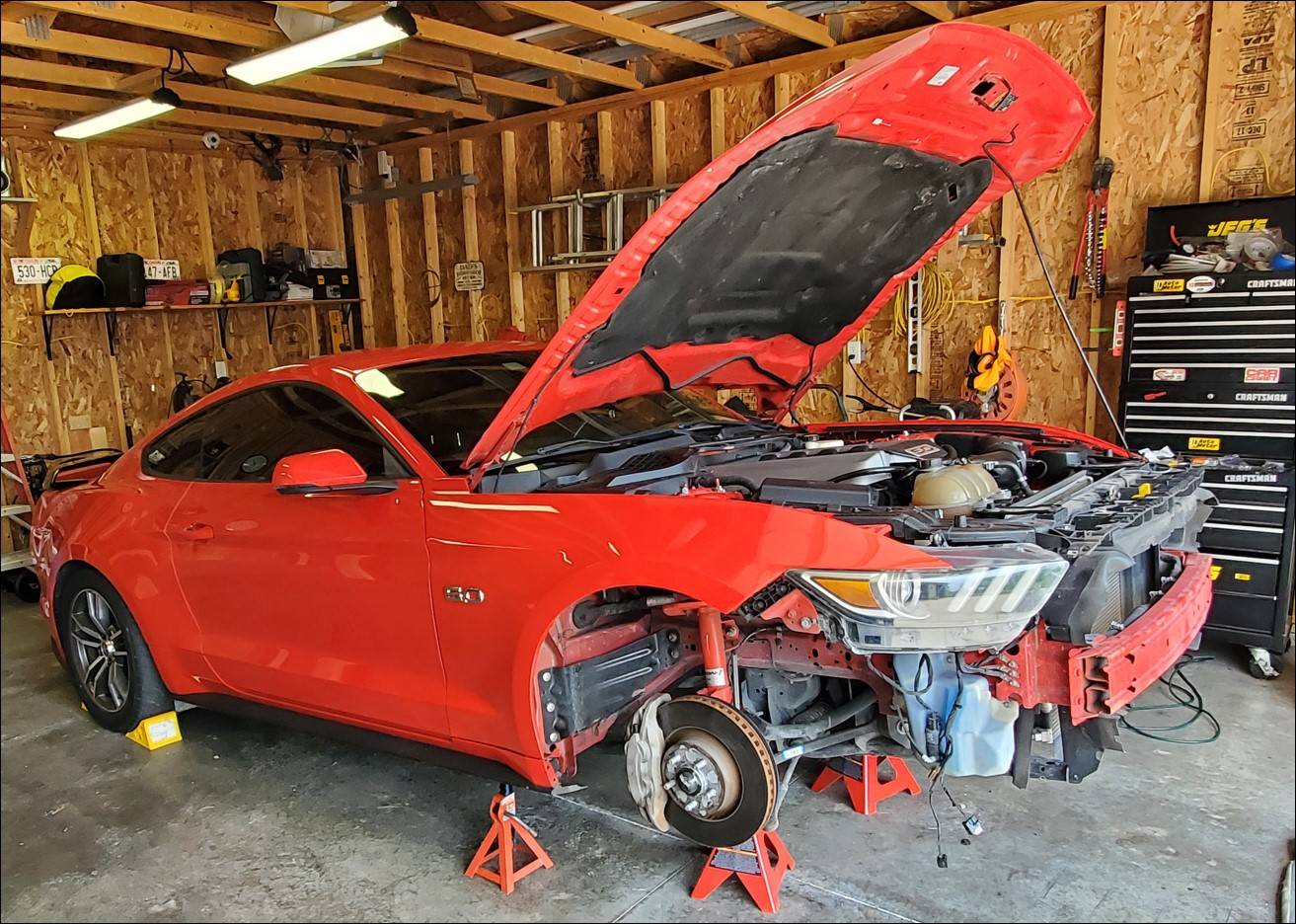

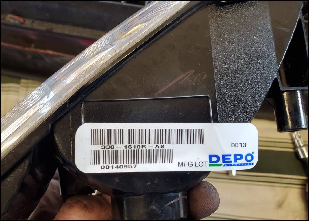

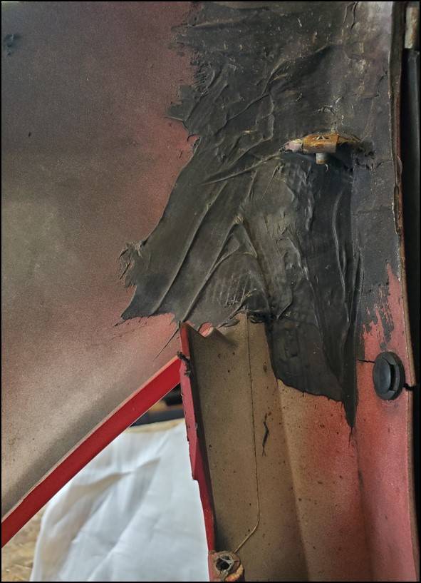

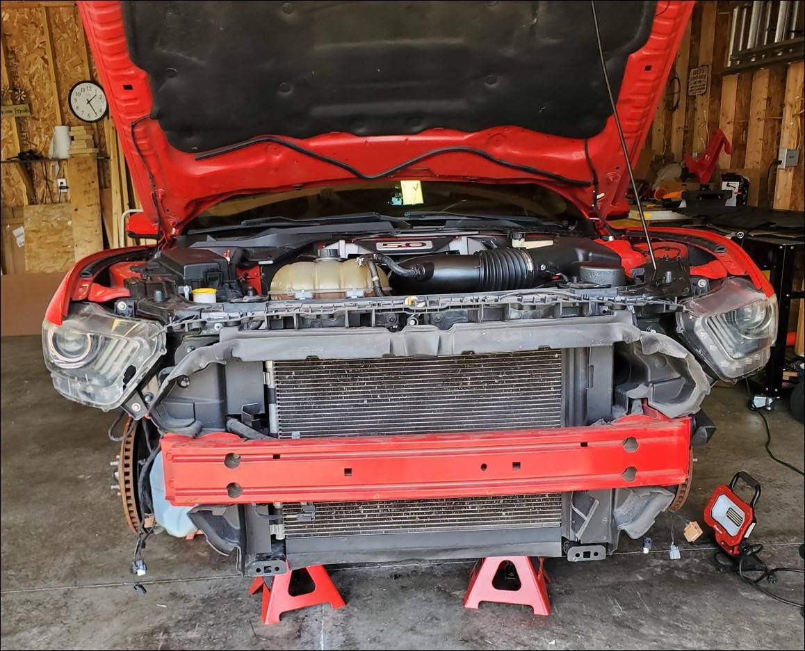

It's a beautiful Saturday morning, time to remove the bumper cover and see the extent of damage being hidden. CarFax reported no accidents before purchase but the best it can really claim is no reported accidents. I can tell that at some point Oliver had a run-in with something on the front end passenger side. The main symptom is the passenger side fender clip does not securely hold the fender in place. There are also a few mounting tabs missing on the passenger side, including one on the fog lamp bracket and another on the passenger side wheel well liner.
Knowing this, I ordered a replacement fender wheel well liner, fog lamp bracket and fender support brackets for both sides so I'd have these parts on hand when I got time to remove the bumper cover.
And away I went.

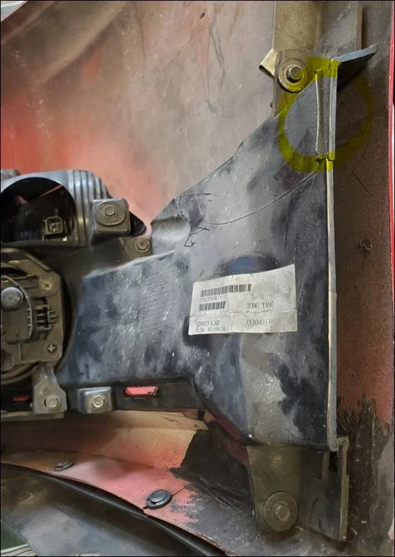

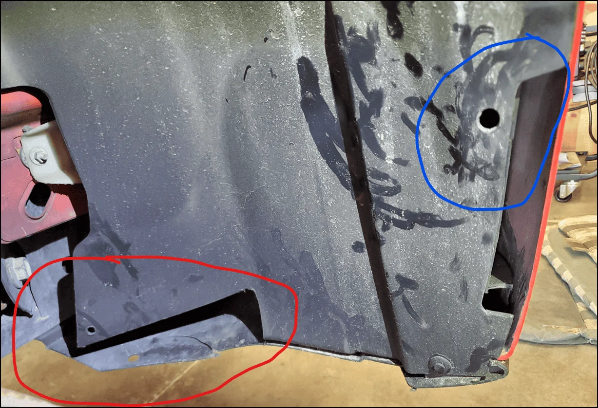

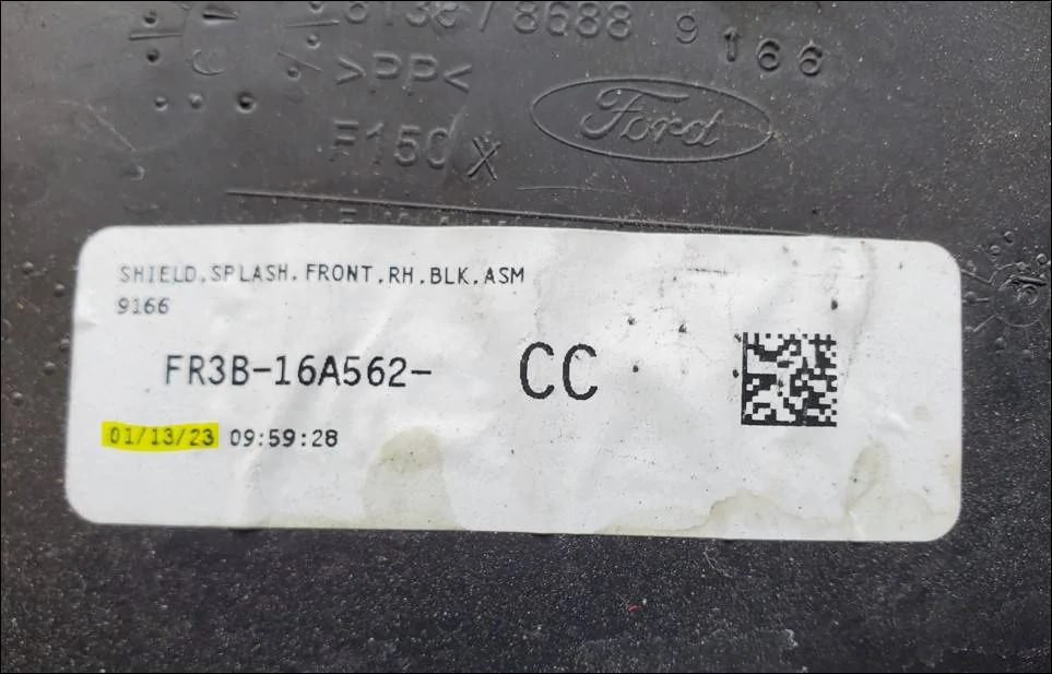

The first thing I saw when removing the passenger side wheel well liner is the manufacturer date on it of January 13, 2023 . Unless Ford was stamping parts in 2016 with a 2023 date, I do believe this wheel well liner is not original. So the previous owner removed the original wheel well liner and replaced it with the one on it now, and also hacked it up in places for some reason. Interesting.

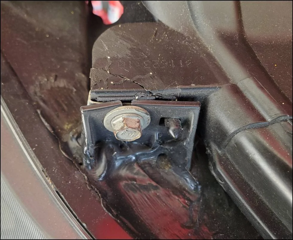

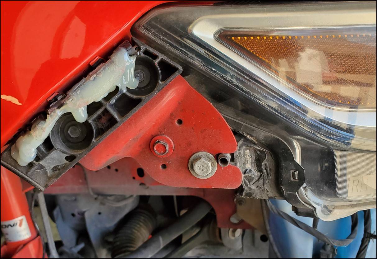

Second, the fender support bracket is a mess. It had a bunch of stuff that hardened like concrete slathered on it. I also noticed Race Red over-spray on the support bracket, meaning to me at least that the passenger side fender was re-sprayed. Spotted some messy repairs made to the passenger side headlight bracket.
Ah, and this might explain the spiders, other insects and moisture inside the headlight. Not sure if this will buff out or not.
And a missing mounting tab on the fog lamp bracket on the passenger side that the wheel well liner is supposed to connect to.

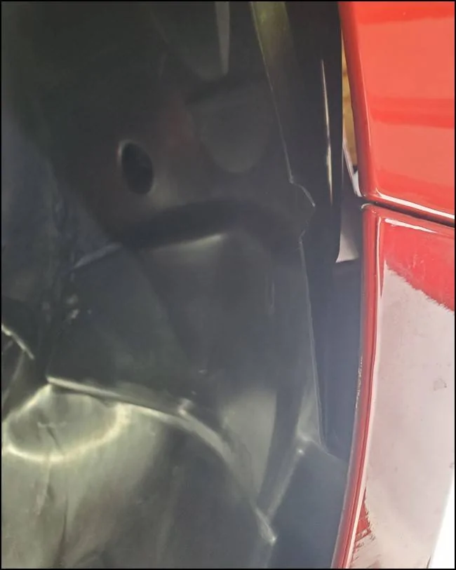

I did not see any obvious damage on the driver side but both the fog lamp and turn signal light have been replaced.
I won't guess if this is fiberglass or screen door remnants in this repair.

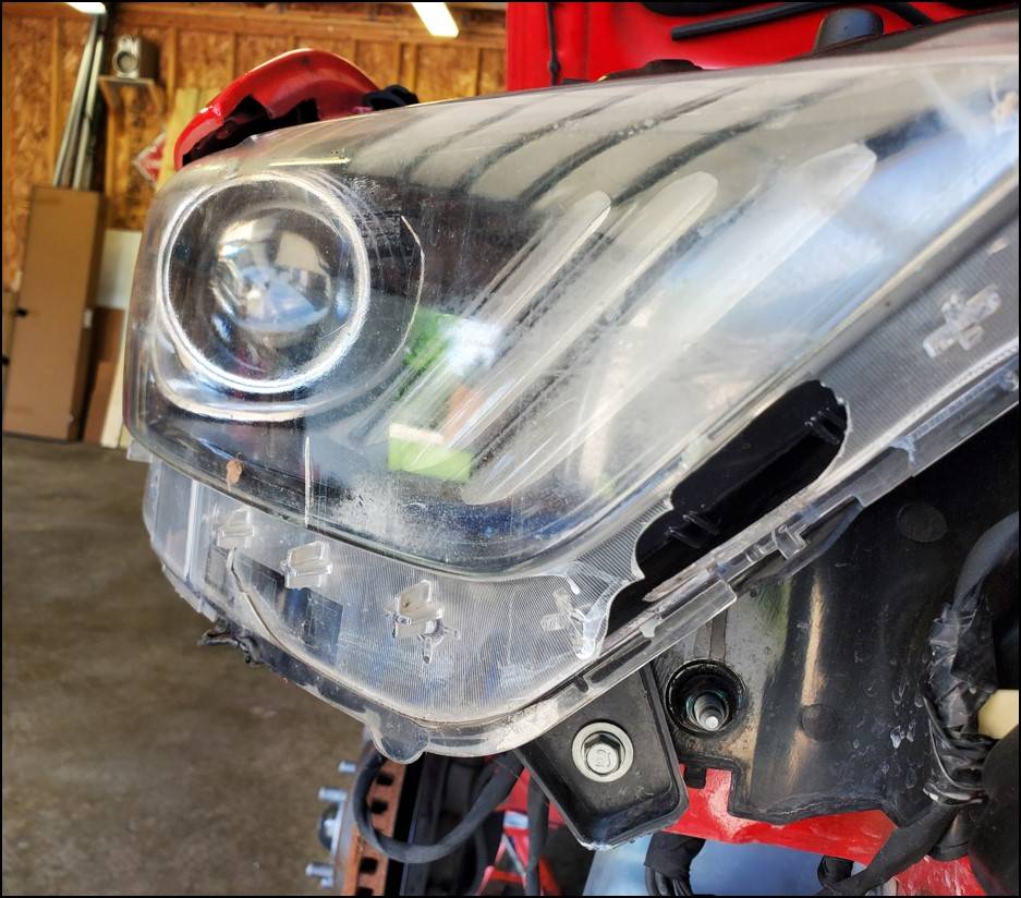

The headlight is the one thing I don't know what to do about. I can't see leaving this as is. OEM headlights are crazy expensive and it sounds like every aftermarket headlight that is not OEM price is junk. I will decide what to do about this part before putting all this stuff back together. Headlight suggestions are most welcome.
Once again, this 2016 Mustang GT is an example of one of the fine automobiles sold by "Mint" Auto Sales in Orlando, Florida. Please, do not let this happen to you. Be smarter and less trusting than me, although in this case I did set the bar pretty low. At least with all the work I have done to this car since last October, it is getting ever-closer to being the mint car I wanted.

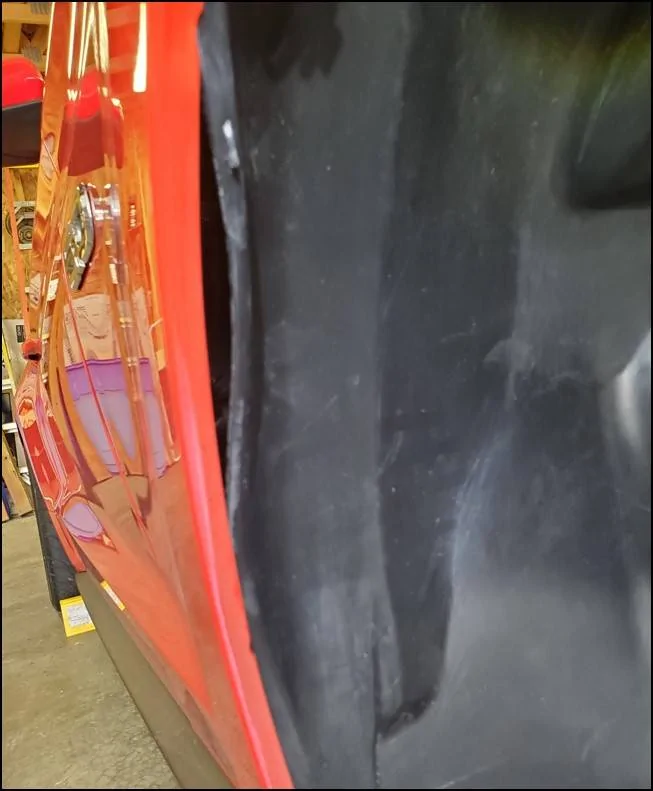

Well, this sucks. The aftermarket wheel well liner doesn't fit worth a darn. I'm not sure even a lengthy session with a heat gun would get this thing into the proper shape. At least the other pieces fit fine.
