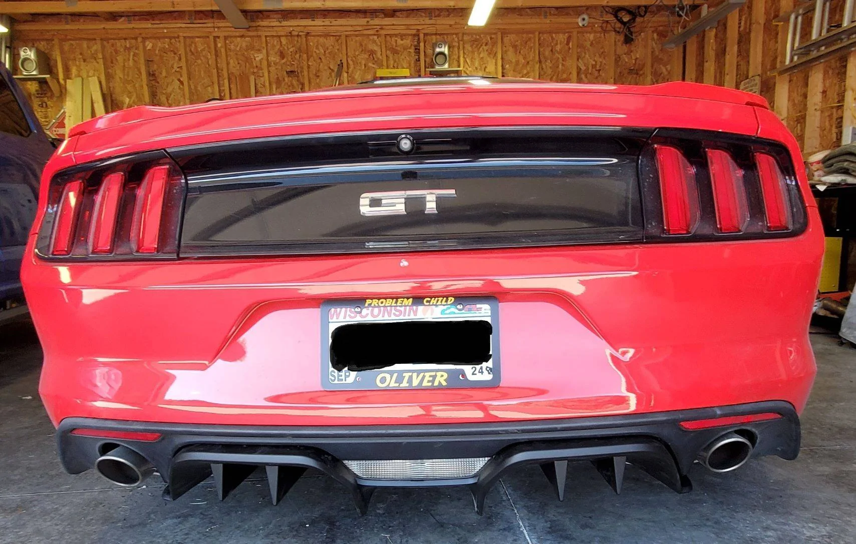

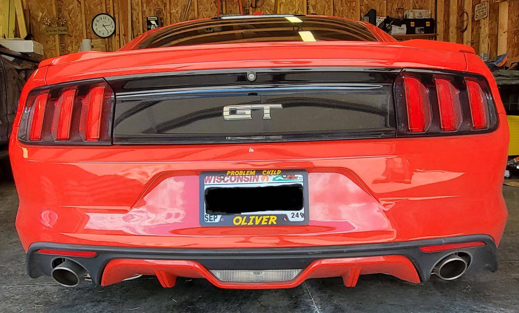

The RTR diffuser from American Muscle went on without too much trouble today.

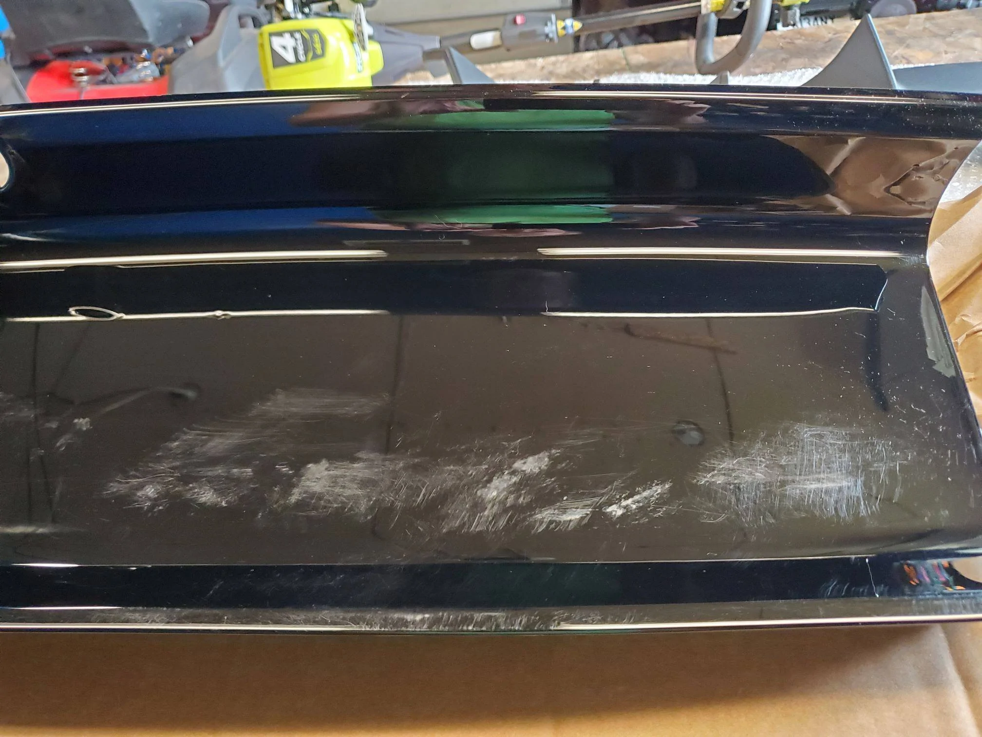

And I shipped back the scratched new decklid panel I got as part of the same order from American Muscle. The replacement is supposed to ship out today. I hope they at least look at this one before they stick it in the box, and I really hope they wrap it in bubble wrap instead of just sticking a tube of paper below and on top of the panel. It does nothing to prevent the panel from moving around inside the box and does nothing to prevent scratches during shipping. The RTR diffuser was well wrapped in bubble wrap and it has a much more durable surface than the decklid panel yet the decklid panel was not properly protected. We'll see. If this one shows up packed like the first one and scratched up like it too, that'll be it for me continuing with them at least for anything body-related or in the least bit delicate.
Before:
After:
Looks great! Glad to see it coming along!

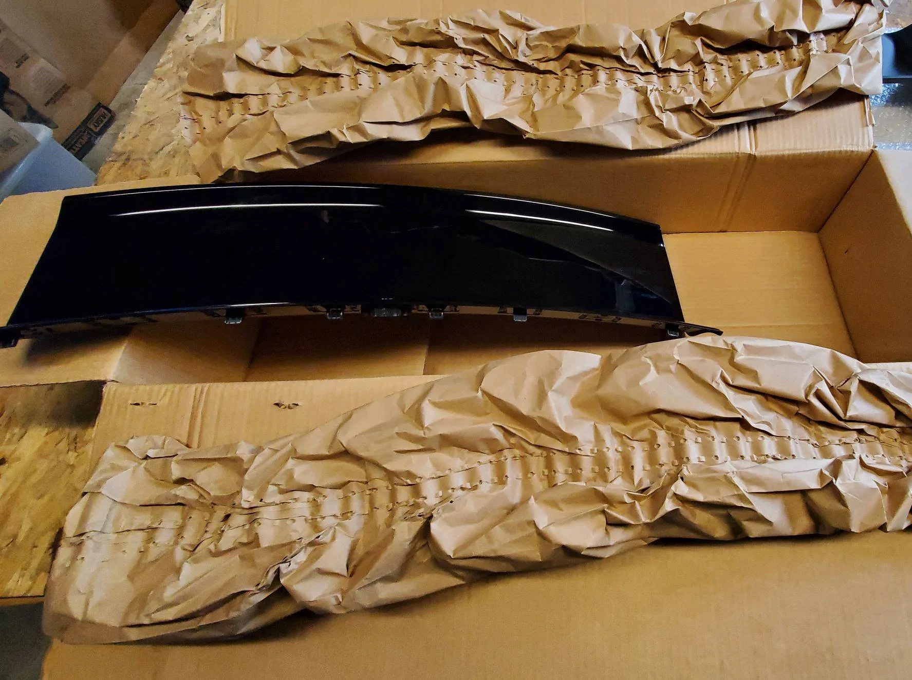

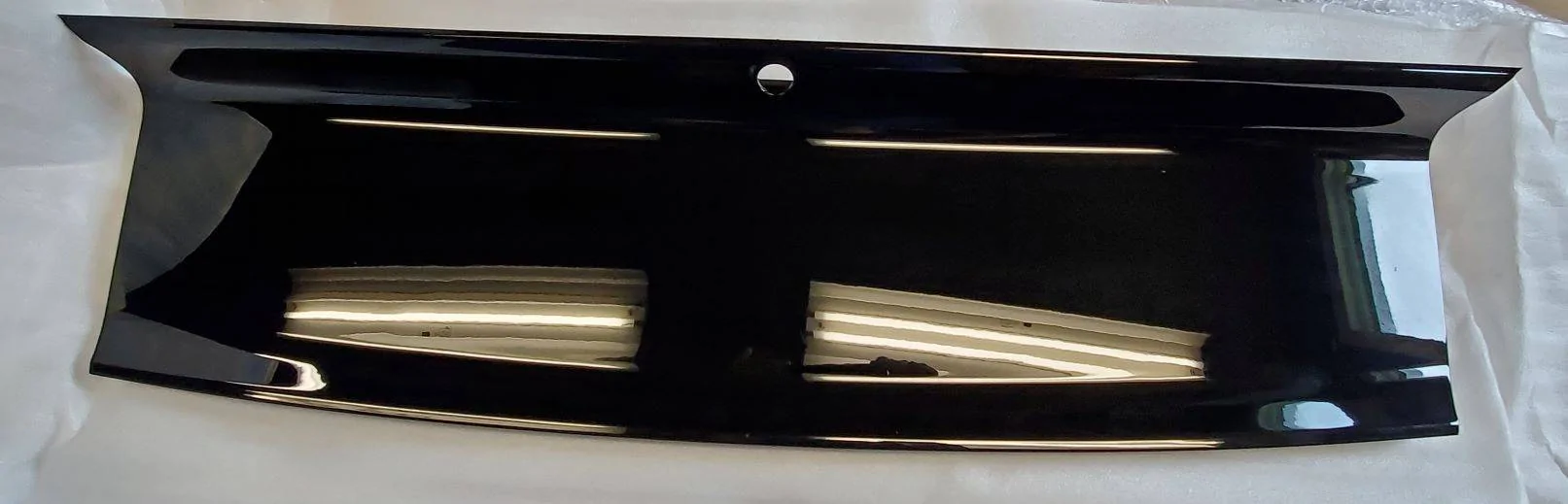

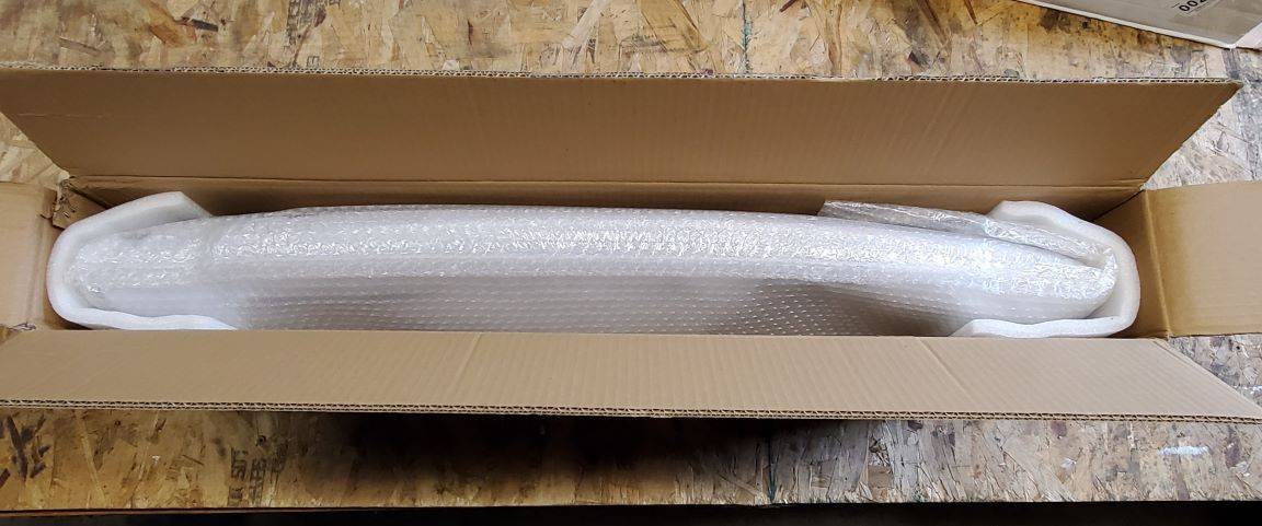

The replacement decklid panel arrived from American Muscle and I am pleased to see that this one is great. I don't know why AM tried to pawn off the previously-installed and damaged decklid panel packed in an oversize box with two pieces of paper to protect it on me, but it was a waste of their time and reputation and my time.
Here's how the first one was packaged and what it looked like on arrival:
And here's how the replacement was shipped in the original MP Concepts box and packaging:
Now to decide if I leave it as is or affix some type of emblem. Which involves making a template and drilling into the pristine surface... I think I like the clean look, much safer.

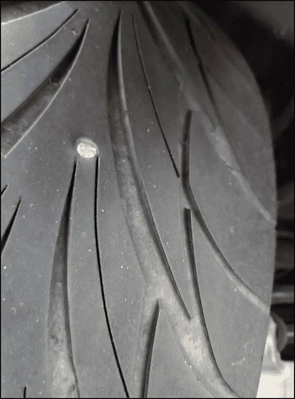

And not end up with something bricked in the process. And with the tire with the nail in it either temporarily patched or retaining air long enough to make the return trip to the dealer. Time to roll them bones and see some boxcars. Note that I did have to Google that to see if double-sixes is generally considered a good thing to roll.
