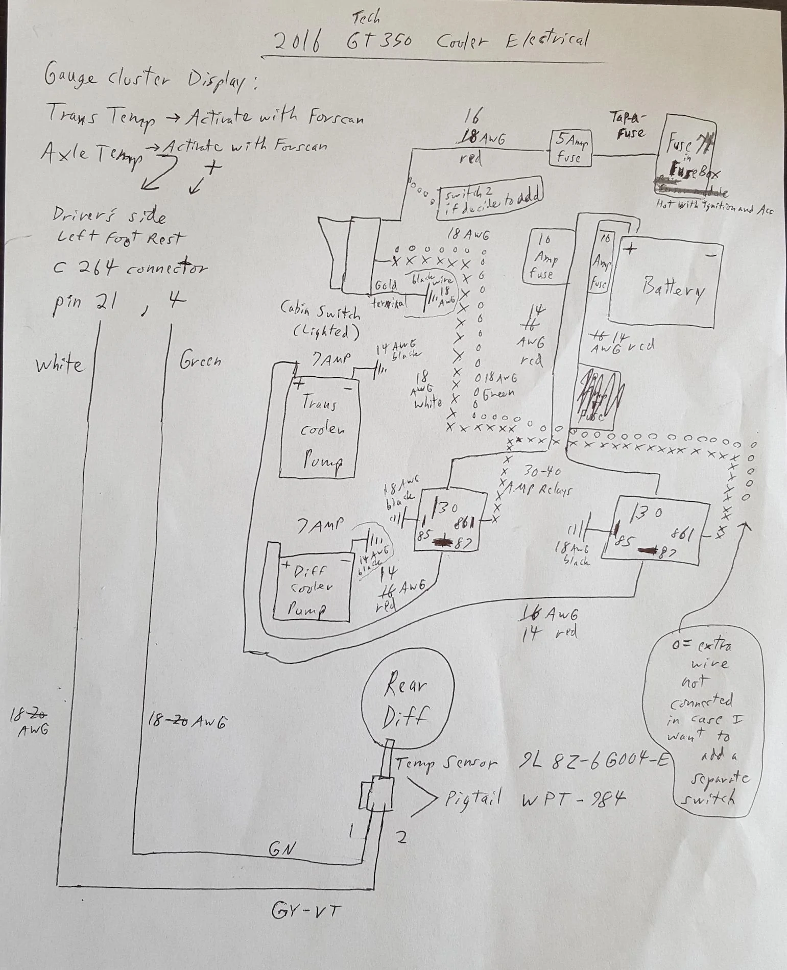

Tech Pack Cooler Electrical Diagram
This picture looks busy, but I summarized lots of content on here with a single diagram. This should enable GT350 Tech Pack (and maybe Base Pack?) owners to see BOTH Axle and Transmission temps in the center gauge cluster and to properly supply power to pumps.
I have mine all simply activated by a single switch (lead "X" in pic), but ran lead "O" along with it (not connected to anything currently) in case I want an independent switch for each pump in the future. With the use of relays each pump is safely on it's own fused circuit either way.

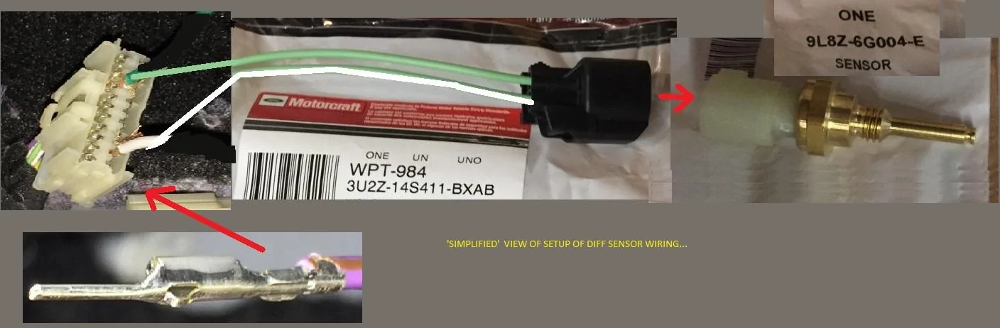

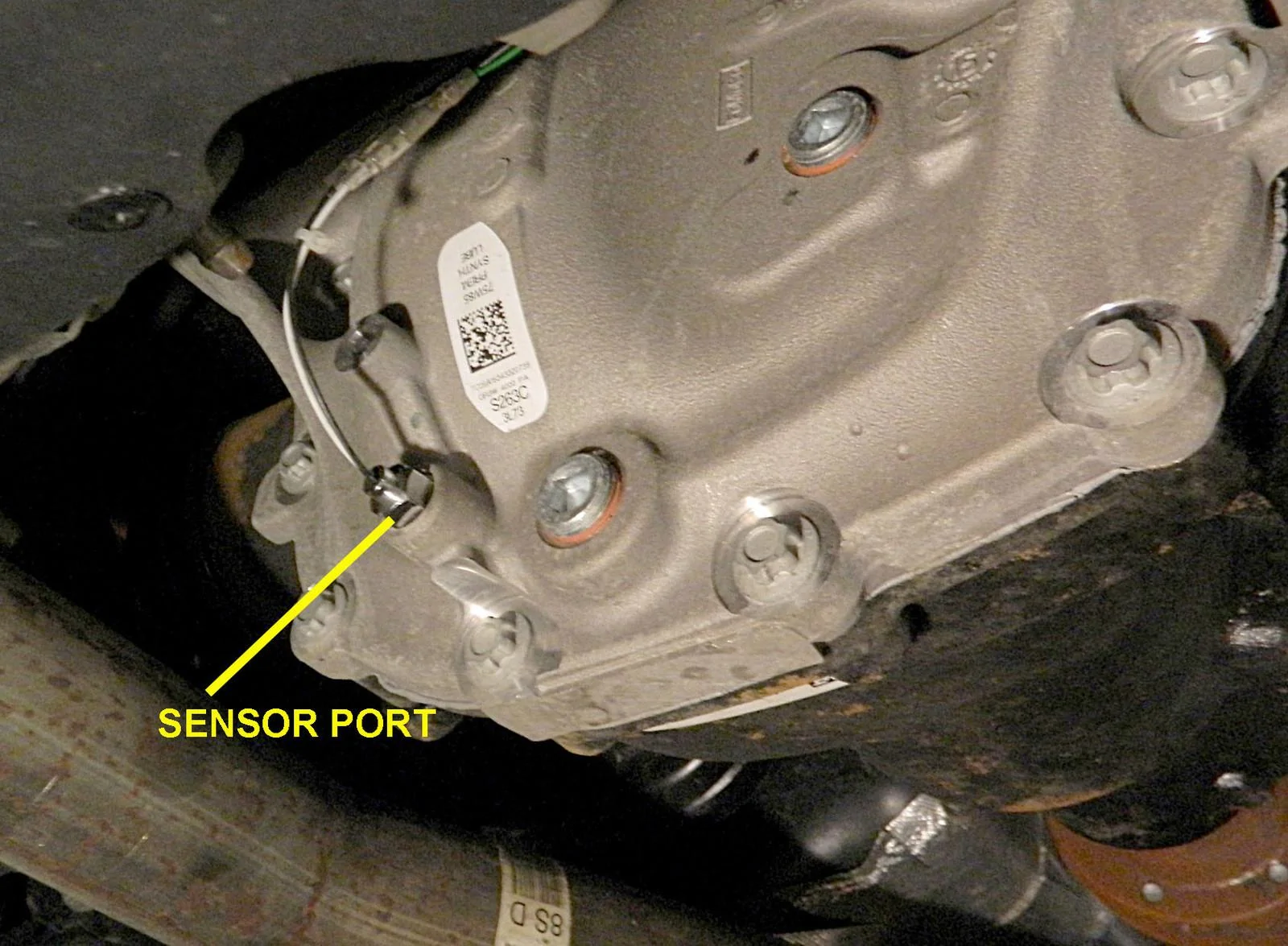

Hey Tank, kgschrader, jwb, rb92gt, cking, Hack, GT_Dave and others..
I have been reading the post on adding the Diff Temp sensor to a Tech Pack car. Really exhausting...I did notice that in the threads it was mentioned that some of you were initially just going to add the sensor to monitor the temps, before you would add the cooler.
I think I would also like to monitor the temps before proceeding with the cooler addition. I have cut and pasted into the attached image what I have understood from this thread is required, please correct me if I am wrong !
2 questions;
Do any of you know the pin connectors that are required to attach the wires from the sensor pigtail to the C264 connector? Where to get?
Can any one add a photo of the Diff cover where the sensor is mounted, preferably if you are not using the Track Pack car wiring harness? DIY.
Really appreciate all the effort that has gone into this thread, you guys are true enthusiasts...
Thanks,
Kev
Here is the sensor port location in the cover, I have an aftermarket sensor installed in this pic . . .

Hey [MENTION=23475]KevDog[/MENTION],
Question 1- I went through Mouser.com and got several types as recommended by [MENTION=29216]jwb[/MENTION].

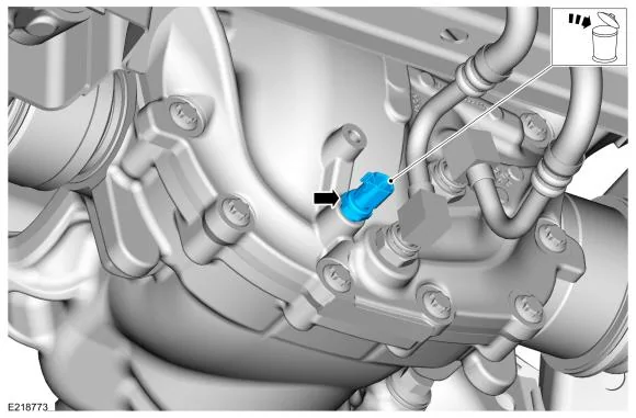

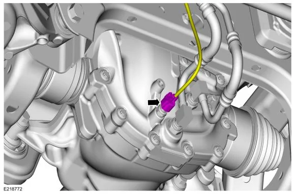

Question 2 - Here's the temp sensor install and removal from the Helm. It has the pics with the lines for the cooler but the threaded socket is in the similar location. Interesting the temp sensor is single use... Good Luck!!
205-02 Rear Drive Axle/Differential 2016 Mustang
Removal and Installation Procedure revision date: 07/29/2015
Differential Fluid Temperature Sensor
Removal
NOTE: Removal steps in this procedure may contain installation details.
Disconnect the differential fluid temperature sensor connector.
Remove and discard the differential temperature sensor.
Torque : 89 lb.in (10 Nm)
Installation
To install, reverse the removal procedure.
