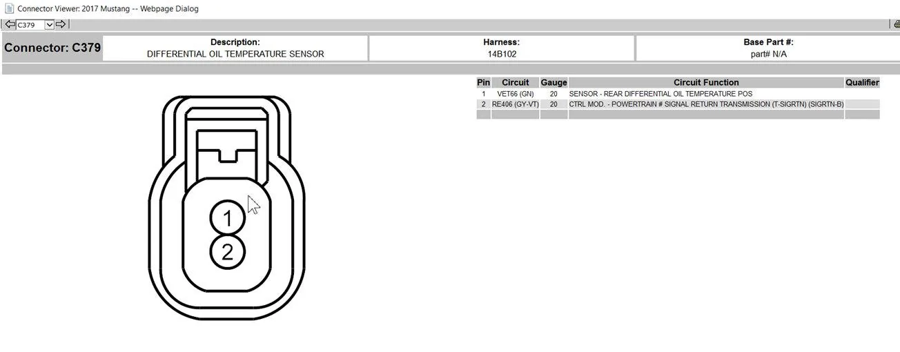

For 20AWG:
Again using the schematic on page 7,
circuit VET66 uses GN; I used solid green (yeah!)
circuit RE406 uses GY-VT; I used solid grey
circuit VYT12 uses YE-GN; I used solid yellow
circuit VYT11 uses VT-GY; I used solid violet

[MENTION=28002]cking[/MENTION],
Could you post a pic of connector C379 (diff temp sensor connector)? I want to ensure correct colored wires/polarity going into C264.
Thanks in advance :cheers:

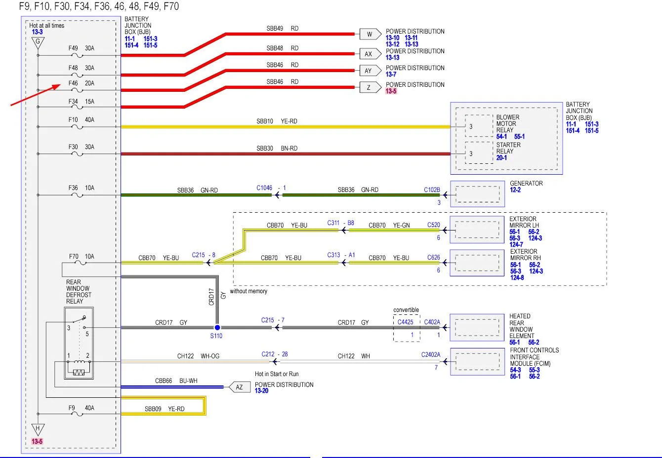

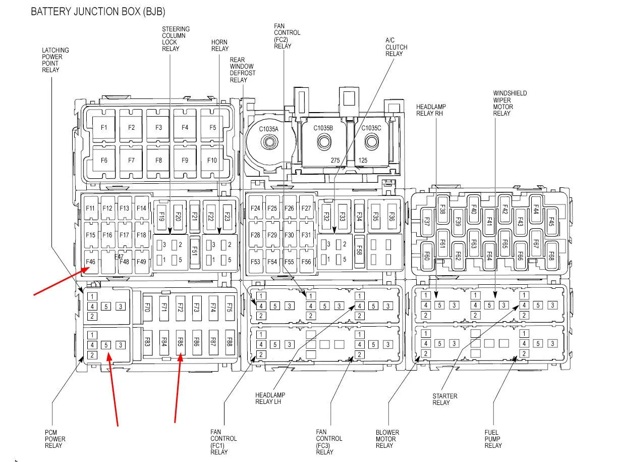

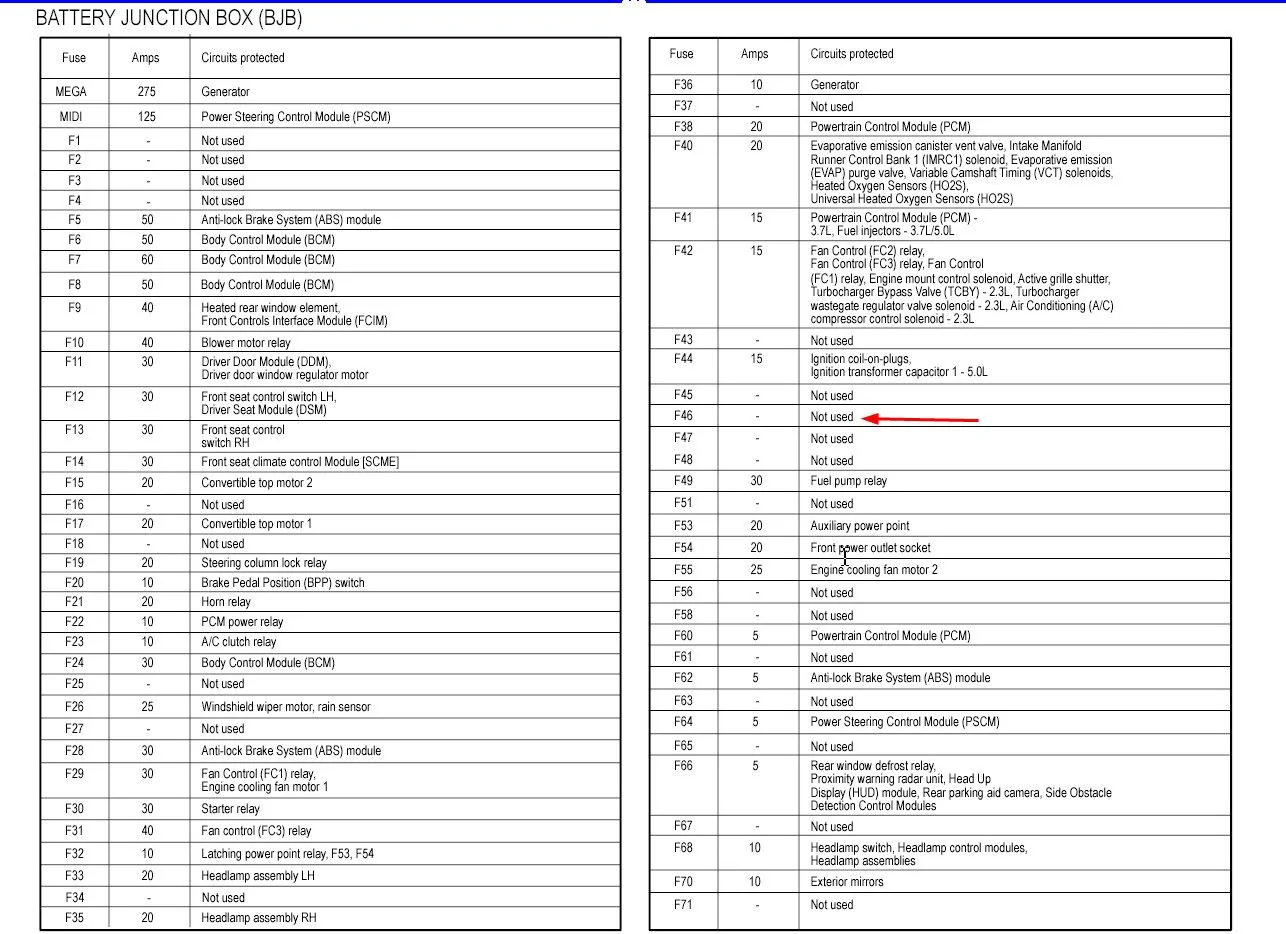

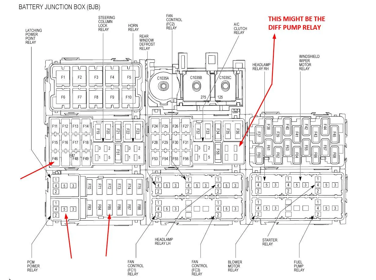

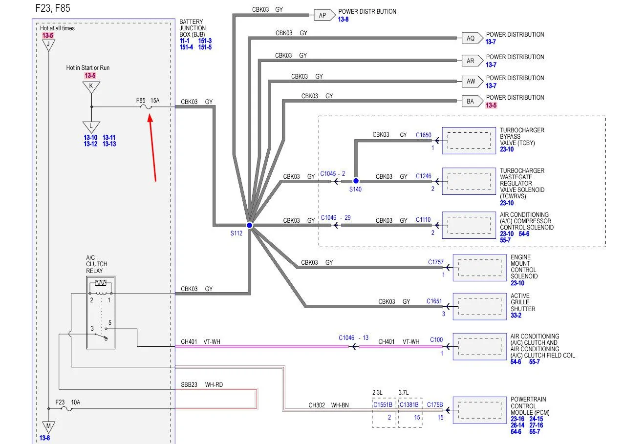

[MENTION=12069]Hack[/MENTION] and I are working through some wiring questions.
I noticed the PCM Power Relay runs through fuse 85. But there is no F85 in the BJB and the owner's manual says it's not used. Also, the schematic indicates F46 is 5 amp but it is really 20 amp (in BJB and owners' manual). If you get a chance will you look inside your BJB and see if you have F85?
I have power to both those lines so I will pull fuses to see which is the correct fuse. Just curious if 17's match schematic.
Thanks,
John

Battery Junction Box
Here is from my 2017 manual

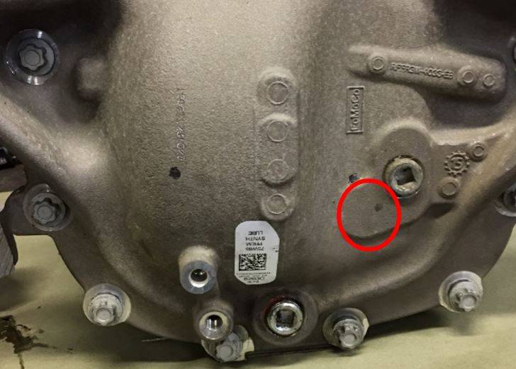

I have the mechanical stuff finally put together and my car is mostly reassembled, so I thought it might be a good time to post a few things that could help others.

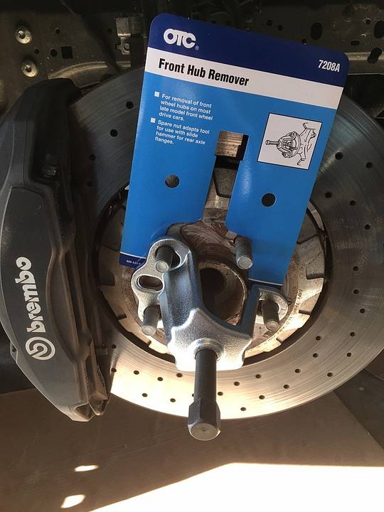

To install the OEM cooling lines and pump, you may wish to remove the rear differential from the car and either modify or replace the cover. In order to remove the diff you have to remove the half shafts. Ford recommends a Rotunda tool, but this one is a little cheaper.
OTC 7208A

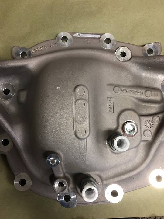

Here's a photo of the track pack diff cover. There's one extra tapped hole and two fittings. So, it would be simple enough for someone to remove the tech pack diff cover and modify it.
And here's the tech pack diff cover to show the difference. I circled the area where the missing tapped hole is located.

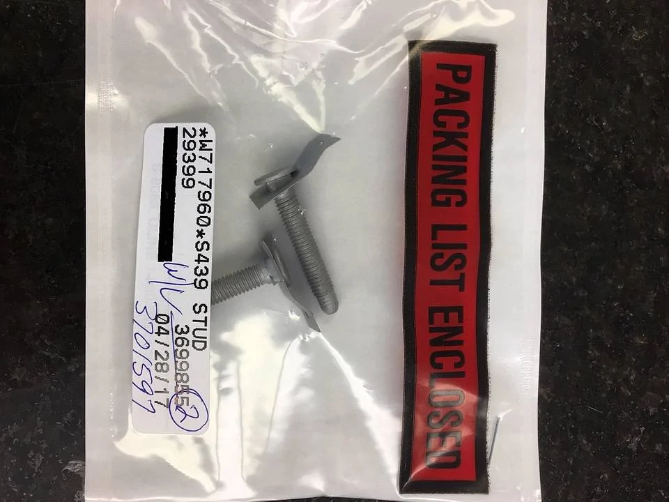

To mount the pump bracket you will need two studs that slip into welded on brackets in the car. There are certainly other ways to make this happen, but the studs are what you will find on the track pack cars from the factory. The tech and base cars have shorter studs, which won't work with the bracket. They are relatively cheap at a couple bucks each.

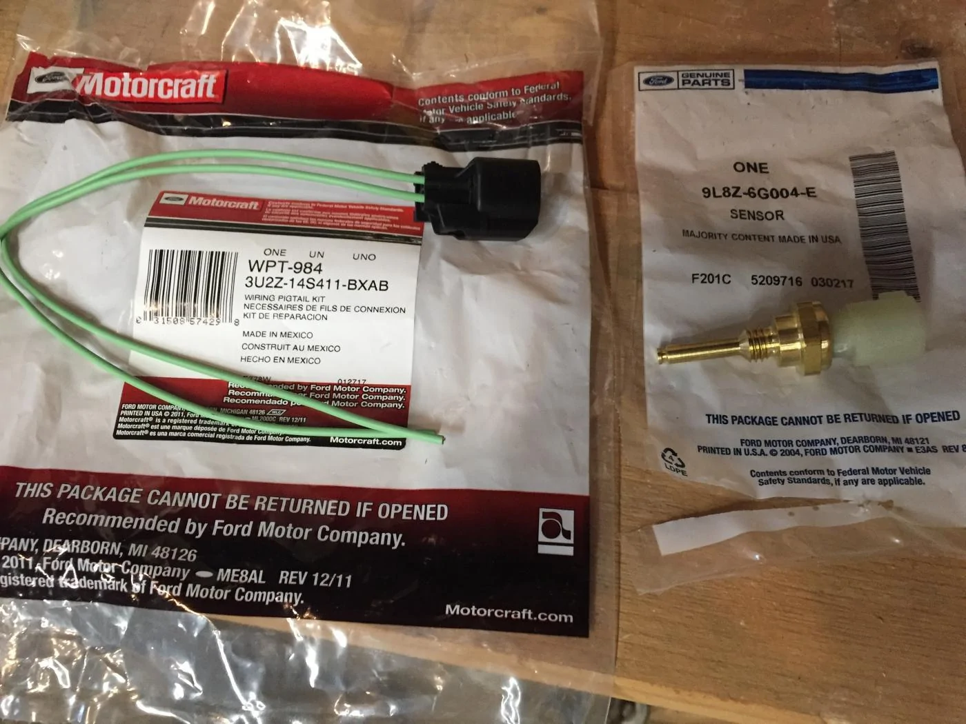

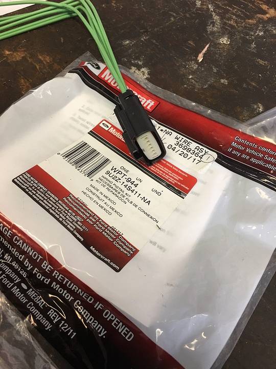

And here's the wiring pigtail you can buy from Ford to plug into the OE differential oil pump if you don't want to spend the money for the entire harness.

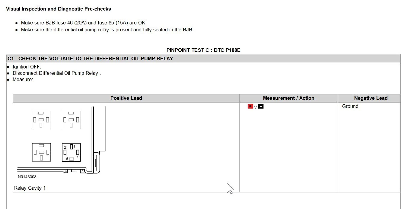

Baffling schematics
I think I found the diff pump relay position in the BJB
Couple pics from the shop manual
From looking over the power distribution when the PCM relay closes it sends power to bunch of stuff like 10 different things. Through fuse F85. Then the diff pump relay Start is feed through fuse 46 which goes hot on key on. But takes the PCM relay to close then send the start signal. So my guess is that if you get the speed and Diag signals to the PCM along with the temp sensor connected between the PCM and the EEC. The right magic codes in bot the PCM and EEC controllers it might work. So your going to have to find a Track pack 2016 to find the right codes in PCM EEC. We know the address range of both of those controllers.
How does that sound for logical guessing?:shrug::headbonk:

how did you find those replacement plug with green wires?
