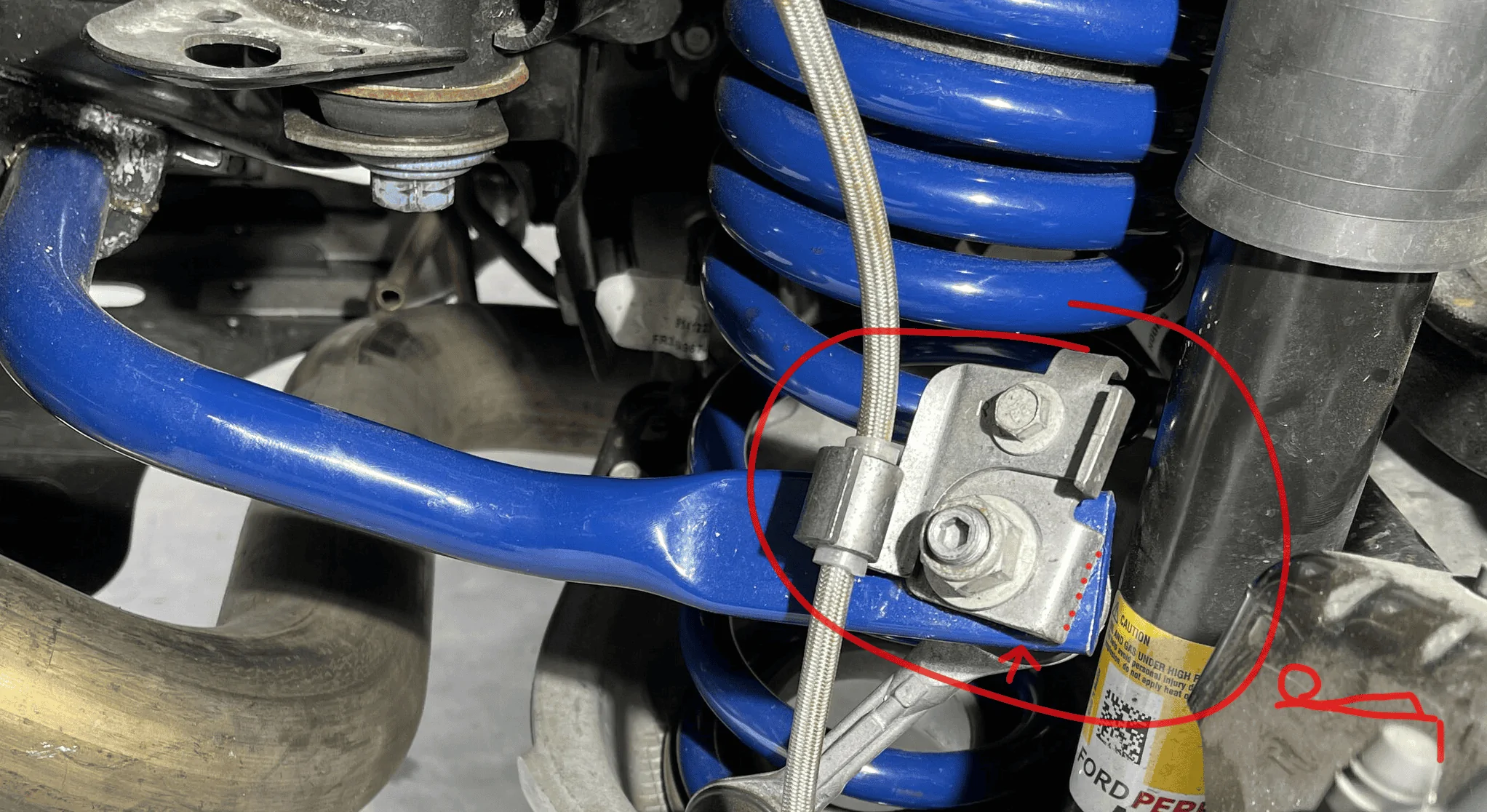

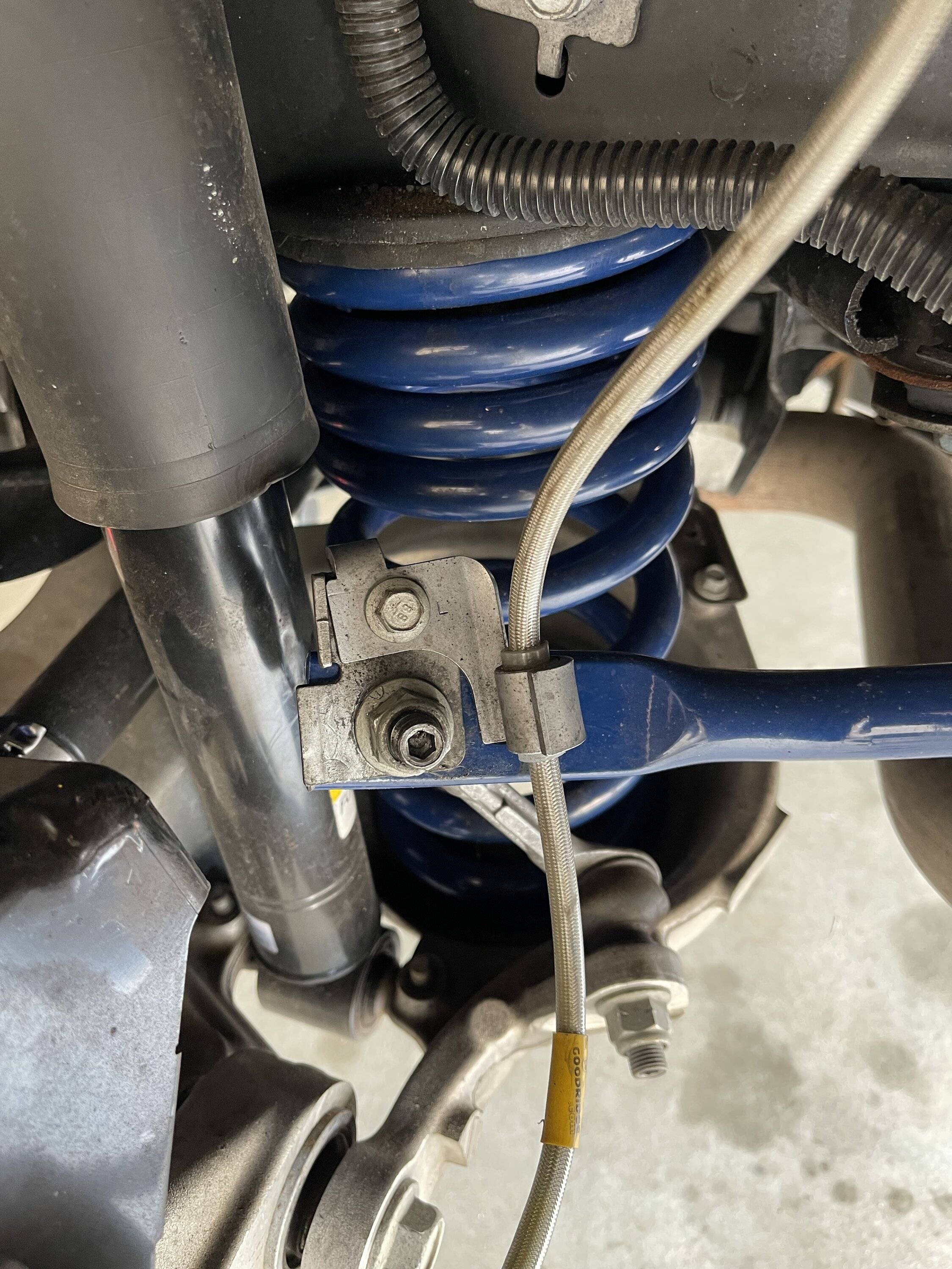

What's going on with THIS
Looks like not enough of that tab corner was chopped off and its propped up on the swaybar end and not letting the tab sit flush with the swaybar. I'd bet that's the source of your clunk, the endlinks shifting because there isn't good clamping force.

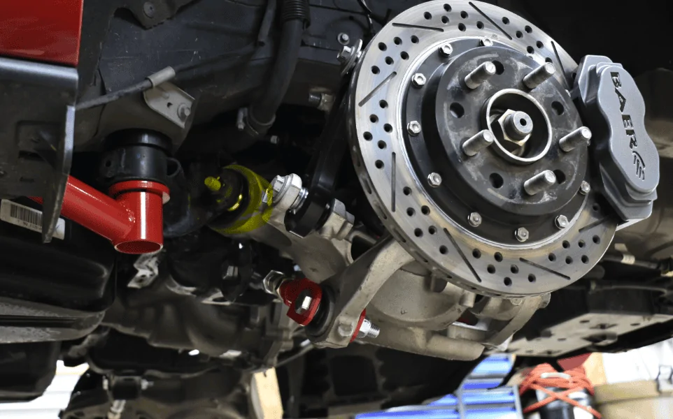

Will I need to completely drop the subframe to get it to align correctly along the lines of what @galaxy said above?
I'm not sure I follow which bolts you're referring to here, nor how I could do so with the tire on and loading the suspension with the car in the air? If you had an example or something that would be very helpful.
While I'm doing this, would it be worthwhile to change the endlinks or no? I doubt it's a cause of my issue, but I would rather go through this once.
You don't have to remove it completely, but I would suggest lowering it down to the last few threads on each bolt. Then you can remove one bolt completely, insert the alignment dowel, and then tighten that bolt 3-4 rotations before moving onto the next. Once all dowels are inserted tighten and torque in the star pattern I mentioned previously.
In regards to the lower control arm bolts, you mentioned that at one point you loosened the bolts to remove the springs that way. You would have loosened the following highlighted bolts.
Good catch. that tab had to be ground off on my factory setup to allow the swaybar endlink to be tightened properly. Yours may be doing all sorts of weirdness with that installed like that.

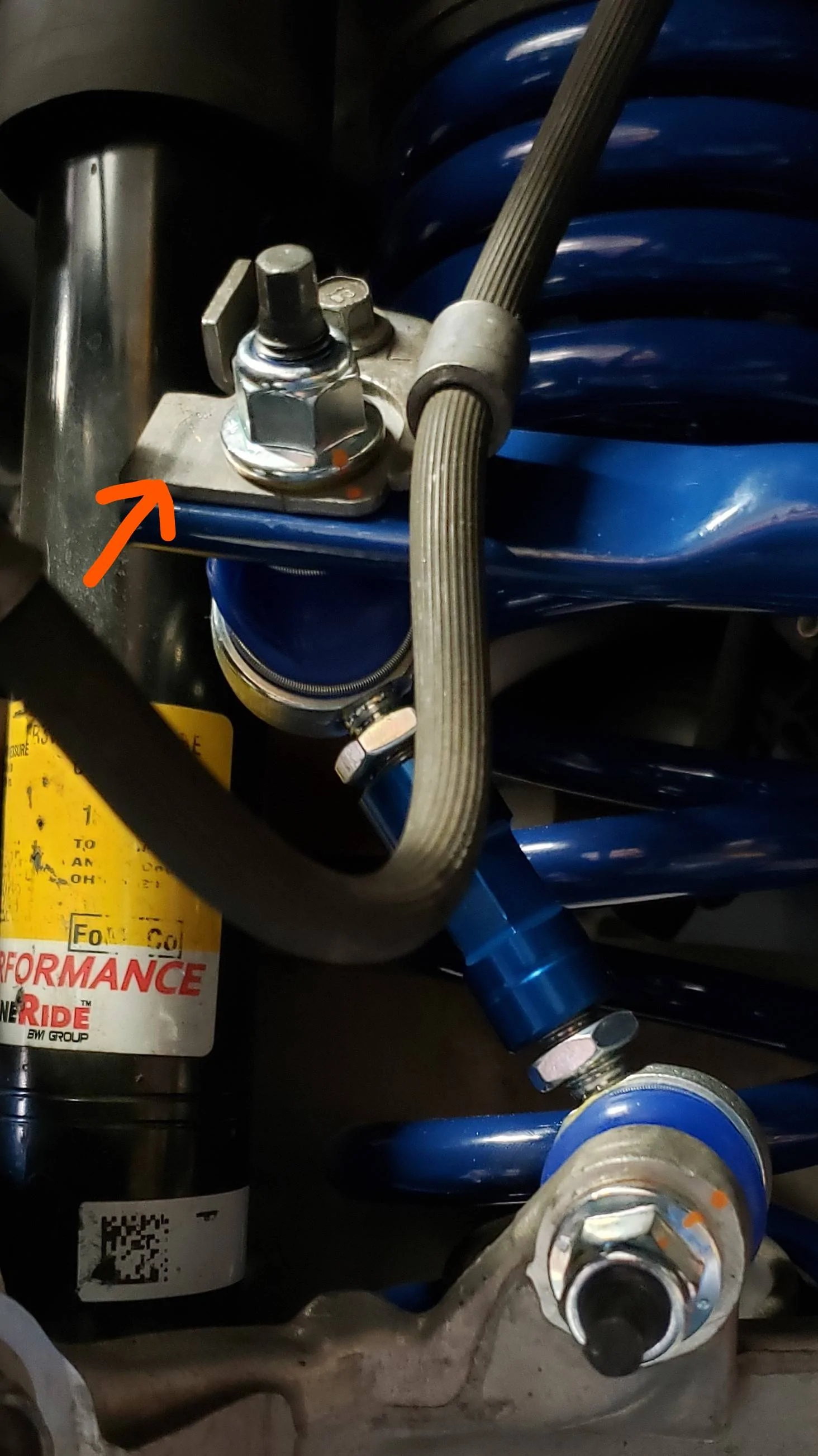

I agree with the above comments - that tab either needs to be cut off or bent flush in order to allow the end link to have sufficient clamping force.
I simply put the bracket on mine in a vise and flattened out the bend, as noted by the dark-ish line on the bracket and the orange arrow.

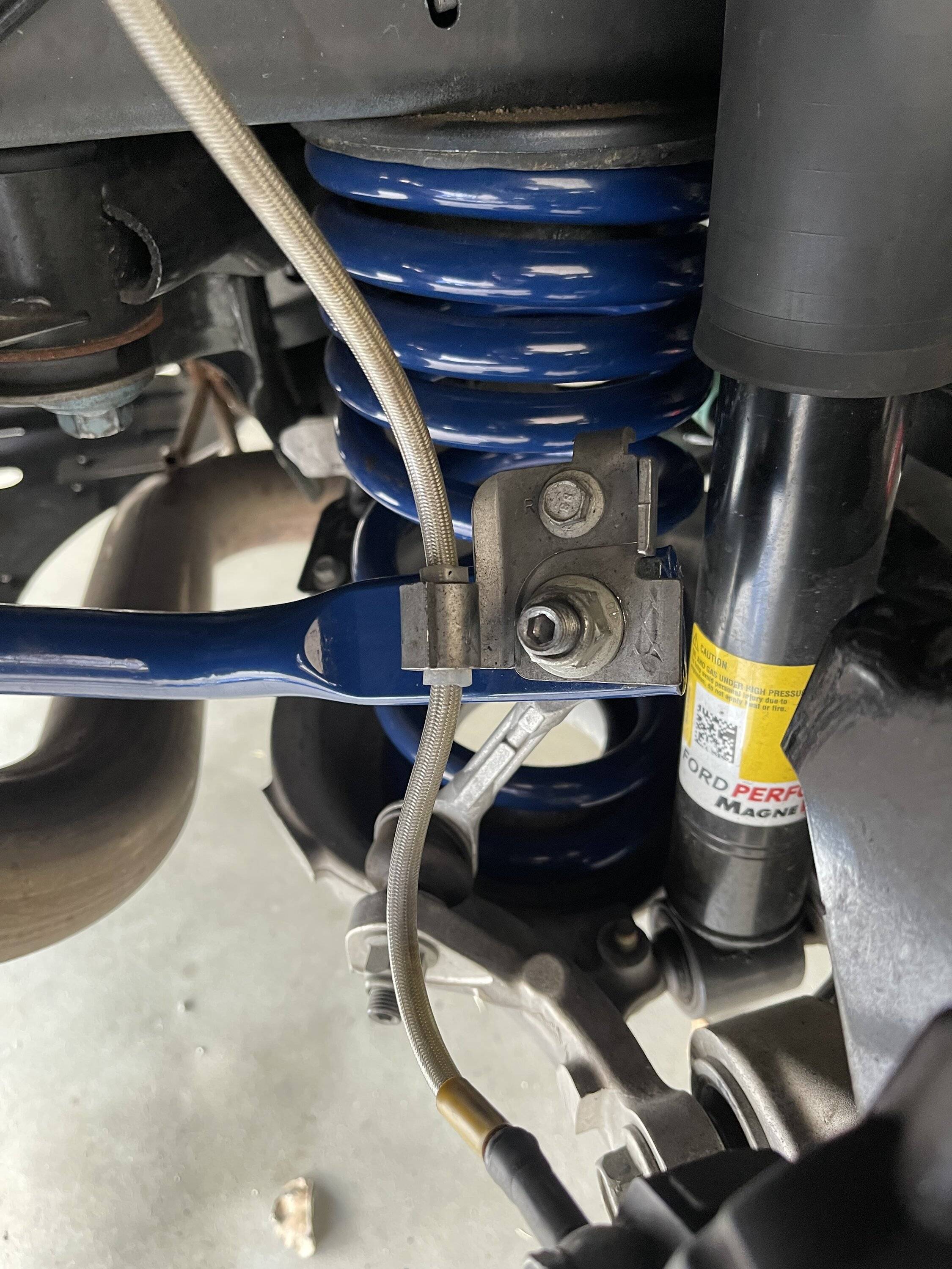

Bent the clamps out this weekend and took the car for a spin, clunking seems to be gone. I still ordered the IRS subframe bushings and IRS supports from Steeda, and will throw those on at a later date to just make sure everything is good going forward.
