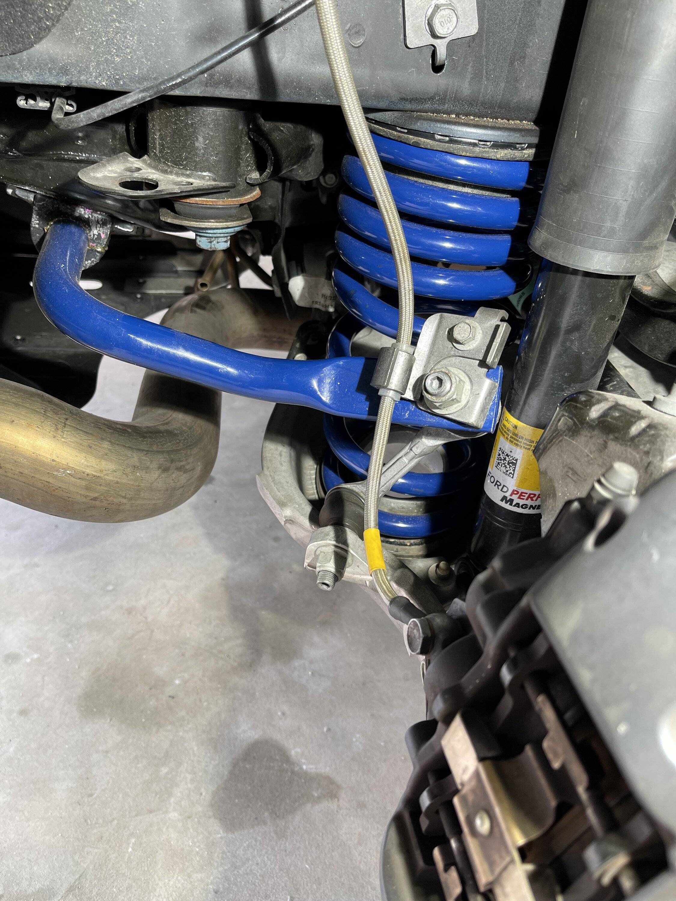

I ran this exact setup for the last 4 years and never had any clunking noises. Check the brake line mounts on the swaybar endlinks on the rear. I remember having to grind a tab off of mine back when I installed them.
The brake line mounts did not fit the new FP sway bar as the stock one. I tightened it down, but did not remove it. Is it possible to maybe flip the bracket around? I thought this may be the source, but in checking it, they remain tight to the sway bar, and I didn't think it would be significant enough to cause such an audible clunking sound.

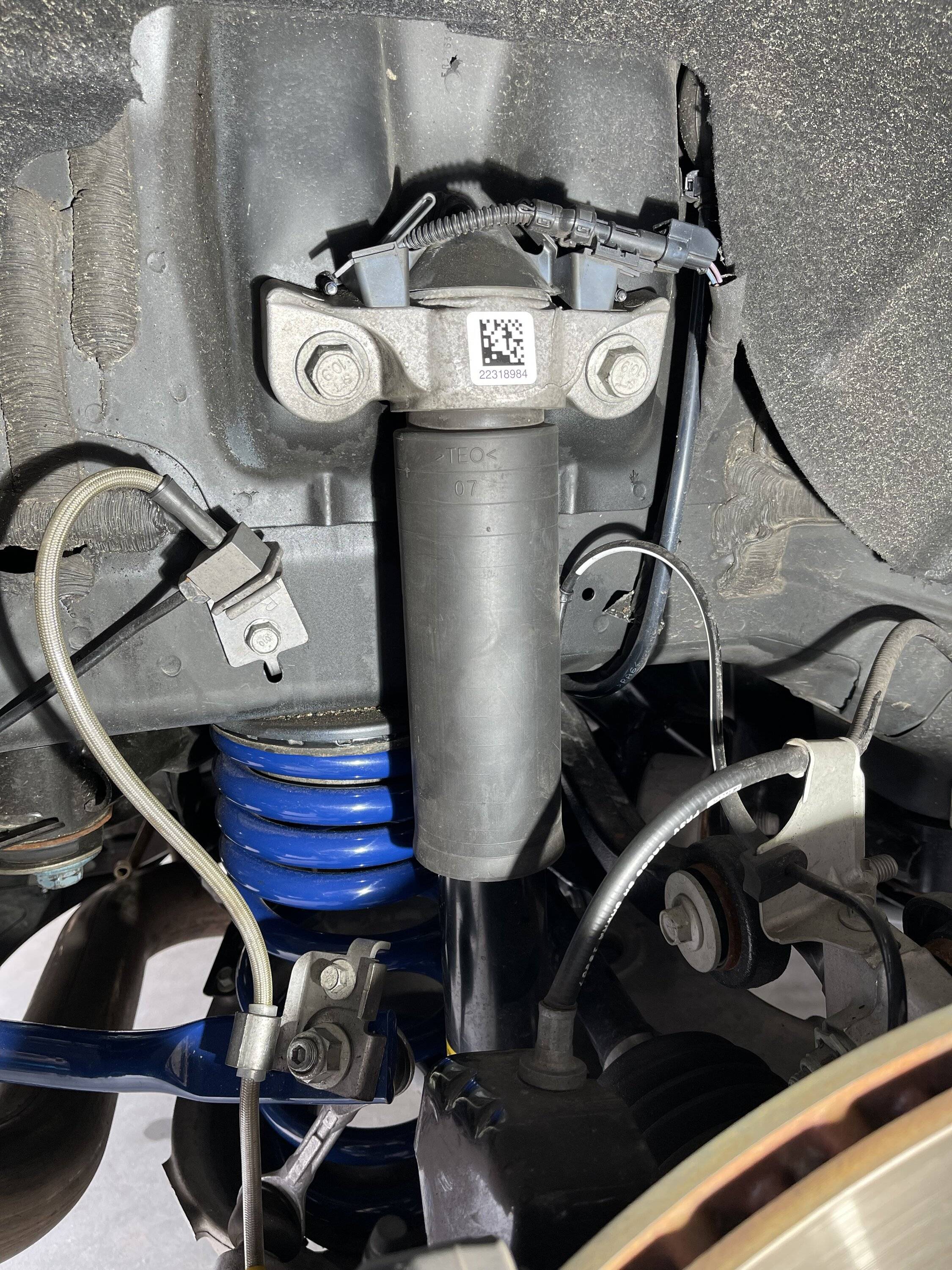

Did you pull rear shocks to install springs? If so, check shock mounts top and bottom.
Yes I did, and I checked the torque spec on them as well. I did have to fight the shocks back into position, but they do not appear to be misaligned or have any other issues that I can see.

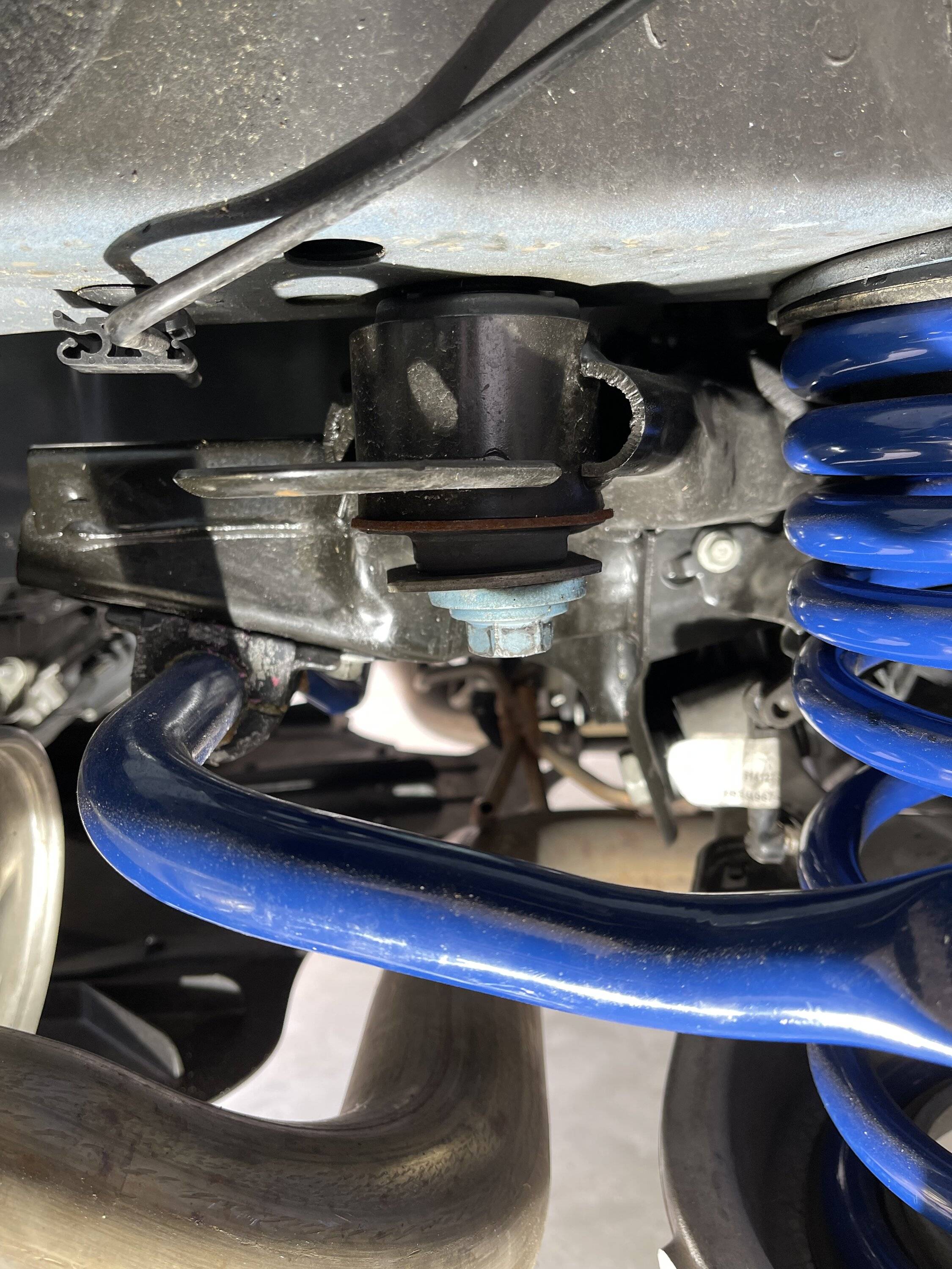

Tried to dig up some photos - I'll see if I can find any more. The picture of the subframe bolt was one I took since it seemed a little "off"...

Oohhh yeah, your subframe is not centered. Those bolts are off. Steeda alignment dowels are money well spent. They fix this by dead centering the bolt in the subframe hole when put back together. A must.

@Deadly0ne dont overthink it. You did right. Just get the alignment dowels. As much as yours is visually off, you need all four bolts loose so that the subframe is free to move around so that it can be centered with the dowels installed. Trying to do one side at a time will not allow it to move to center. Yes, you will big time need another alignment.
