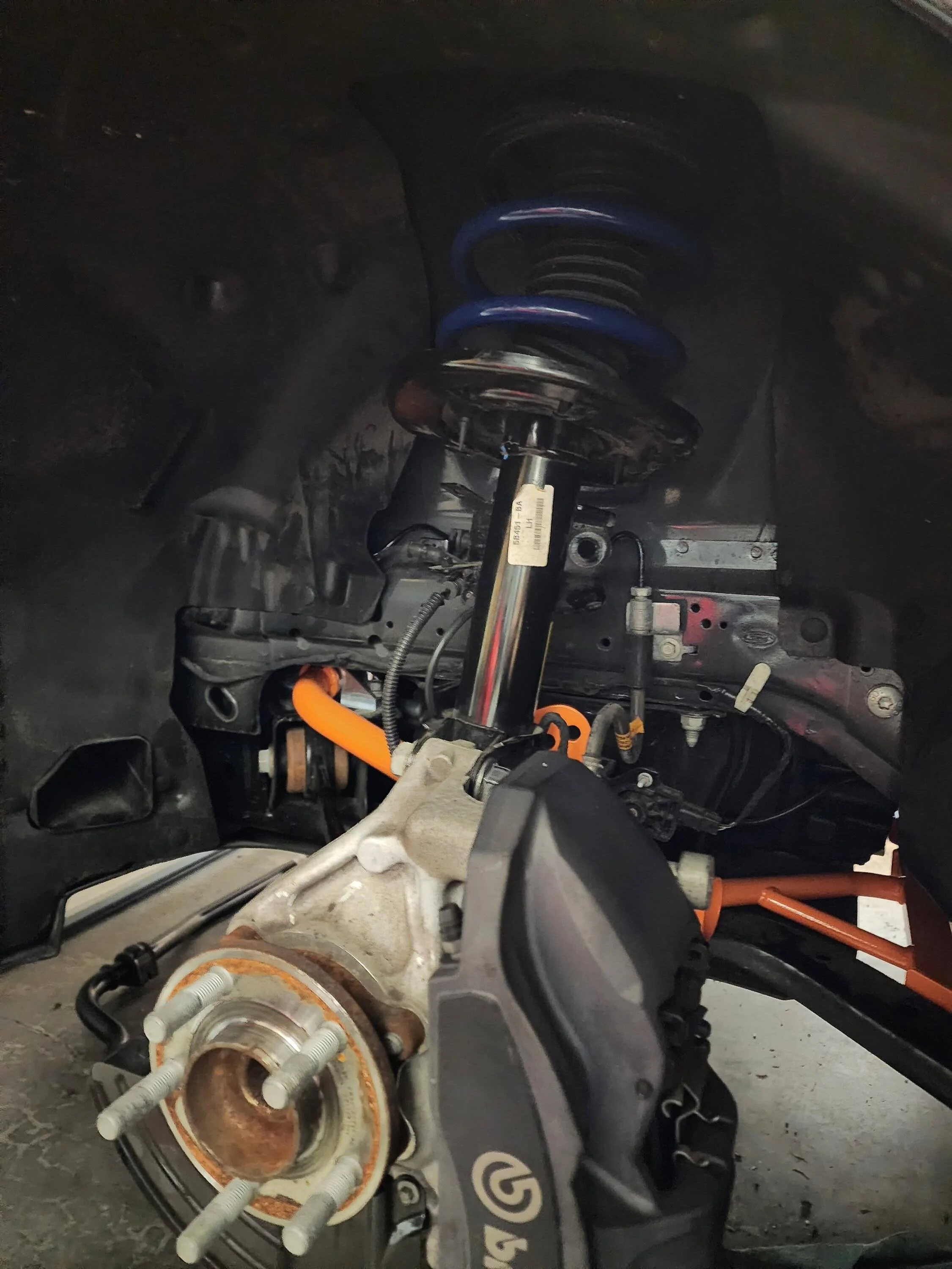

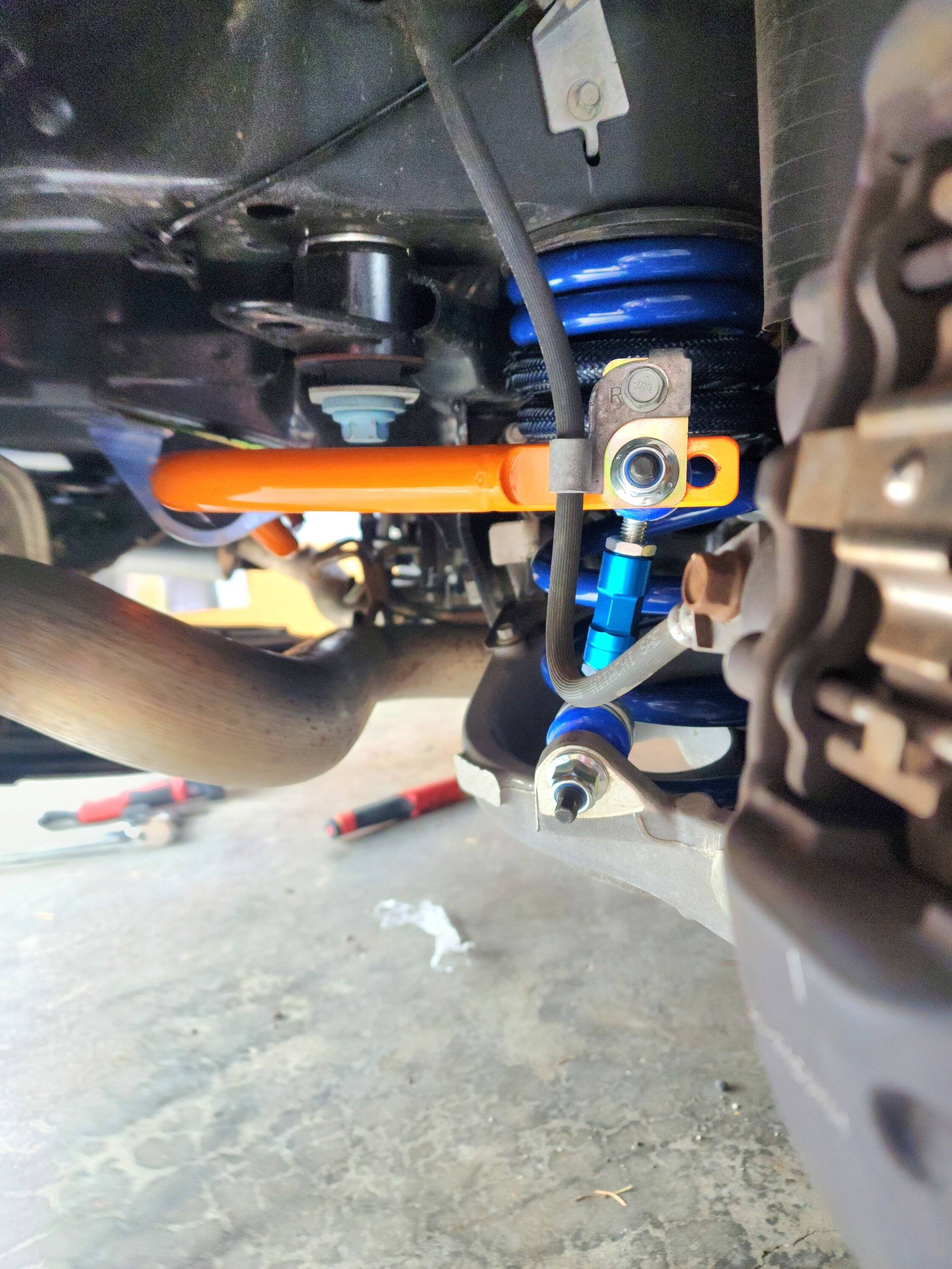

I'm in the process of doing all of this now. This is my 3rd s550 chassis I've gave the steeda make over too. I had a cluck the first time when I did all the work on my ecoboost mustang. Turned out to be an endlink. Tighten it up and was good to go.
Currently waiting on the caster plates to get here from steeda to do the front end of the car.
Got the front finished up last night. Car goes in for an alignment friday morning. Will report back to see if I have this mysterious clunk everyone is having.
So dropped the car off for an alignment on friday morning. Took it home put the new wheels and tires on it and put about 150 miles on the car this weekend. No clunks no noises from the suspension. Ill double check everything this weekend.
