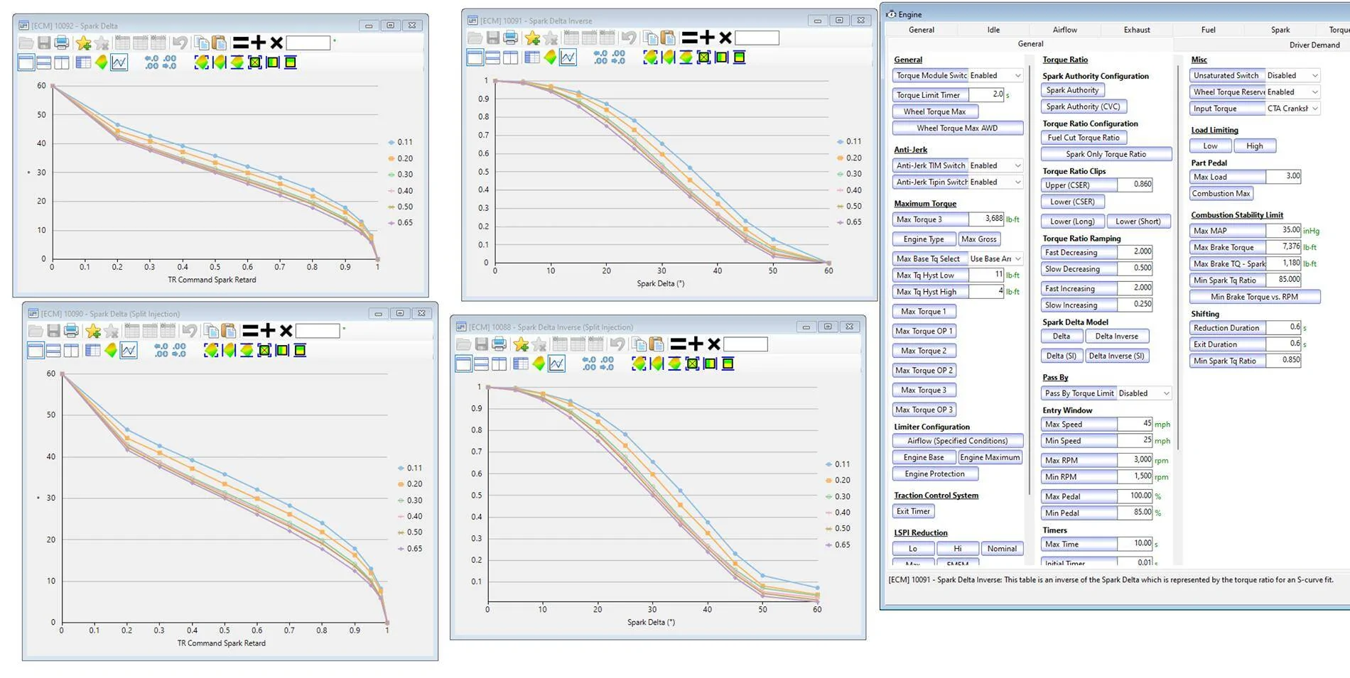

Off topic a little bit speaking of engine brake torque... Is this derived from just the MBT tables?
I believe the engine brake torque calculation is corrected for mbt minus actual timing. There is a lookup table for the torque ratio as a function of load and (mbt - actual timing).

Where is this table? Increasing MBT or decreasing MBT will effect desired brake torque?
I don’t have my laptop in front of me. The tables are under the torque management/general tab usually center column at the bottom. Some call them the spark torque S-curves. There are 4 of them.

So, changing these values will increase/decrease desired brake torque ?
I don’t think so, but they will change the calculation for engine brake torque. They’re mainly there so it knows how much timing to pull for torque control.
Spark Delta: This is the spark delta used during torque control events when commanded by the TR Command Spark Retard.
Spark Delta Inverse: This table is an inverse of the Spark Delta which is represented by the torque ratio for an S-curve fit.
These 4.

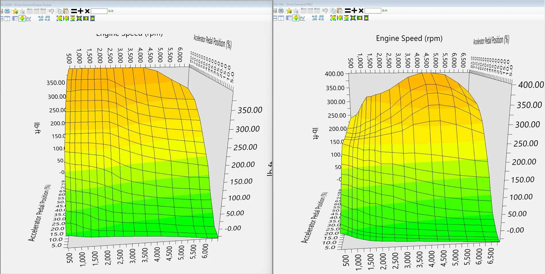

DD doesn't seem to effect engine brake torque under WOT, that I have found. Double values, leave stock, no difference. Wondering what exactly effects desired/actual engine brake torque. I have messed around with quite a bit of everything and have yet to figure those 2 out. Like I said, off topic.. lol.
Your pedal produces an atmosphere condition compensated demand torque. Spark and fuel the ECU has control over, atmosphere conditions it does not and only has a base line of STP to go off of. This torque is turned into a desired mass airflow. This desired mass airflow value can be limited by any number of the models demand torque goes through to be turned into mass airflow as well as your MAF transfer function, as It may ultimately be turned into a desired MAF sensor frequency/ period. So if you are doubling your driver demand, you have to go through and scale everything else along the path to a desired MAF sensor frequency or its just going to be limited.
The ECU opens or closes the throttle until the actual mass airflow is achieved. This actual mass airflow is turned back into an indicated torque. This indicated torque is the base line at lambda 1, MBT spark, and STP conditions.
Prior to the pedal position exceeding WOT start, throttle opening is based on the requested torque from the driver demand table(s). The start position is when the ECU does straight line interpolation for WOT throttle. At the end position the throttle will be WOT. Now driver demand values can have your throttle opening to WOT when your pedal is less than the WOT start position. Automatic cars driver demand tables kind of do this in the factory tune.
Left is auto, right is manual. Same below 30% throttle and above 4000RPM. In the region below 3500 and higher than 30% throttle the Automatic driver demand table torques are much higher than the torque the engine can put out.

In this application, the torque converter slip can actually allow the engine to make more torque than what is applied to the wheels. So instead of the feedback loop being the engine brake torque and the driver demand torque being kept in sync, its the engine brake torque and the transmission output torque/ desired wheel torque being synced. Technically both are just engine brake torque and desired wheel torque being kept in sync. The torque converter clutch unlock/slip/lock parameters and target slip modify the demanded engine torque to give that desired wheel torque. Its just not as straight forward as only modifing the manual DD tables, as there is just more driver independant control going on there.
