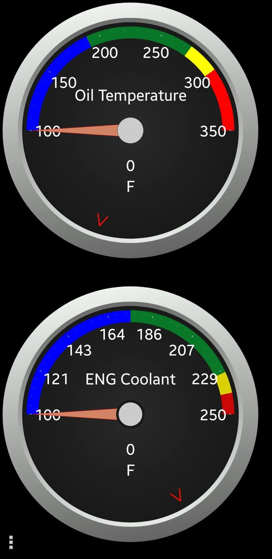

Yes. I found the PID's specific to Ford and had the Oil pressure up. But I decided on running the dash oil pressure display on the center console and will use my phone for coolant temp, oil temp, fuel rail pressure and fuel pressure. I may just end up using a larger display like a small tablet so that I can have the items mentioned and trans and diff temp. It is easier to see the needle in the color bands and a gauge than having to focus on text while on track. My first event for the season is on 23MAR and I should have all this set by then. I will share my display set up and software used when I finish the configuration.
