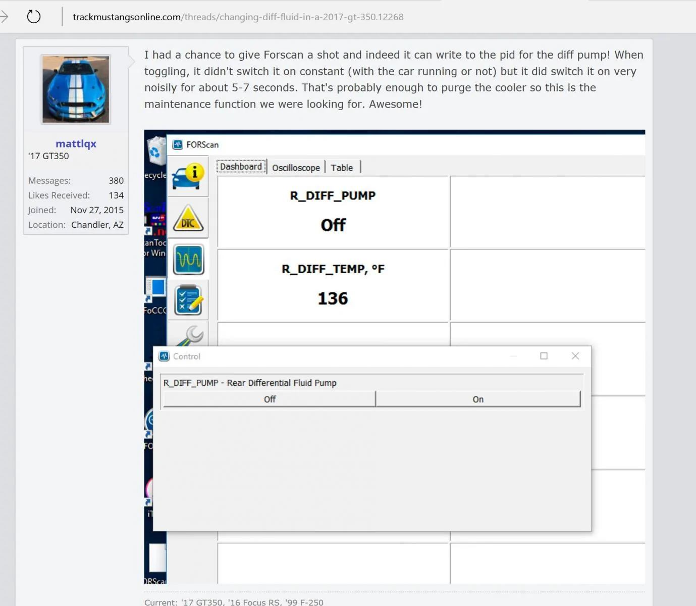

Want thank the last two posts, went to the vcm site and downloaded the manuals. That helped explain things better. Some success I did learn how to run the diff pump with a forscan. Still lost as to why when you change the as built to thinking the car has 12 speaker from factory installed 9 speaker the bass out does not enable from head unit. I'm still betting on PCM doesn't see the amp power signal and disables the output but it should throw error code.
Congratulations [MENTION=28002]cking[/MENTION] :cheers: That's awesome.
Could you write it up and post either in a new thread or the Forscan thread?
I'm still hopeful we figure out the oem operation for diff pump on the Base/Techs. Every bit of info could help.
Thanks in advance.

track mustangs online.com/threads/changing-diff-fluid-in-a-2017-gt-350.12268/
take the spaces out of the top line will give link to another forum that has write up about diff pump.
This site won't let you post links to another site:doh:

R_DIFF_PUMP
PID FORSCAN TO RUN PUMP.

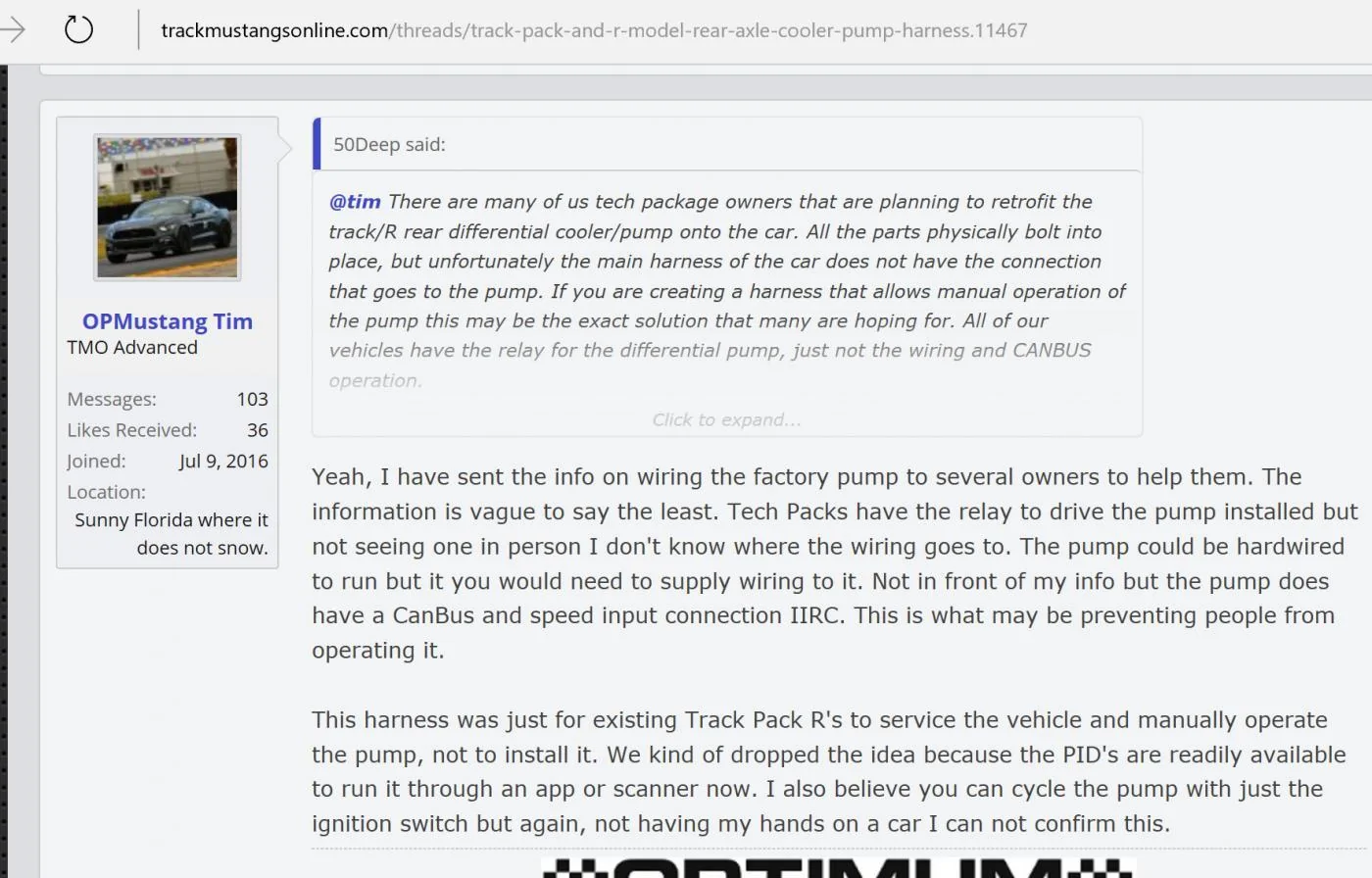

Another thread talks about manual switch harness he might sell.

Diff pump maual wiring
Source with info
