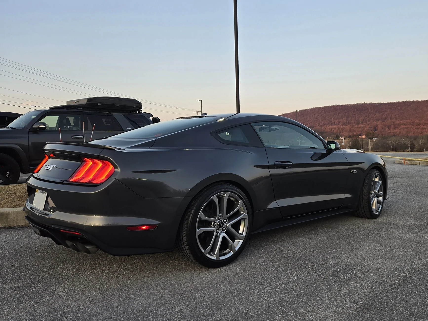

My 19 GT came with the stock blade spoiler but I'm considering swapping for a PP1 or a GT350 track pack spoiler. Would this be a straight install with the same holes? Or would I need to fill or drill?

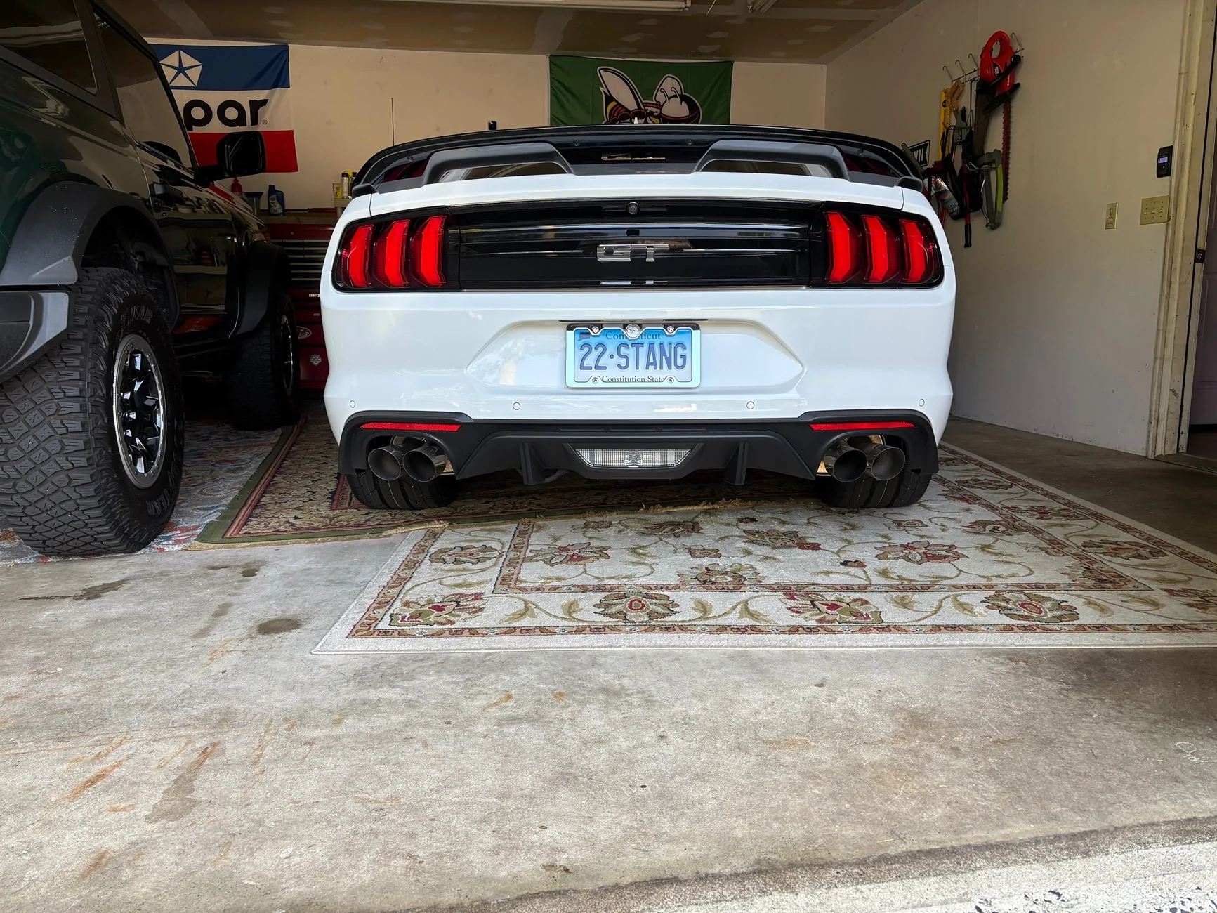

Curious why ya park the toys on the carpets?
Love the Bronco in addition to the GT.
Cement floor so just added protection from possible moisture. They are old rugs from the house so it’s not like I purchased them just for that.

I ll be the different one here to say the spoiler on your car the way it s sits is way better looking. Looks more refined IMO. Don t see the need for big eyesore . Are you going to balance the front to match the new rear then.? Those are supposedly designed by Ford to work together . Nice looking car either way!

Thanks for the feedback! Just toying with ideas so far - haven't ruled out stripes or side scoops, but I lean toward subtlety and don't want the Boy Racer look. Just debating whether the current spoiler is a bit *too* subtle....
