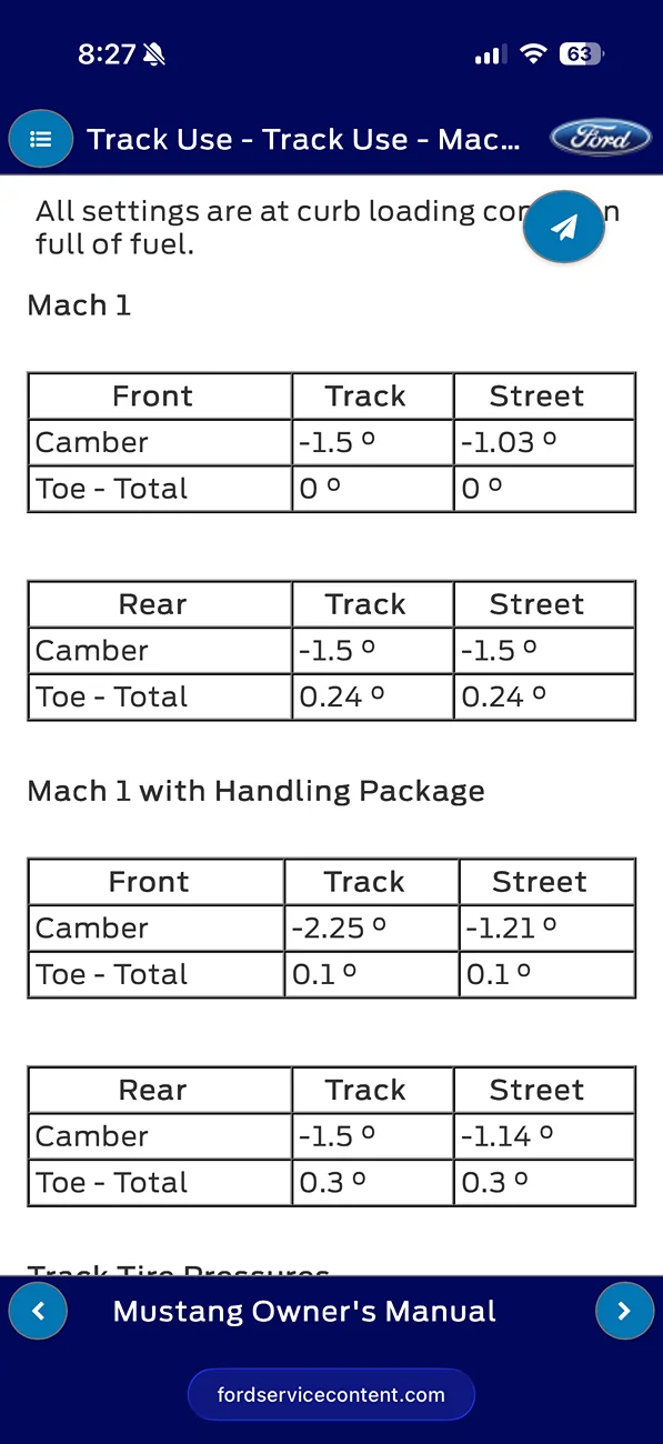

MAGS1
Mar 6, 2020
96
11,580
19,009
Somewhere in Middle America
Mark
2022 Mustang GT
It is not directly wheel related. That's ridiculous. Why would a wheel change alignment?
Direct from the owner’s manual

Just enjoy shutting down people who spread misinformation on the internet.
Getting of topic a bit, but this is FAR from misinformation. Saying that changing a component of your suspension has zero effect would be closer to misinformation. I can guarantee from an engineering perspective if you change a variable in a system the resulting numbers will also change. 2+2=4 we can agree but 3+2 doesn't = 4, a small variable change results in a change in output.
A wider wheel does affect steering and suspension how much I can't argue, I don't posses the skill, formulas, or variables to do the math. The wider stance will 100% increase leverage on all suspension components and the change in scrub radius is going to have some effect as well.
Because of the added leverage spring rates will be effected, camber will change, stress on bearing etc. will change. The increase in scrub radius will also change steering feel and effort, and might be the reason for the change in toe between the HP and none. Also try not to think of the car in a static position, suspension is dynamic.
With that said if you didn't change your alignment it's probably going to be ok. However Ford def has different alignment specs and the only differences in suspension HP vs none on the front at least are springs and wheel/tire, so one can deduce that the alignment spec changes are due to the differences in spring rate and/or wheel/tire width. Also note the differences in camber and toe are very minor here, so the changes made here are also most likely very minor.

The different alignment specs are just more aggressive for track use...going with an inch wider wheel isn't going to change anything.
MAGS1
Mar 6, 2020
96
11,580
19,009
Mark
2022 Mustang GT
Which has absolutely nothing the do with the wheels
It actually does, since the non-HP and HP come stock with different size wheels. Fronts on the HP need more camber because they’re wider than the non-HP.
