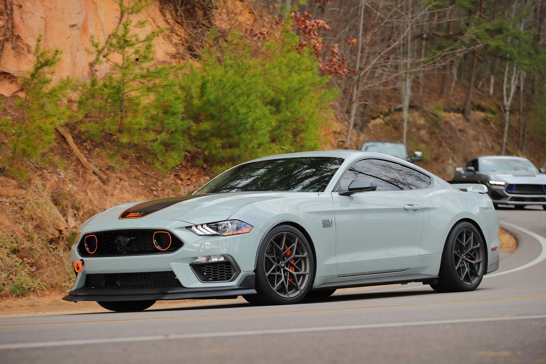

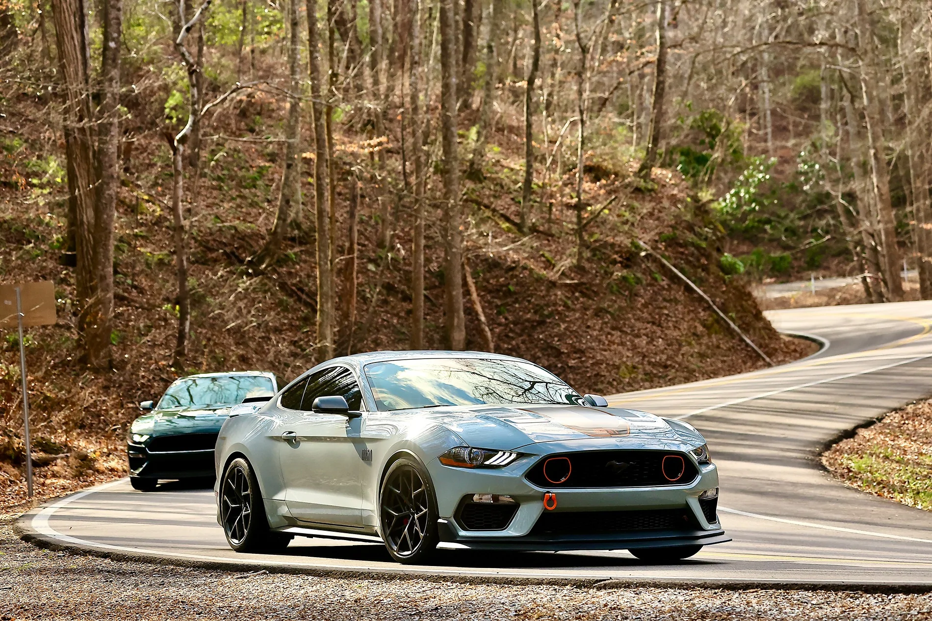

As for point 1, I bought my Non HP car, and the previous owner had already done the HP Wheels (Ford Performance), put the front splitter, the fender lips, and the rear spoiler with gurney flap on it. I couldn't be happier with it, I made it my own to a certain degree (de striped the sides, and paint matched the rear spoiler). Haters gonna hate, just do what makes you happy :)
As for point 2, I just did a Steeda rear sway bar as the front one on the HP car is the same. I also did the full stop the hop kit, the sub frame braces, and that was it. With stock springs, my tires don't wear funny at all, and mine handles really well, I take to the dragon frequently and have never lacked for any grip or performance at all.. This was Sunday, almost 70 degree day the Sunday after Christmas :)

That wheel tire fitment looks good with the HP wheels, I thought I remembered the HP was slightly lower than the none HP, but maybe I'm wrong. Which kit did you go with? Did you also do the diff bushing upgrade? The less I buy the happier I'll be lol.
We were on the dragon on the 21st while it was so warm as well. Hardly anyone out, it was a lot of fun.
