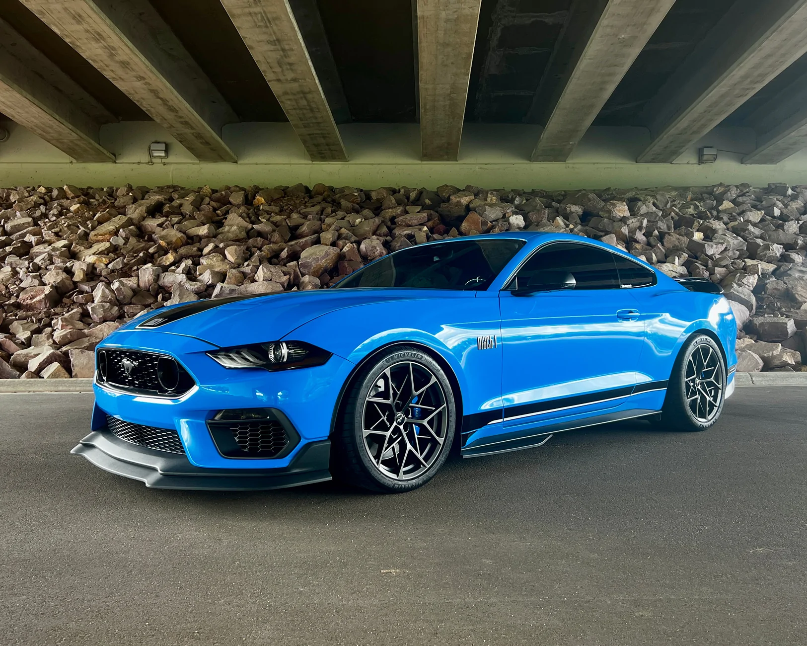

Handling pack wheels are the best looking in my opinion, but a pain to clean. I haven't really seen a wheel style that I like more yet. LMRs MHP1 wheels give you a similar enough look without having the aggressive offset in the front, spokes are also noticeably thinner imo. Velgen, Signature, Apex and Weld wheels are all sets that I've seen on Mach 1s that usually look pretty good but some of those options are going to cost you big.
Ultimately though, it is your car so do what you want. Anyone who is getting on your case about being a "HP poser" is just being a tool or thinks there HP car is somehow better than yours. The reality is you can throw all the Handling Pack parts on a Non-Hp car and it will handle exactly the same as an HP. The only noticeable difference would be speedo reading, which would read higher than you are actually going. There was a thread from a while back were someone compared the programming codes of a non-hp and an hp car and found there was no difference in the tuning for the magernride which a lot of hp owners will tell you exists. Even if it did exist, the difference would be negligible.
I'm currently still running my factory sway bars but thinking about possibly upgrading atleast the rear. Aside from some exterior and interior cosmetics, my non-hp has the following:
OEM Handling Pack:
Chin Splitter, Spoiler, Wheels, Wheel molding and rear splash guards
(The spoiler came gloss black and was repainted magnetic gray but I left the gurney flap left gloss black because I like that look more and that's how ford originally had it on their preproduction cars),

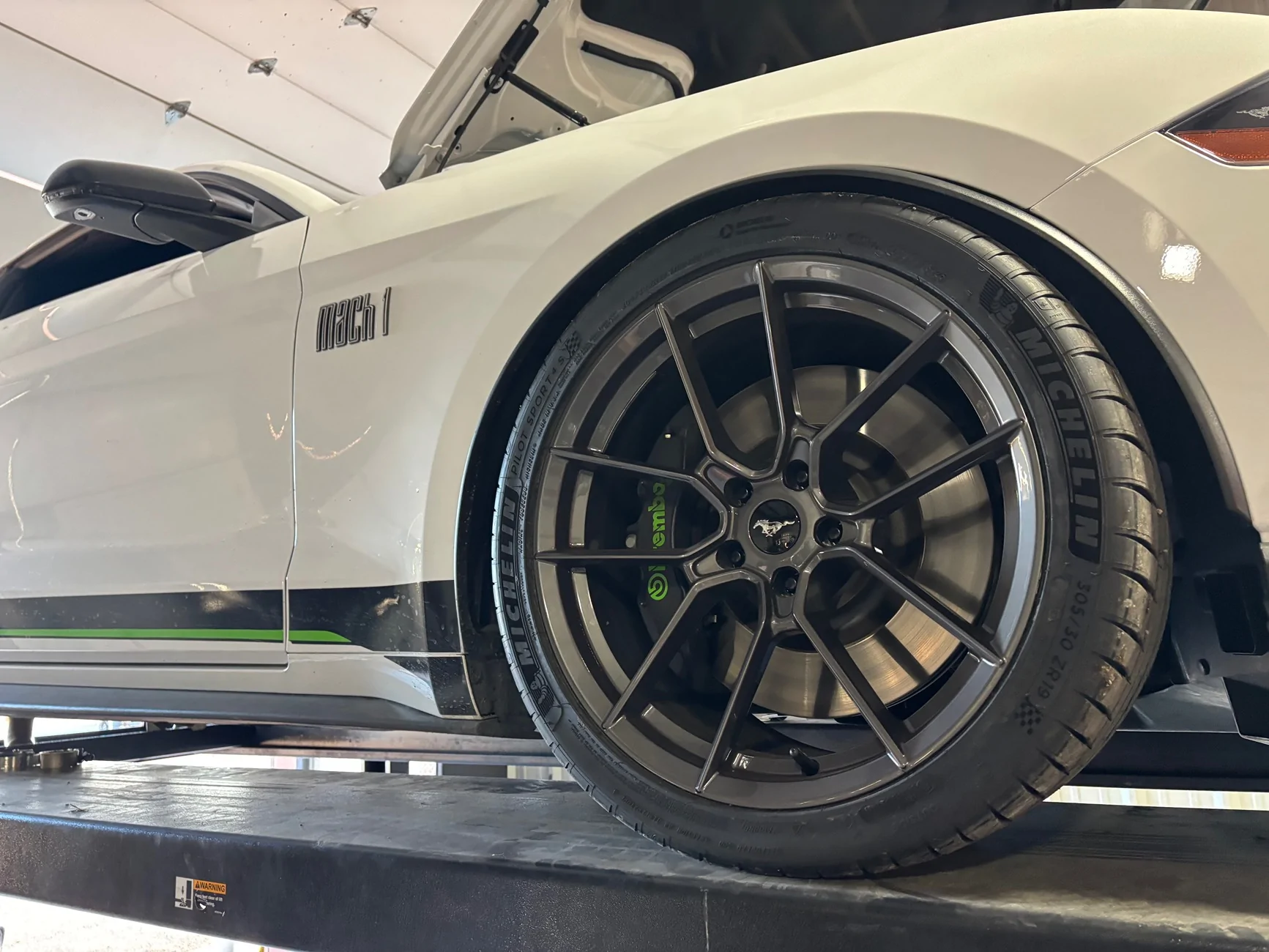

Wanting to do a few upgrades to my Mach 1 (may or may not have a small end of year bonus burning my pockets đź‘€). Mostly just putting around town, but do occasionally do some track time and some spirited road driving i.e., The Dragon etc. Want to add a bit more rubber over the stock non-HP tire sizes and firm up the suspension some, feel like I'm leaving some handling on the table as my skill has increased. Two stages here but I think they might be related somewhat based on my goals, so wanted some feedback.
1st: Wheels and tires, I dunno if it makes me a poser but I really like/want the stock HP Bird nest wheels and I like the tire sizes. I know I'd need to add the fender flair to the front. Should I be considering other options here? Is it really it frowned upon to run HP wheels on a none HP since it's not technically up badging?
2nd: Suspension, thinking I want to go full Steeda here, I've put together a quick build but wanted some input on if what I chose is correct or needed or if I should change, add, or remove anything. I'm scrubbing the outer shoulder of the front tires and figure a bit of camber would help so adding the camber plates or maybe it's just HP envy :crazy:. Not sure if the magnaride tune is really that great and it's very spendy and could easily be added later. Slightly worried about lowering springs tbh even slightly roads are rough and it's a bit of a lip to get in my garage/shop.

Pull the trigger on the wheels if you want them, not up badging whatsoever ;) you can actually get them pretty cheap from Ford Performance.
As for your other choice, I know many swear by Steeda, but personally I think they suck the more I’ve read, heard, and experienced in the past, and think you should check out BMR.

I went with LMR forged DH1 wheels 10.5 up front and 11 in the rear.
Did steeda suspension, did not do the diff bushings.
On your list, I would forget the diff bushings and the magneride controller until you are ready to be a track car.
it really all depends on how much you are willing to compromise your factory ride quality.
Steeda springs are solid and you will not notice a ride difference. Moving to the lower profile tire you do notice just a little in ride difference.
If I were you, I would leave the DSC controller and the diff bushings and snag the other sway bar, as well as the IRS alignment and bushing set up.

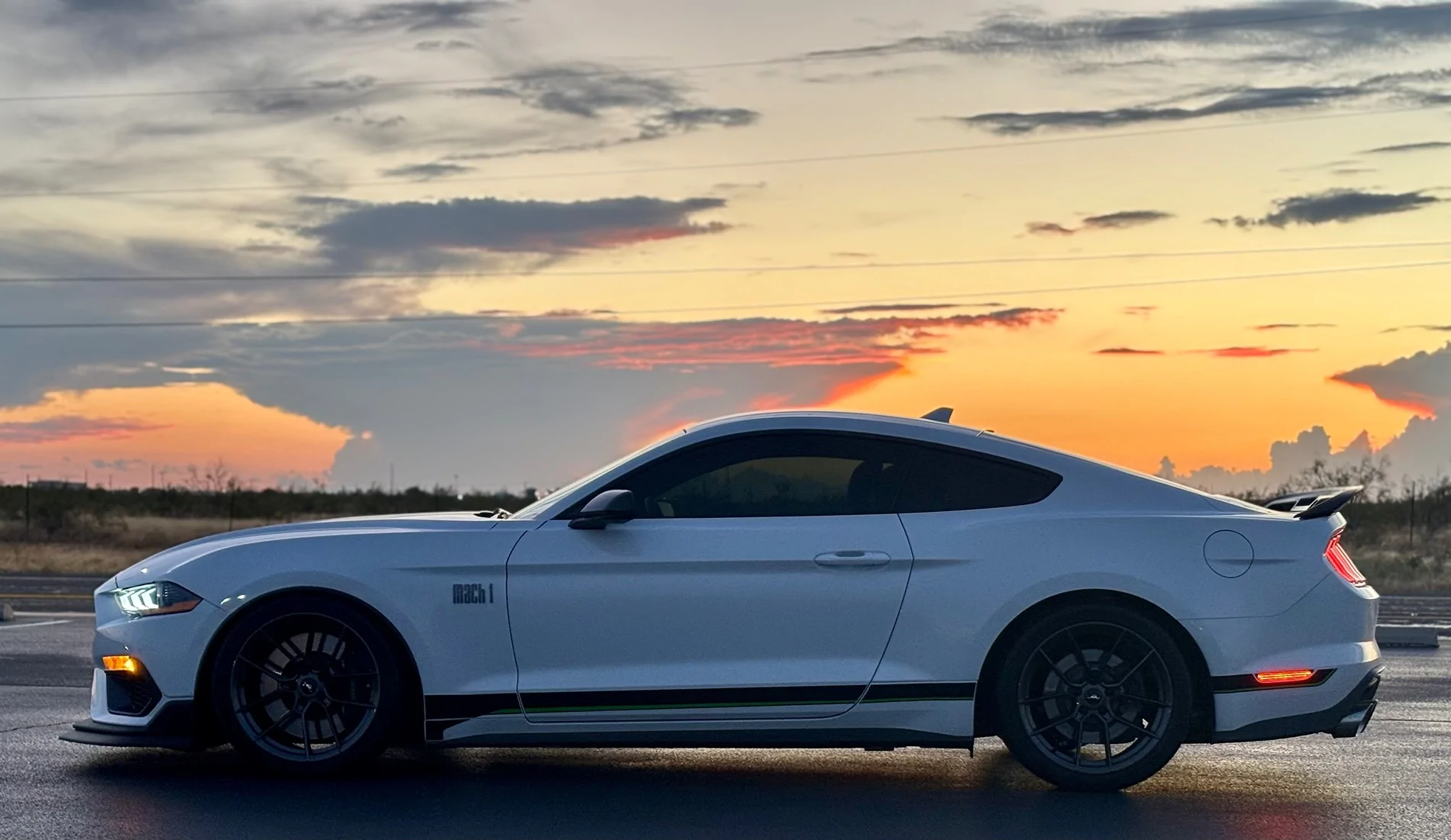

My car
Steeda
Progressive springs. (Will be moving to dual rate, car is a bit low)
Front and rear sway bars with billet brackets
IRS braces
IRS alignment dowel
IRS aluminum bushing inserts
2 point g trac
Maximum Motorsport CC plates
LMR DHP1 forged wheels (I went this route for weight and cleaning)
added all the factory HP bits
