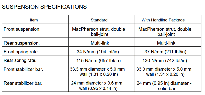

HP springs are stiffer....closer to GT350 springs, but not quite.
Spring rate chart is almost a sticky.

This is from the Mach 1 supplemental documentation.

No problem, it is a subtle difference for sure but a nice improvement.
