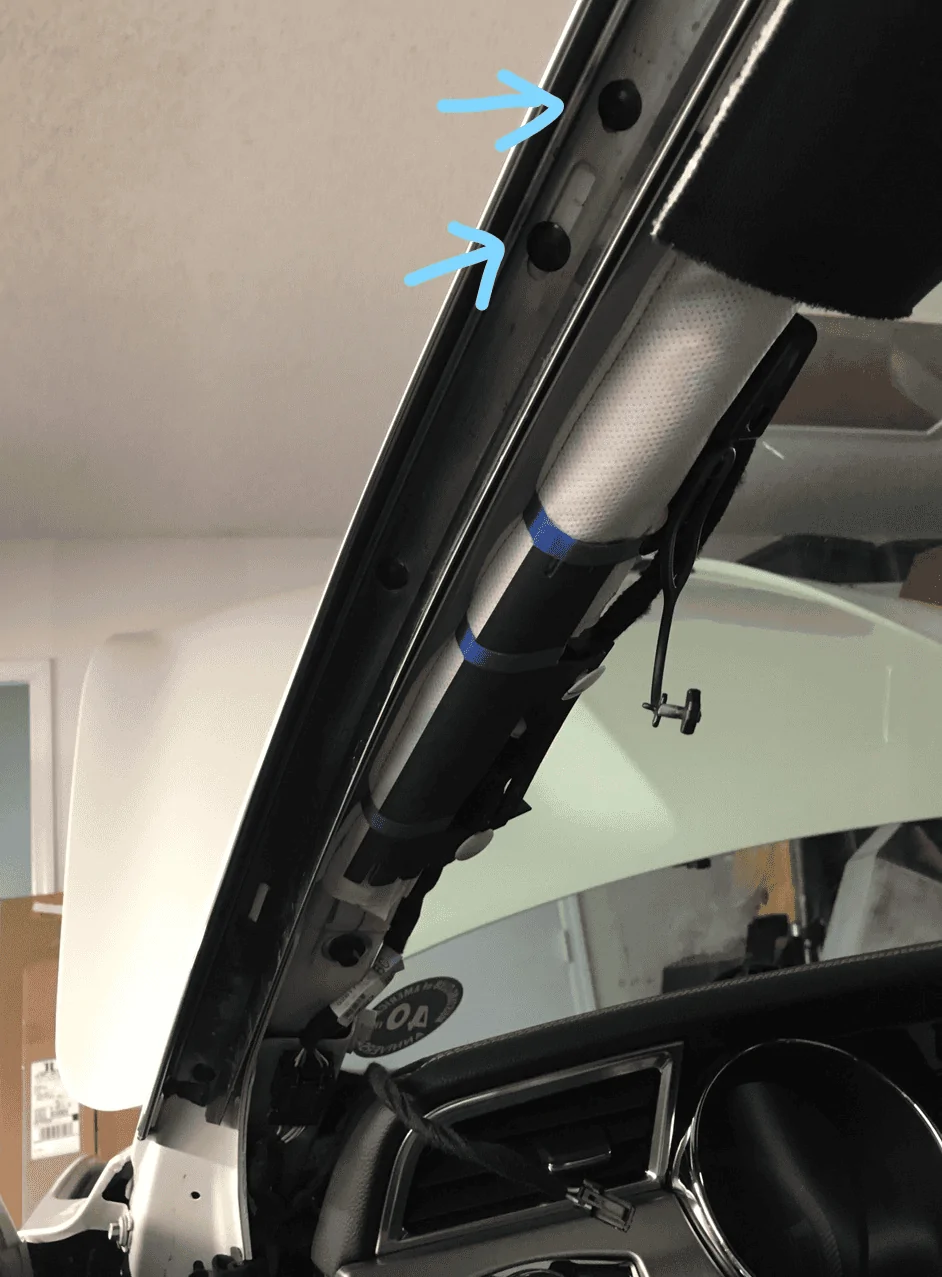

Does anyone know how to get to the arrowed area safely and put everything back properly?

@Albertcado We only thighten the screws, nothing more.
@Cobra Jet answered the exact thread we had for explanation
Best regards, Birdmaster

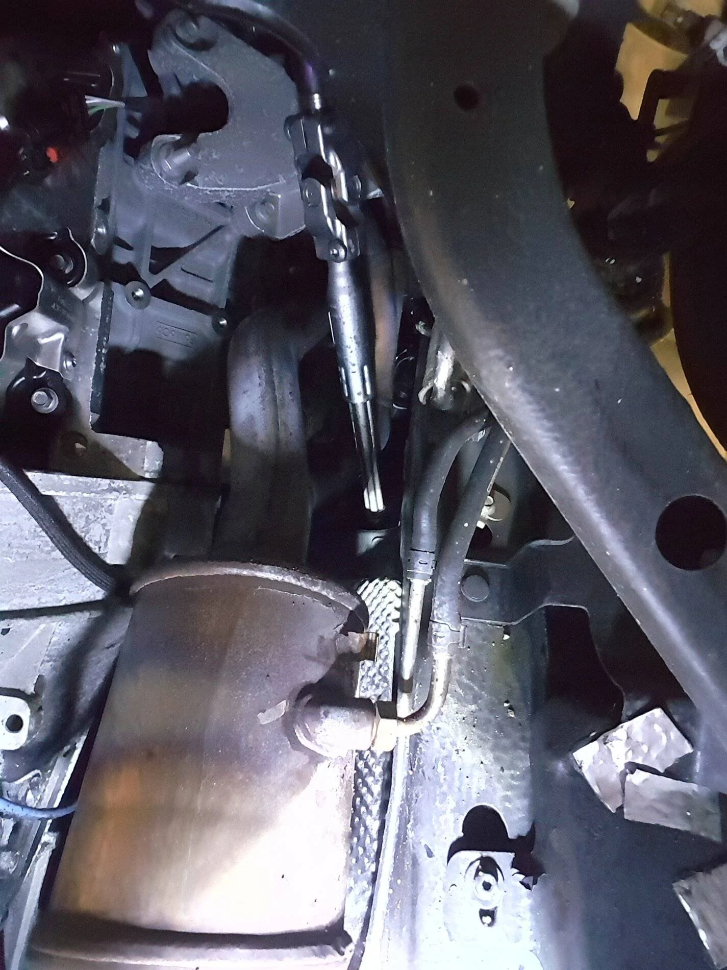

After 12 months of noise when accelerating, we solved it.
A guy in our german Mustang forum had a similar noise.
On the driver side, near to the exhaust pipe a pressure line sometimes touched the body of the car.
You can see the pressure line on the pic over the heatshield going down to the bottom of the pic.
We hope it works for other Mustang drivers too.
Best regards from good old Germany ;-)
What did you do with the pressure line once you found out it was causing the noise?

@Albertcado
We pushed the line a little to the side with our hands. There is a holder into which the line can be pressed, but this also made a slight noise. Just pushed to the side.
Nothing more after one year of noise.
