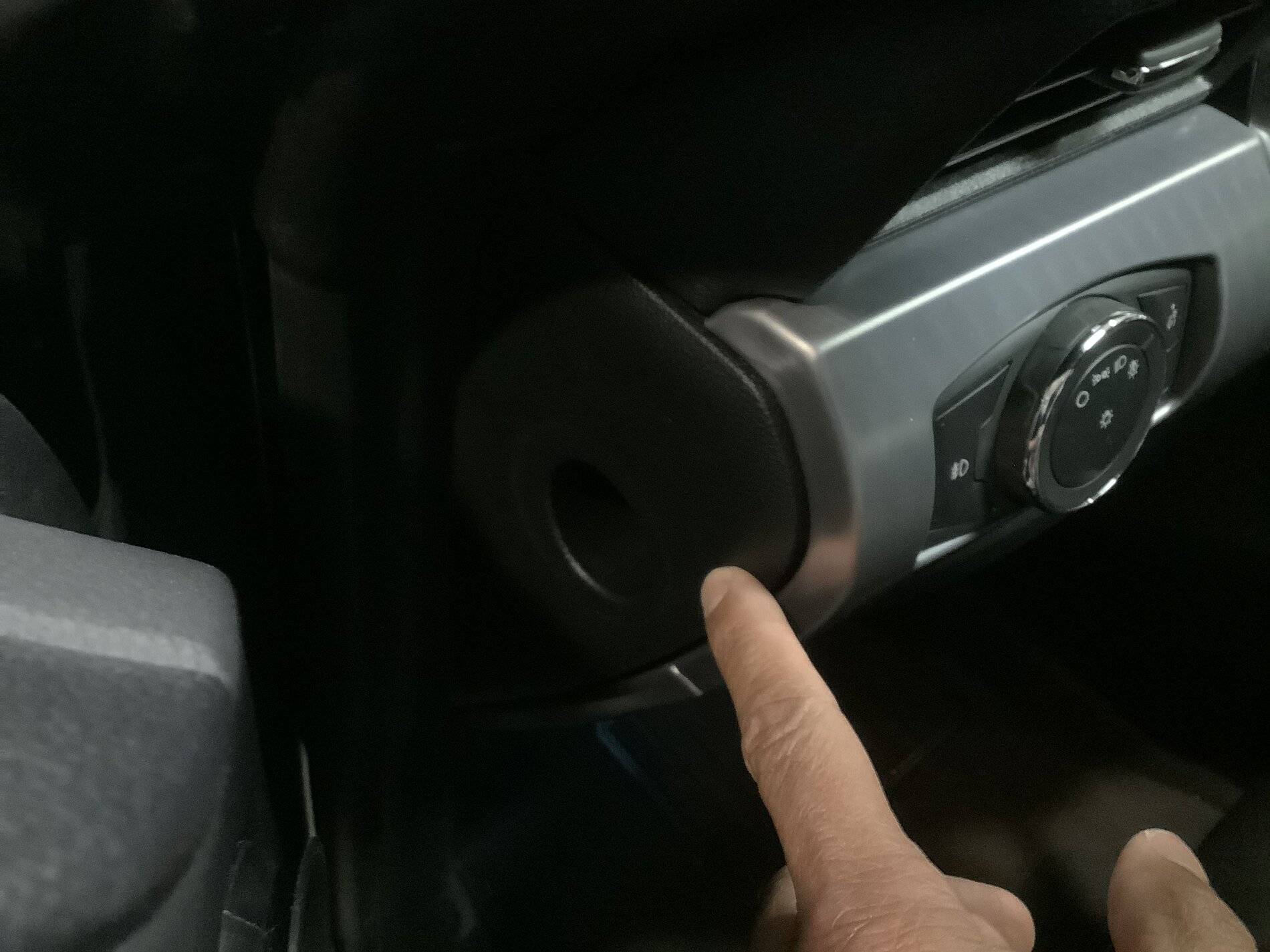

After 12 months of noise when accelerating, we solved it.
A guy in our german Mustang forum had a similar noise.
On the driver side, near to the exhaust pipe a pressure line sometimes touched the body of the car.
You can see the pressure line on the pic over the heatshield going down to the bottom of the pic.
We hope it works for other Mustang drivers too.
