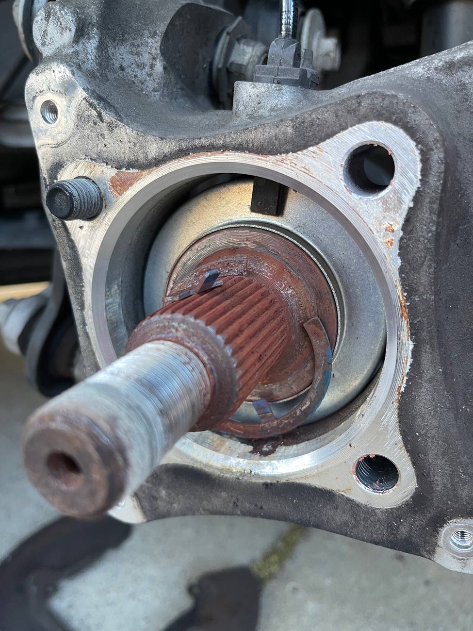

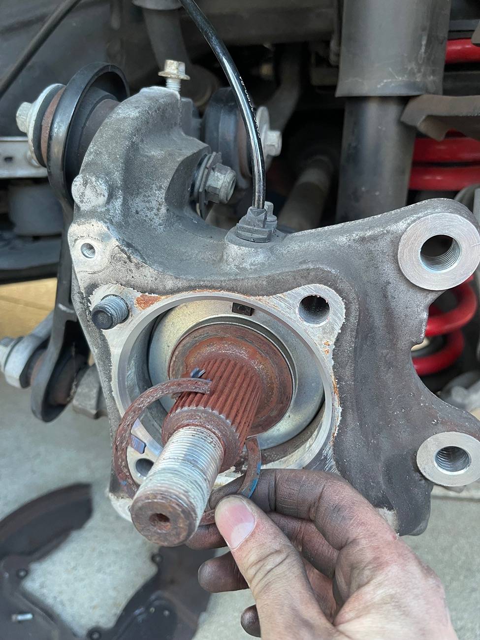

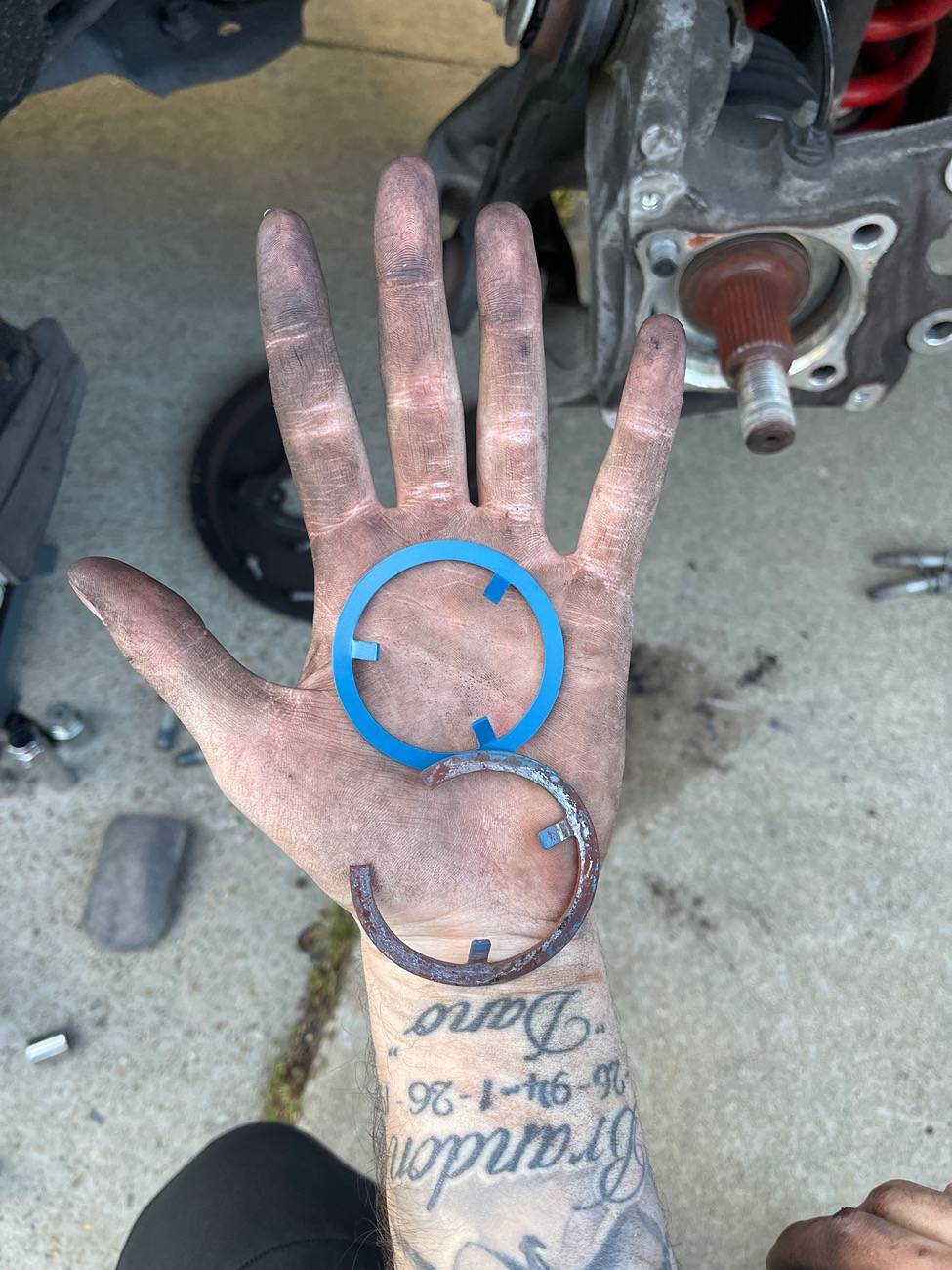

Well I’m here to say after some research I found out what was causing my creaking. Behind my wheel bearing I found this thrust washer completely thrashed. Clicking is now gone. 15$ fix and new axle nut!
