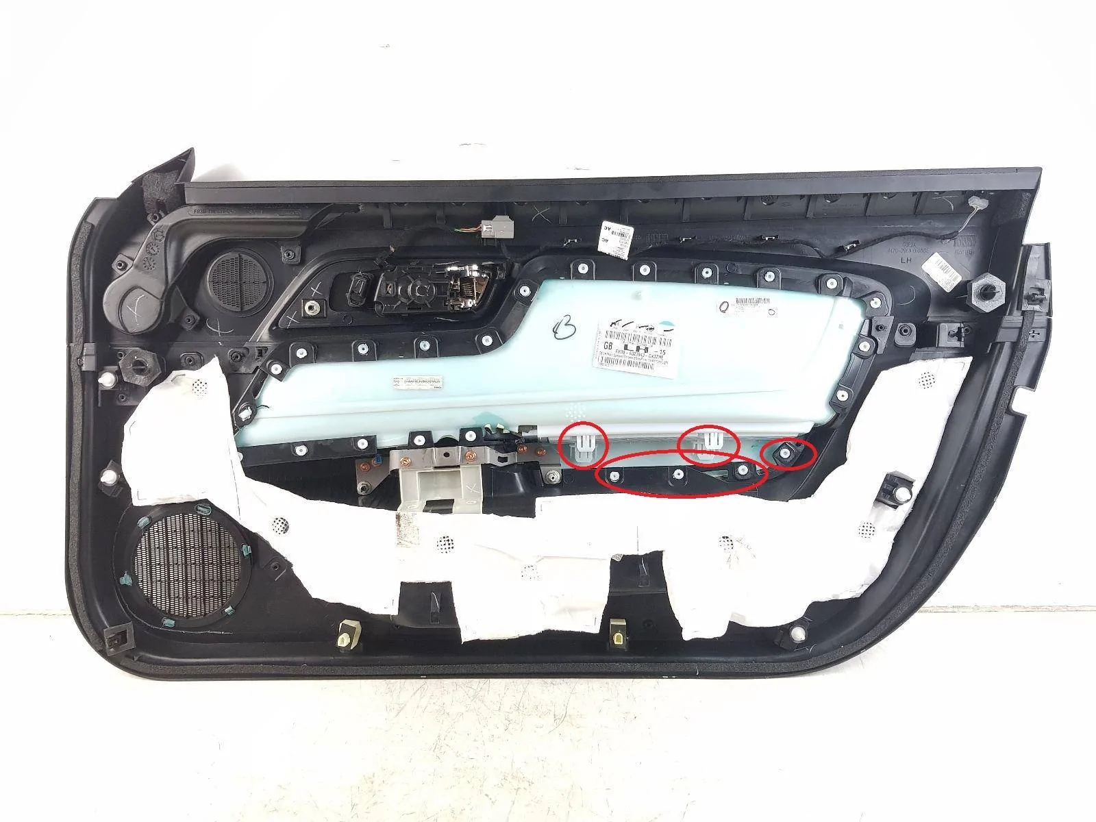

Another thing I found that I forgot to mention... when you have the door panel off. Flip it over and inspect all those heat staked melted plastic rivets. I found a few around the armrest area (where your elbow would rest) that rattled when I tapped the panel. Both door panels had this problem. There was not enough compression between the parts when they melted them over leaving a gap. So, I injected some hot melt under the rivet head to fill the gap and make it solid. I also added some hot melt to the plastic tabs which fasten the arm rest pad to the door. They seemed like a source of noise as well.

I just got back from the Ford dealer. My 2020 Shelby has THIS exact issue. I have a new complete door panel ordered and coming early next week.
