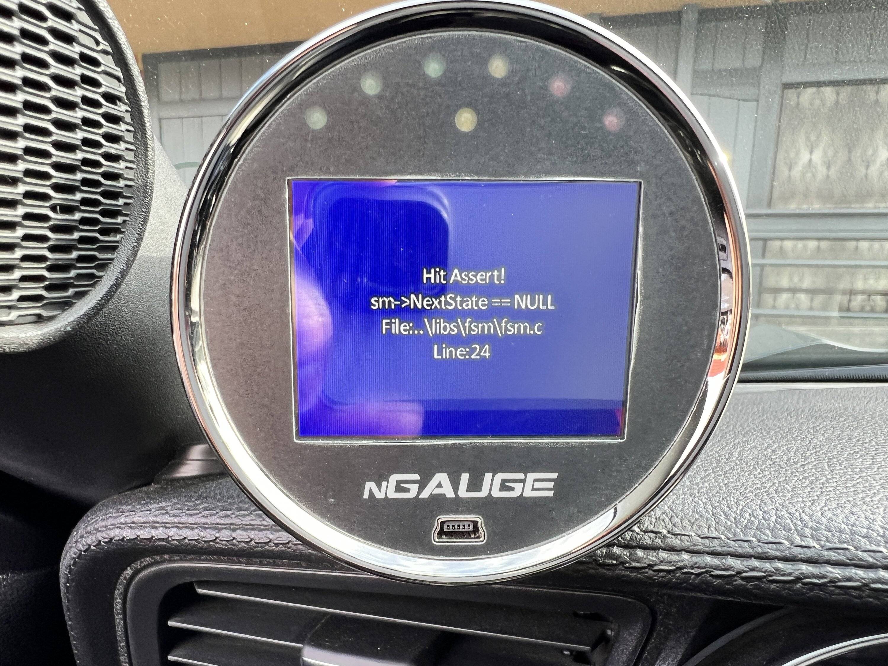

Hi M6G community,
I got a weird error screen on my nGAUGE not too long ago and wanted to see if anyone had this experience.
Hopefully it's not a symptom of it bricking in the future. These are discontinued and it's super helpful.
Thanks in advance!

Some embeded C code encountered an impossible condition, leading to stopping the code to execute (in that "Finite State Machine"module, which is likely very important in the embedded software world).
That being said, I would :
* Restart if (you might have done that already) --> Is this happening again ?
* Reset it completely and retry.
* Re-flash the firmware through USB.
If any of this is working, sounds like some memory corruption due to component failure :(

Well poop (The component failure part).
Yes, I did restart it and it worked fine. Thanks for your response👍

There have been several M6G members that experienced Ngauge issues; many seem to relate to the Ngauge cable.
Check this thread out, read through to page 2:
https://www.mustang6g.com/forums/threads/im-looking-for-ngauge-cable.182653/
I would try a reboot as suggested above, if that doesn’t work then try replacing the cable.
