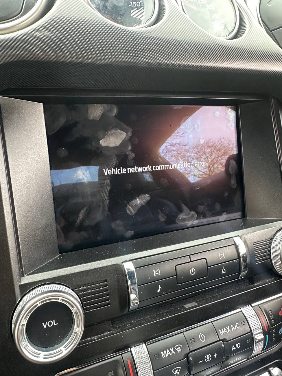

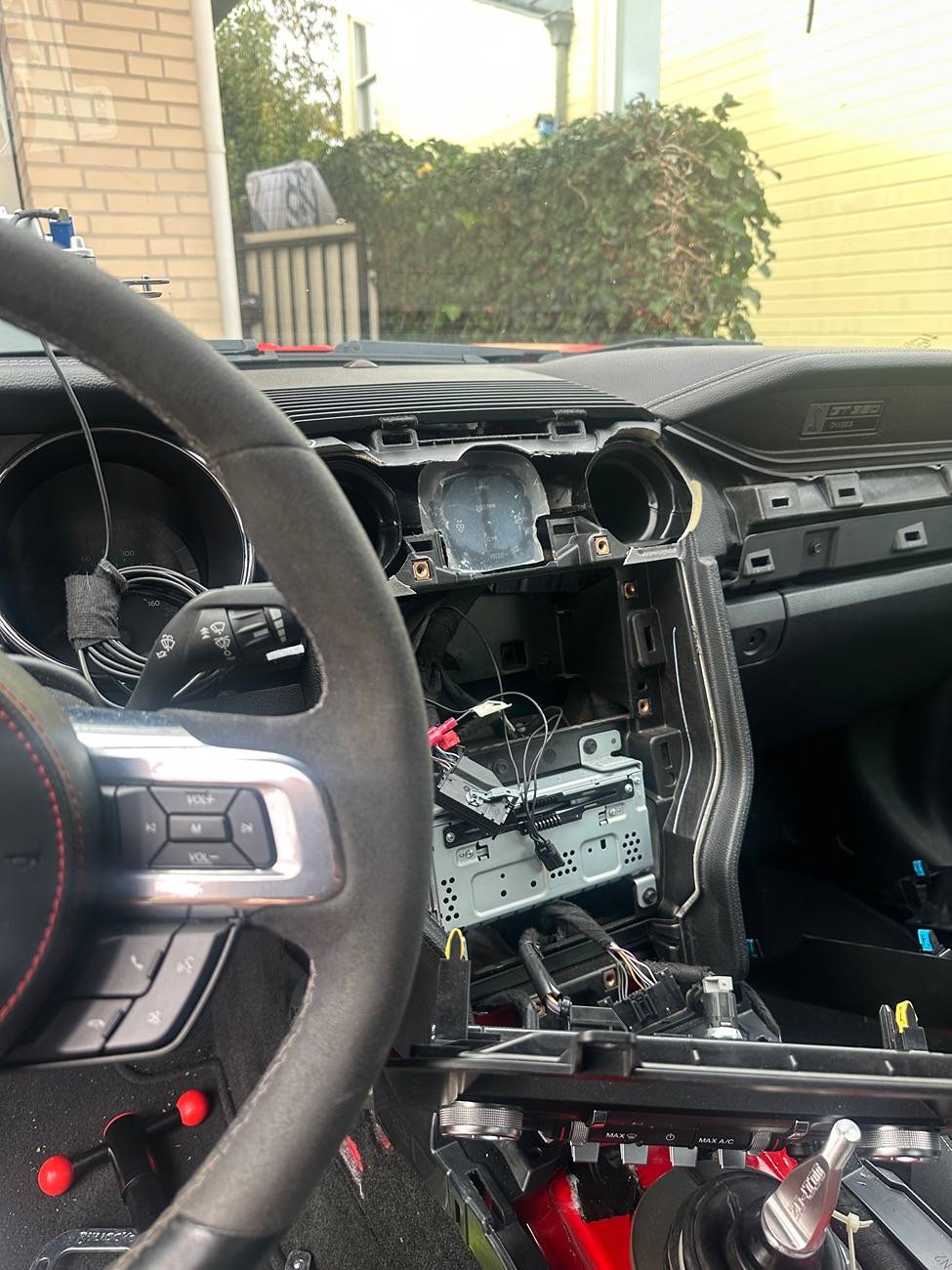

I needed to hardwire for the gauges, and I used normal electricity wires? Since I thought it would work right. Now everything put together. I have a big problem, first I got the message: “vehicle communication error”. And now I can start the car but everything is Blank my Sync 3 and cluster…
The gauges light up, but dont show any data on it, also not on start…

I have now solved it. I will describe it as best as possible: eventually I discovered that my own electronic wire was bridging the wire of the wiring harness and that may have caused a bridging failure. I have now removed the bridge and reconnected it. Now everything works properly - the oil pressure, but I am now going to find out whether this can be switched on via forscan?
