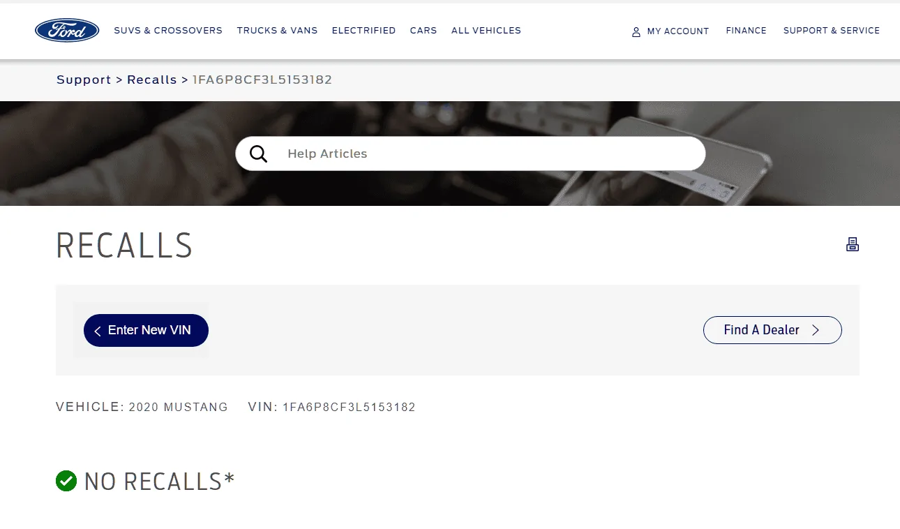

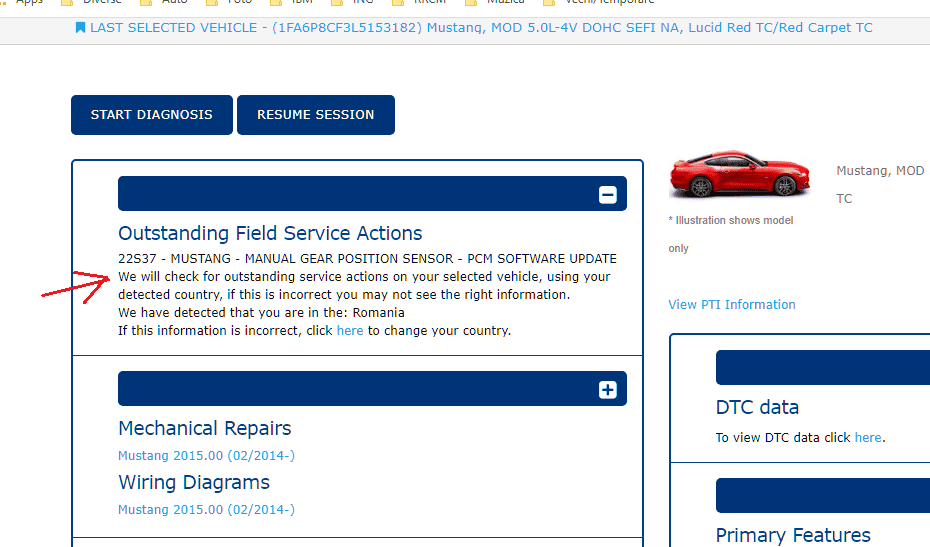

There's something strange though.
I can see the recall in Etis:
But not on the Ford website, which is supposed to be the official place to look for recalls:

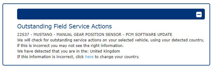

ETIS for my 20 Euro / UK :
WD :like:
