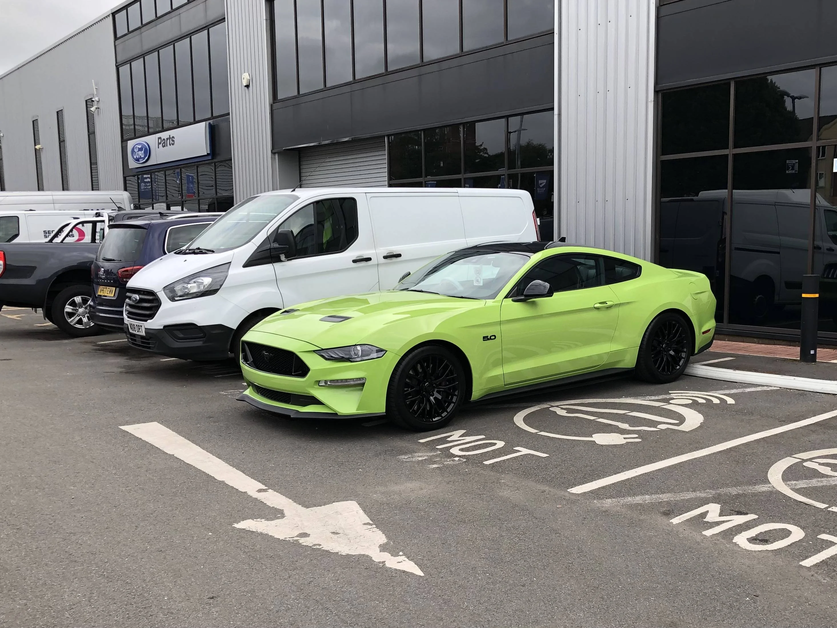

Just to complete my experience of the recall :
PCM recall done :like:
2nd year service done :like:
Having nice day with no shitty roads and no cleaning to do afterwards is a bonus :sunglasses:
WD :like:

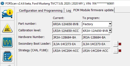

strategy before update: LR3A-14C204-ACC.
After update: LR3A-14C204-ACE
