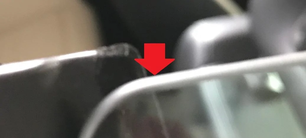

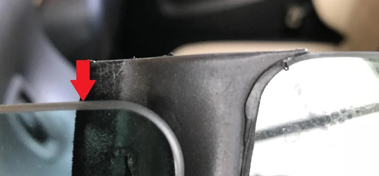

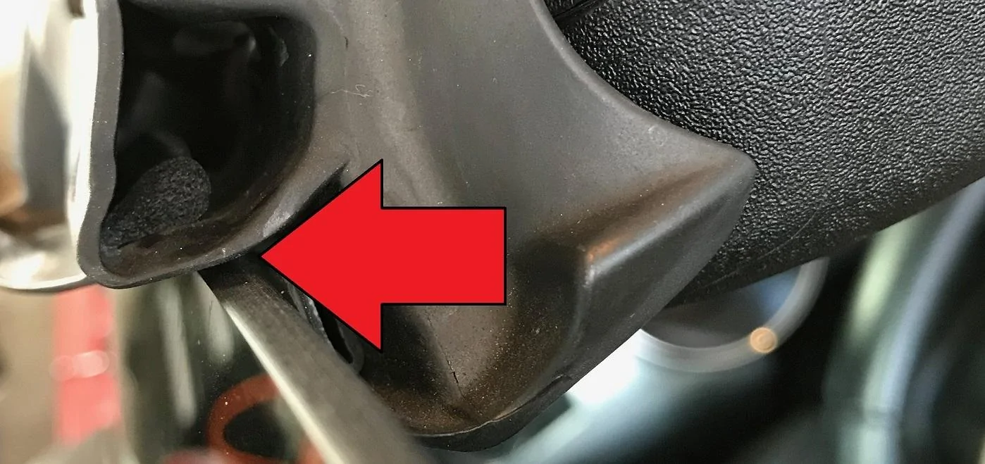

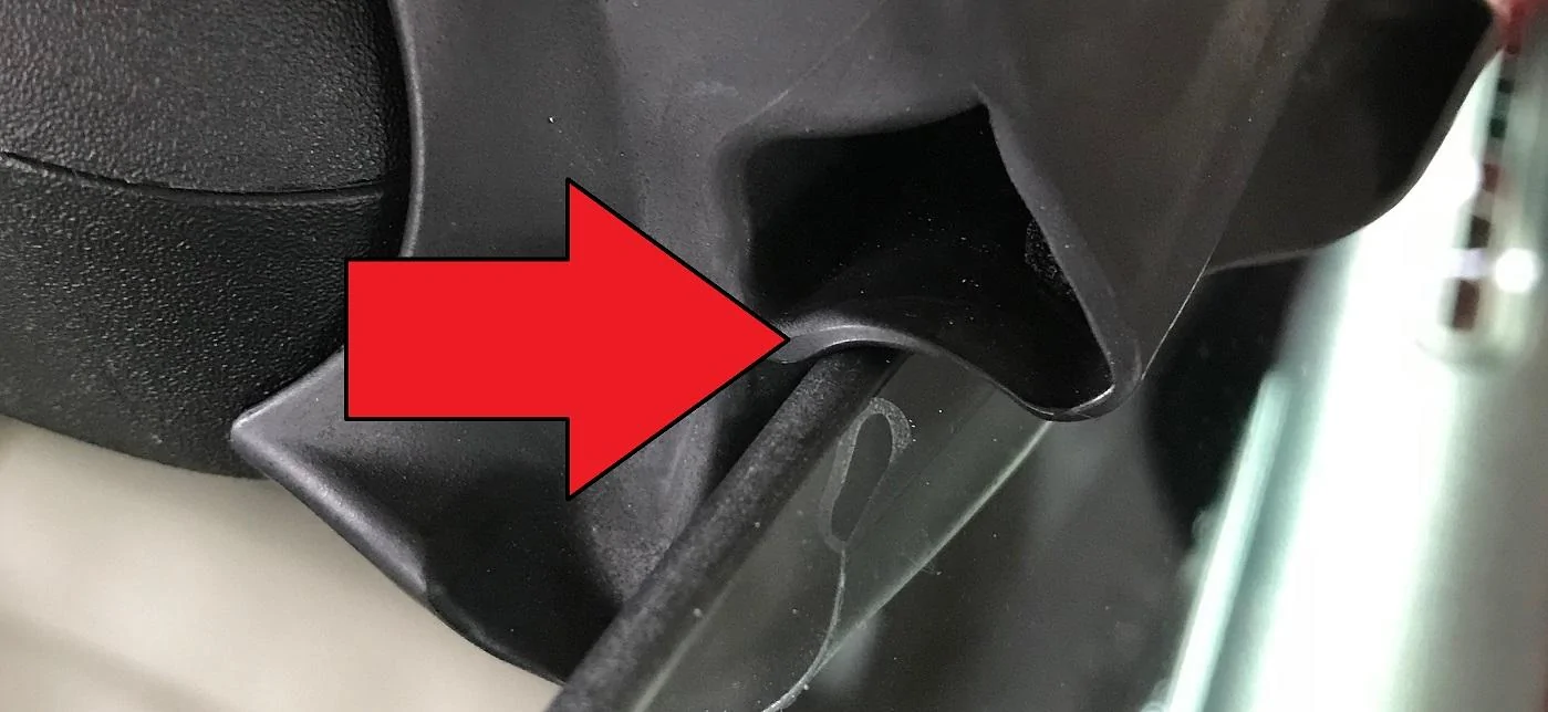

There is a benefit to having a convertible and showing the issue with the glass adjustment after the latch recall.
The first 2 pictures are the passenger side, which has an issue but not a sever as the drivers side, you can see that the window does not come all the way up to the height of the weatherstrip. The glass also does not full engage the weatherstrip at the front of the door at the windscreen.
The second 2 pictures are the drivers side and even more severe gap at the front and back.

Agreed. Until I put the top down I was envisioning the numerous excuses that I was going to hear from the dealer. Open and shut case and an easy fix.
The tech should have set the windows with the top down and for hardtops they should mark the window positions when completely up to aid with re-alignment.

FIXED!!!
So here is the deal: When the technician put everything back together he used "dust" marks as the indicator for where the window should be. That's not ideal. Also they program the windows for height and the program is only as good as where the window is in the clips.
The technician reset the door in the clips in and ignored what he thought were good reference points and then went though the window height program and all appears to be fine.

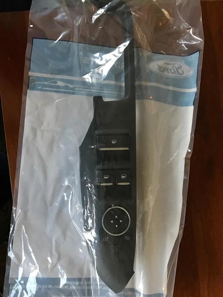

Dealer called me today. Said that the technician ordered a replacement switch panel for my car. Apparently he cracked one of the tabs so the dealer bought me a new one to have put on. They probably did not need to, or even tell me, but they did! :thumbsup:

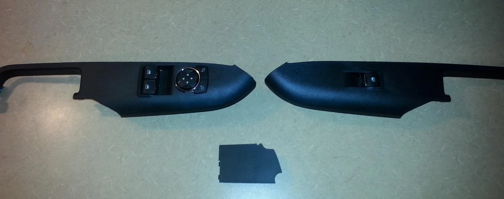

My window wind noise is now better and I have two new window switch plates on the way. Apparently the last time he did something to the little panel behind the door handle that is removed to access a screw. It now rattles when the door is closed and over bumps. I guess they can look at that too when they replace the other two pieces.

After a few attempts to make an appointment and then bad weather cancelled (I don't drive the Stang in snow), I pulled the parts from the car myself and made a trade with the dealer. Here are the 3 parts they broke that needed replacing - these are the new ones I installed myself. I have to admit I did have some trouble removing the door panel parts - but you would think a dealer would know where all the tabs are and be more careful. I was guessing and yanking.
