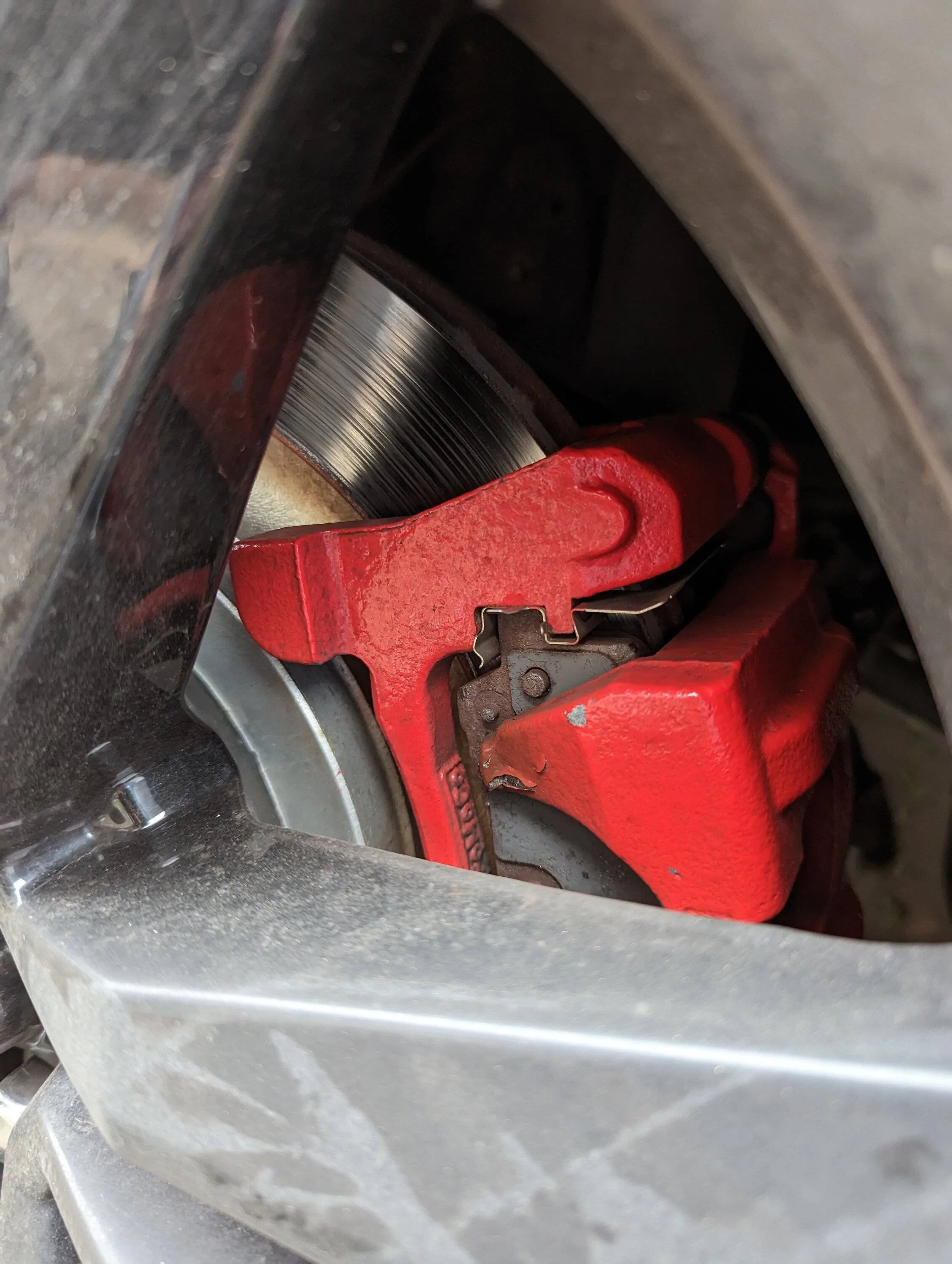

So back in October my car failed it's MOT on the handbrake efficiency. I was able to clean up the mechanisms on the caliper and it was working fine untill recently where I basically don't have a handbrake so I have to park in gear and it looks like the brakes are binding slightly.

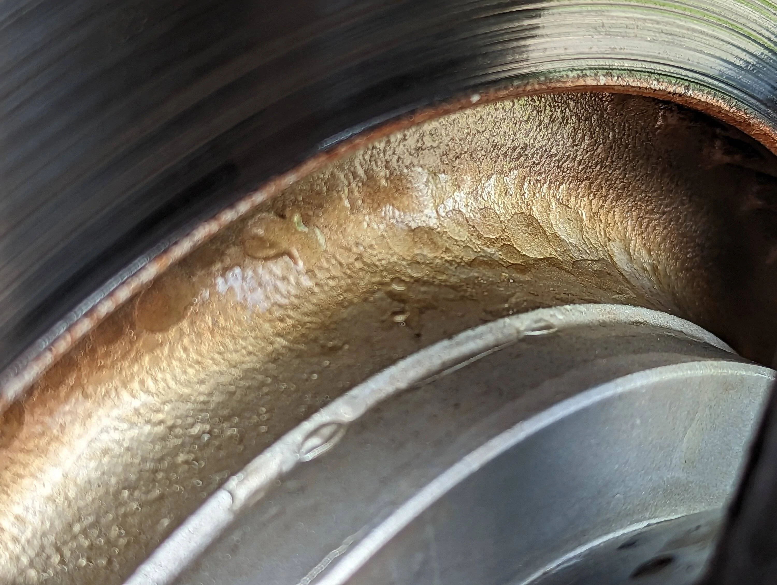

Yeah I think it's the calipers mate, I got an AA patrol to clean the spring mechanism up at the rear and free them back in October, and didn't need to touch the tensioner bolt. And based on the calipers and brake disks I think the caliper is stuck at some point between on and off as it also looks like it's getting hotter than it should.
Here's my disks.

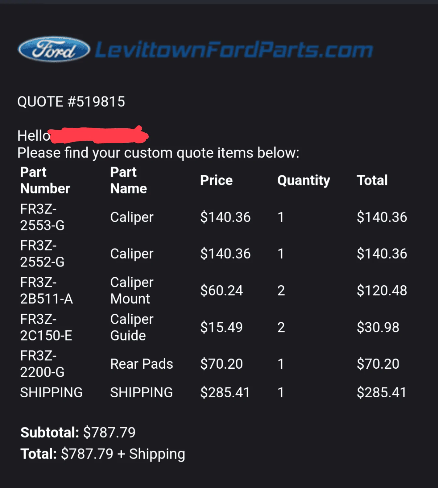

Iv had a look at Tasca Parts, think it works out to about £280 for 2 calipers with shipping which I don't think is too bad so might order from them. Pads and everything else I'd just look at getting in the UK, I'm sure they shouldn't be as difficult or expensive.
I would have a look at refurbing but I think it would be easier and less to go wrong if i just replace. And it's my daily so the easier and quicker the better tbf.
Unless anyone knows of the same calipers are used on any other Ford cars.
This is what Levittown Ford have quoted -

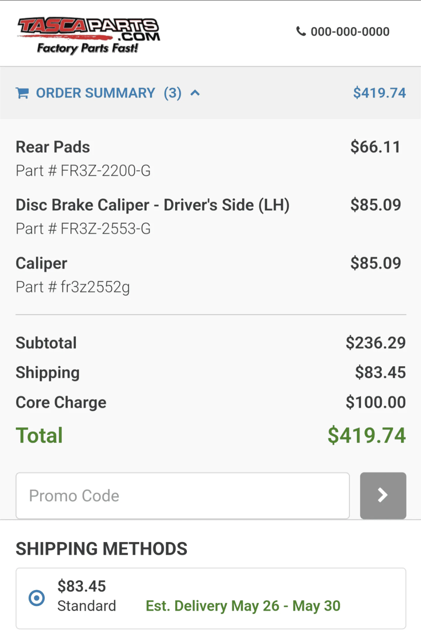

Thanks for the recommendations. I went ahead and ordered from Tasca parts in the end and added the pads on anyway as I doubt they'd be much different price wise over here and saves me searching.
American parts websites always seem so much better than what we get here, just enter your VIN and it gives you diagrams and breakdowns to make it easy lol
£350 in total.
