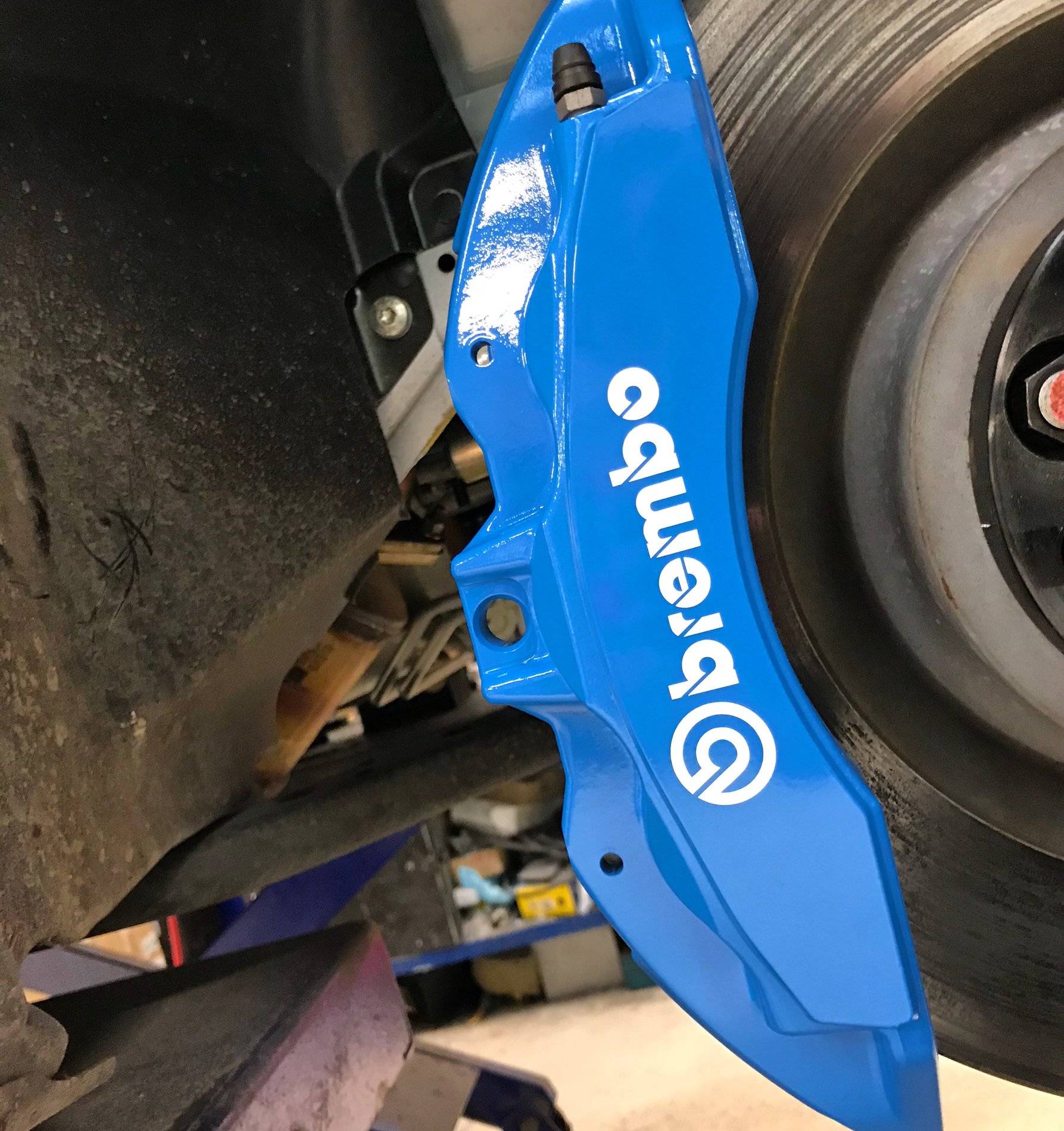

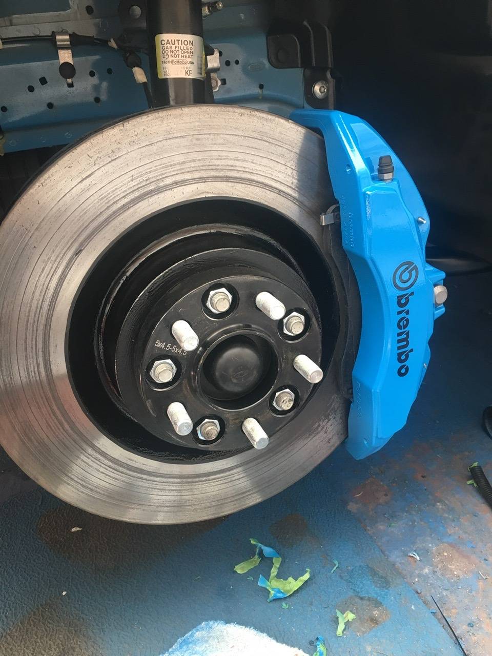

I had all my calipers painted on my DIB car. I had them painted in a light blue almost a Grabber Blue or the Focus RS colour. This was done by a friend in a body shop and I think i paid £30.00 a corner. This may seem cheap but at the same time I did have a quarter panel and the bumper painted so may have had a deal on this.
As far as I'm aware these were all masked and painted whilst on the car in an oven and I bought some white brembo stickers on ebay which they fitted and then clear coated over the top. These have been done a year now and are still looking good.
I had then done in light blue rather than DIB as I already had the factory nickle wheels but was awaiting delivery of my GT 350 replica wheels in gloss grey which I think they look the business.

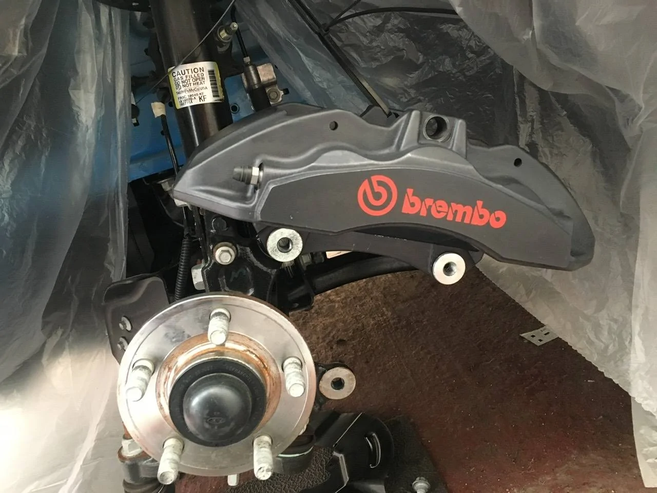

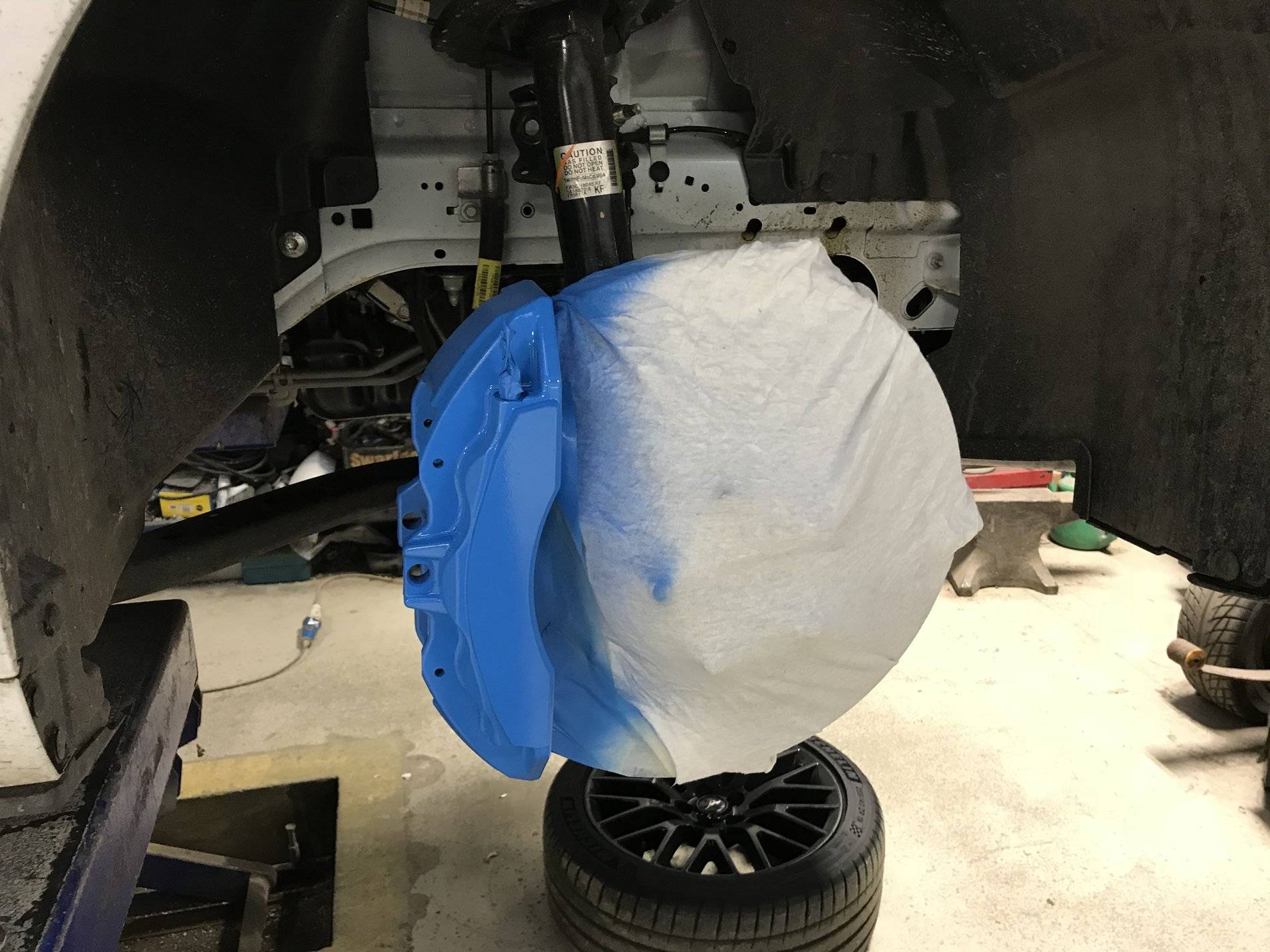

Did mine myself used a rattle can of 2pak , prep is what took time masking car up ect, car was only a month old so only needed to scotchbrite them, 18months later still looked great

Great job! I'd be happy with results like that...What about the drying? Assume you did it in warm weather?

Hi it was may time , just left for a few hours before refitting then drove next day all good

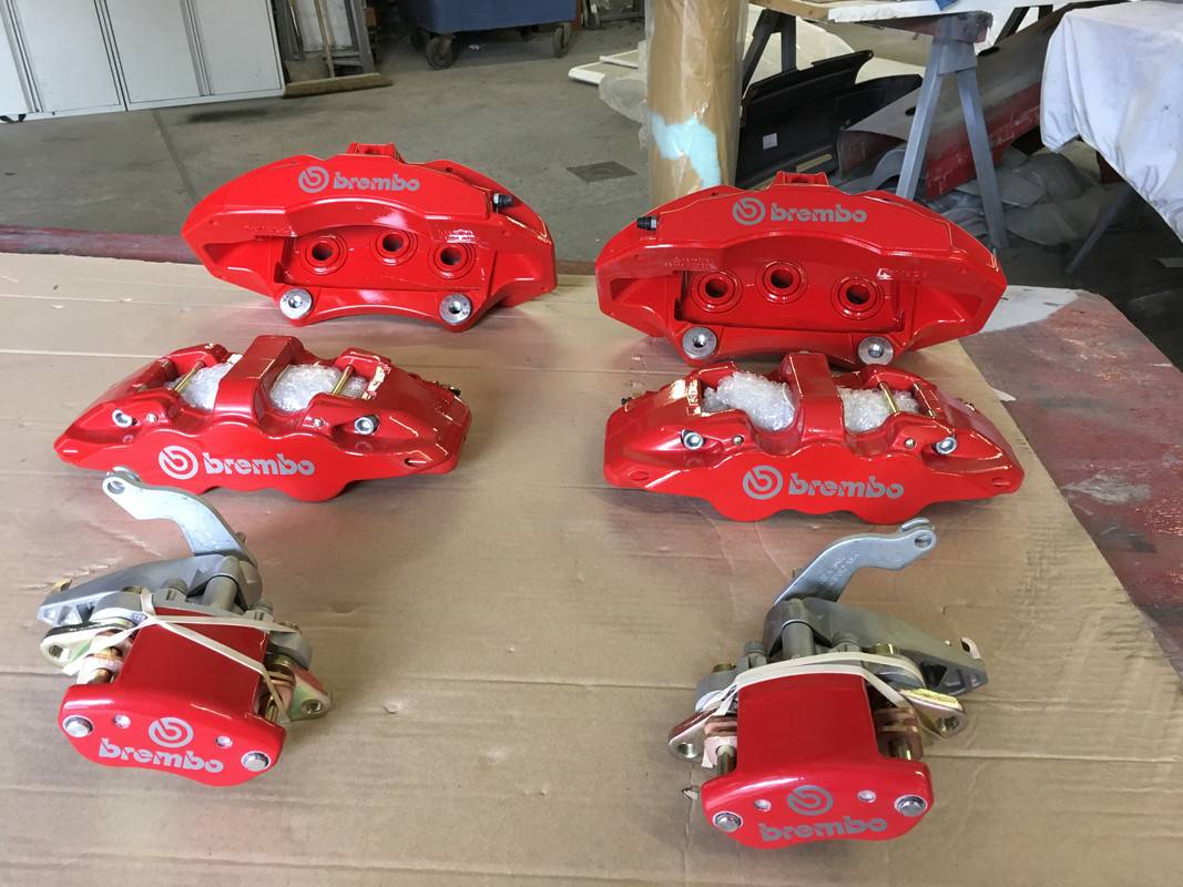

Mine were done by a friend at a local body repair shop...he just used normal 2 pack.
