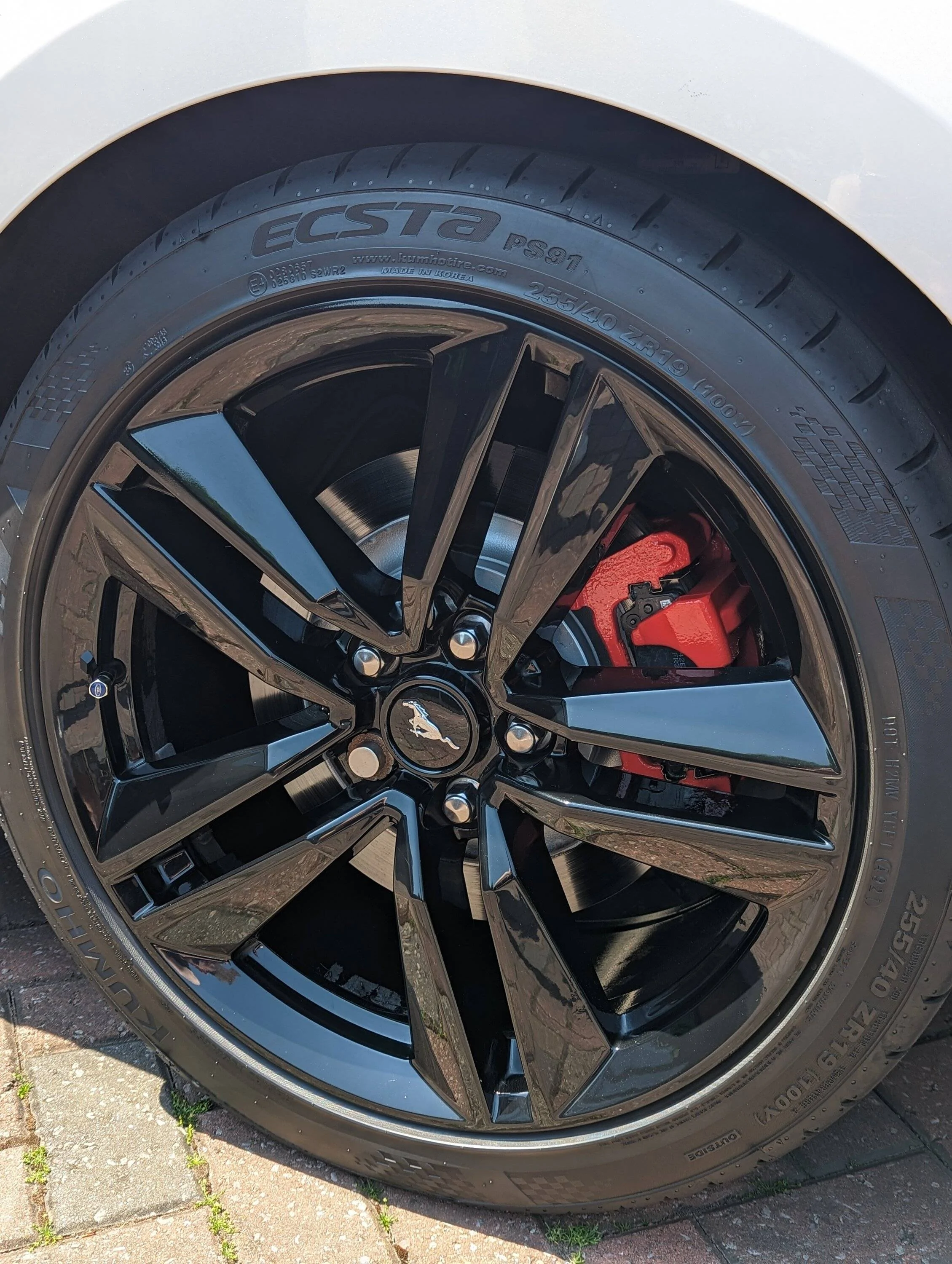

I got a wire brush on the hub section, used some surface cleaner, taped up and then sprayed. I didn't do the outter edge unfortunately, was trying to be quick, was really hot and nose was dripping all over the place :cwl: I'll touch up the caliper carrier tomorrow.

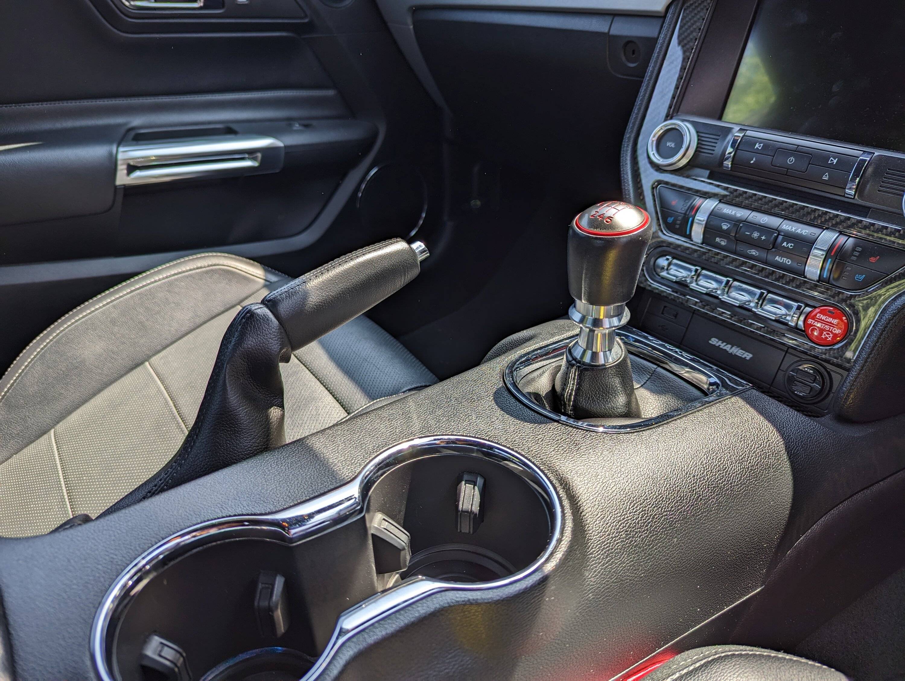

Finally complete, nice to have a working handbrake again that ain't pointing towards the sky and still rolling. :crackup: it did also need a bit of adjustment underneath.

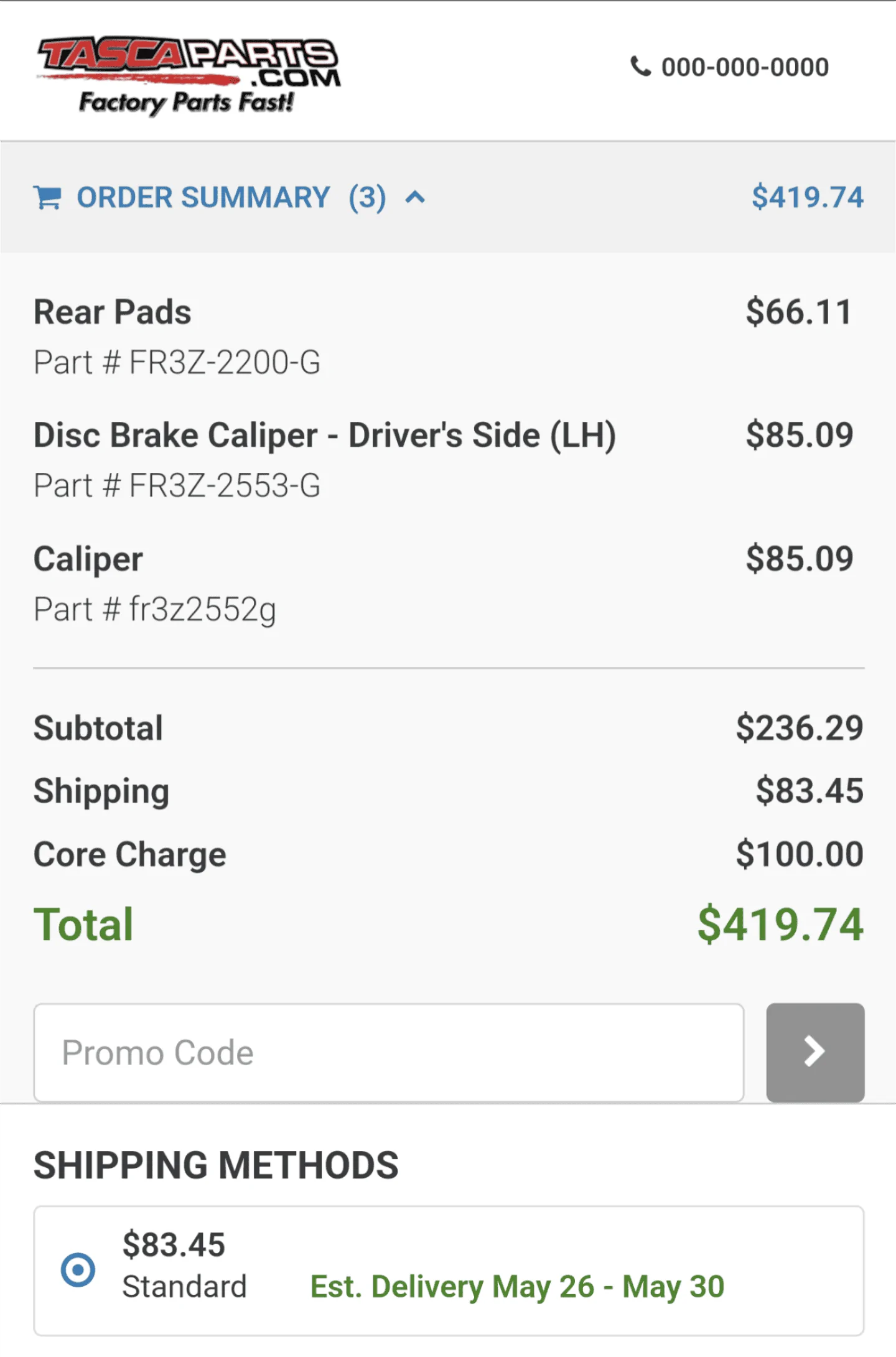

Thanks for the recommendations. I went ahead and ordered from Tasca parts in the end and added the pads on anyway as I doubt they'd be much different price wise over here and saves me searching.
American parts websites always seem so much better than what we get here, just enter your VIN and it gives you diagrams and breakdowns to make it easy lol
£350 in total.
