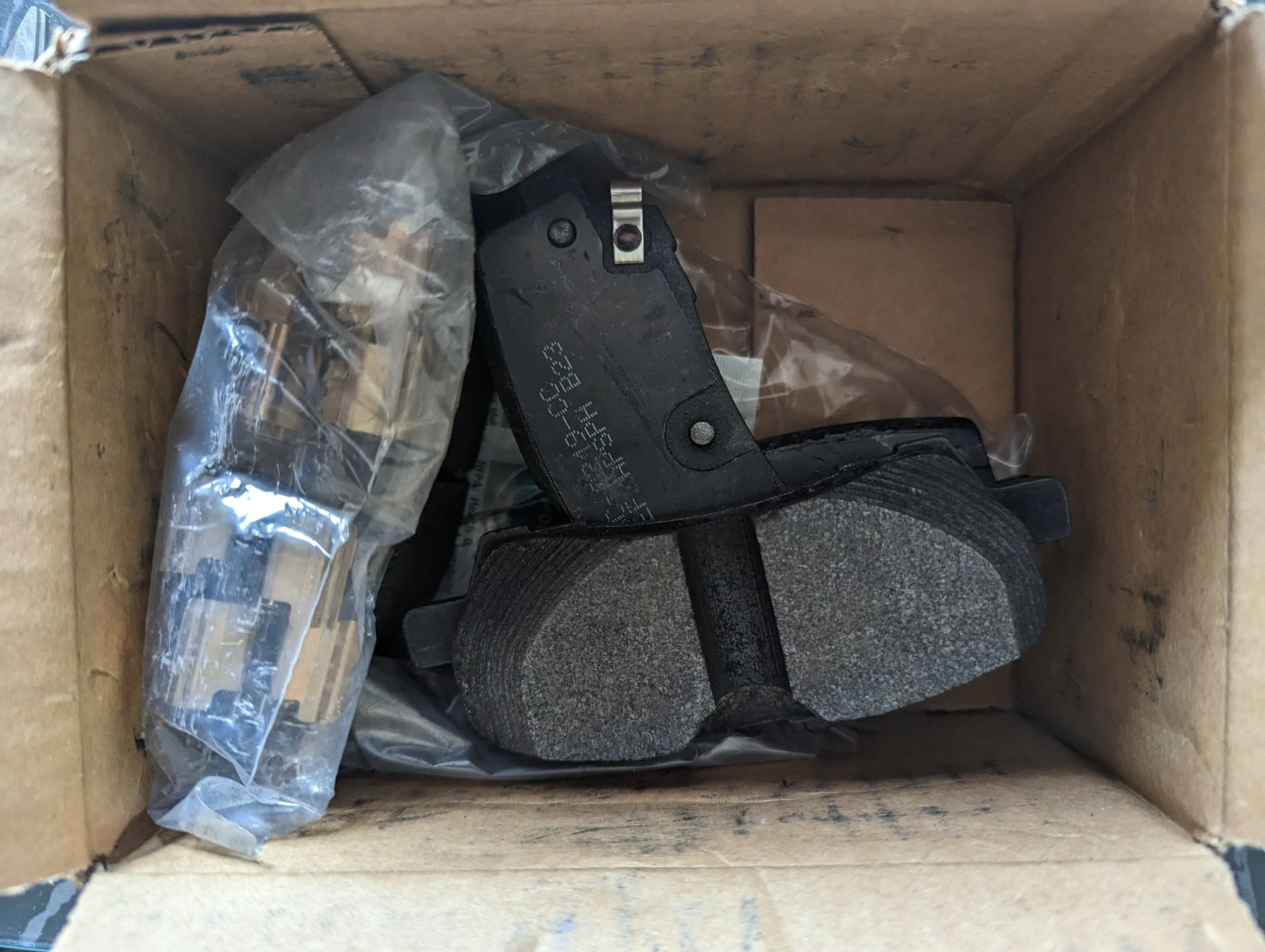

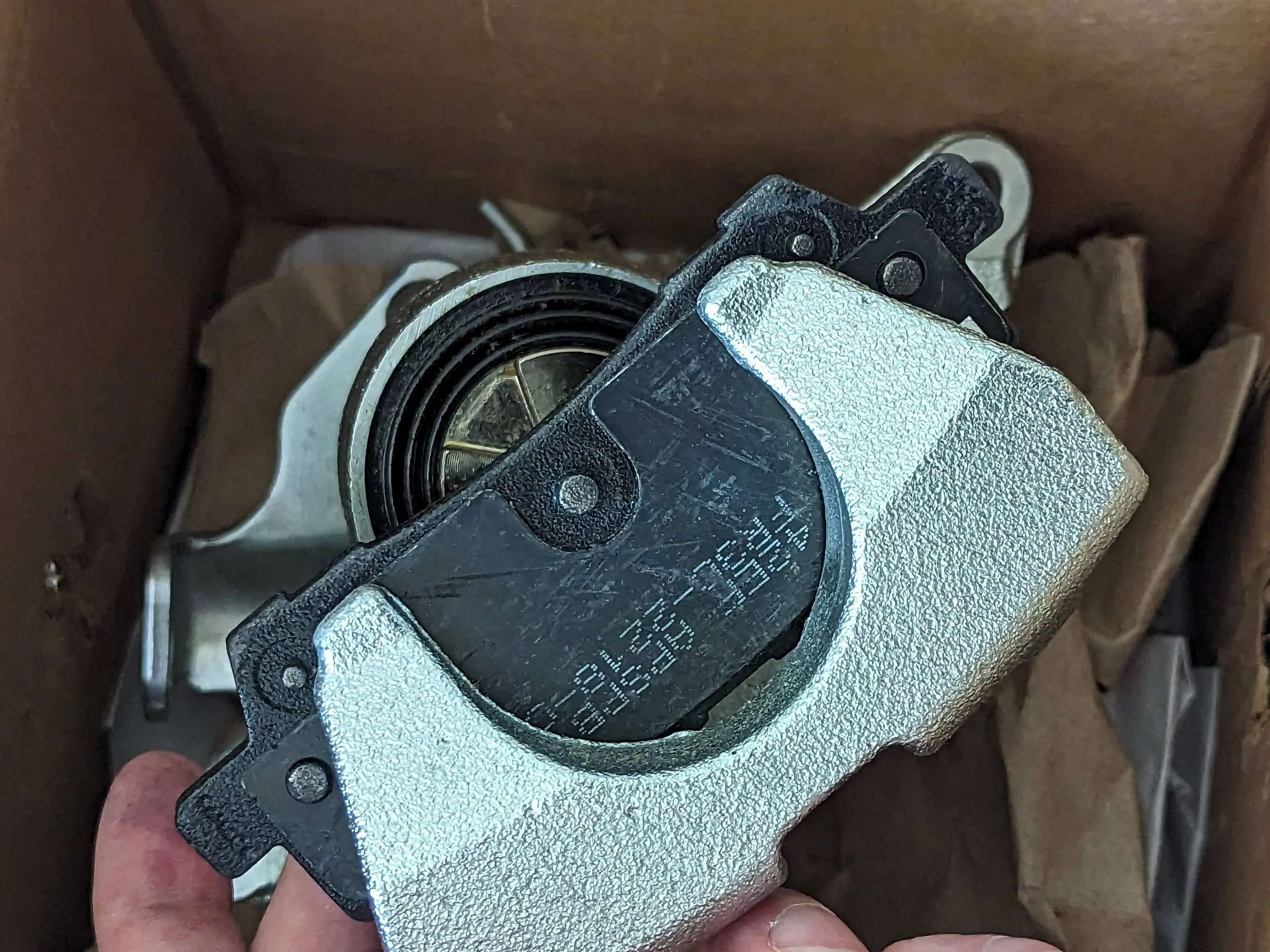

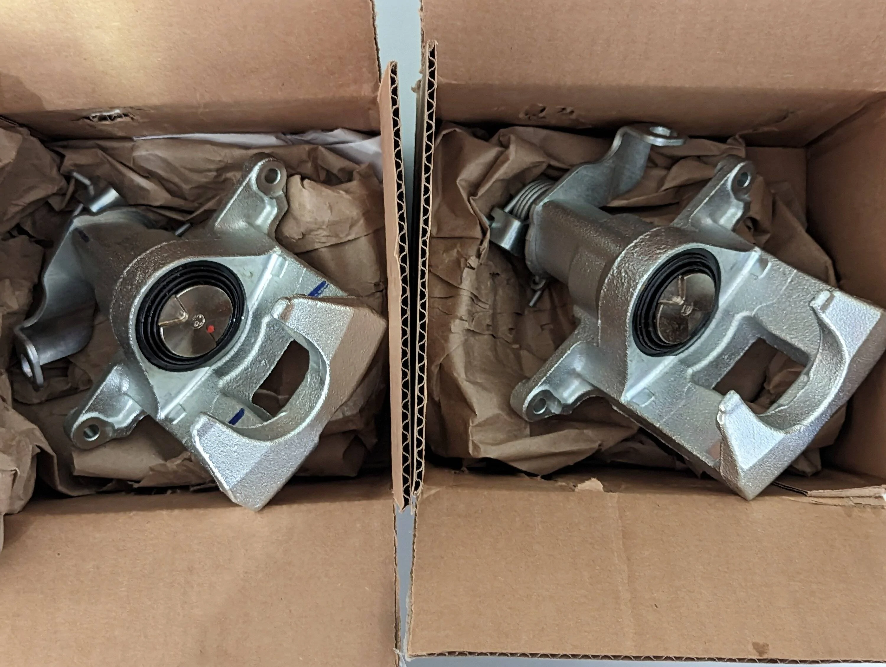

Parts have been delivered, was quite quick tbf, will definitely use Tasca again, thanks for the suggestion. £80 customs fees which at about £430 overall is still cheaper than buying parts here. And all looks about right for now, pads look to be the same as what's currently on the car and they sit into the new calipers.
Just need to get some brake fluid and find some time to get them changed, I'll let you know how it goes.

I bet the ‘incompatibility’ just comes down the colour.
The American PP cars get black rear callipers which we also get, but you wouldn’t really know (even when new) unless you looked really closely.
The black paint is that thinly applied you can still see the zinc showing through.
(like my silver / black door cards) I actually thought I had one of each, but it just depended which side of the car was in the sun or not … lol
More obvious under workshop / indirect lighting - which did confirm both sides are black :

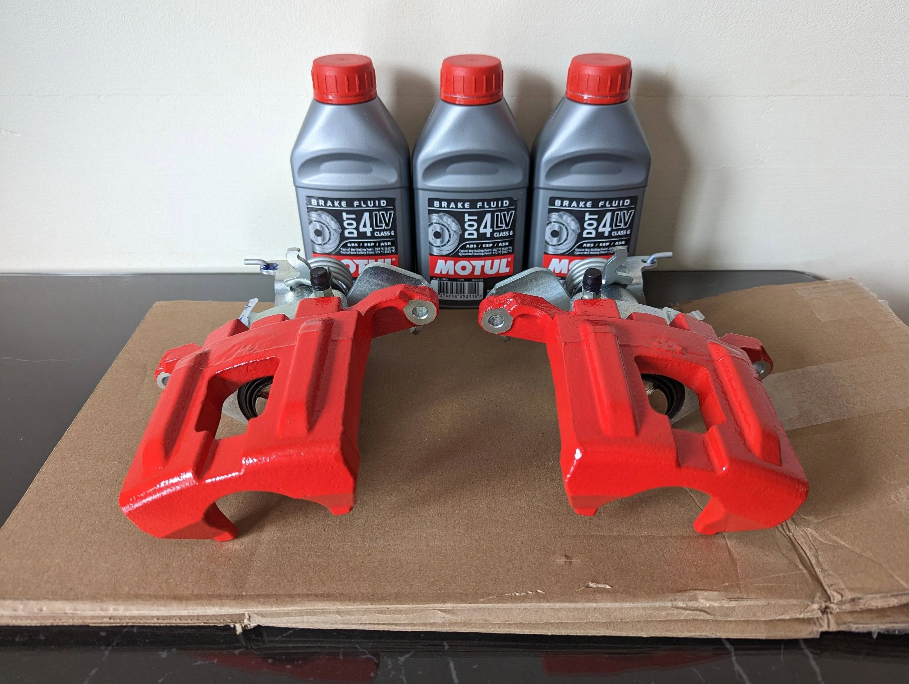

Maybe the part numbers are colour related then, they all looked pretty much the same, I always thought we get a lot of PP parts thrown in on UK Mustangs anyway because I swear our 2.3's get the same 4 pots as the US base GT and UK GT's get the PP 6 pot Brembo's standard? (If I'm right?)
But then I wasn't sure if the rears are the same across all models.
and I hope they're right and work all ok because iv already painted them in advance while they're off the car :cwl:

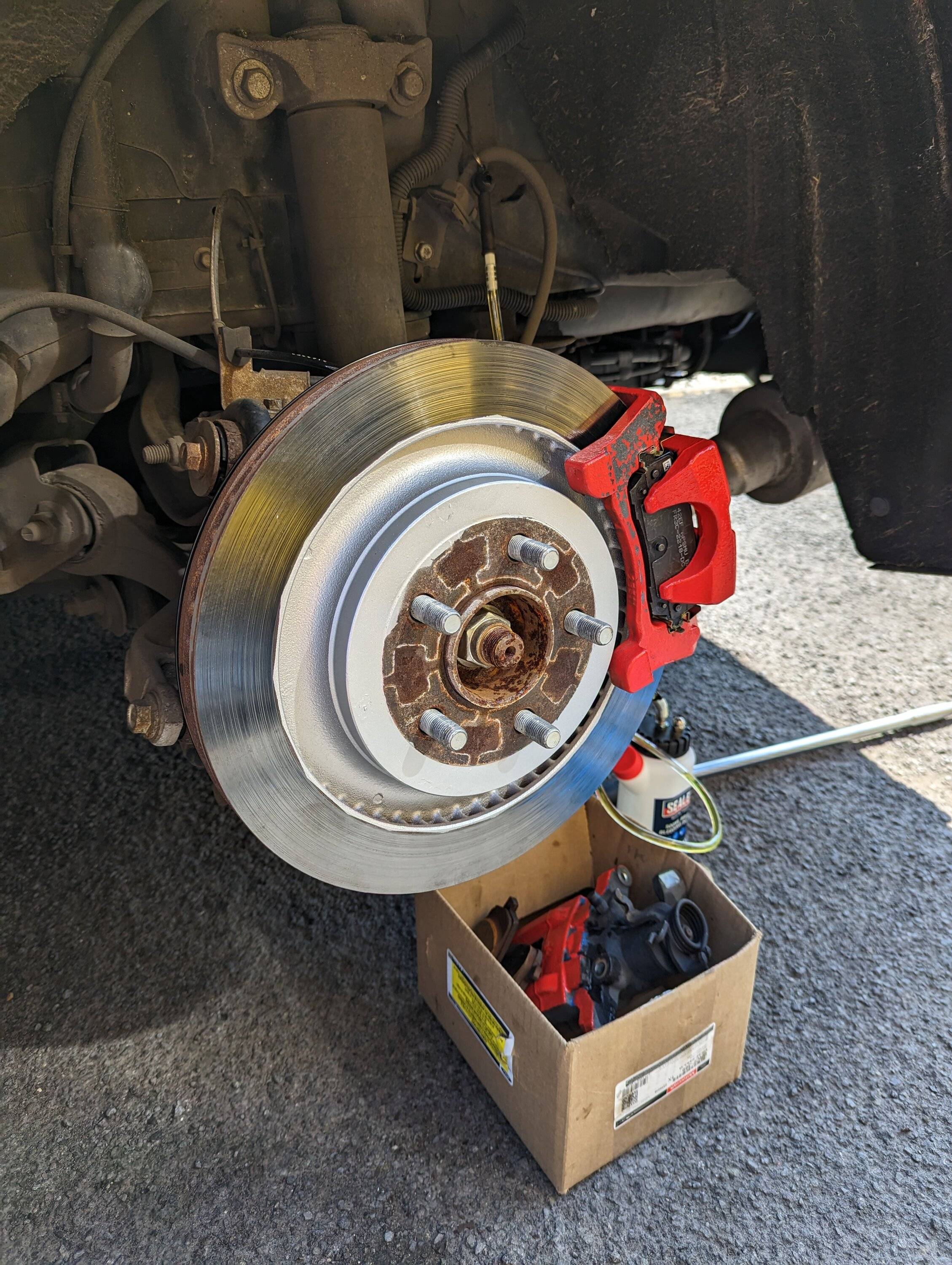

Finally got around to doing it all today, all worked out pretty well tbf, handbrake is now much better and actually holds the car, was quite hot today and my hayfever was being horrific while trying to get it done.
Ended up needing a new water pump too since mine was leaking, that was another £130 from Bristol Street Motors and £13 per 1l bottle of concentrated coolant.
Just need to paint the Caliper carriers now, I reused the brake discs since there is plenty of life left on them and iv already spent enough money, but excuse the poor masking tape job, using the brakes will sort that out lol. It's definitely not as clean as WD Pro's behind the wheel. :cwl:
