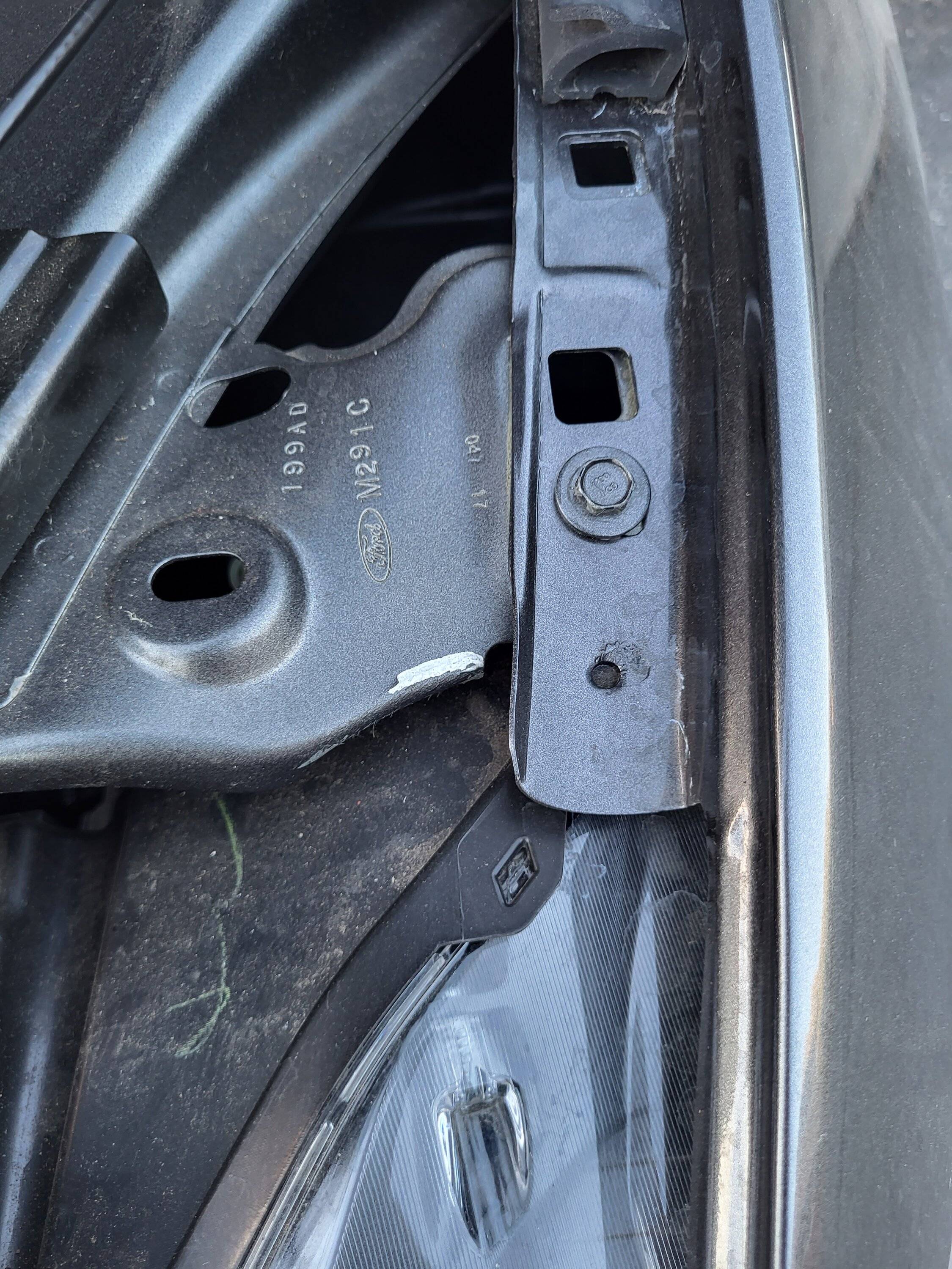

Small paint chip on the driver fender support.. bent at one point?
Paint chips and marks next to the air intake
Noticeable dent behind the drivers headlight but NO other visible dents, frame is also prestine from what I can tell.. I'll remove the fender liner to inspect better.
After market fenders? They also feel like if they were made out of plastic?

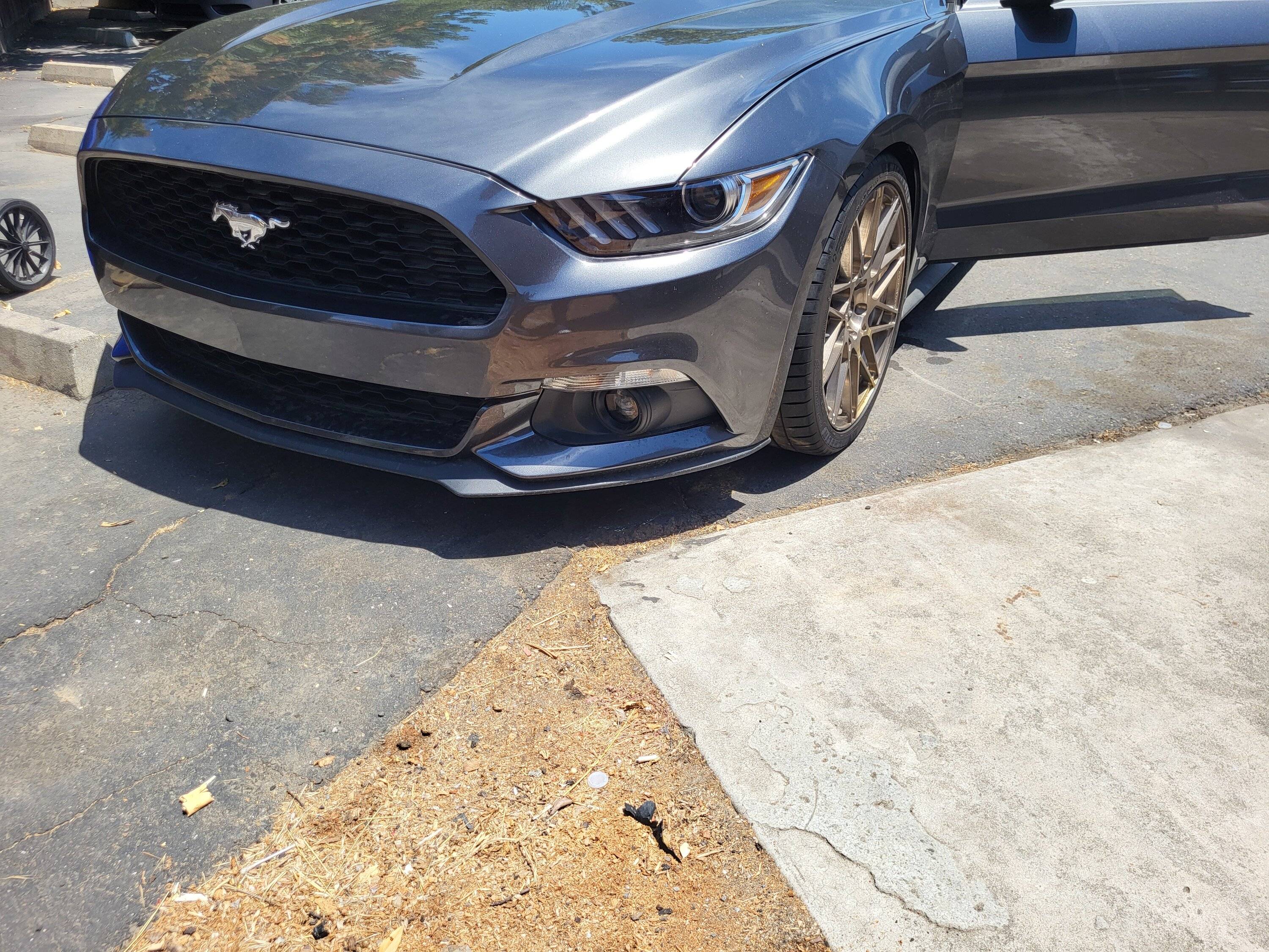

I guess the car was in a front end accident at a time. Probably the past owner rear ended someone.
The new chinese front bumper and third party mud guards, along with bent parts point at this.

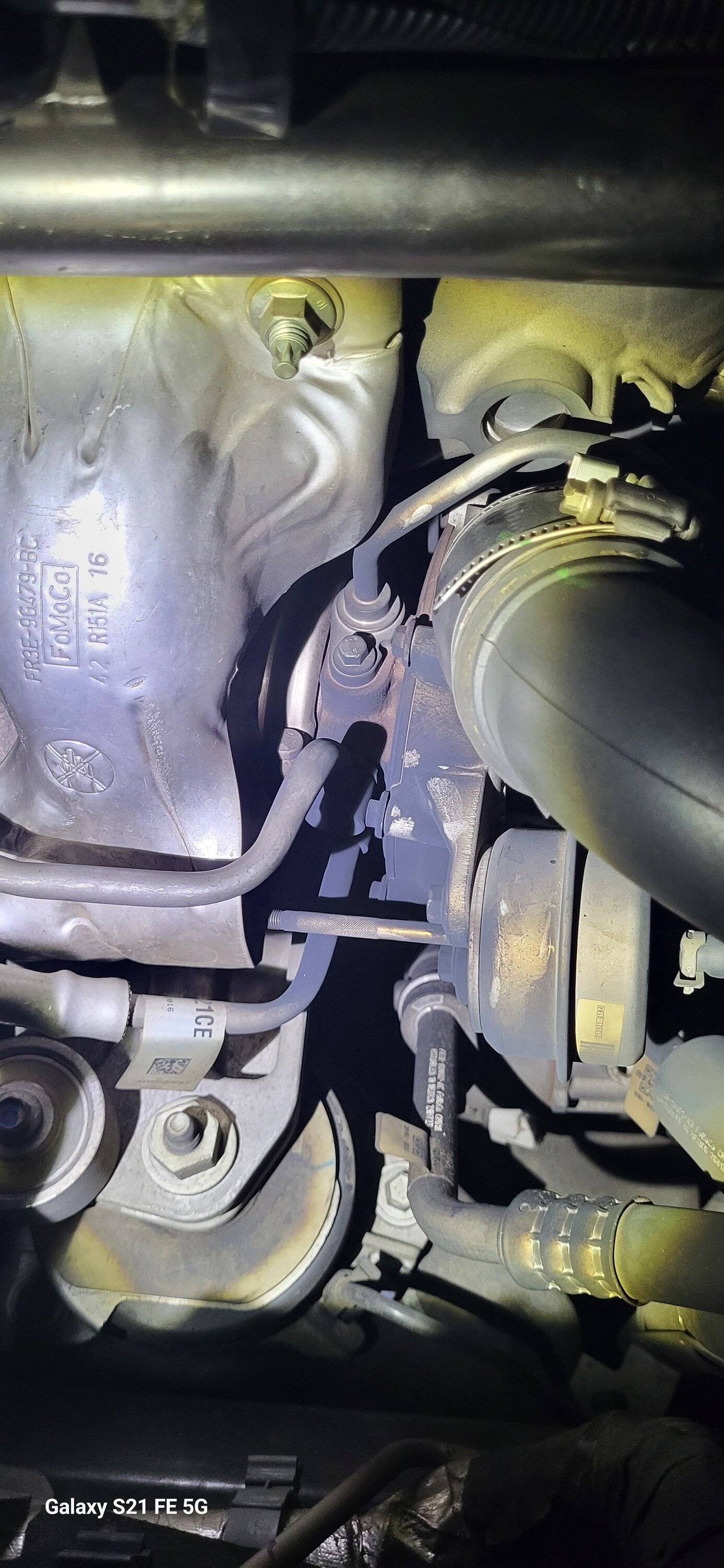

Been a wile since I've posted, the service contract aka extended warranty has been terminated. Unfortunately NOW the car started having an issue... great!

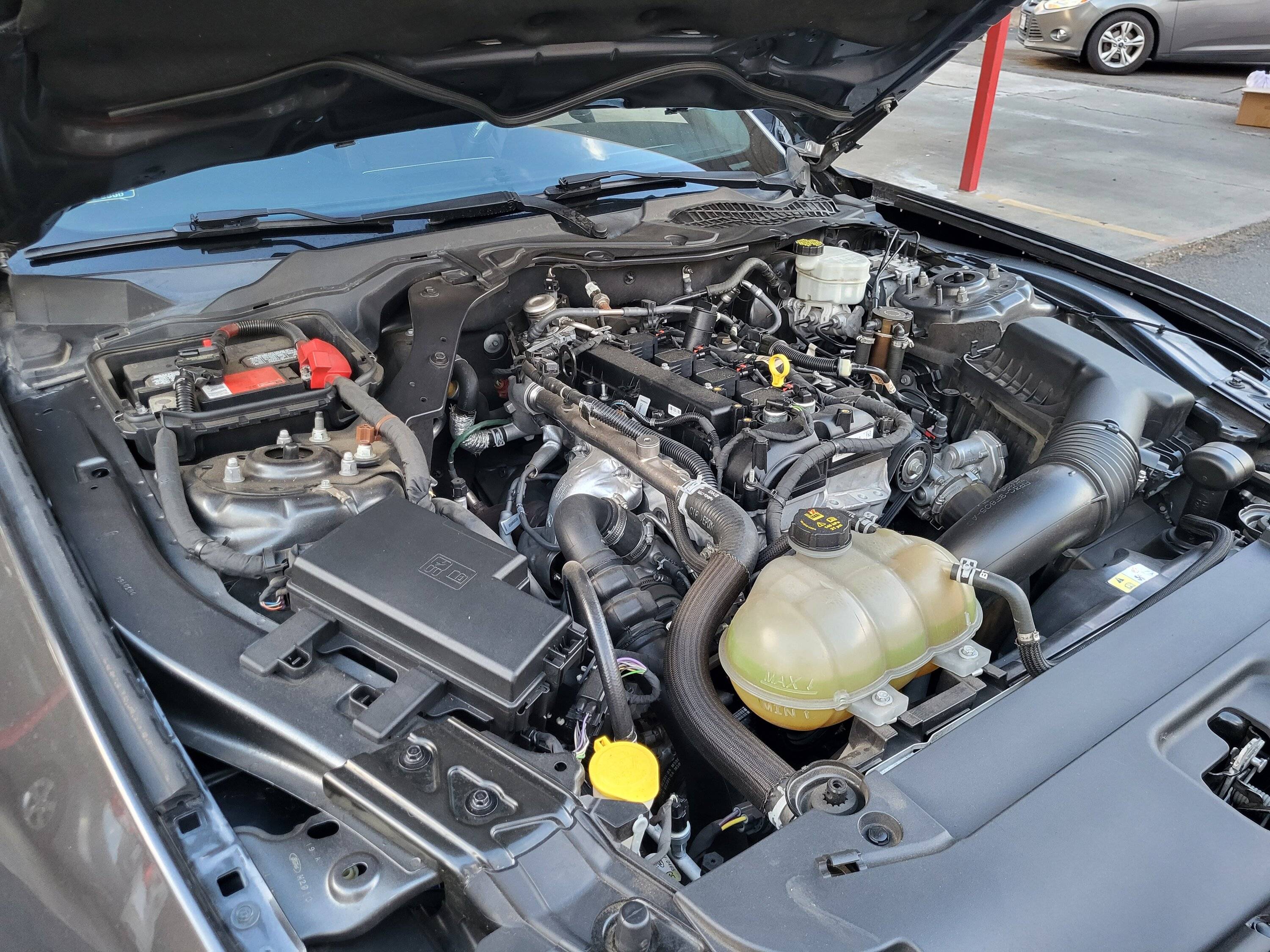

Once in a wile the car gets a code P0171, I've checked for vacuum leaks, removed the Mishimoto oil catch can and installed the PCV house, but haven't found anything, thought It was bad fuel, but nothing changes even after cleaning the map sensor.
Aside from the code, the car also "stutters" wile on idle the rpm drops to the point where it seems the engine might turn off, well last night it did that after I parked and my bro noticed smoke from the passenger headlight, with the car on we poped the hood and didn't see anything at first then it started stuttering again and and stopped after noticable puff smoke came out of the turbo, that same smoke(exhaust) is coming into the cabin, irritating our eyes, making our clothes smell and giving us a headache(or dizziness) got to love exhaust fumes...

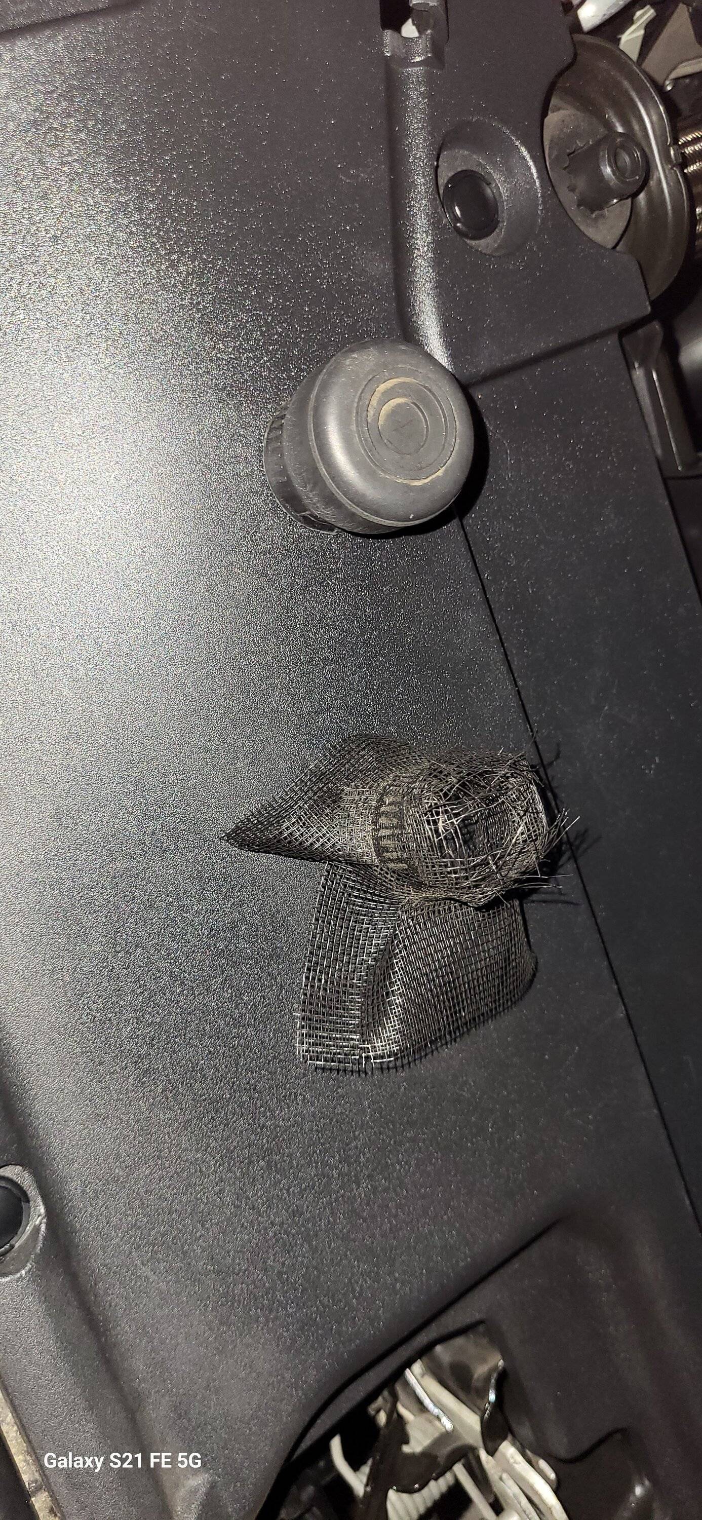

Well this is the damage
Turbo soot
Since then I've stopped driving the car..
I also found that, I removed it and installed a proper hose.. just trying to eliminate any possible causes..

Looks to me like an exhaust leak. That alone, if it's before the O2 sensors, can cause the engine to believe it's lean. The first thing I'd try is to tighten up the bolts and see if that changes anything.
