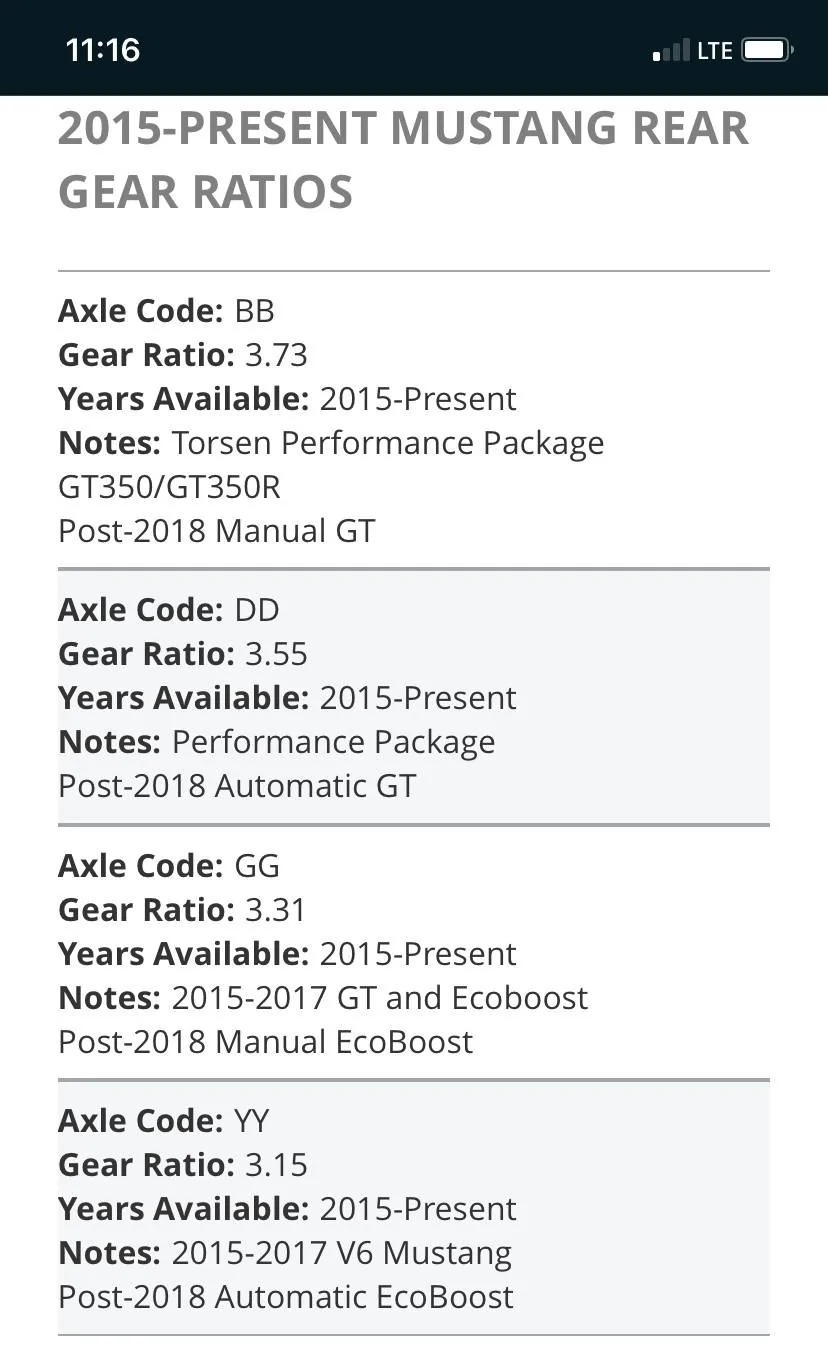

I want a 2021 Mustang GT not a 22 that's down on HP and torque. Which leads to the next concern. I want an automatic. I prefer a 3:55 rear gear but running into 3:15 mostly. What's the downside to a 3:15 ?

There should not be a GT with 3.15…?
edit: shows what I know about a10s…

3.15 is standard gear ratio in the gt. Here's my 3.55 option that was $795. I test drove 3.15 geared a10 & my 3.55 a10 car was a bit quicker or snappier feeling.

To answer your questions. The ā€œ10HPā€ loss is a crock. It’s measured at the crank not the wheels. You will never feel it.
The 3.55 will feel better off the line, a little more peppy. The downside is higher revs and slightly decreased fuel mileage. I would have preferred the 3.55 on my 19’ GT/CS A10 but the car I chose had the 3.15’s. Three years in and I’m fine with it.
Unless you find a smokin’ deal on a 21ā€˜ do yourself a favor and get a 22ā€˜.

The 3.55 gear was a $300 option on mine. (I think it was $300, may have been $350). Mine is manual, not sure how it is for the Autos.
In a M6 car the 3.55 is cheaper because you start with the 3.31. It’s the same pumpkin as the 3.31. The 3.15 uses a different pumpkin so moving up costs more.
