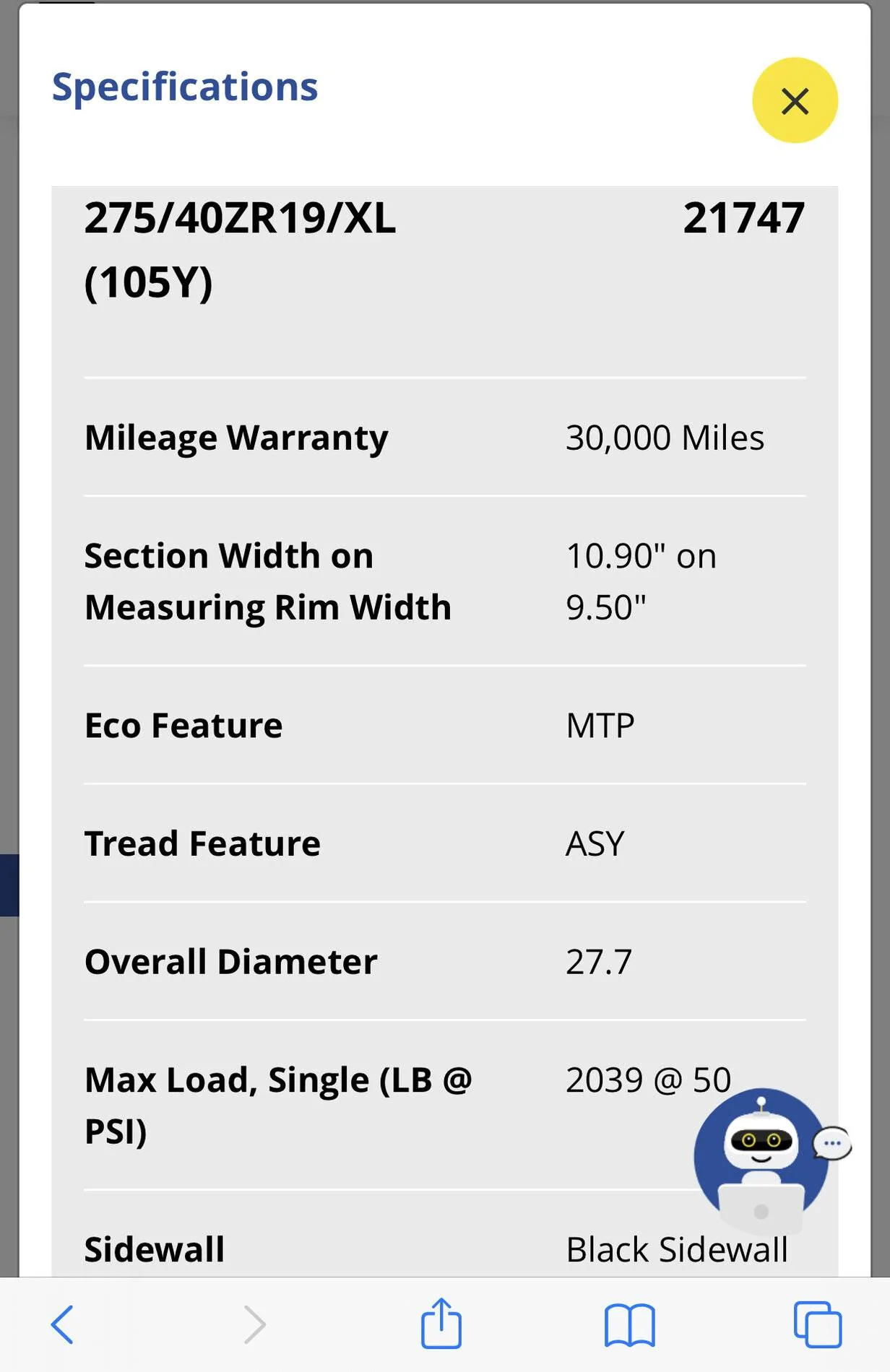

The tires I currently have, have a section width of 11.4" and tread width of 10.3".
The 275/35 (100Y) Pilot Super Sports have a section width of 10.9" and tread width of 9.6"
The 275/35 (96Y) Pilot Sport 4S have the same section width of 10.9" but according to tire rack a 9.1" tread width...(is it just me or does 9.1" tread width seem really small?)
So I was thinking either one of those might be a decent improvement? Sucks they are expensive...but, at least lightweight.

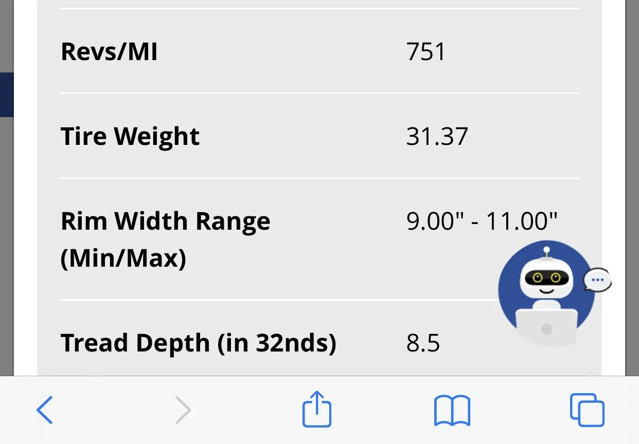

No worries at all. Well, if 275/40 is good, cant imagine 275/35 of the same tire would be bad. Here's the question of the hour for me though, I wonder what the tread width is on the factory 275/40 PS4s?

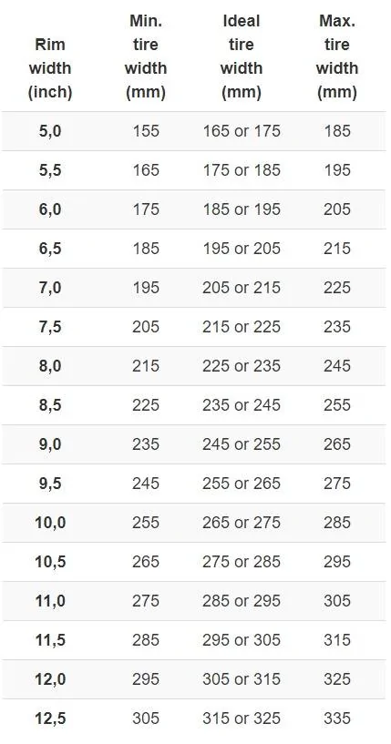

That said, I have a set of VMR V710 19X9.5 wheels for my PP2 for winter. they currently take a Blizzak LM-32 275/35R19 (Fr:ET22, Rr: ET45) with no issues that I can see. At the same time, I do not push my car in winter. I run a 305/30R19 on the OEM in summer.

Like I said, some tires can fit a wider range of rims that what is listed on the chart. You DWS 06 can go to a 11" rim. Of course, that doesn't mean it will improve traction, handling and cornering. It just means it will fit. That is car dependent.
