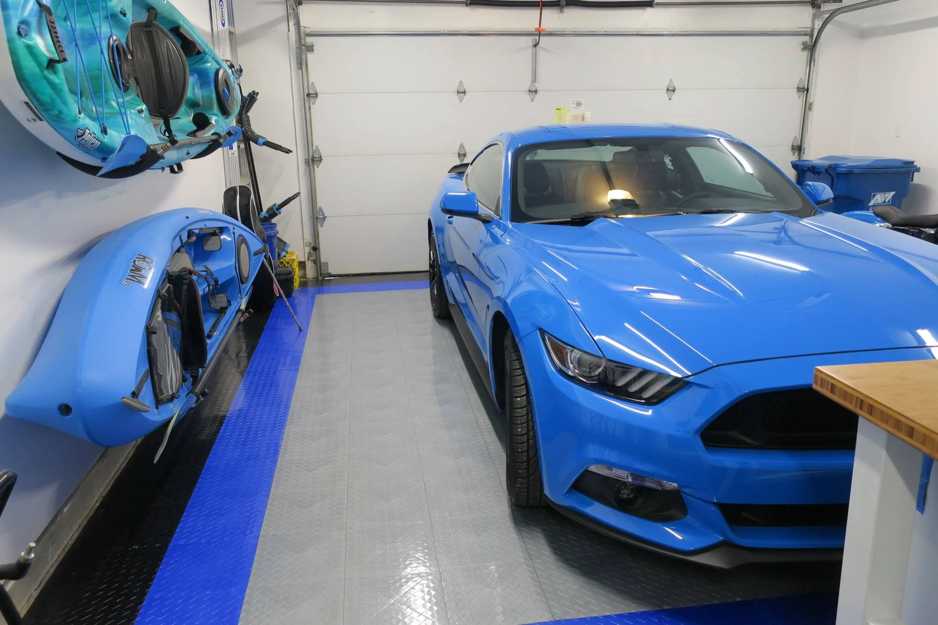

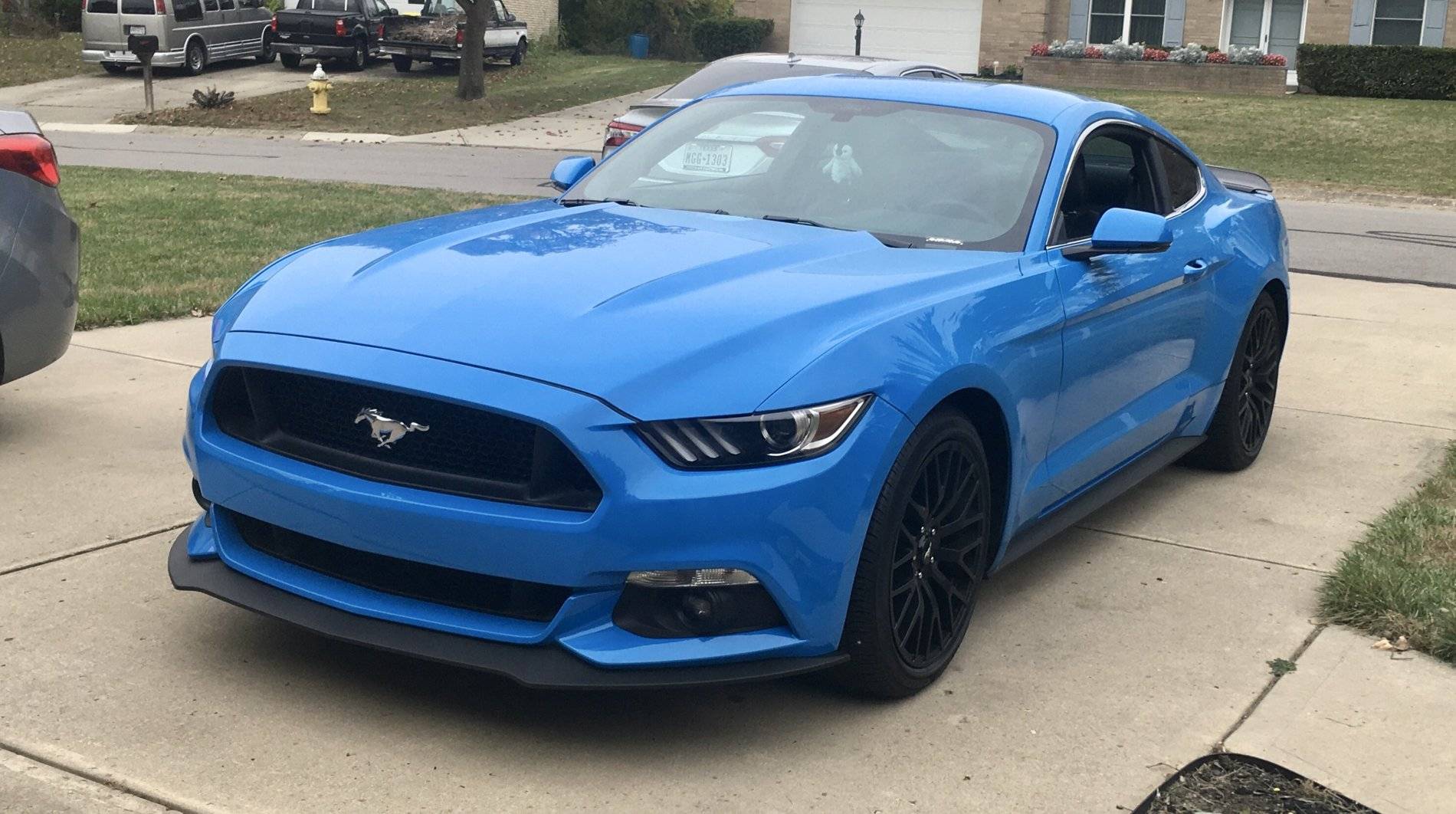

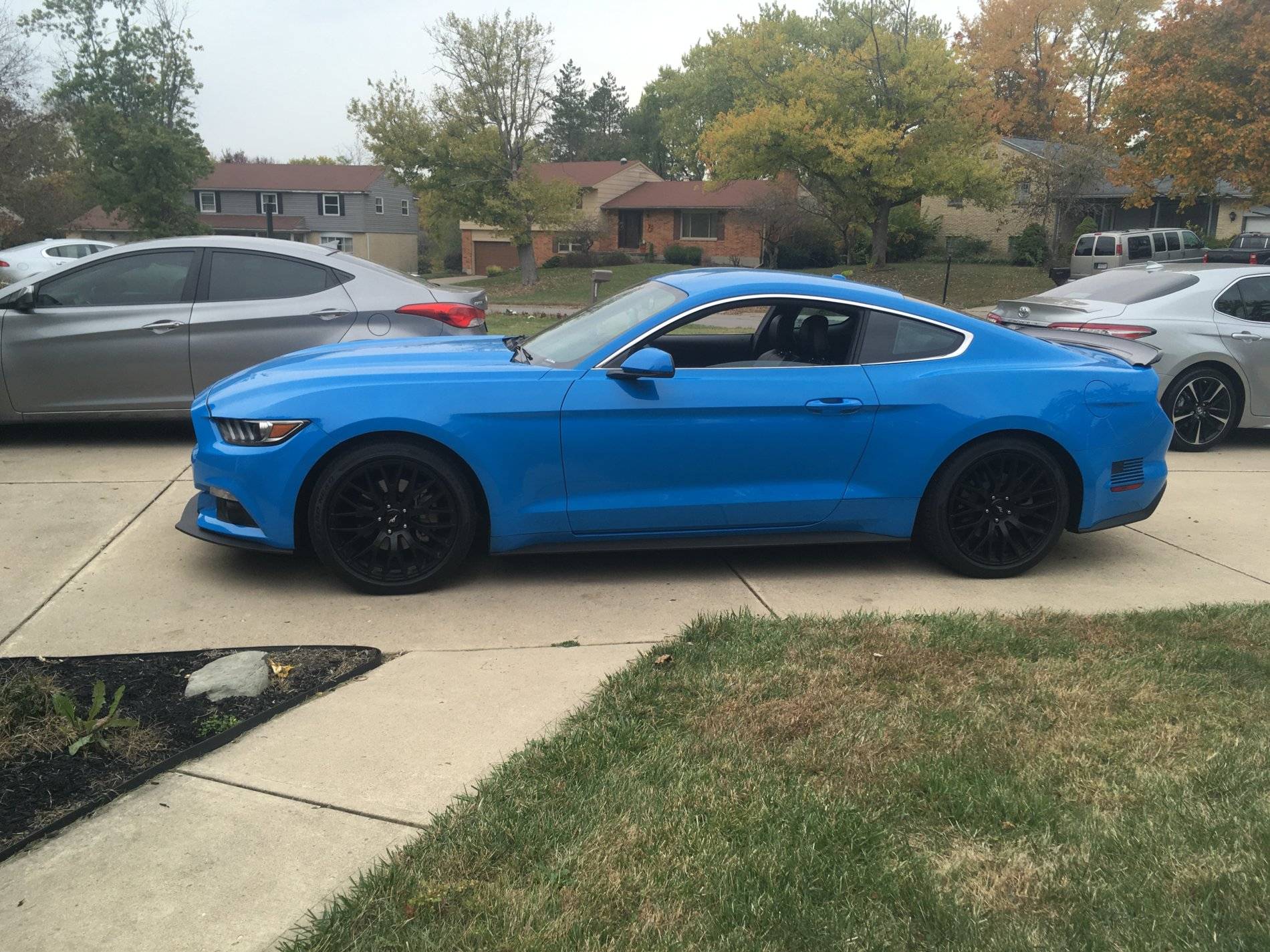

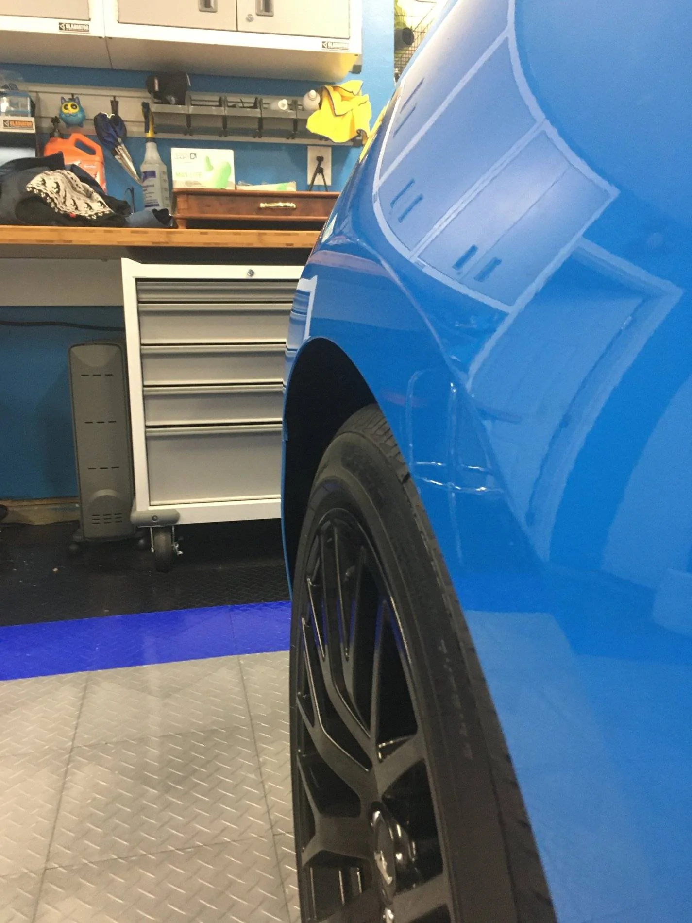

This is my car now before lowering springs are installed. Give me your opinions and my options!
Garage pic is old but shows the wheels space

Unless you do extended studs too, you'd want an adapter style spacer that is 20-25mm. 25 is what people usually use for the PP wheels, but your specs are a bit different.
You'd want all four wheels because the tuck is going to be exaggerated once the springs are in.

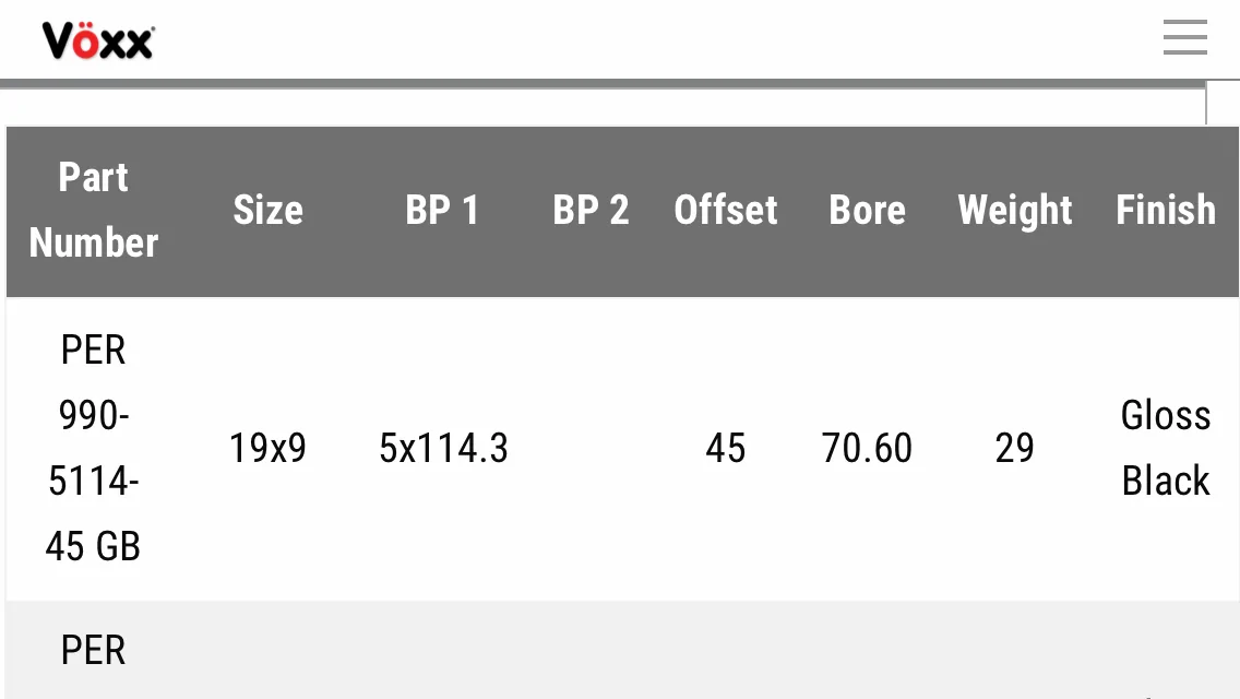

Here’s my exact wheel specs.
so guide me! What do I need lol.

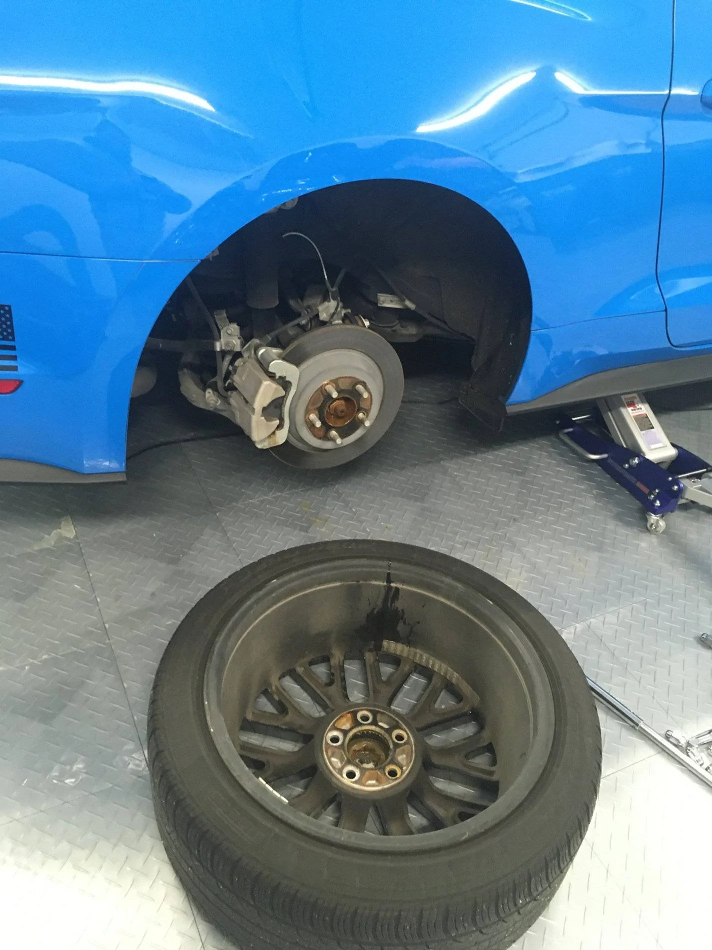

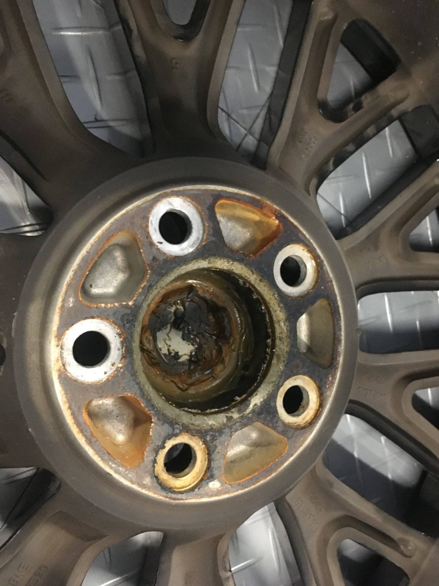

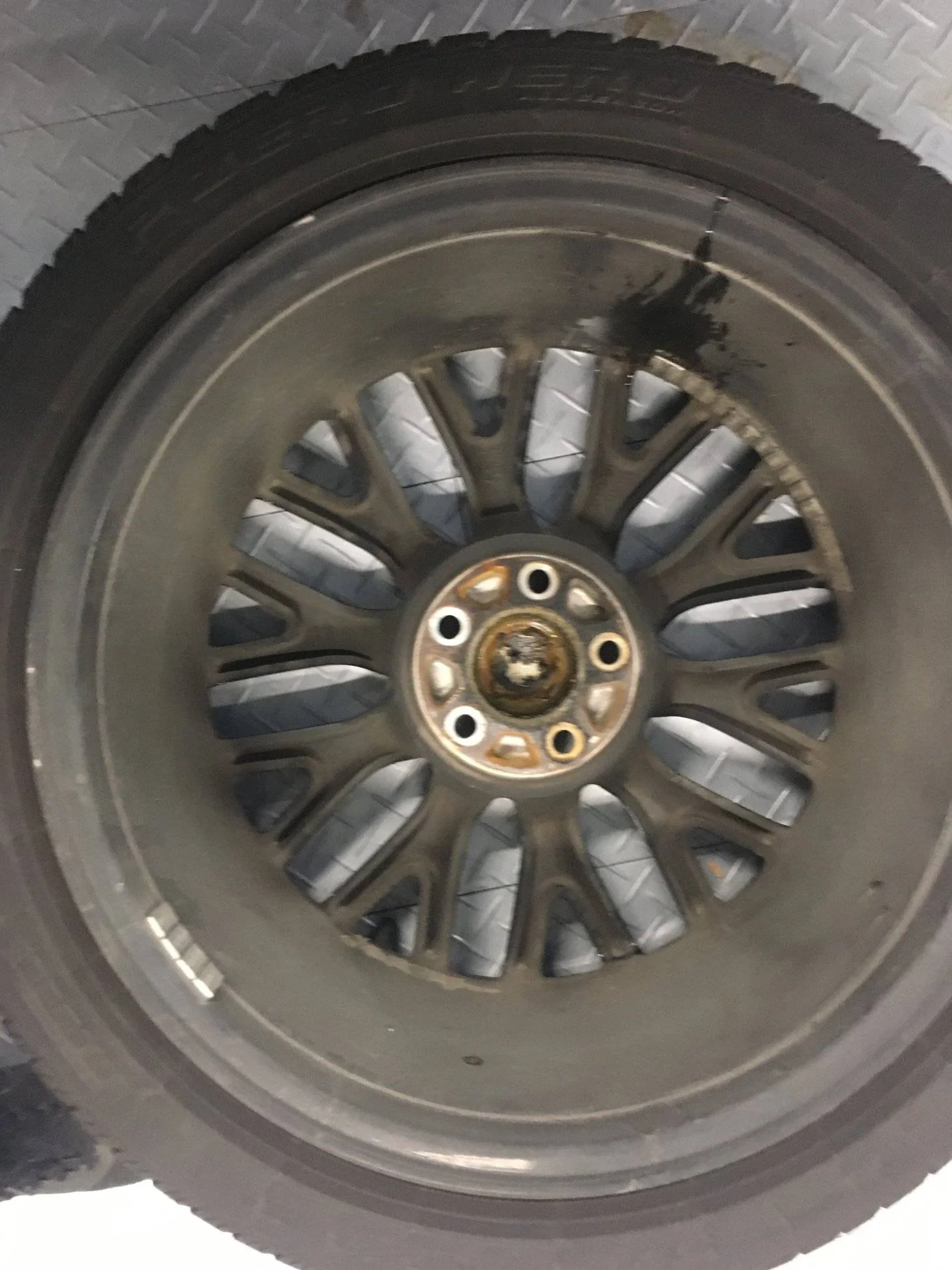

What does the back side of the wheel look like? Does it have pockets casted in between the log holes? If so how deep?

ignore the putty stuff in center cap, I use auto car wash and water was being pushed behind the cover caps and causing rust to come out the center later
so I stuck silicone in there to seal it up, worked well. Just nasty behind the cap now.

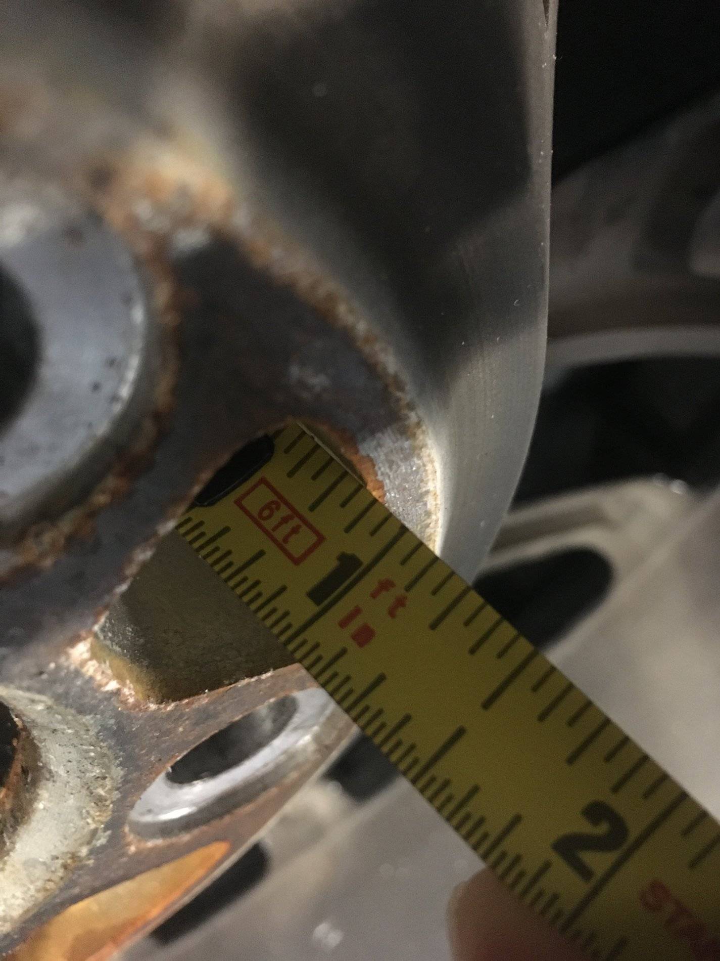

Looks like a little over 3/4 of an inch

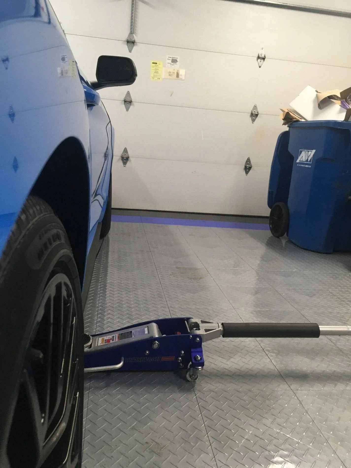

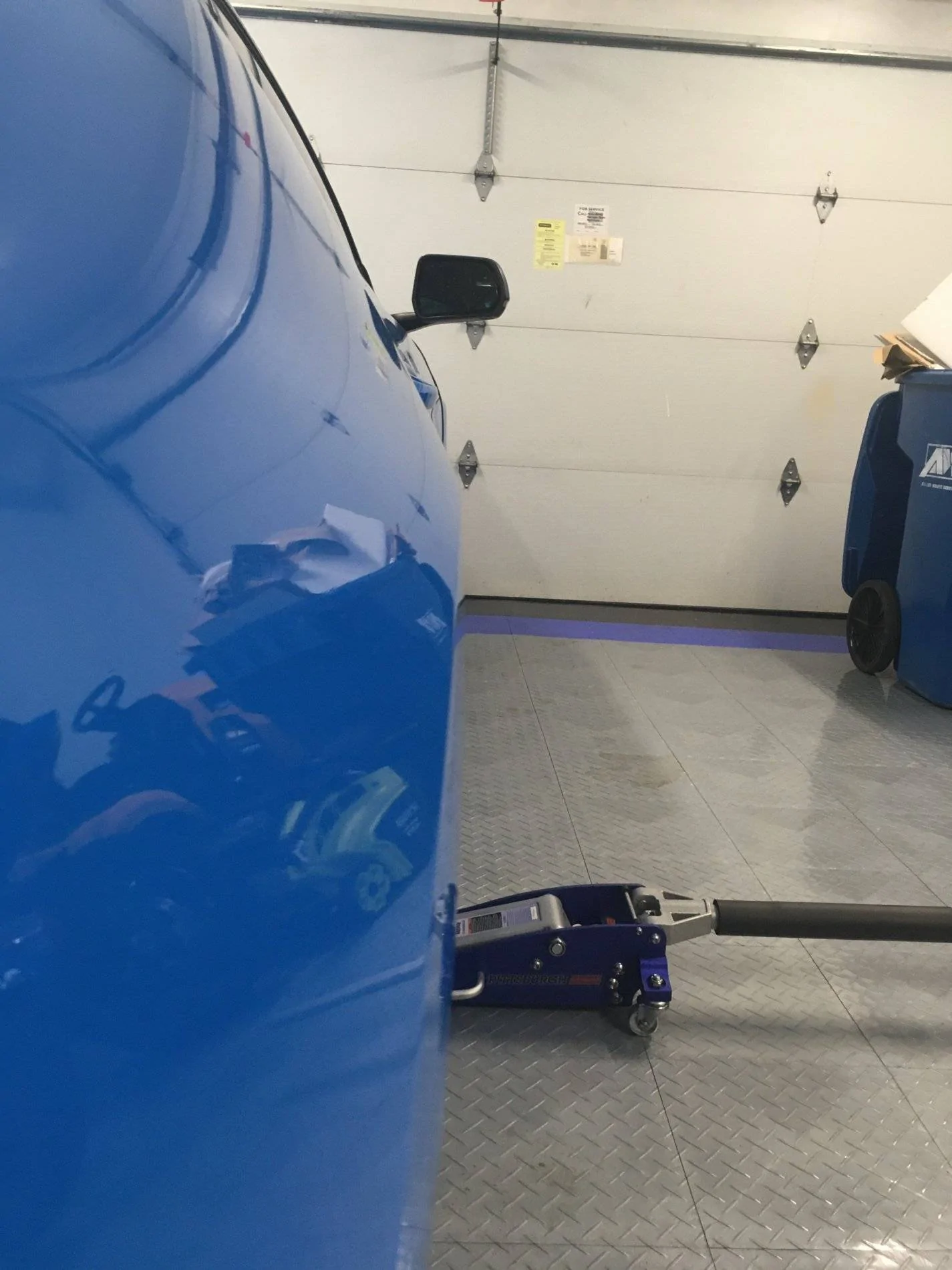

Some photos of it.

I don’t have a level crazy horse, I guess I will be buying one this week. Lol

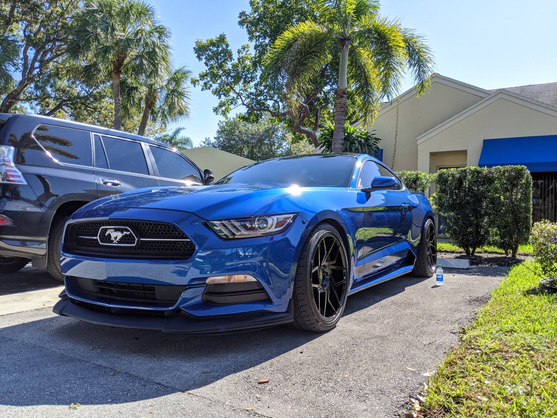

You don't need a level to do what Bill was suggesting, just something a straight edge to hold up from the wheel/tire. You want to figure out how much further out you want them to sit. 20mm should bring it to about what I have here. 25mm would be out a tad more. 5mm is about .2".

Here I am reading about like anything above 5mm spacers needing extended lugs,
do they make 20mm spacers? What widths are your tires? Mine are 19x9.0 @ 45 offset. Wondering if your suggestion of 20mm would be more or less than your set up.
I love your cars look. Would like to get that.
What product did you buy?

I think your rims are factory offset of 35 mine are offset of 45
how does this factor? Does this mean mine are or yours is further out already? Will that mean 20mm on mine will be further or closer inside, meaning maybe I need 15mm or 25mm or whatever to make up for the offset.
