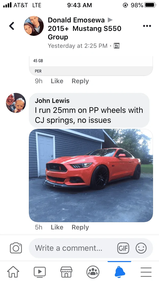

Would I rub at all with my wheels 19x9.0 45 offset with 25mm? I’ve been seeing photos and it also looks appealing.
Though he has pp and mine are not, replica wheels.

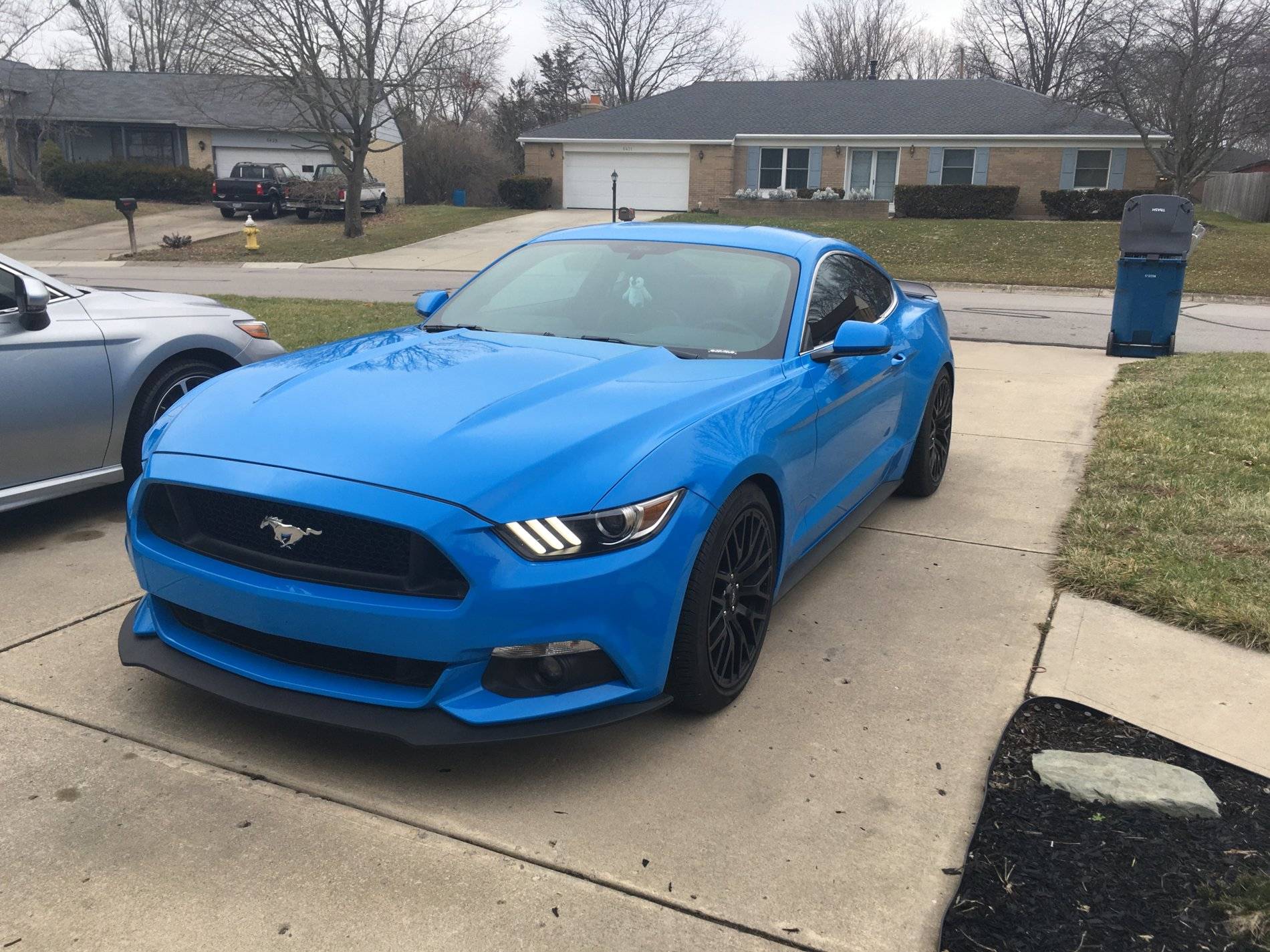

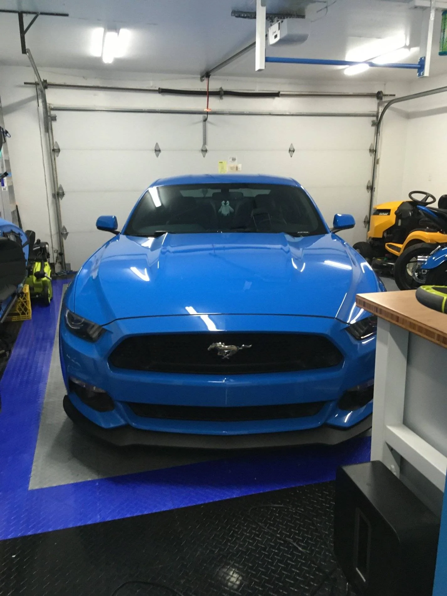

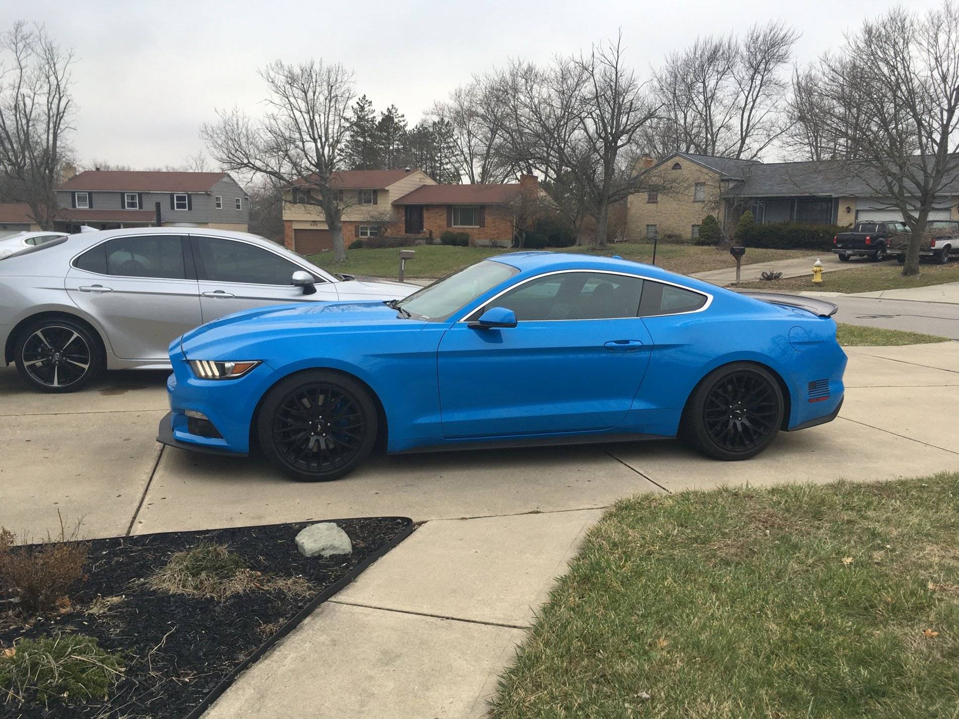

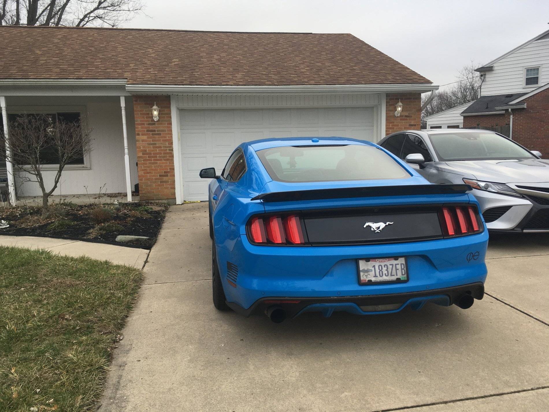

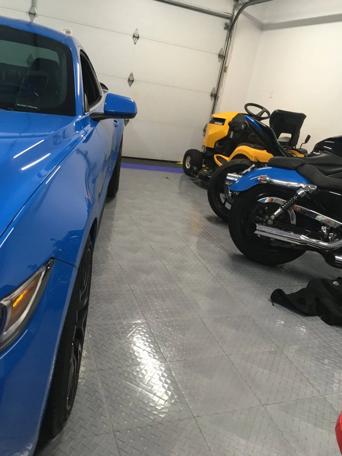

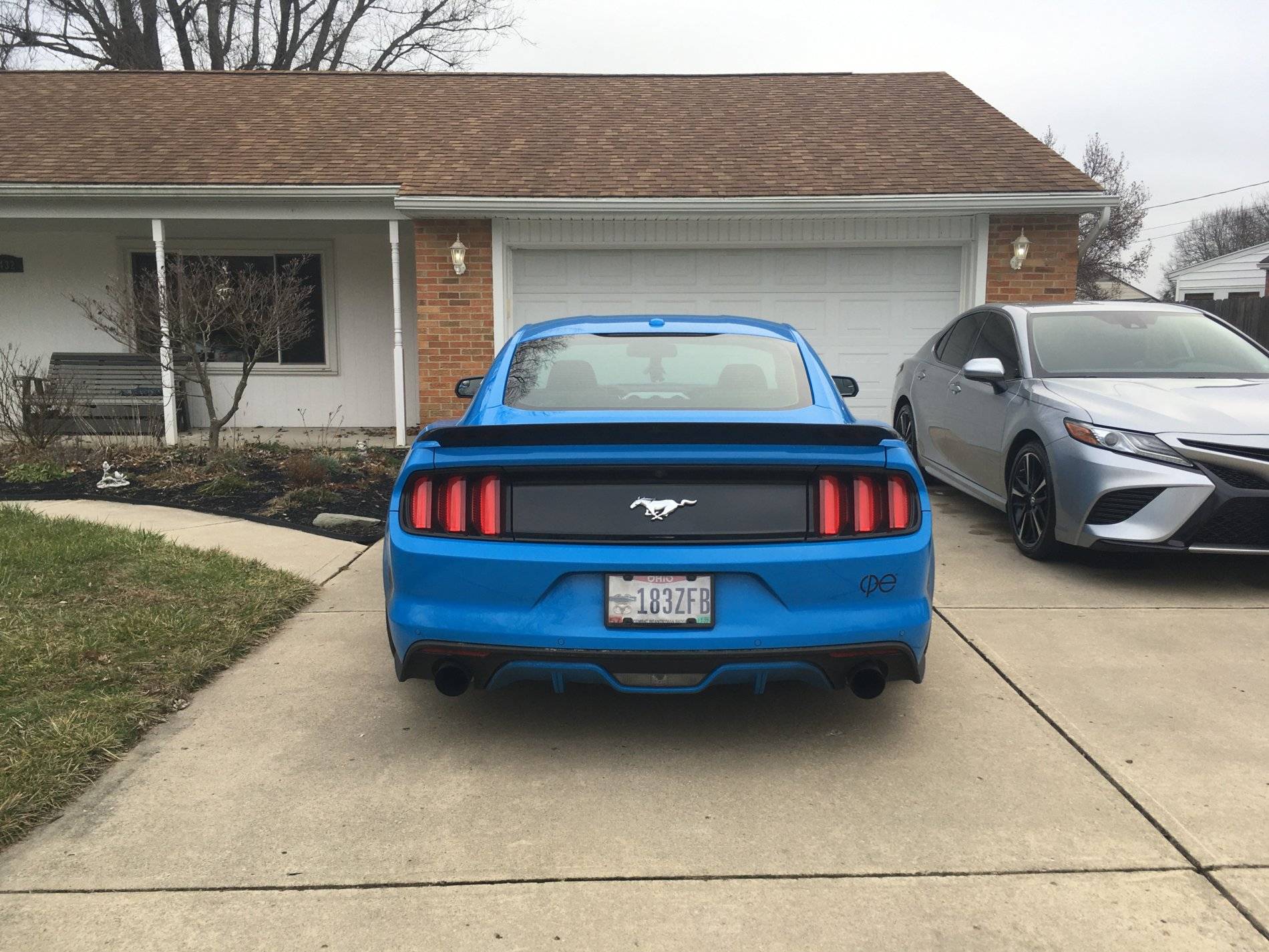

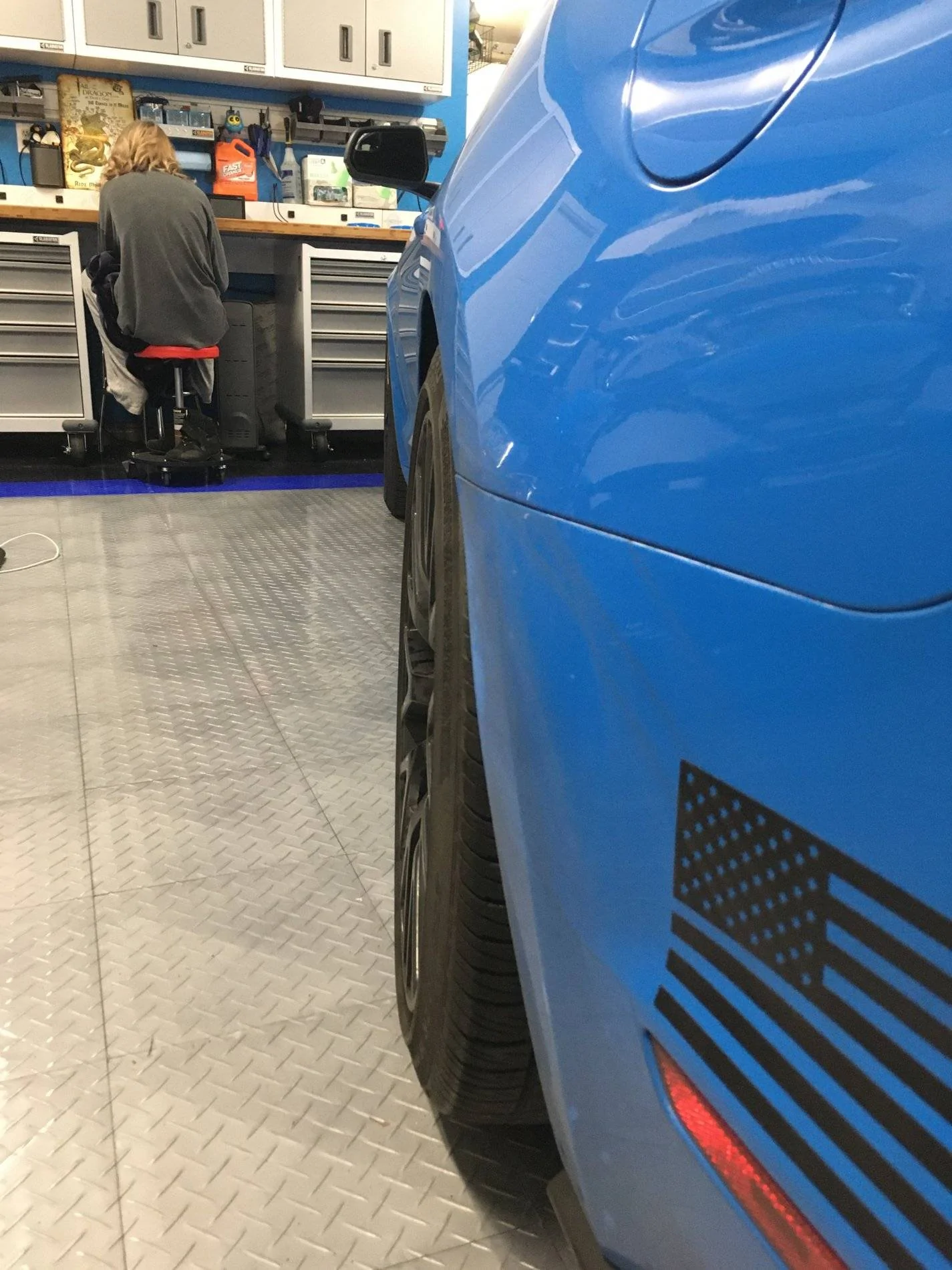

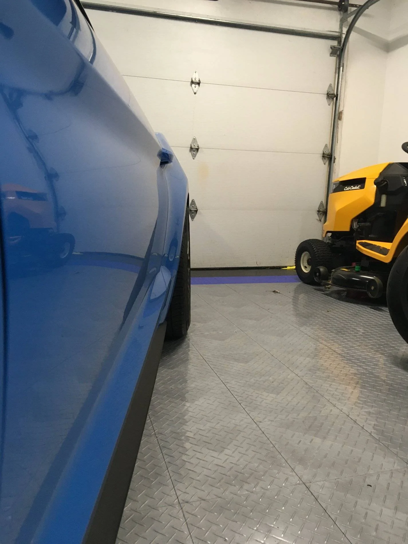

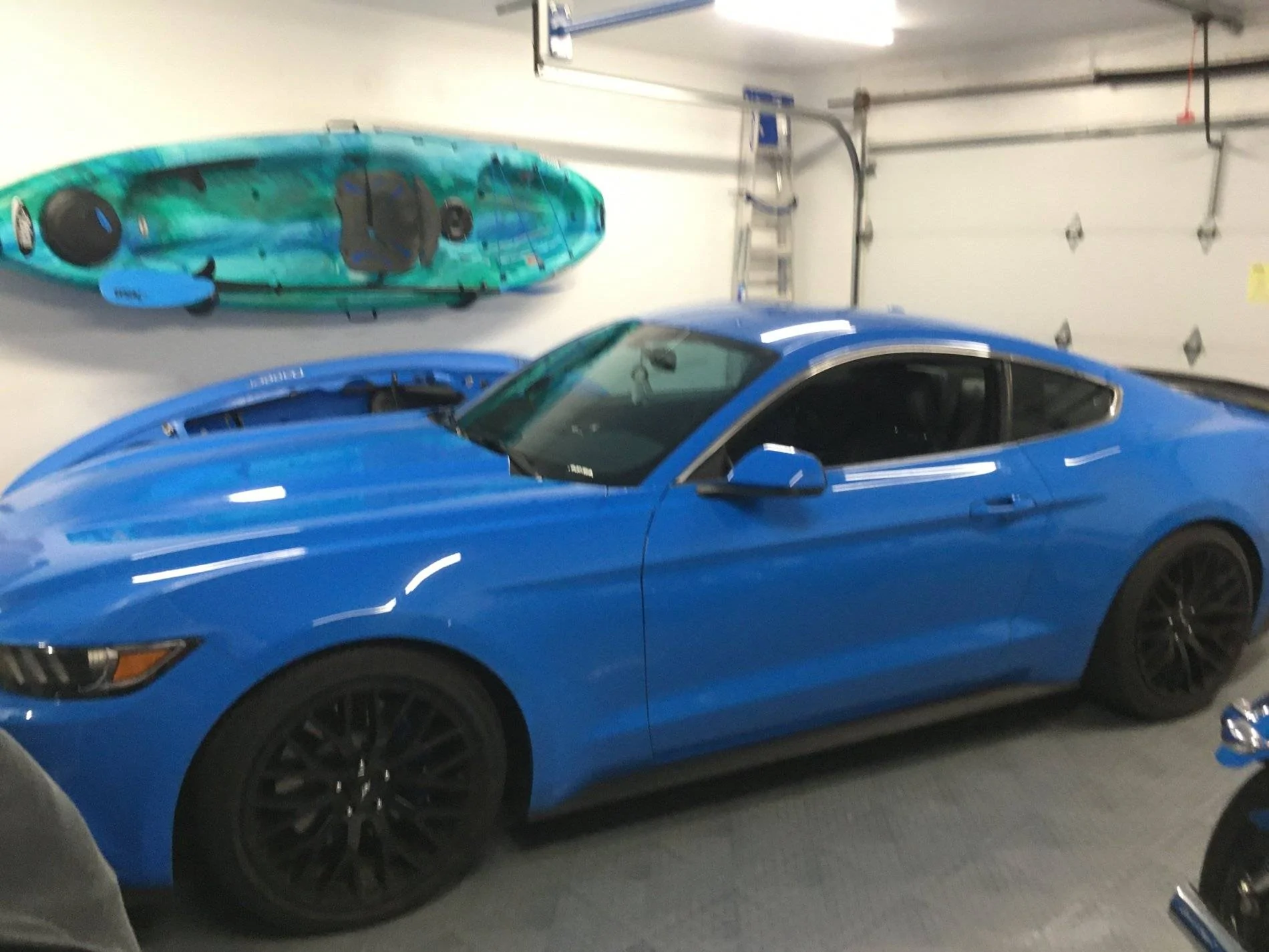

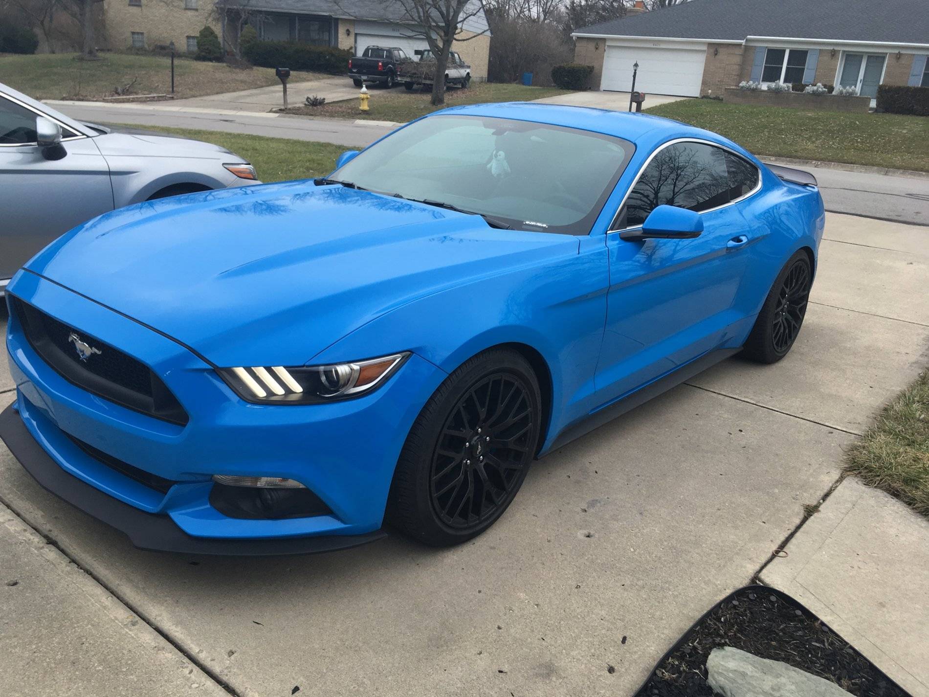

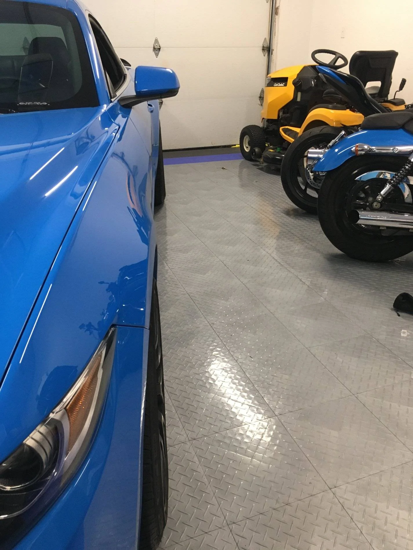

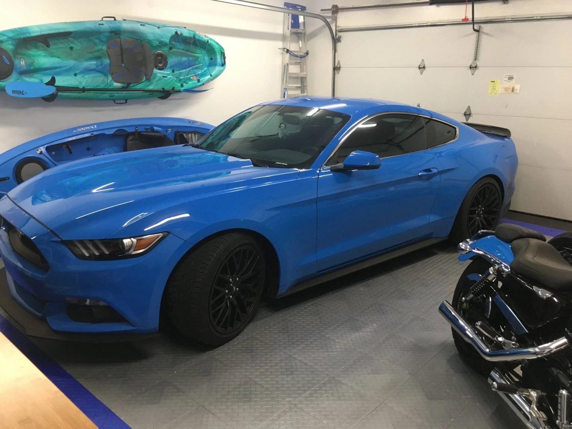

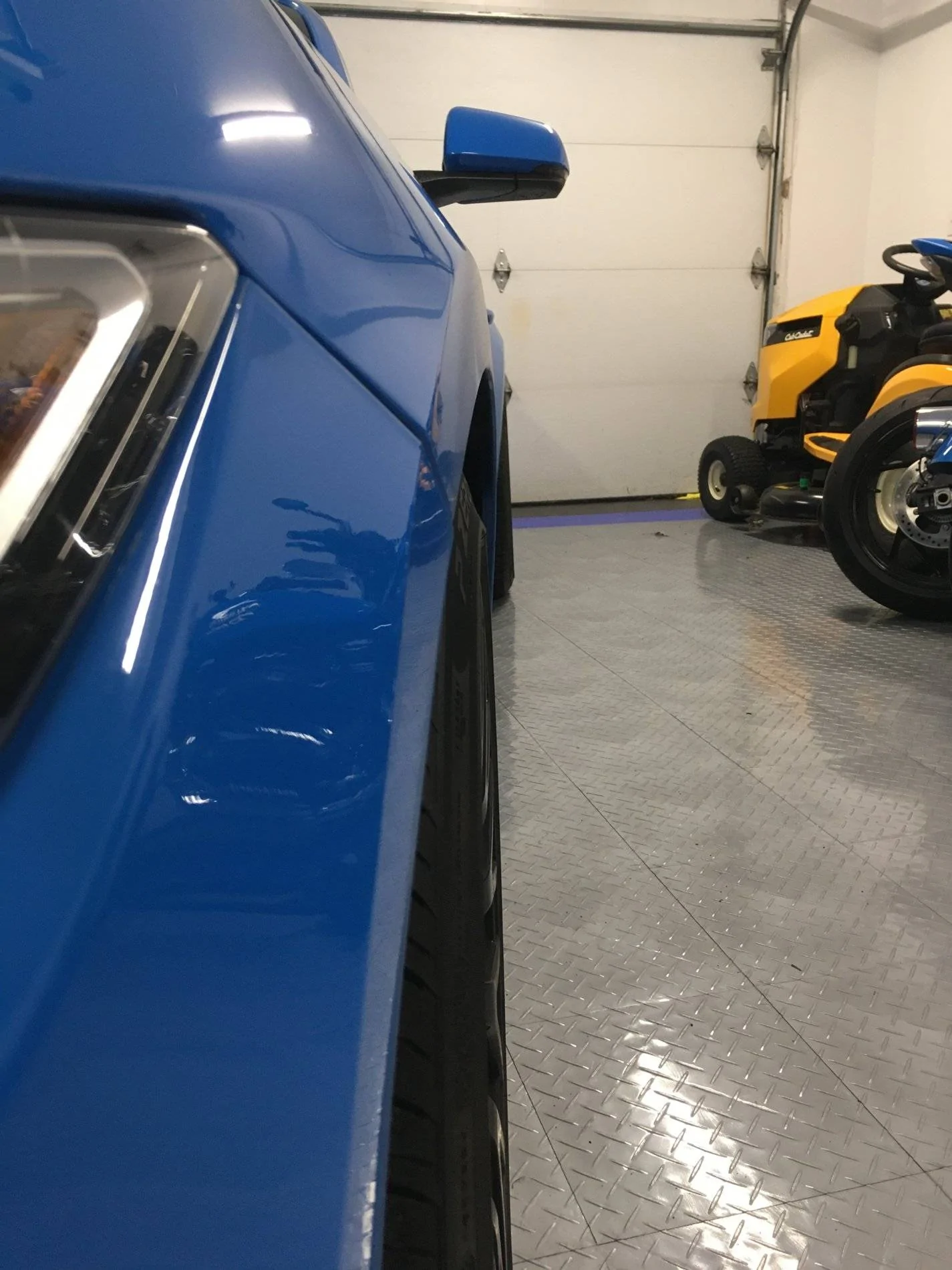

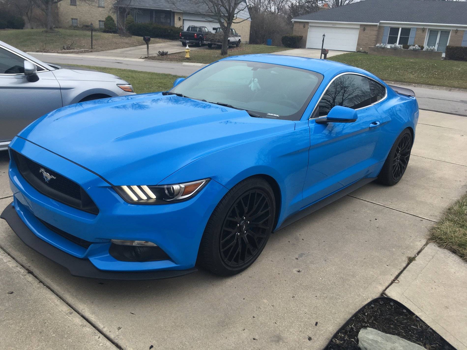

Here they are
FreePenguin
FreePenguin
Sep 29, 2019
81
5,354
3,704
Ohio
Donald
17 mustang
Got the alignment done, she’s all within spec now. A few better photos.
