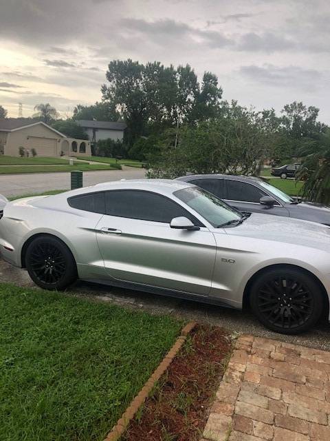

So I'm not too experienced with buying new wheels, but I currently have the stock 235/50/18 on my '19 GT non-PP and wanted to swap them out for something bigger.
Currently eyeing the PP replica wheels from American Muscle. 19x10 in the back and 19x8.5 in the front.
https://www.americanmuscle.com/performance-pack-black-19x10-2015.html
https://www.americanmuscle.com/performance-pack-black-19x85-2015.html
Along with that I'm looking to purchase new tires of course and was looking at the Pilot Sport 4S and the Continental Extreme Contact Sport (FRONT: 255 /40 R19 100Y XL BSW / REAR: 285 /35 R19 99Y SL BSW). Currently preferring the Contis cause of the ~$230+ price difference, but if anyone knows if the PS4s would be way better, let me know.
My question is, would this setup work easily with my stock car? Nothing changed on the car by the way. No suspension, spacers, etc. Would I just be able to purchase these and have them installed with everything else the same? And also, would I need to buy anything else such as a TPMS kit? Or would they be able to use the ones already on my wheels now?
Thanks for any help. Like I said, I'm clueless with a lot of this wheel stuff. And since I'm around the time to replace my tires anyways, I decided why go with the 235s again when I can change it out and go with bigger tires.

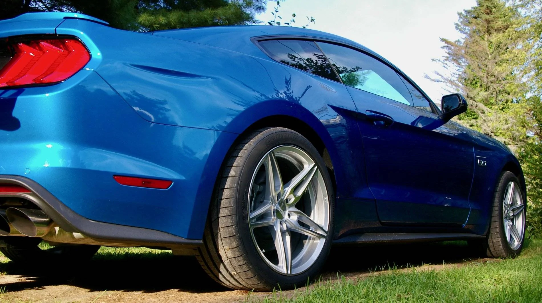

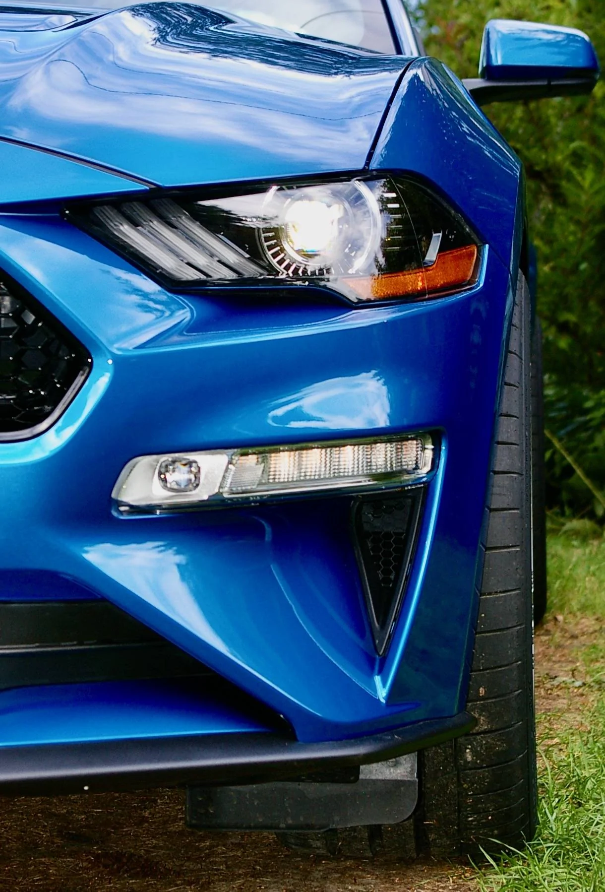

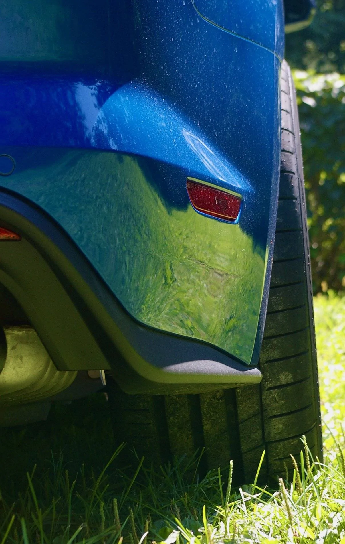

That will work with your stock car. You will lose the ability to rotate wheels front to back if that means anything to you. I just updated my stock '19 GT with 19x10" ET32 wheels with 285/35/19 ExtremeContactSport's and can't say enough positive things about them.... smoother, quieter, track straight and weigh 1 lb less per corner... win! That being said, I paid considerably more than the replicas you are considering, they are cast and the ones I got were flow-formed so very light.
