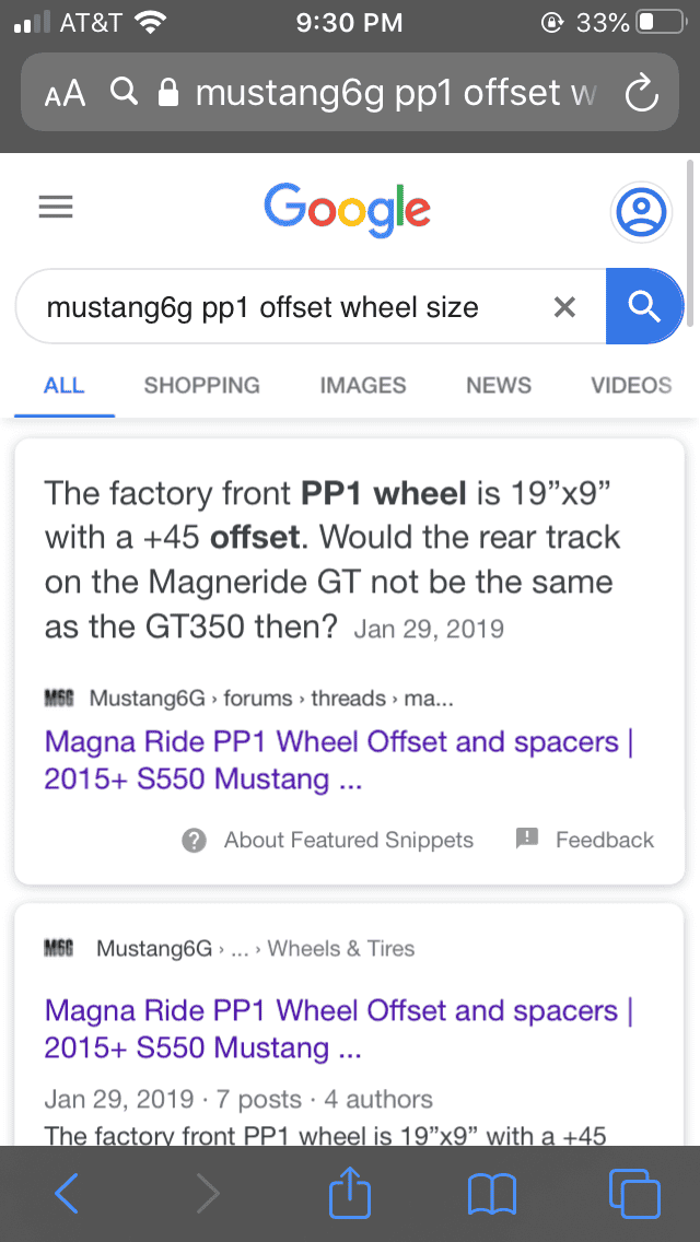

Google says the mustangs w pp1 wheels are 19.0 45 offset fronts.
With this said,
I have the same size wheels all around, I’ve been reading people do 25mm front and 20mm rear, so does this mean I should go 25mm all around? Or 20mm all around

I think your rims are factory offset of 35 mine are offset of 45
how does this factor? Does this mean mine are or yours is further out already? Will that mean 20mm on mine will be further or closer inside, meaning maybe I need 15mm or 25mm or whatever to make up for the offset.
Thanks!
I actually don’t know your guys’s oem offset,]
My wheels are not stock, they are 20x10 with a +42 offset and I put a 5mm spacer on each corner which ends with effective offset of +37. Offset is different based on wheel width, I gave my answer for you above based on calculated what the difference would be using this calculator. Set current as 10" width, 37 offset, and new as 9" width with 25 (yours with 20mm spacer) or 20 (yours with 25mm spacer) offset.
The 20mm spacer would have your wheels 1mm more inside compared to mine, the 25mm spacer would stick out 4mm more.

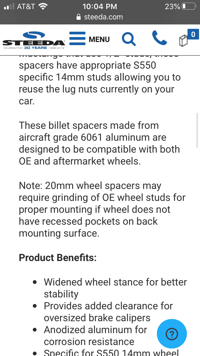

if you go with the 20mm spacer make sure the tip on your lug studs dont bottom our against your wheel. When you install the 20mm spacer on your hub. apply some paint to the ends of the OEM studs and install your wheel. if the paint transfers onto the rim you will need to C'bore it out a little with a 9/16th drill just a little so that the wheel will seat against the spacer and not against the lug studs.

And if you're wondering why to what he's saying above, the 20mm spacer might not be thick enough to cover the full length of the stud that it needs to so part of your actual studs could be hitting the "pockets" of the wheel. 25mm doesn't have that issue because it is thicker and covers the whole stud (iirc from when I had mine on).

So you’re saying the 20mm is the best bet, and if it rubs just to drill it down / shave it out so it won’t rub anymore in the recession spots.

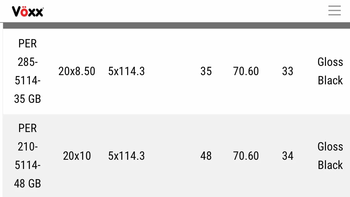

20x8.5 +35 would sit in 17mm compared to mine
20x10 +48 would sit in 11mm compared to mine
Really you'd want 10" wide with a 35-38 offset or 9" wide with a 24-27 offset.
If you aren't set on whichever shop those screenshots are from, check out LMR now because they have some killer deals on their wheels for Black Friday-Cyber Monday. Some are $500 for the set!
