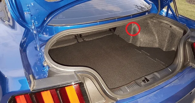

I had (hopefully had) a similar rattle in my Mach 1. There is a metal weld point about right in the middle of the trunk liner on the right side that had enough of a gap where it would resonate against itself. Its located behind the liner. If you smack it there you may hear a rattle/metal on metal noise. Ive currently got 3M tape holding pressure on both sides to prevent it from rattling.
Had to peel back the liner to get to it but so far it's helping...the universe willing of course.
