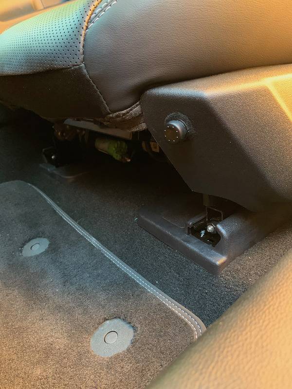

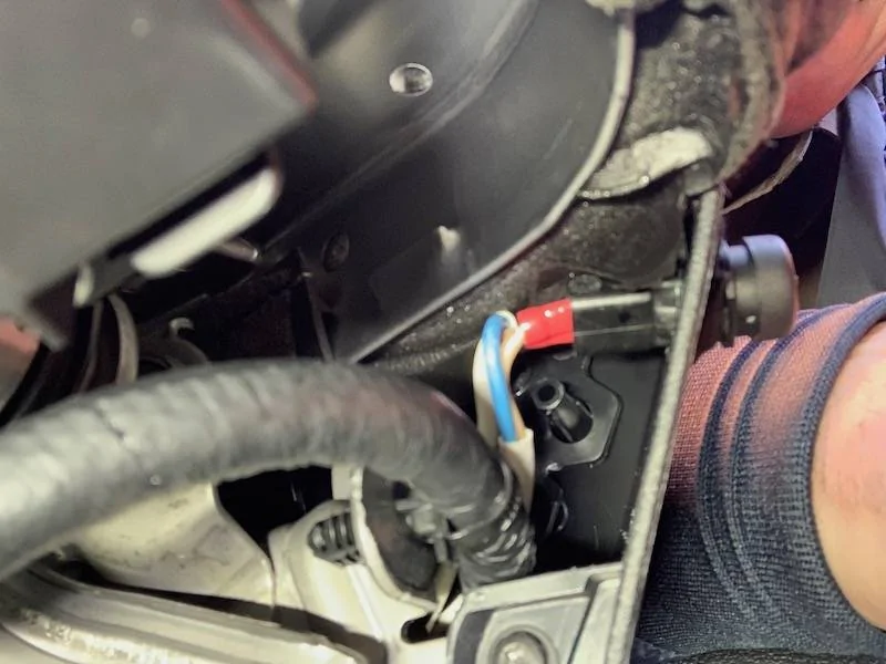

Sixth mod: installed a permanent remote control for the gate motor.
My gate works with two generations of remote controls. The new model is more modern and takes a 3V battery. The old generation, however, used to take a 12V lithium battery. So nine years ago, when I installed the gate motor, I figured I could connect it directly to a 12V supply in the car and install a button in the car, so I have it always at hand and never have to worry about replacing the battery. I did that in my first Mondeo, then transferred it to my second Mondeo, and now I've transferred it to the Mustang.

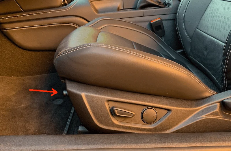

The best place, all things considered, was on the plastic trim that surrounds the driver's seat buttons.
I'm very pleased with the result. It's discreet and very easy and comfortable to reach.
The remote control is hidden behind that plastic trim. Try as I might, I can't take a picture showing the remote control itself - it's well hidden behind those metal brackets, though it can be seen from a certain angle if you know exactly where to look. Follow the wires from the button and you'll get a rough idea where it is.
The power for the remote control comes from the connector that goes into the command panel of the seat, which is right there, directly behind the command panel. A couple of minutes with a multimeter told me which pins to use.
As a bonus, this connection is permanently on, so I can use the remote control at any time, engine on or off.

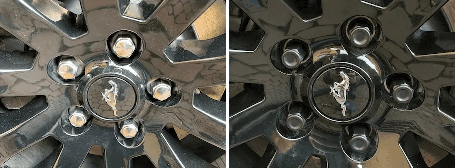

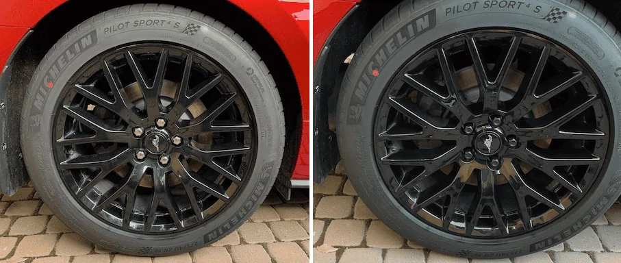

Seventh mod: black lug nuts.
I hated the look of the silver ones. They looked awfully out of place on the black rims. Besides, I didn't trust Ford's two-piece design, which swells over time.
Left: before. Right: after

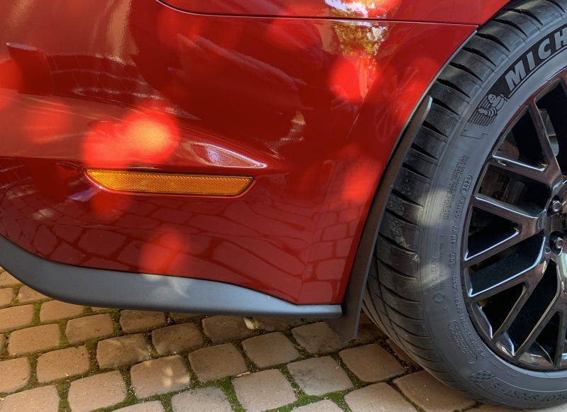

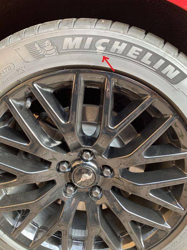

Nice, black nuts are defo on my to do list :sunglasses:
If your interested enough, those coloured spots will come off the tyres with a little bit of white spirit :like:
WD :like:
Vlad Soare
Vlad Soare
Jan 21, 2020
67
3,696
4,549
Bucharest, Romania
Vlad
2020 Mustang GT 6MT
Done. They're not completely off, though. You can still see a discoloured dot if you know where to look.
But at least they aren't red anymore. It's much better now.
WD Pro
Jan 18, 2018
132
6,819
13,669
United Kingdom
Lime GT
Hhhhmmm ... Perhaps the red use a different glue ?
Mine were yellow and the white spirit shifted all the glue (with a little bit of work) :like:
WD :like:
Vlad Soare
Vlad Soare
Jan 21, 2020
67
3,696
4,549
Bucharest, Romania
Vlad
2020 Mustang GT 6MT
Oh, you think that's glue? In that case, maybe good old Goo Gone can help. I'll give it a try. :like:

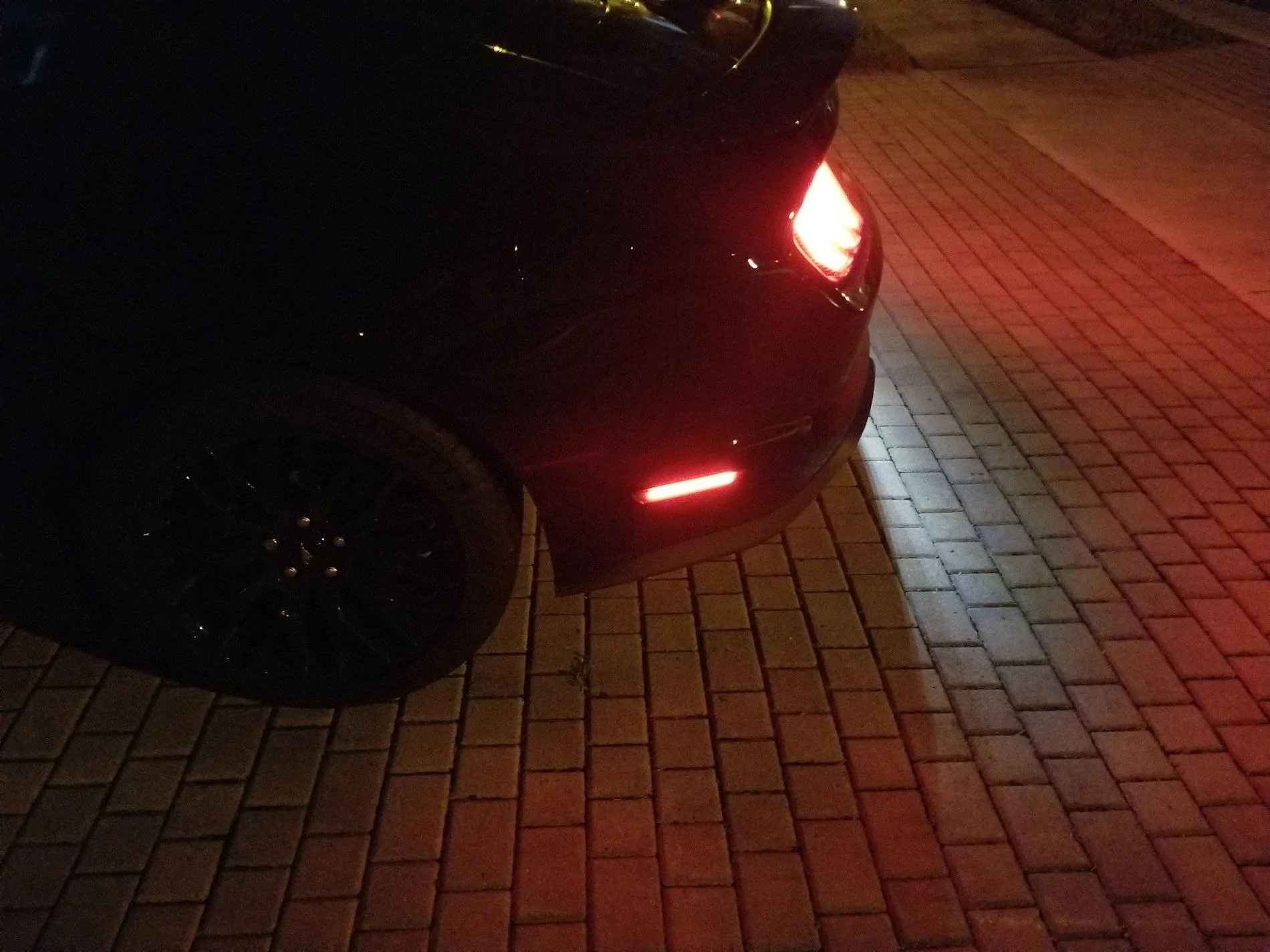

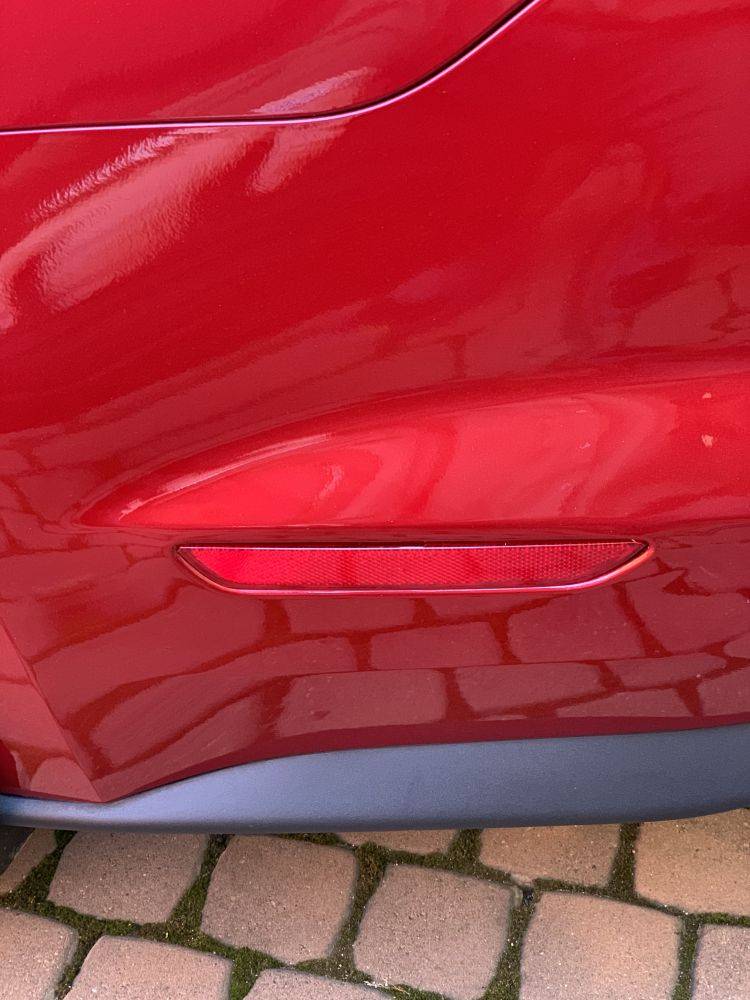

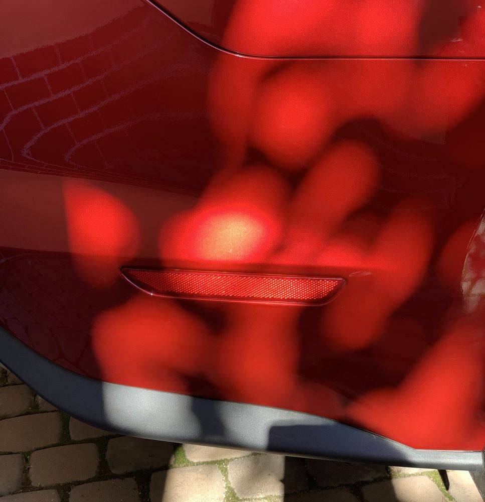

I temporarily solved the orange reflector problem. Red foil. :sunglasses:
It's transparent enough not to hinder the function of the reflector.
Before:
After:
This will have to do until I manage to source some real red reflectors.
