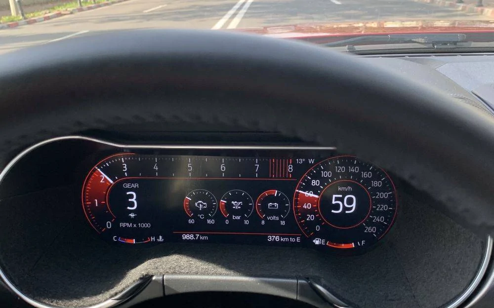

My OBDLink EX has arrived. This is what I've changed so far:
- four turn signal flashes instead of three
- disabled the double honk when the key leaves the car while the engine is running
- disabled the 'door open' chimes (both ways, i.e. opening a door while the engine is running, or starting the engine while a door is open)
- disabled the green upshift/downshift indicator on the dash
- auto door lock (upon driving off from a standstill)

Red dash, to match the colour of the car. :sunglasses:
Oops! I took pictures while driving. Shame on me! :giggle:

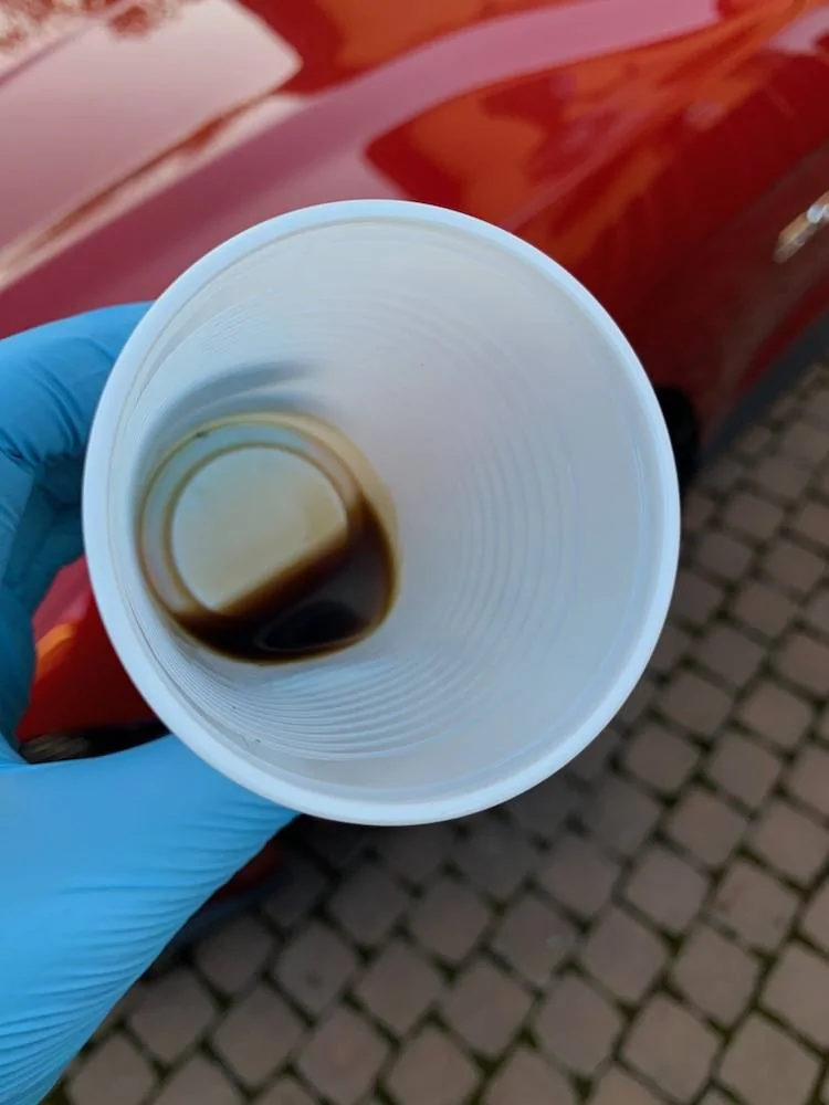

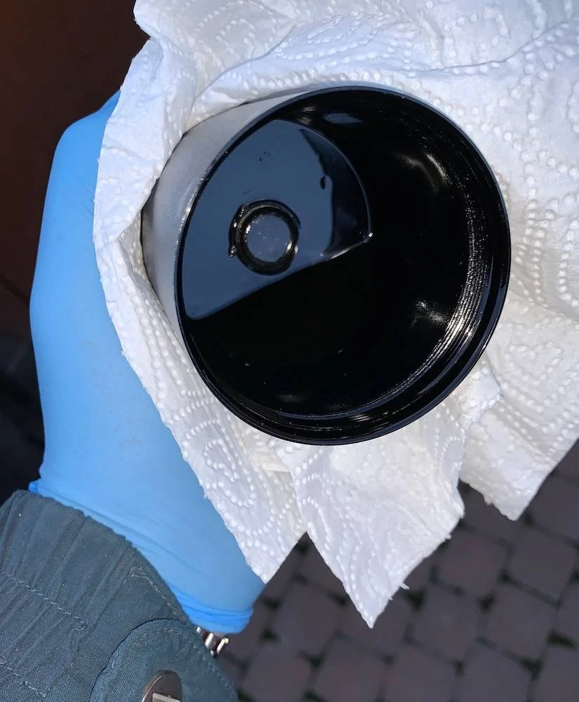

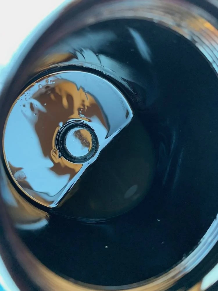

I checked the catch can today. I was curious as to how much oil might have collected in it in a thousand kilometers. Not much, apparently, though it's enough to make me glad I installed the can.
It's difficult to take a clear picture of the black can interior. A disposable cup gives you a better idea of the quantity.
I used a syringe to measure it. It's exactly five milliliters.
The bottom of the can can be unscrewed and removed for emptying using your bare hands, without removing anything but the radiator cover (which is a piece of cake). It does take a bit of fiddling, though, and you need thin hands. Otherwise you can follow Mishimoto's instructions and remove the hoses and the screws that hold the can to the bracket, then take out the whole can. This will be necessary from time to time anyway, in order to clean the brass filter and baffles, but just for a quick oil level check and emptying I think it's a bit of overkill.
I'm so happy I installed the catch can. All this oil would have gone into my engine, soiling everything in its way - throttle body, intake manifold, valve seats, valves... everything. Yuck!

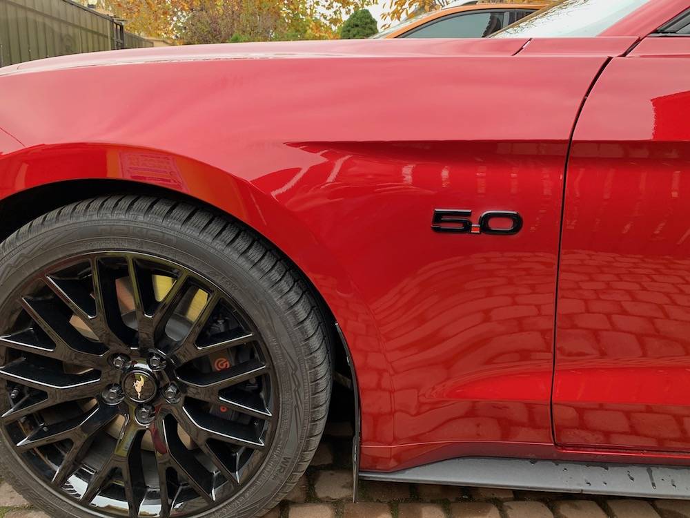

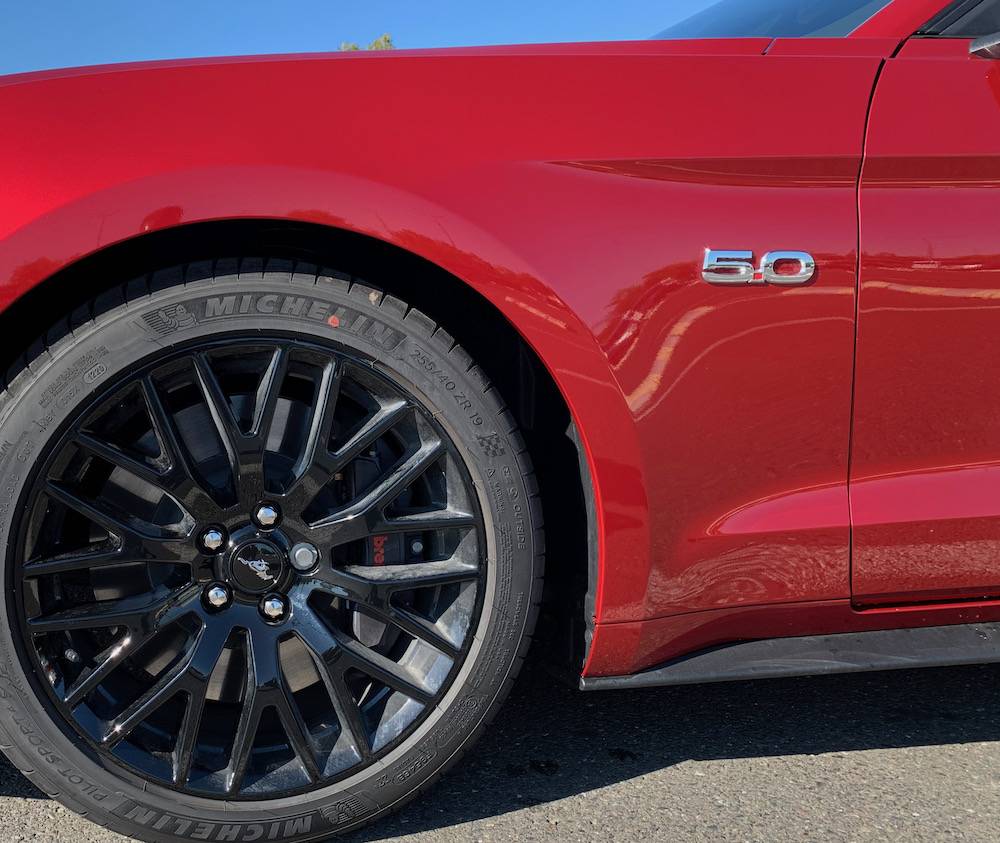

New change - black side emblems. :sunglasses:
The silver ones looked terribly out of place, since there was nothing whatsoever in chrome or silver on the sides of the car, not even the wheels. Not even the wheel nuts for that matter (the picture below is old; in the meantime the lug nuts have turned black).
Now everything looks as it should.
Before:
After:
The trouble is that having started this, I now feel an irresistible urge to continue. Now the chrome pony on the front grille looks out of place. And there's slight problem with that. I know the pony is also available in black, but I'm not sure how it would look on a black grille. I like the grille pony, to me it's a defining feature of any Mustang, so I'm not sure if making it harder to see would be a good idea. I'm afraid it might become next to invisible. I don't know; I'll think about it.

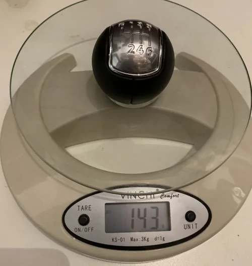

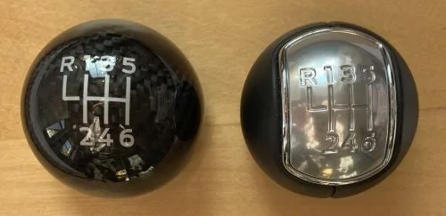

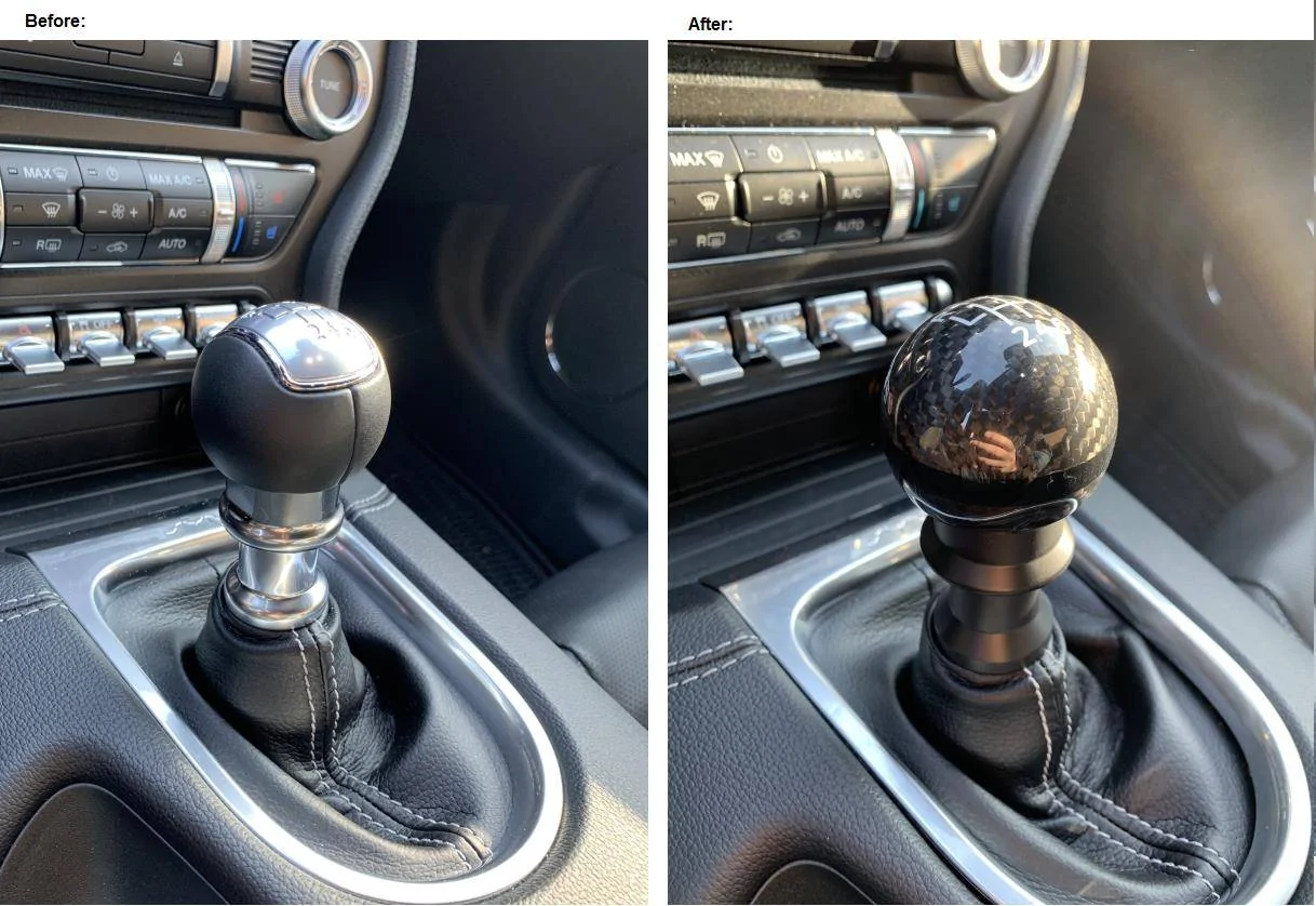

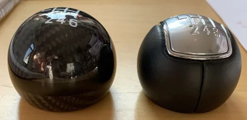

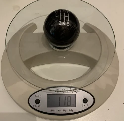

New mod: Ford Performance carbon fiber shift knob, plus Steeda black delrin lockout collar. :sunglasses:
The shift knob looks and feels great. Photos don't do it justice. :inlove:
Size-wise it seems to be just a tiny bit bigger than the stock one, but that's only visible in a side-by-side comparison, and only if you look carefully. Actually, I'm not sure whether it's indeed larger in diameter, or it's just the original one's flat top that gives this impression.
Weight-wise, my scale says it's lighter, but I couldn't feel that. It feels nice and reasonably heavy.

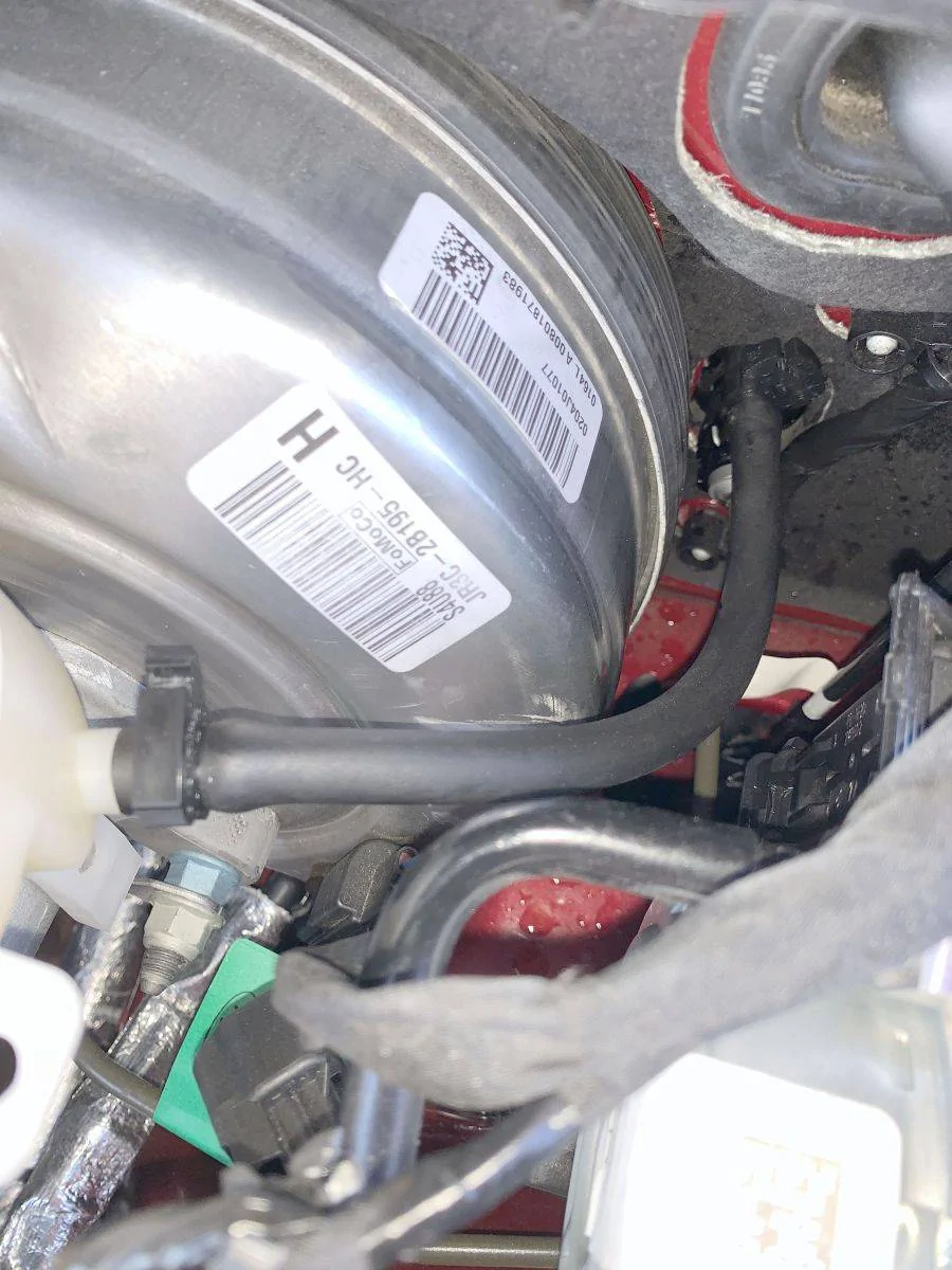

New mod: Steeda improved clutch line to master cylinder.
Considering how hard I had to pull on the original line to take it off the nipple, I don't think it would have ever come out by itself. It would have probably been just fine. But I had no way of knowing that beforehand, and it was a constant source of anxiety to me. Every couple of days I would open the bonnet just to check if the hose was still looking fine.
So, problem solved. :sunglasses:

How much fluid did you loose, was it a tricky process and did you need to bleed the clutch ?

Very little. I couldn't even perceive a change in the fluid level in the reservoir. It was at Max when I started, and it was still at Max when I finished.
There were two tricky bits.
First, removing the firewall end of the hose. I don't think it's tighter than the other end, but there isn't enough space to wiggle it while pulling, which makes it harder.
Second, tightening the clip at the firewall end. You can't tighten it with your bare fingers, and there's not enough space to insert just any tool. You'll need a pair of very long and thin pliers, preferrable with a curved tip, but I didn't have anything like that. Luckily I managed to find something else that worked.
